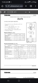

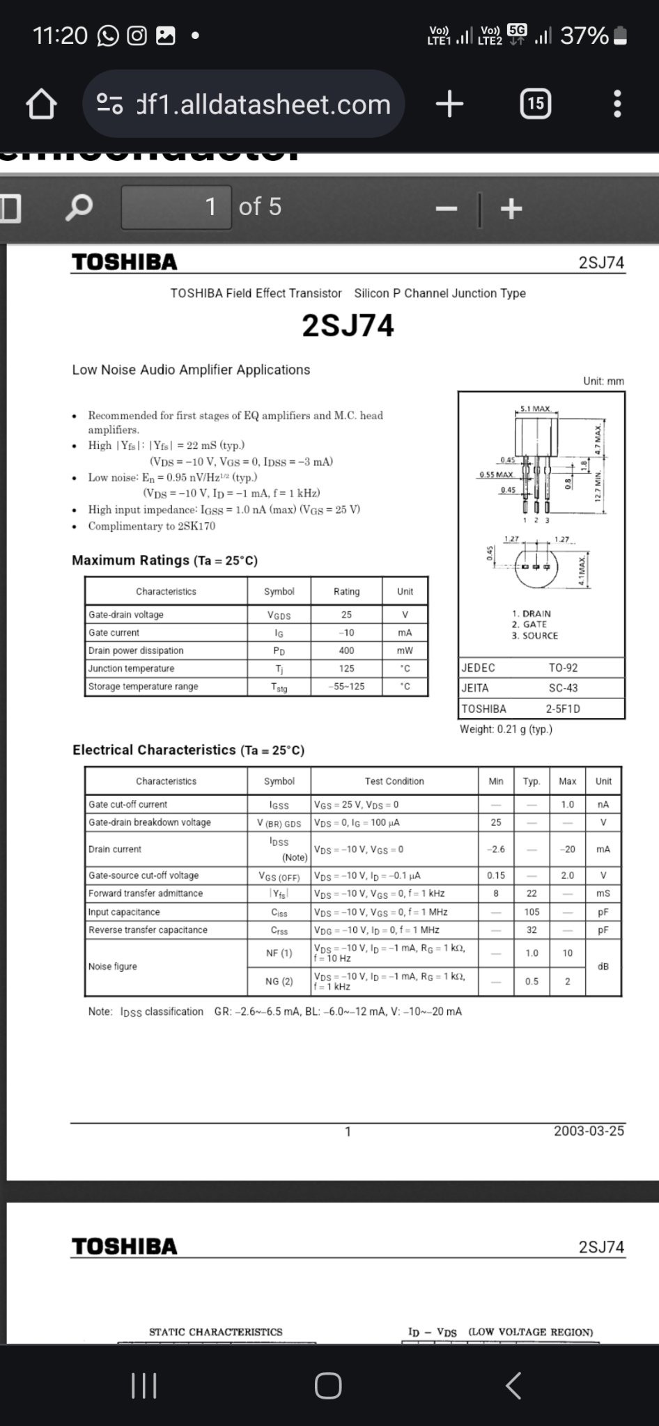

For my new project Aleph J, JFETs Q1A, Q1B - LSJ74 are the only option to be considered (found in digikey) other than 2SJ74 ( very difficult to get genuine one). But my concern in choosing LSJ is that having different varients like LSJ74A,B, C, D. Having various Idss values in electrical parameters. So which one to be selected.
Attached data sheet of both LSJ and 2SJ for reference.
One more thing in the case of BJTs Q2-PNP and Q3,Q4-NPN. For Q2 - ZTX551and Q3,Q4 - ZTX451 are my options (available on dijikey and mouser) even though having low (hfe upto=150) because ZTX550 are obsolute.
What are the better options for these BJTs (which are easily availabe on dijikey and mouser) without changing circuit component parameters in aleph j.
I am a beginner in this field and your suggestions are greatly appreciated.

Yes, the jfets should be Idss matched (say , to 1mA per Papa's recommendation) If you just buy a few pieces from Digikey, even within the same IDSS grade, there is no guarantee they will meet the recommended matching tolerance. And the LSJ part isn't exactly cheap either so you probably don't want to buy a large batch just to match a couple of pairs...
Brings up a question. NP has stated that the 2SJ74 could be run to 30V without any ill to the devices. (I'm running mine in Aleph J at 28.5V, SFSG) Do you know what the LSJ74 might tolerate? Interesting the Linear datasheet says "IMPROVED SECOND SOURCE REPLACEMENT FOR 2SJ74". Know anyone that has run these higher than 25V D to S? And thanks for the link to the ebay seller, bought a couple quads!
The 400mW is at 25 C.
Perhaps de-rate to 1/4 to 1/3 of 400mW to be on the safe side, and heat sink if pushing it.
That’s exactly right, even Pass recommends choosing a lower Idss version to minimize the dissipation, which was pushing 200mW in the F5 turbo versions. Inside an amp will be a different, i.e. warmer thermal environment.
I personally would try it, but with heatsinks. If that’s too hot, then cascoding of course.
