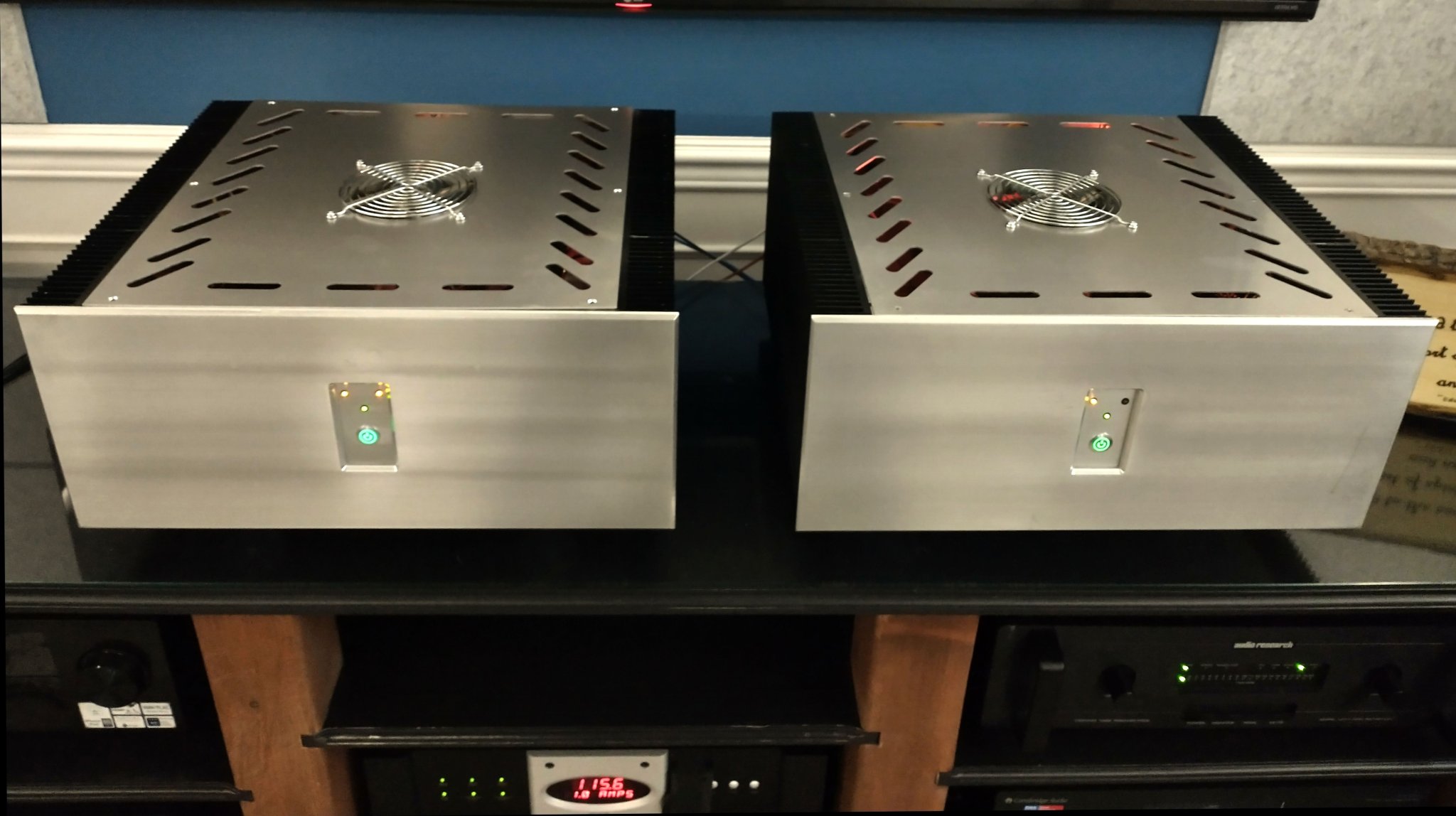

Thanks for the feedback all. I've been running them with the clip on sinks, and they're right around the 36C mark. I added some high performance paste into the walls of the sink before sliding them over. I can tell you the sound is great! The bump in power has made the difference I was looking for. Previously using the Antek 18V transformer. I found the Plitrons (400VA, 22V secondary) in a shelf I had bought in 2014, and forgot about them. So after reading the threads on using a higher rail supply and asking some questions, the first amp is up and running. I also changed the chokes from a 159ZJ to a 159ZL (10mH). Excellent! I've also dropped the bias a bit from 450mV to 420mV to offset the higher rail supply. Yup, it warms up quite a bit faster. But all good so far, amp #2 coming up this week.
It would be nice to know what a realistic de-rating for temperature is. As mentioned I'm seeing about 36C to 40C, with rails at 28V, BL devices at just under 10mA. So...it's breaking some barriers here at 3V over maximum D-S volts already. And at 70% of maximum dissipation. The heat sinks must be helping. Too bad we can't know what the temperature limit is before the ca-ca hits the fan. May find out soon enough! Keeping the current at 400mV/470R might be an option to consider.

I designed and built these cases before such sizes were even available. I wouldn't do it again if given a choice, too much work!
Reactions: 4 users
I think a lot of builders dismiss using fans...should not be the case. I actually have 5. I mounted four of these perfectly square on the bottom of the heat sinks, directly below the center of each pair of power devices. F410T-12LC. You cannot see them as the width is exactly the same as the heat sink.
For the top fan I used this: Noctua NF-P12 redux-900.
I designed and built a microcontroller based solution that includes a soft start circuit and monitors a pair of LM35 heat sink mounted temperature sensors. The fans are all 12V. The small ARM controller signals a switchable 8V regulator to run the fans, and you can hear them only within a foot or so away. If you think these little fans are not effective, try them and see! Since they move air right at the heat sink channels right at the power device location they're effective. So they only get enabled when the temperature reaches 49C, and I have about 4 degrees hysteresis. The bi-color LED at the center switches from green to orange when cooling cycles making it easy to track how effective it is. The amps seem to run perfectly in this zone!

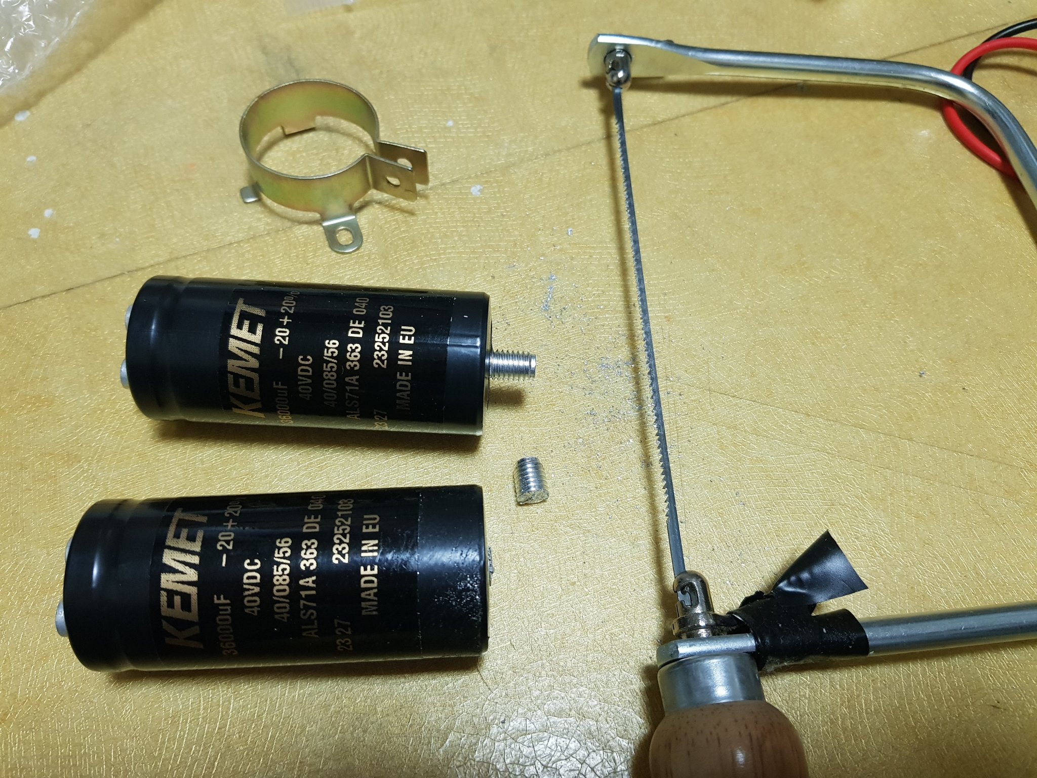

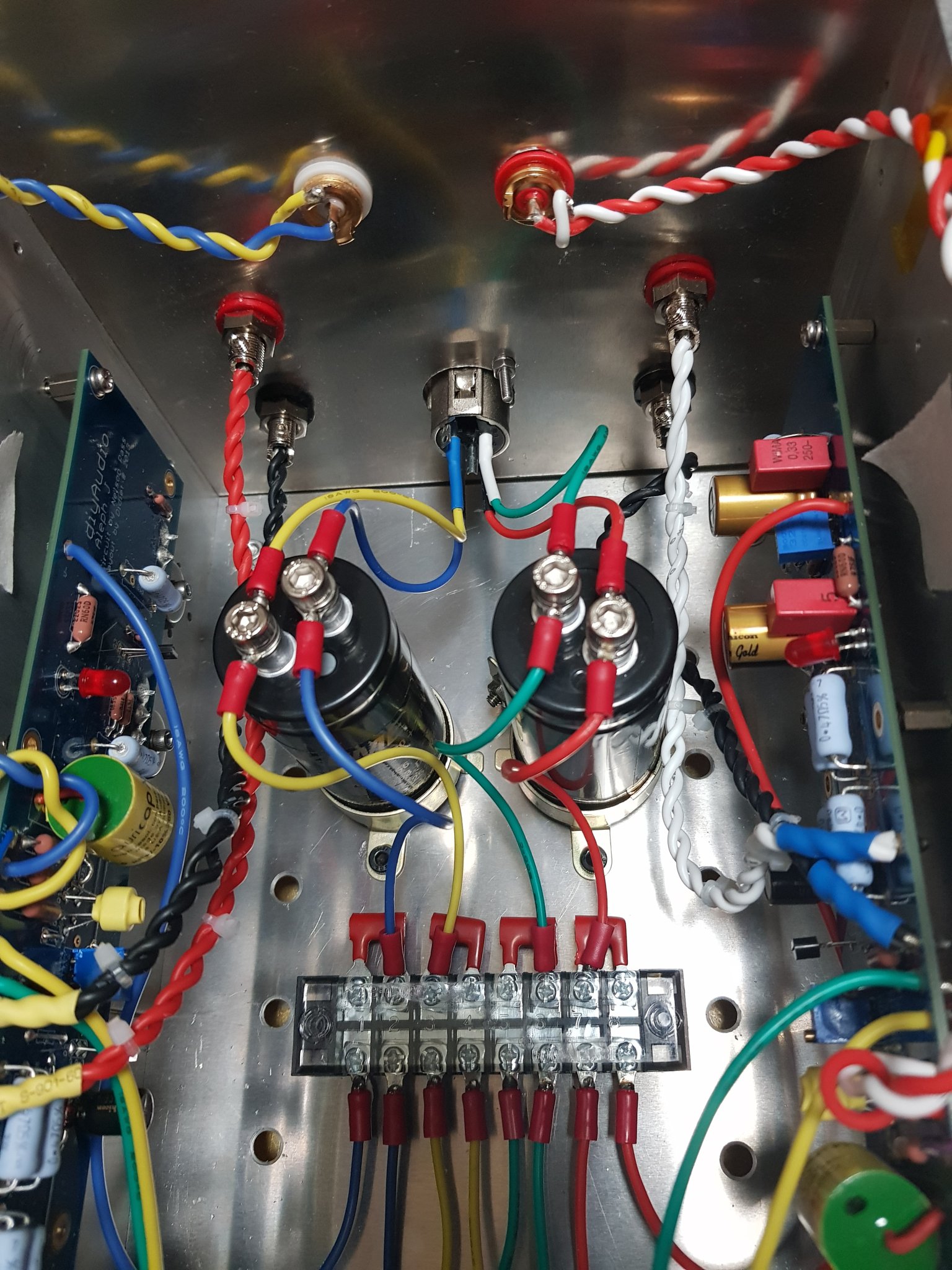

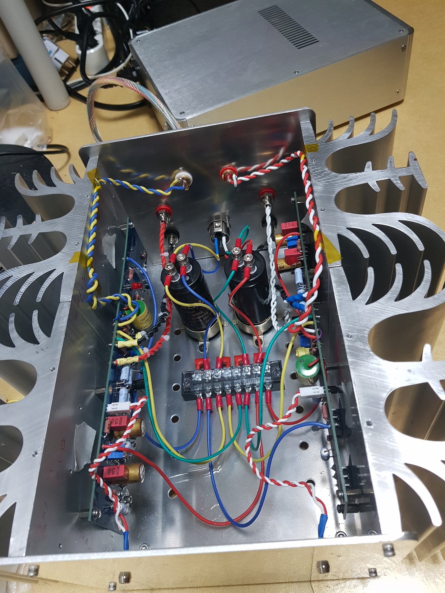

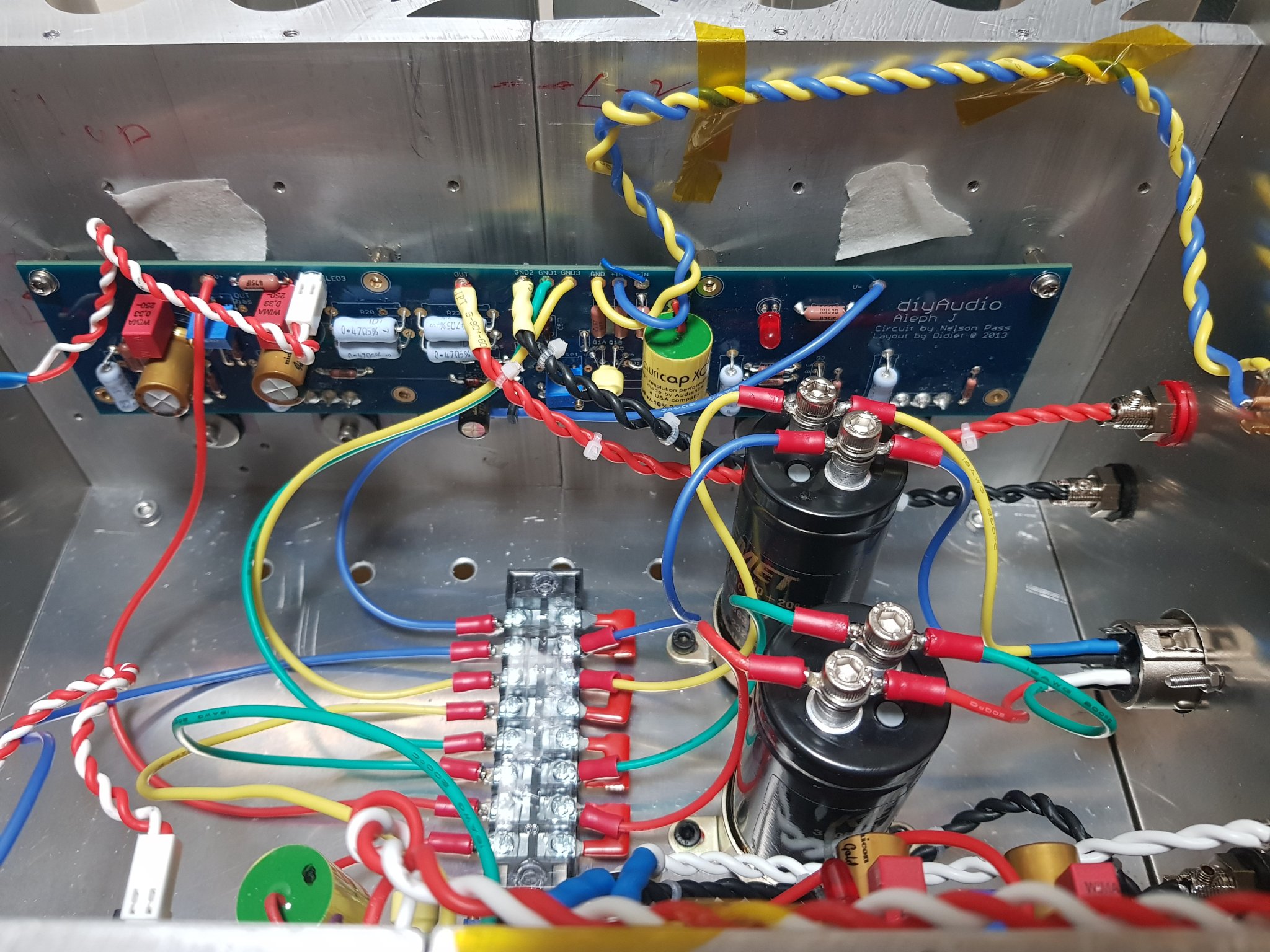

I've added extra capacitors bank (Kemet 40V 36000uf).
The Kemet 40V 36000uf has mounting stud(?) then I've cut it.
The power rail was +/- 24.2VDC before.
It is +/-22VDC now. I don't know why extra capacitors drop the power rail voltage.
The turn-off-sound seems to be 'normal'.

Wow, nice work. I see you're using the Auricap XO for coupling. I had these as well, and ended up switching to Clarity cap CMR from pCx. Recommended highly, what a difference.
Joined 2012
namghiwook,
I do not have any capacitance multiplier supplies in my amplifiers (I use CLC) but the voltage drop seems strange. I assume you have not made any changes to the power supply.
You can check to see if it is the capacitors that are causing the voltage drop by temporarily taking the capacitors out of the circuit. It looks like the yellow and green wires to and from the capacitors are the ground wires so they can stay in place. To take the capacitors out of the circuit disconnect the two red wires (V+?) from the capacitor and connect the ends together with a screw and nut, and disconnect the two blue wires (V-?) from the capacitor and connect the ends together with a screw and nut. Wrap exposed connections in electrical tape if there is a chance that they may come into contact with anything.
Assuming I identified the wires correctly the capacitors are now out of the circuit and you can power up and measure the voltage without the capacitors in place.
