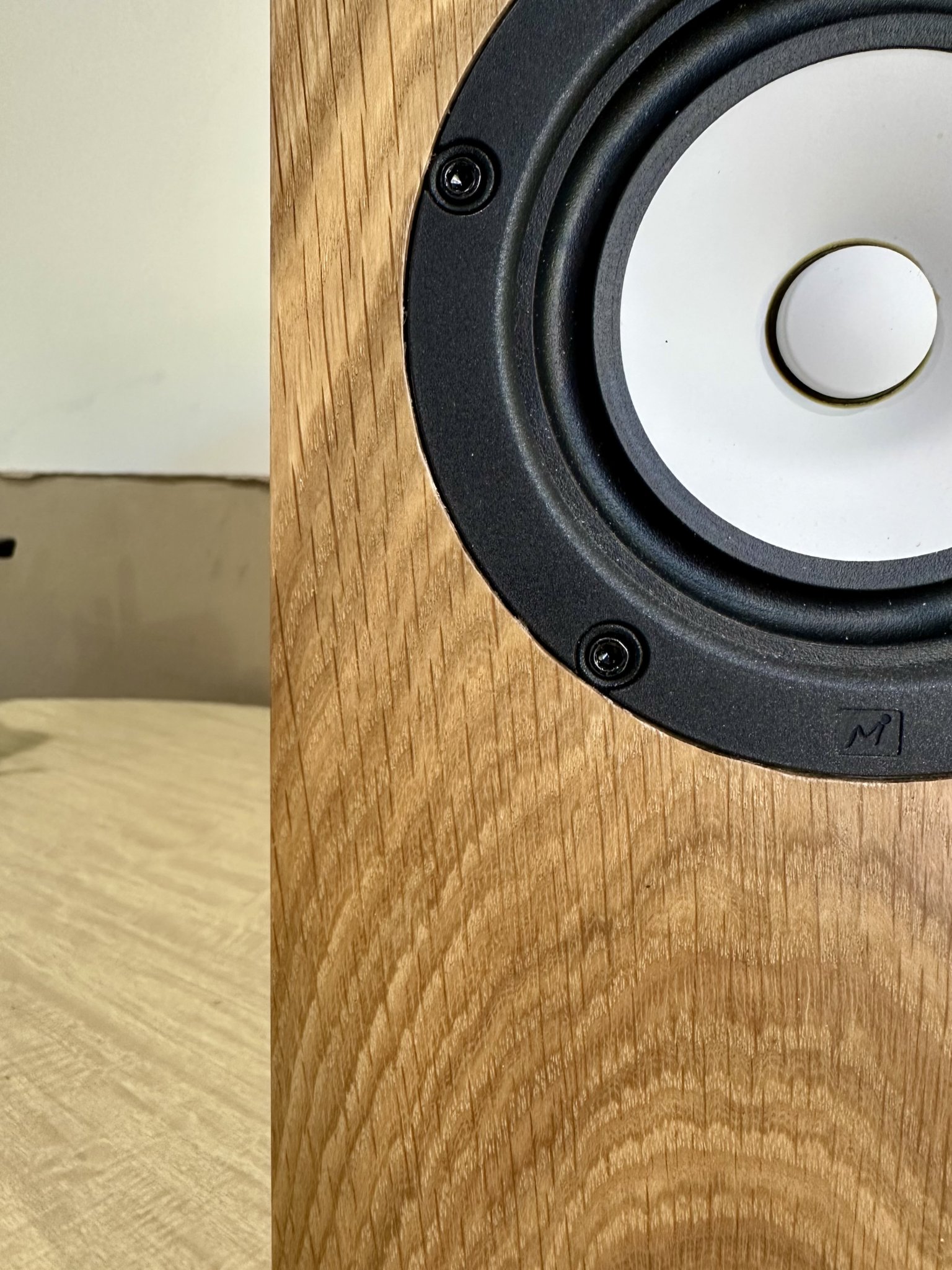

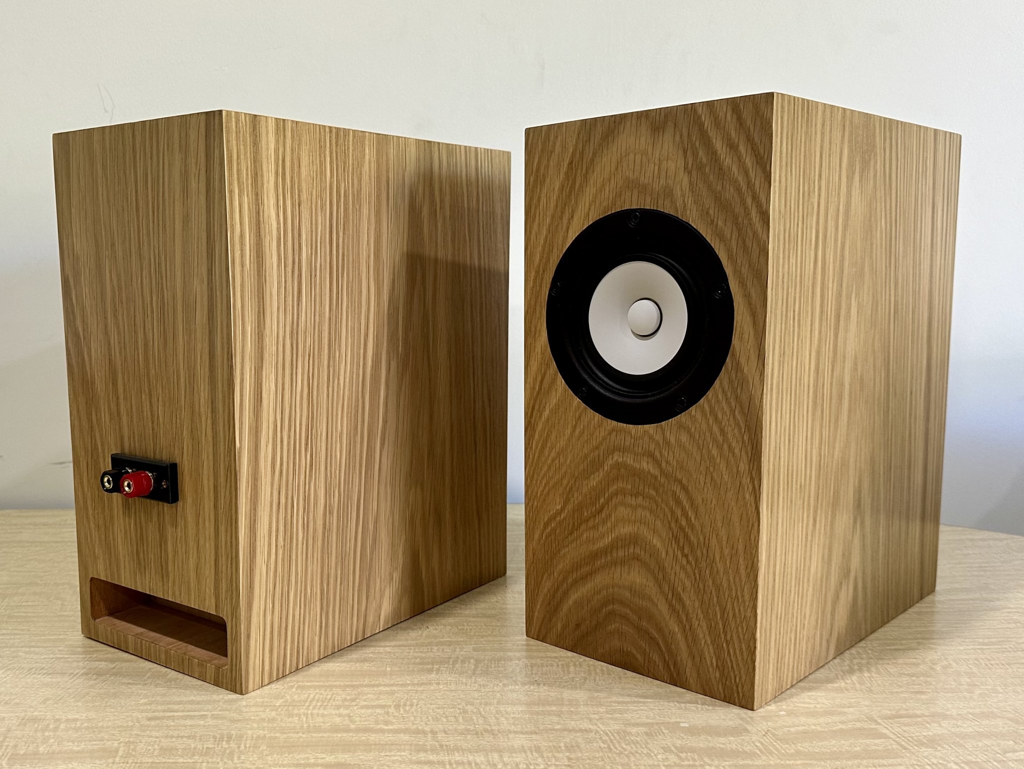

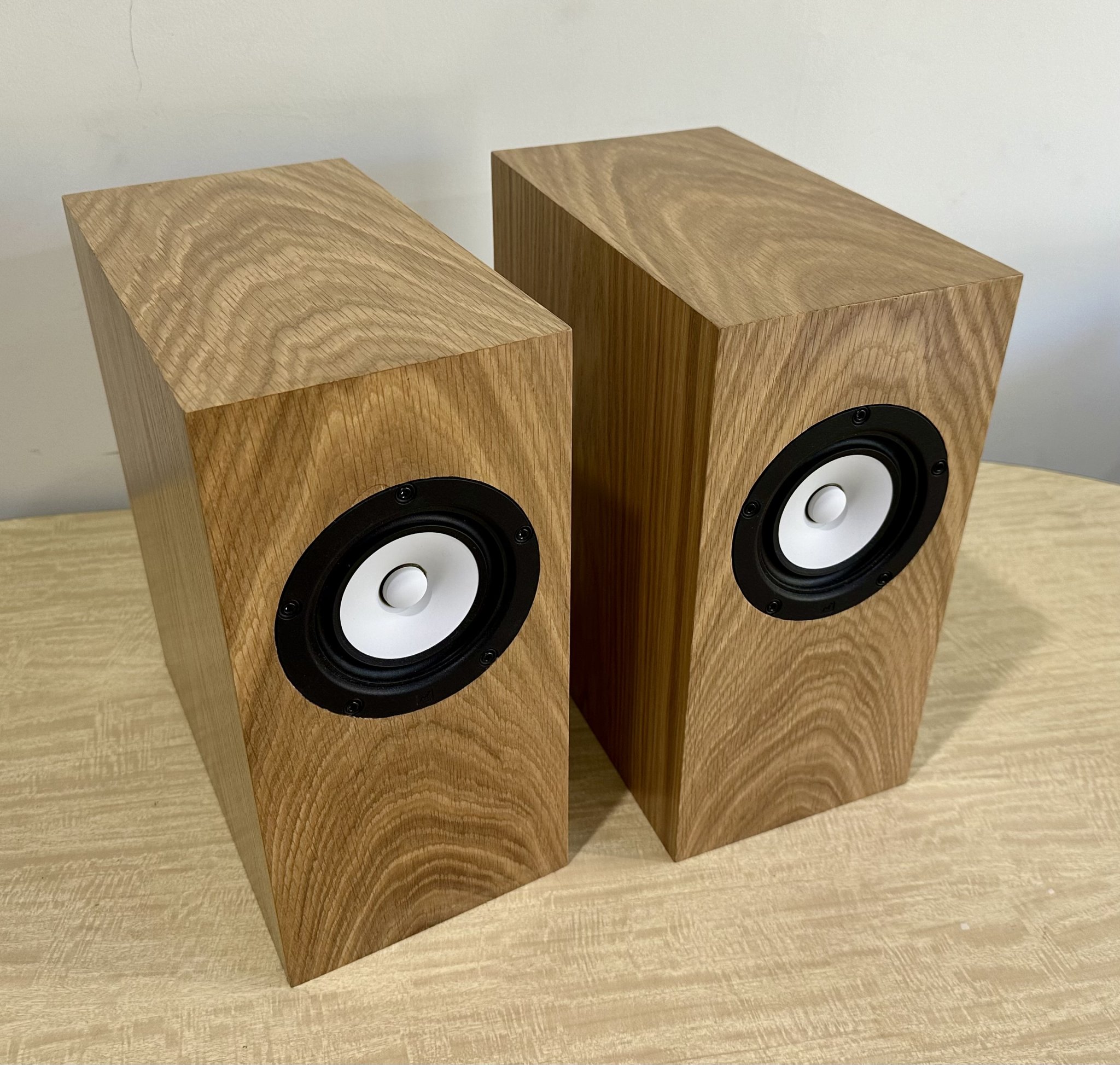

Thanks, definitely a satisfying project.Nice work! Do you have more build pics? Did you only use glue or screws as well? Is the back of the speaker veneered as well? How did you apply the veneer with the speaker terminals attached?
1. Only glued, used PVA and clamped tightly, there’s a couple of more pcs here. Might go with a stronger polyurethane next time, but fine as is on these little guys. Cabinet timber is 12mm 7 ply.
https://www.diyaudio.com/community/...e-between-maop-7-maop-11.388552/#post-7174934
2. Back done as well, didn’t bother with the base though.
3. Unsoldered the terminals to do the back. Not much room to get fingers in the slot, so closer placement of the terminals would have been less fiddly to get the cables back out. Manageable with a bit of inventiveness. Dremel to open out and sand the front and rear veneer once glued in place.

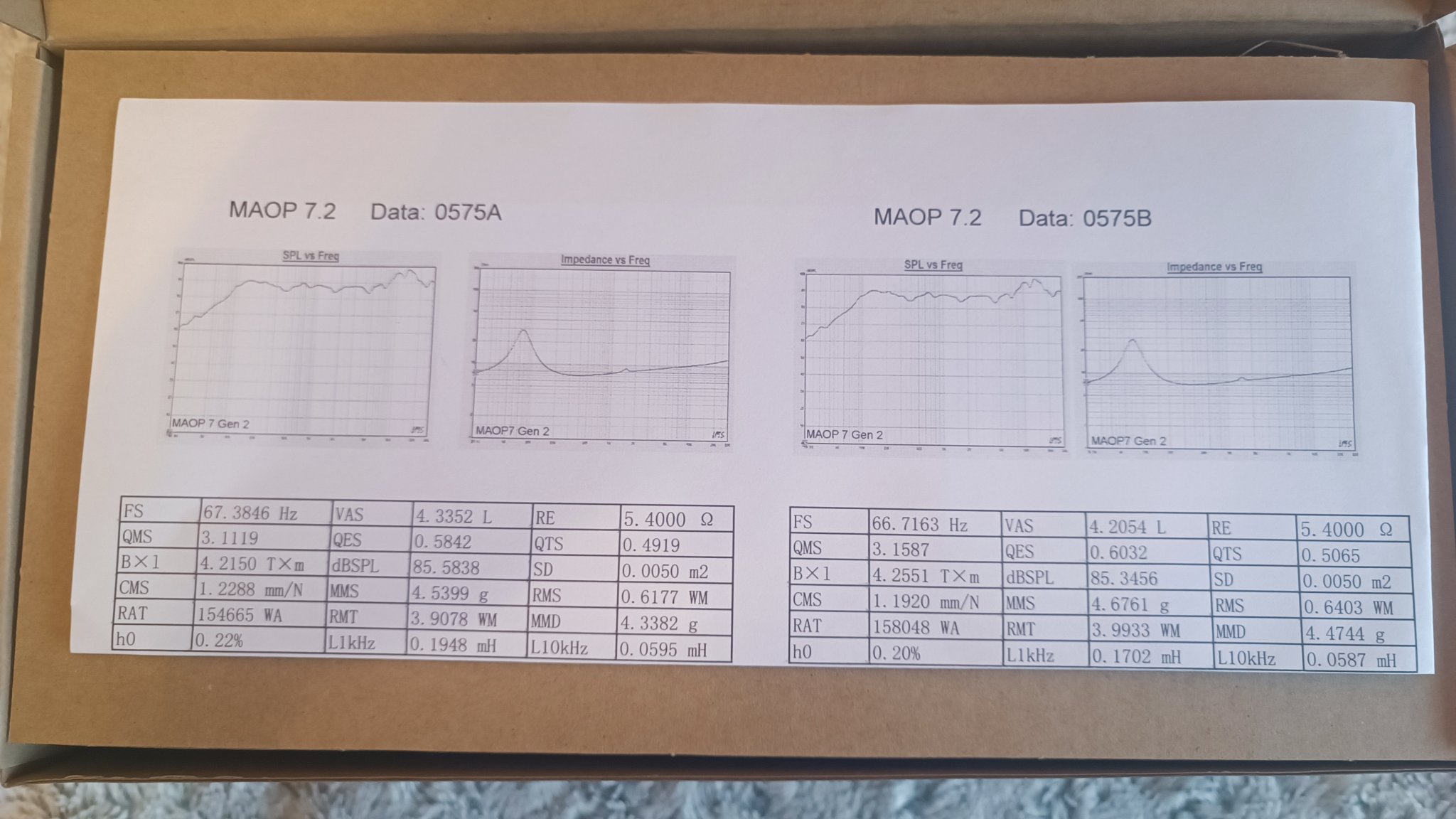

but i would like to double check from the supplied T/S data. Can you post that info?
Here are mine:
