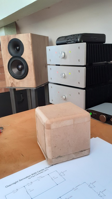

See the pic?
See the cube?
That is a 100mm cube.
Made from offcuts of 19mm / 0.75" MDF. Hollow but sealed.
5 minutes on the saw to trim the offcuts to size.
5 minutes to glue it together.
5 minutes to route the edges.
A dime's worth of glue and a nickel's of electricity.
What's it for?
Nothing!
Other than it makes me smile.
It's whimsical!
It sits on my desk and when I am thinking about something I may roll it around in my hands. It's quite nicely tactile.
If you can't comprehend any of the above then you will just have to accept that we are very different people!
One person's 'common sense' is just sterile, boring, conformity to another!
And yes, I'm weird. I made my peace with that many years ago!
I am comfortably retired after a career in IT fully embracing my weirdness, so it can't be all bad!

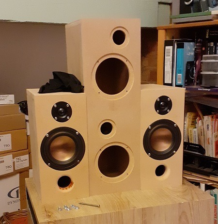

I have made a start on some Overnight Sensations.
The two stacked in the middle are standard sized OSs intended as the rears and are ready for drivers (which I have) and crossovers (which I don't). It's complicated, involving VAT, Brexit and SoundImports (who I can recommend for buying the components)...
The flanking two are complete. They are electrically and volumetrically the same as standard OSs but an inch narrower and front ported. They will be the fronts and be positioned one either side of the TV on a new frame I need to weld together! I did run the idea of them past Paul Carmody but didn't get a response. Make of that what you will! That is not a slight on Paul: he was very helpful with a T20 tweeter/crossover question I had.
I have only tested them on my chipamp office music setup replacing the C-Notes for a few days. They sound very nice playing music but they are noticably less efficient than the C-Notes, evidenced by the sub that is part of the system needing turning down to restore the correct balance. Having said that they sound very musical and enjoyable even without the sub operating!
