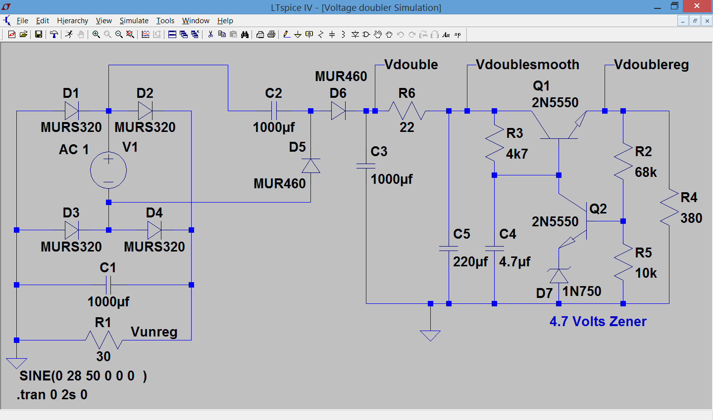

Adding and simulating a voltage doubler and regulator.
We can begin to eleborate on the simple PSU. Here is the design brief. We are making a simple amplifier but would like to run the VAS stages and front end from a stabilised and smoothed rail. The main rail is around 28 volts DC (off load) and our target for the auxiliary rail is +40 volts DC. How do we do it ? and can we simulate it ?

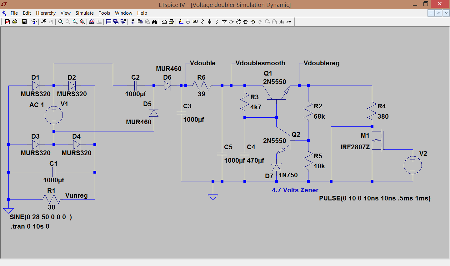

Taking our simple PSU above as a base we can now add to it. I've moved the load resistor to the bottom to clear screen space and tidy things up. The regulator is going to be a classic text book two transistor design.
For those that want to try and create this, here is the circuit diagram. For those that want to skip that and just simulate it, the file is attached to this post.

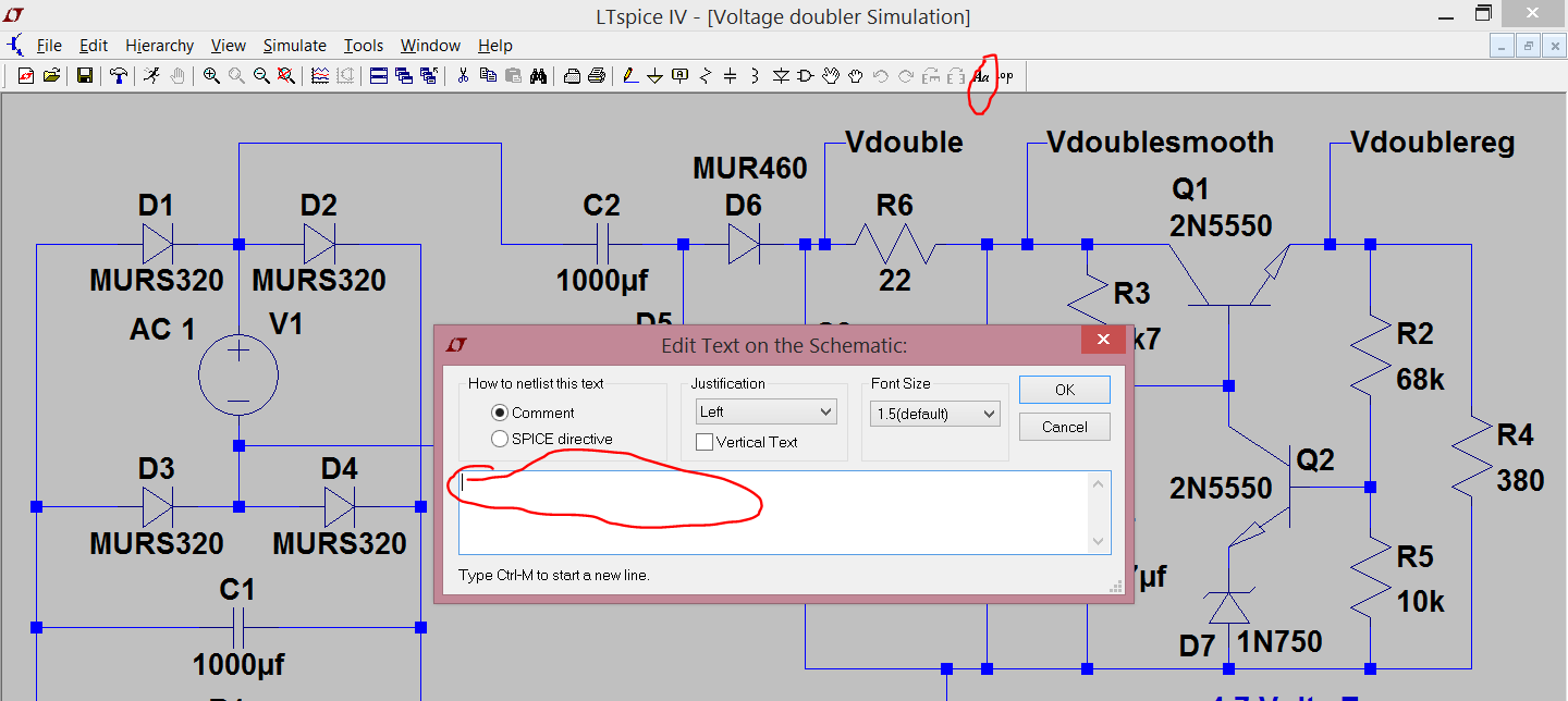

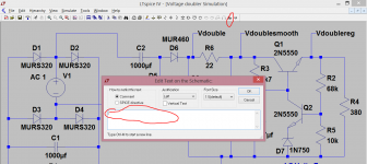

Notice there are four "net" labels attached to relevant points in the diagram. These will be used to make looking at the 'scope traces more understandable. The 1N750 zener is in LT's library. To place a zener on the diagram open the "component" library as we have done before and look for "zener". Right click the finally placed device and select 1N750 from the list. The blue text saying "4.7 Volts Zener" is a user added note. You can add any text by using the .Aa option. The other options and drop downs in the Window are self explanatory.

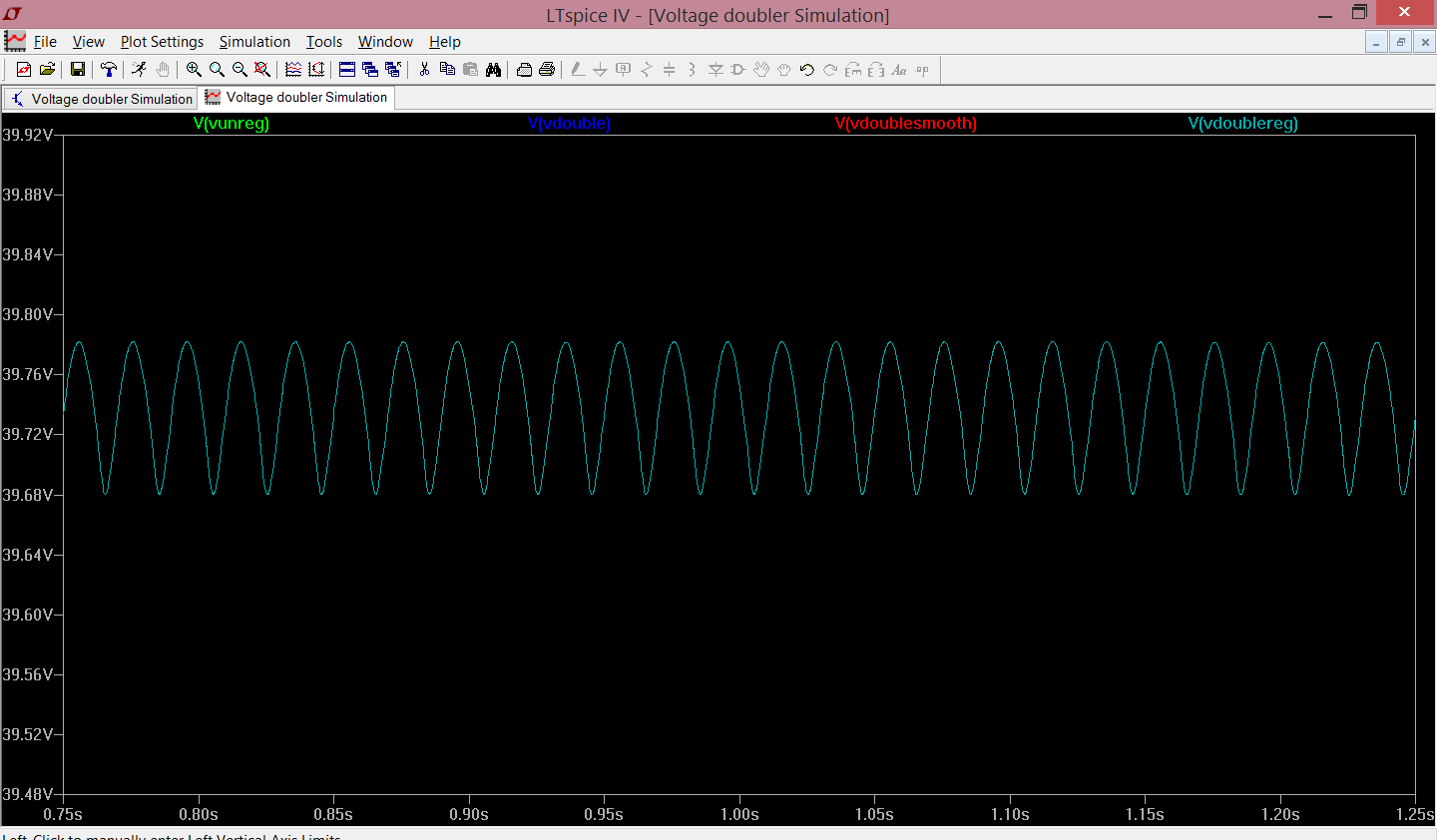

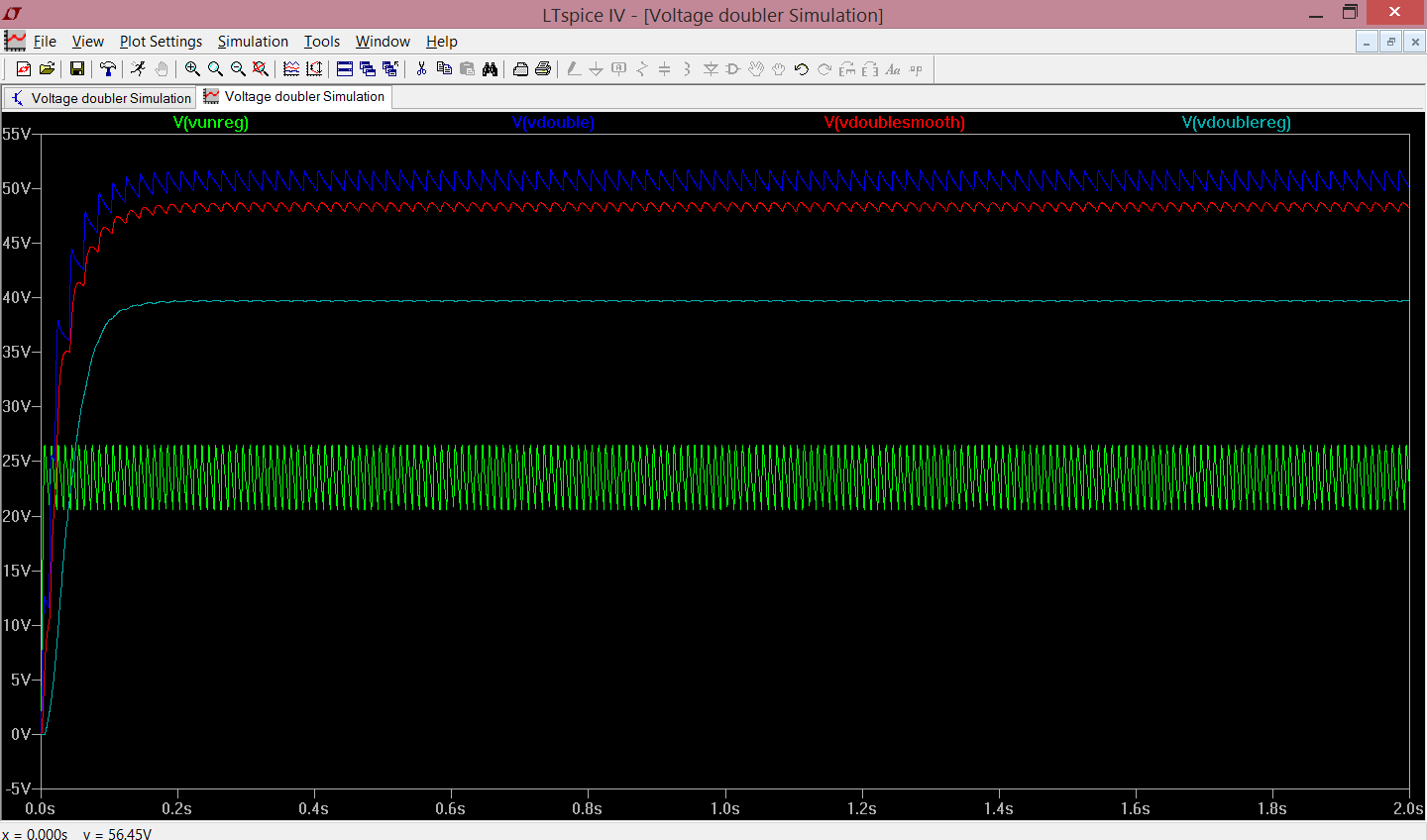

Make sure your simulation time is set to say 2 seconds and run the simulation. Probe in sequence the four points of interest. You should see this.
The traces show the ripple on the various points and the reasonably clean +40 volts (this isn't as much an exercise in best circuit design as showing how to build a circuit up and simulate it). As before, this is a dynamic simulation and all the voltages and currents must be probed rather than seeing them as steady state values (remember... the .op or DCop pnt command is no good for dynamic simulations like this). You can zoom in on any part of the traces... so look at just the ripple of the regulated output.

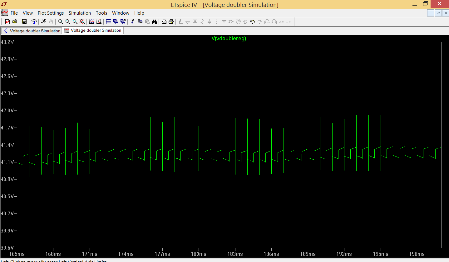

It looks like this.

Hi Andrew,
I think you are seeing more of a limitation of the way LT (and the PC ?) handles the graphics. Pictures 3 and 4 are from the same run. Picture 4 just zooms in on a specific part of the trace to highlight the ripple more accurately.
If you run the attached file in that post and probe the four marked output tags in sequence and then zoom into the regulated output you will see the same. Nothing changes, only the effect of the way LT handles zooming in.
Looks like you are confirming that the remaining ripple is just as good as this version of the regulator can achieve with this level of ripple on the input.
Not a glitch due to drop out.
I think this does show that voltage doubling and even more so with tripling and quadrupling, creates a very ripply supply. Here with rCRC on the input, ripple still comes through on the output.
Use the sim to model and compare non doubled to doubled and tripled and quadrupled rectifiers.

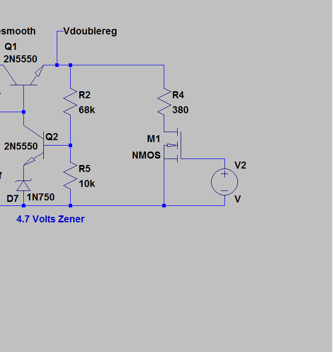

Testing under load. Here is a quick and easy way. We can use a FET to switch the load across the supply to check how well the regulator functions. We can also modulate that switching function to test the dynamics of the regulator.
You will need to zoom out the circuit slightly to make room for the extra part... yes we only need one. Go to the component library and add an NMOS transistor. Now connect a second voltage source between gate and source as shown. Use the scissors and the "hand" to cut the load resistor and re attach it as shown.

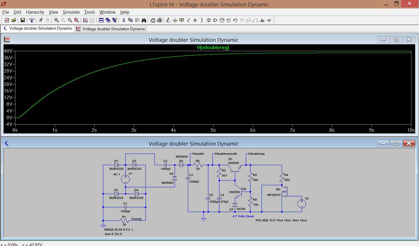

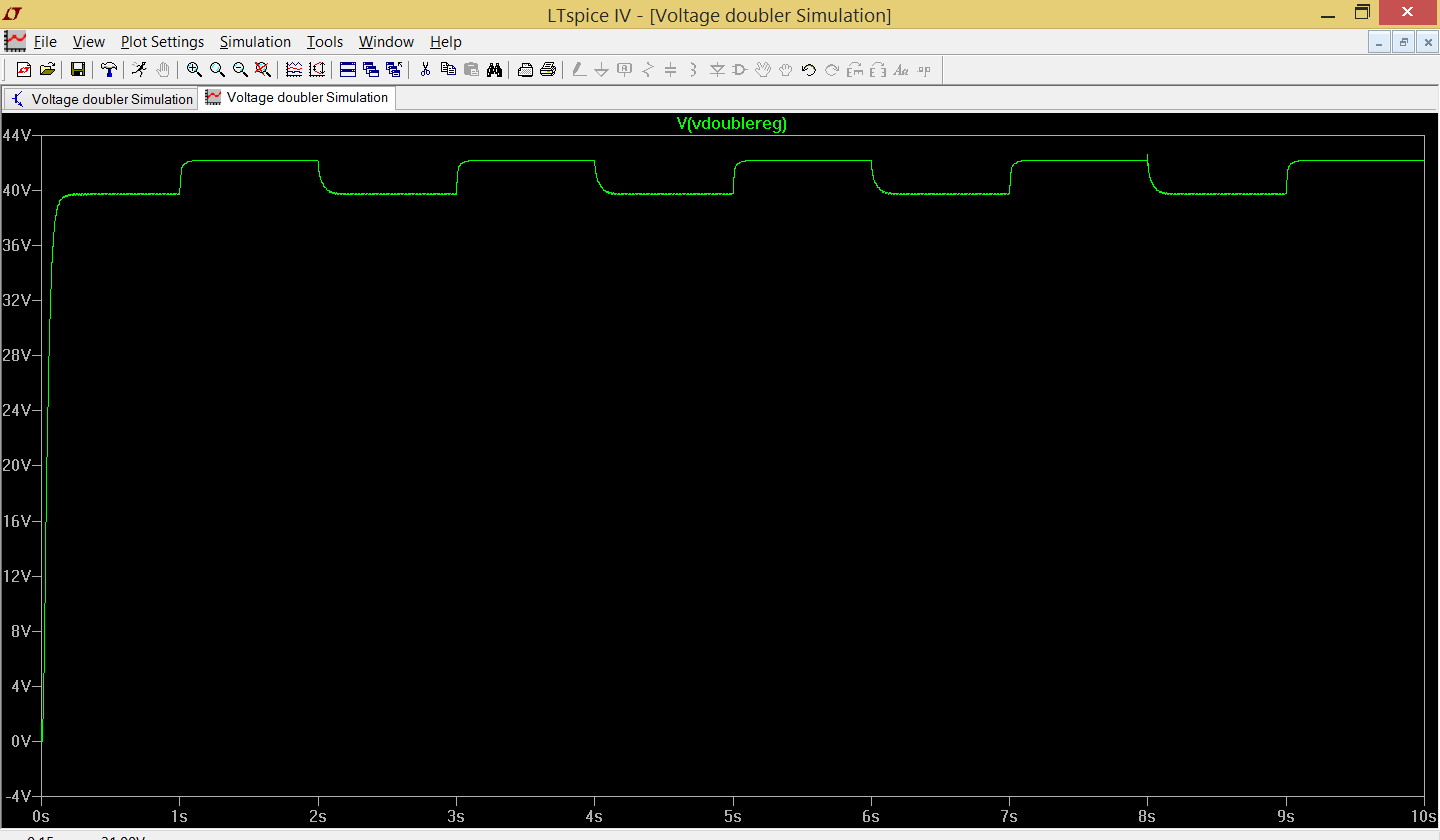

Right click the transistor and select a suitable device. I'm using the IRF2807Z as a typical low Rds device. Now make the voltage source you just added into a pulse. Lets set it for a 2 second period. Now alter the <edit simulation> to give a longer run time of 10 seconds so that we can see more of what is going on.
We can see that the regulator isn't brilliant... and that is one for you to work on and improve :)

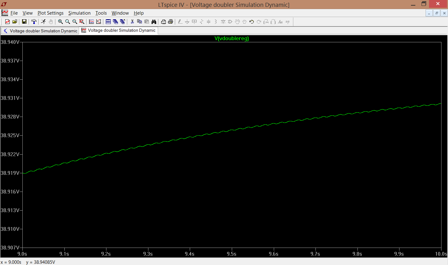

Now change the voltage source to a 1ms pulse (Ton = 0.5ms and TPeriod = 1ms) Change the stop time to just 200ms now, otherwise you will be waiting all day for it. For the amplitude... well as its a FET we are controlling a 0 to 10 volts setting shouldbe ideal. Run the sim again.
Now zoom in on the last few millisconds and look at the detail. You can see the hf ripple (our FET modulating the output) combined with the ripple we had before.
