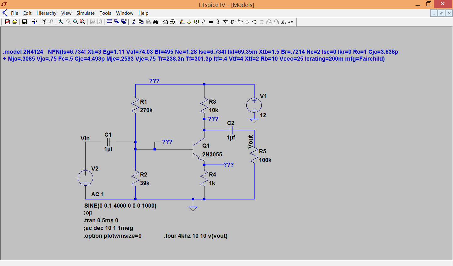

So what does a "model" look like and how do we use it. Here is a typical example that I've lifted from the attached file (just copy and paste).
.model 2N4124 NPN(Is=6.734f Xti=3 Eg=1.11 Vaf=74.03 Bf=495 Ne=1.28 Ise=6.734f Ikf=69.35m Xtb=1.5 Br=.7214 Nc=2 Isc=0 Ikr=0 Rc=1 Cjc=3.638p
+ Mjc=.3085 Vjc=.75 Fc=.5 Cje=4.493p Mje=.2593 Vje=.75 Tr=238.3n Tf=301.3p Itf=.4 Vtf=4 Xtf=2 Rb=10 Vceo=25 Icrating=200m mfg=Fairchild)

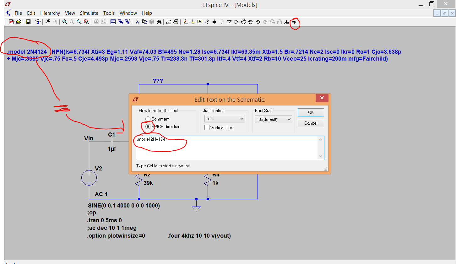

One method is just "include" the file within the simulation as follows.

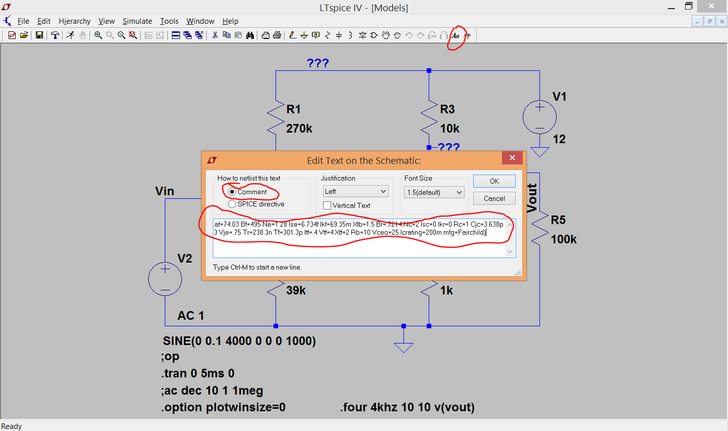

1/ Open the simulation file you want to include that device into.
2/ Copy and paste the full model details onto the diagram using the "text" Spice directive.
Don't worry if some of the text seems missing... it will all be there when you drop it onto the diagram.

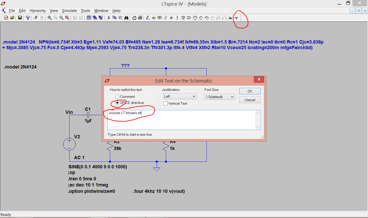

Now we have to instruct LT to be able to use that model and we do that using a very specific command of .model (dot model)
3/ Using the add spice directive command (top right on the toolbar) enter .model 2N4124 (the model name must match the name of the included model that you copied onto the diagram.

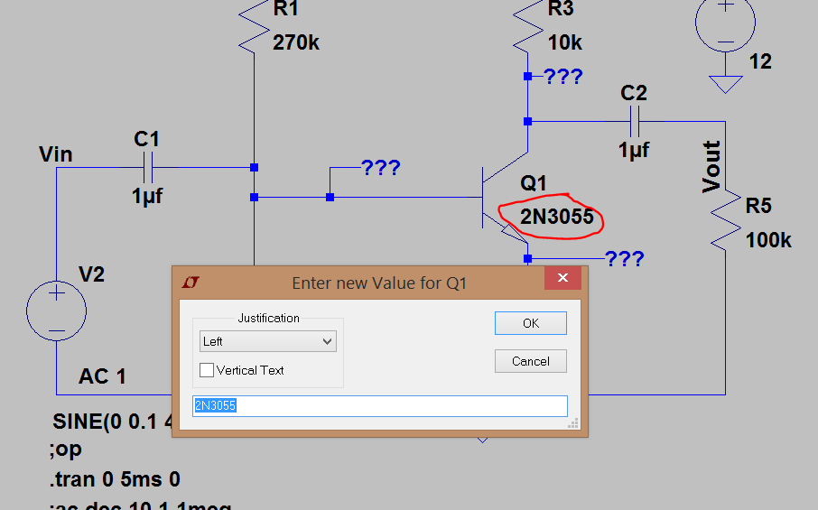

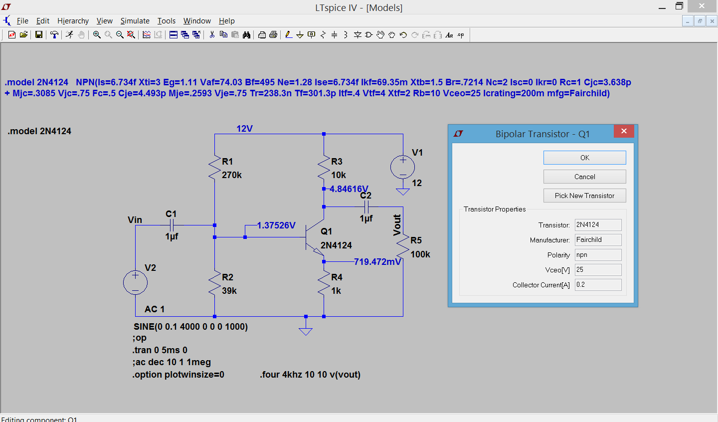

4/ You can now right click the old devices type number (2N3055 in this case) and enter a new value of 2N4124 Remember you are right clicking the text that says 2N3055 and not the transistor itself.
5/ Having done that, the simulation should run using the included model and if you now right click the transistor itself you will see details such as Fairchild and a Vce value, all put in from the model details we included.

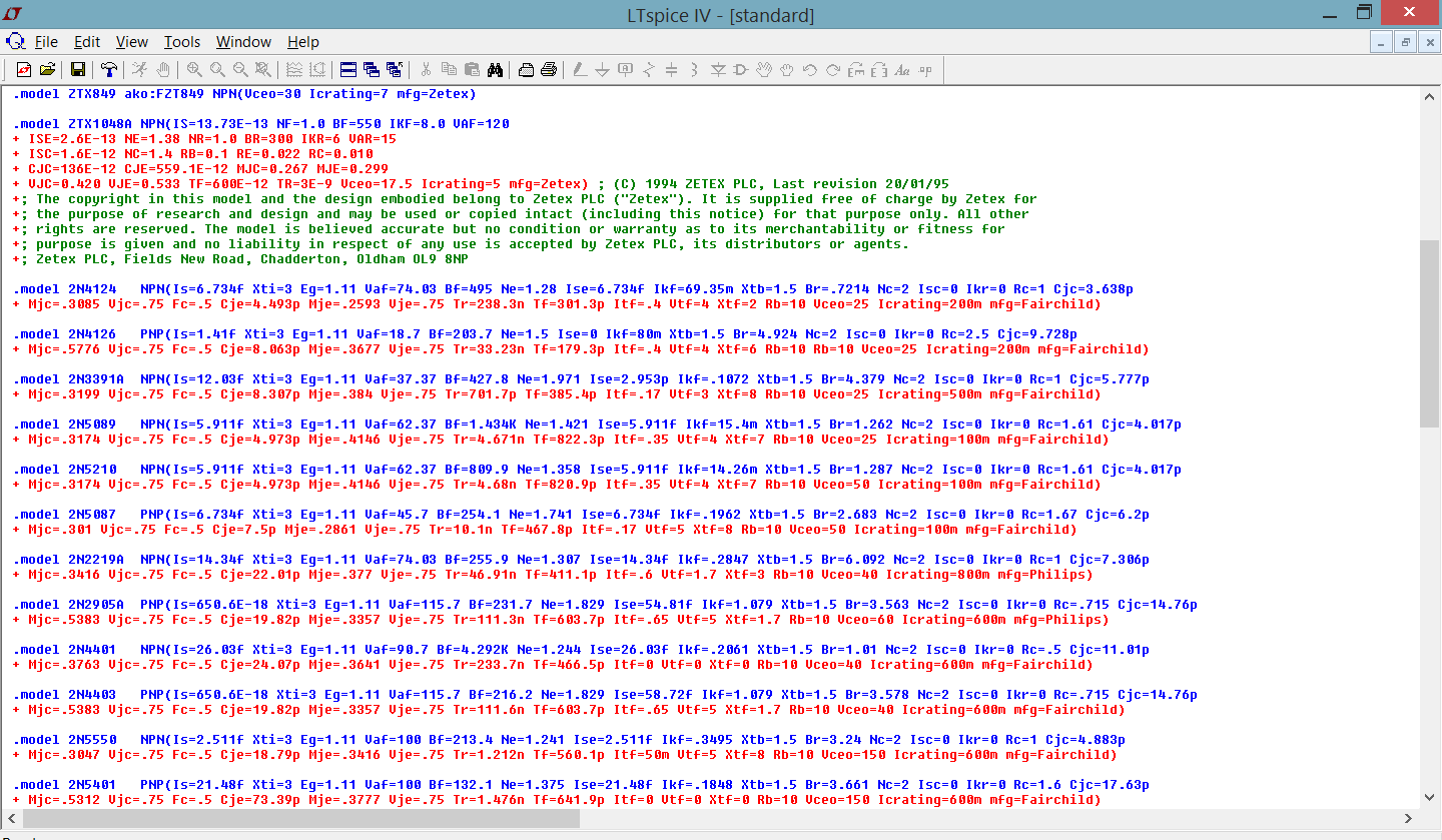

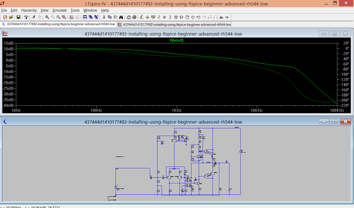

So the next method (and my preferred one) is to simply include the models as notepad files with the simulation file. For this to work, the notepad file of the models must be kept in the same folder or directory as the simulation file you wish to use it on.
Lets try it with the attached notepad file of all those models.
1/ Place the LT simulation file and the notepad file into the same folder on your PC. Hint... you can copy and paste the whole models file and drop it into as many separate folders containing simulations as you wish.
2/ Look carefully at the name of the notepad file. It doesn't matter what you call it but you must now enter that exact name onto the simulation. I called it simply LT Models. So again, using the "add spice directive" command (top right toolbar) we now add the following specific instruction,
.include LT Models.txt
Notice how the name MUST match the name of your file and how it also includes the .txt designator.
Having done that you now right click the devices type number on the diagram and enter a device from the LT Models file. I skimmed through it and picked totally at random the BUX47A. When you run the simulation it should all work using that devices model that it extracts from the whole notepad file of hundreds of models.

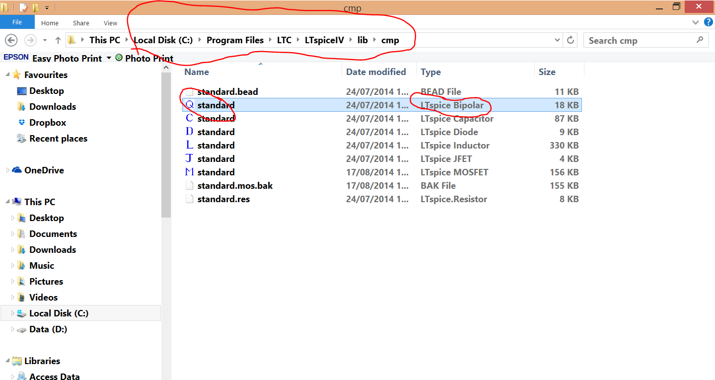

That is probably my preferred method of including a model but there is another way. Remember back at the start when we were installing and confiuring LT and how we looked at where on your PC where it resided. Well we could add models directly to the program files used by LT but I'm uneasy doing this because when LT updates there is no guarantee that your added files won't get over written and lost. Whether this actually happens or not I can't confirm but its something I've seen mentioned.
For those that are interested though, navigate to C:\program files on your PC and look in the LTC folder. Click through the folder and you will see one called "lib" or library. Click it and look for the "cmp" or component entry for bipolar devices. If you open it you will see all the models available to LT as standard. These are the ones that appear as available devices when you right click a transistor.
You will see that there is nothing stopping you altering or adding to the lists of parts to make devices available automatically from within LT.
However, I personally DO NOT RECOMMEND you go down that route.

OK... I adjusted the filename, put it in the same dir as the .asc but still LTspice does not do what I want it to...Seems to work OK.
Rename your text file to something shorter. I used Model 1
Then add Spice directive .include Model 1.txt And keep both files in the same folder.

You should be right clicking the transistor type (the text of the device), not the transistor itself. If that is what you mean.
If you look at my pictures in my earlier posts, if I right click the 2N3055 text I get this where I can then type the new device number in.
