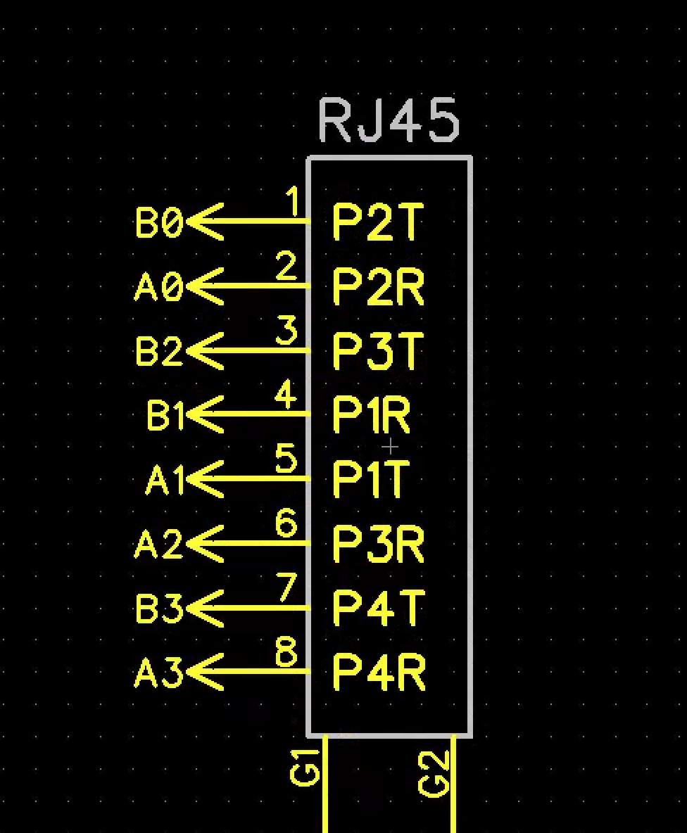

I notice there was some talk about inverted clock signals and their effect on locking in one of the threads. Are the "A" connections or the "B" connections inverted polarity? Im working with a third party designing an audio bridge and the LVDS driver is being adapted from an HDMI connection and I want to insure complete compatibility with the Teleport receivers.

In any case lets ask it another way. If I am going to tap LVDS signals from an HDMI output connection instead of using a teleporter for the transmit side, I want to insure that I don't mix up the positive polarity signal with the inverted half of the differential signal. I assume but would like to verify that the A0,A1,A2,A3 LVDS pads are all positive polarity after reception and conversion back into I2s. The B0,B1,B2,and B3 are carrying the inverted signals. It is precisely because you have it right that I don't want to mess it up.
Here's the RJ45 pin mapping...
