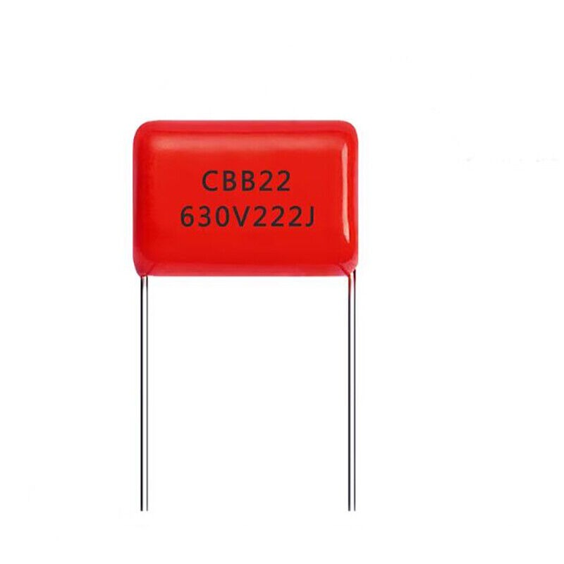

CBBs are metallized polyprops seen everywhere on ebay. I think "orange drops" used in guitar amps are of this type too. I use them in non-signal applications, like snubbers and in regulators.

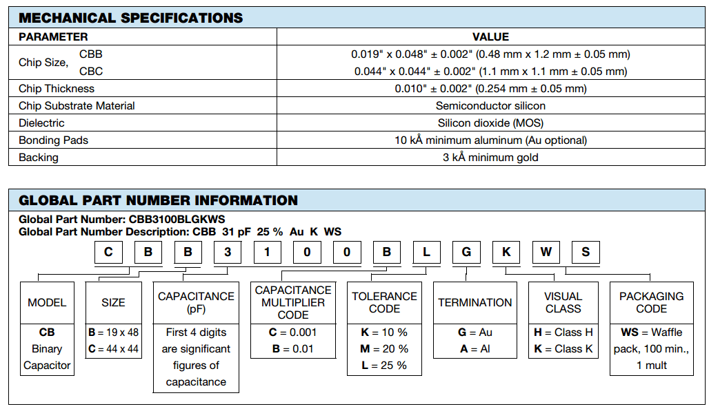

This is from https://medium.com/@mia.pinge/the-difference-between-cbb-capacitor-and-cl-capacitor-2b63250eecfdI still wonder what the letters stand for.
The ever popular 715 and 716 series polypropylene capacitors (i.e. "Orange Drops") are technically CBB capacitors.Conventional film capacitors are generally classified into metallized polyester films and metallized polypropylene films depending on their materials. The polyester film capacitor is also called CL capacitor & MER capacitor; polypropylene film capacitor is called CBB capacitor & MPR capacitor.

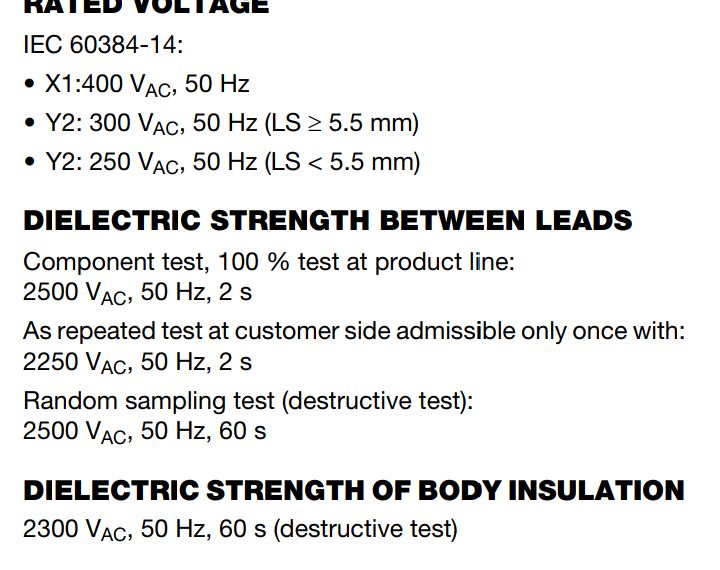

Forget mild work inside amplifiers, they are connected to Mains lines where lightning can (and does) hit transmission lines regularly
As in many times during any electrical storm.
Protection devices (spark gaps, high power varistors) limit that to 1000 or 1500V peaks at user lines, but anyway ...
Plus motors are very inductive and "sparky", again generating large peaks.
So any "250VAC" rated capacitor does NOT mean just the sinewave peak 300 something Volts but a MUCH higher peak value.
By heart I remember they were tested at 1600VDC or so but apparently modern test rating is even higher.
Test voltages are mind boggling:
WAY above 250VAC peak value (354VDC) as imagined above.
Industrial/machinery World is very different from HiFi needs and ratings
