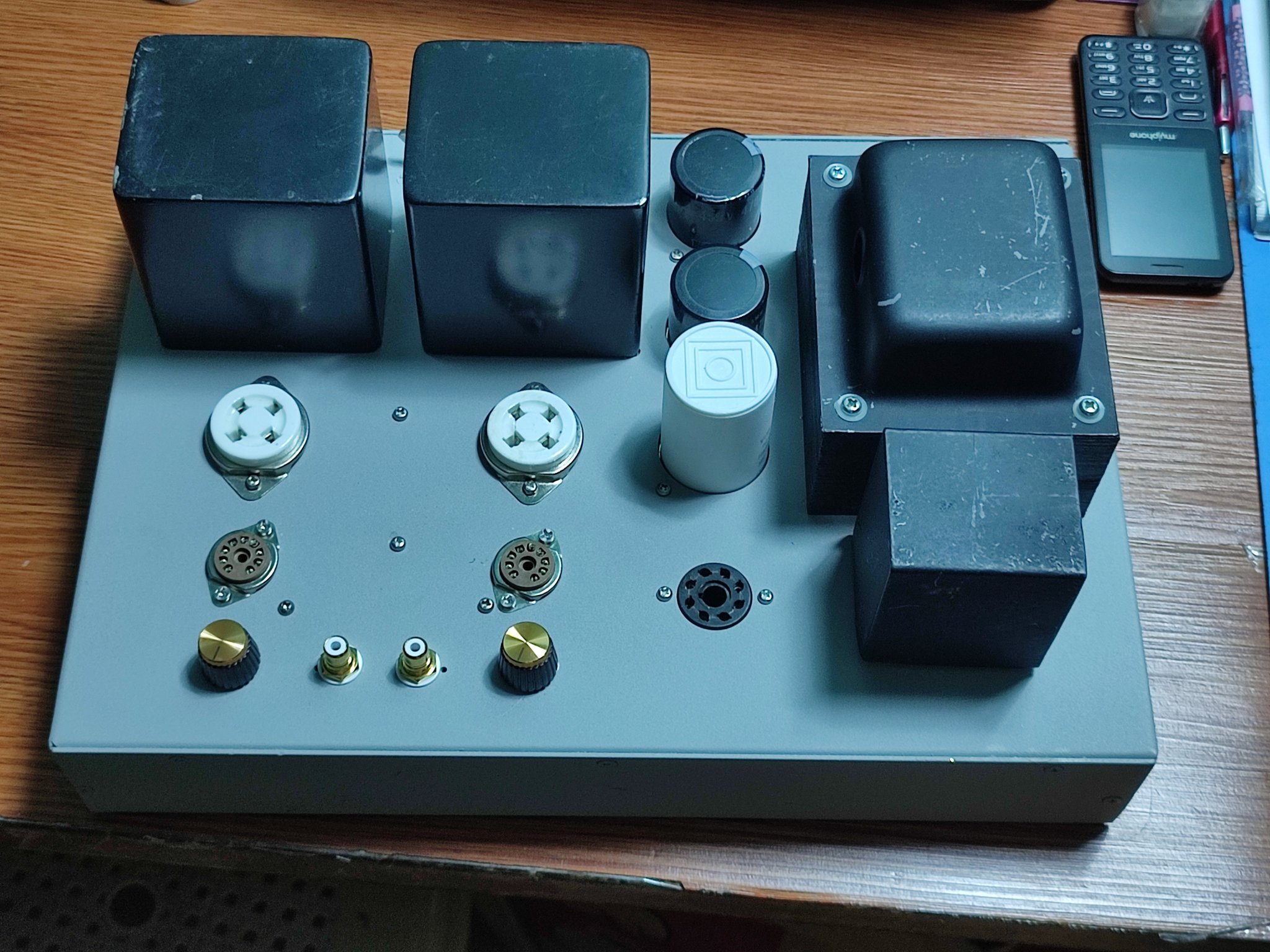

CBB62 in a 2A3 set psu.......
several years apart, very noticeable is the the volumetric efficiency attained over the years...the first one is a GE 40ufd, the other one is a cbb62 with 60ufd....
