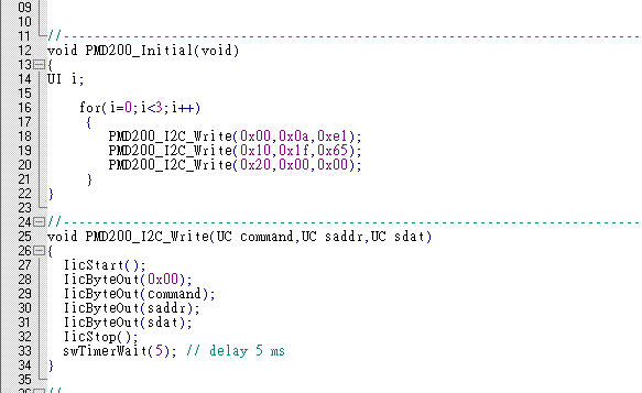

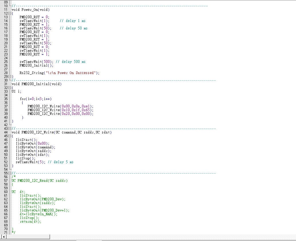

When I used 8051 and IIC to initialize PMD200 in the past two days, data writing failures often occurred. After carefully reading some of the discussions and pictures you posted before it finally led me to figure out the reason for the IIC write failure. I think PMD200 must delay some time after writing the command before writing the next command. My current approach is to delay 5ms between two commands In addition, the speed of IIC should not be the problem. I am currently using a speed of about 130KHz to write command to PMD200. I only initialize the PMD200 three times in a row now, and the 9 commands written almost never have non-ACK problems. Although the PMD200 still has some work to do, such as rewritting the command when sampling rate changing, the most exciting thing is that it took me less than a day to solve the PMD200 initialization problem.

Yes, I only intercepted the more important parts, because the other code has nothing to do with PMD200. I have rearranged all the code related to PMD200 as follows. The control method is the same: do RESET three times first and then write the command. The difference is only that after writing the command, there will be a delay of 5ms before writing the next command. I add the delay between the two commands because the PMD200 itself is a DSP, It may take some time to complete the internal settings after receiving the command. I occasionally encounter similar situations in my work. After all, the company no longer exists and I can only guess at how it works.
Thank you, got it! You just used a different i2c library plus your own code plus different input settings for the PMD200. But obviously you didn't follow this advice:
If every command is separated by a delay of 5ms: is it still necessary to send the output settings before the input settings?the output settings have to be in place before the input settings are sent. If you send the output settings first, the input syncs itself to the right output settings.
