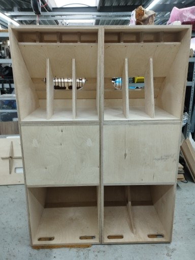

Yes, Cubo kick 15 is wider than TH18 in the original plans.
Look for posts by user 'jo bg' in this thread and on Speaker Plans forum.
Jo bg contacted Cubo to ask if the Cubo kick could be reduced in width to match the TH18. Then they can be stacked neatly like this. Cubo said yes, but the crossover frequency should be raised a little bit.
Jo BG posted that they are extremely happy with the results, so basically I copied their idea

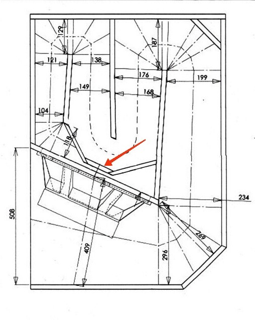

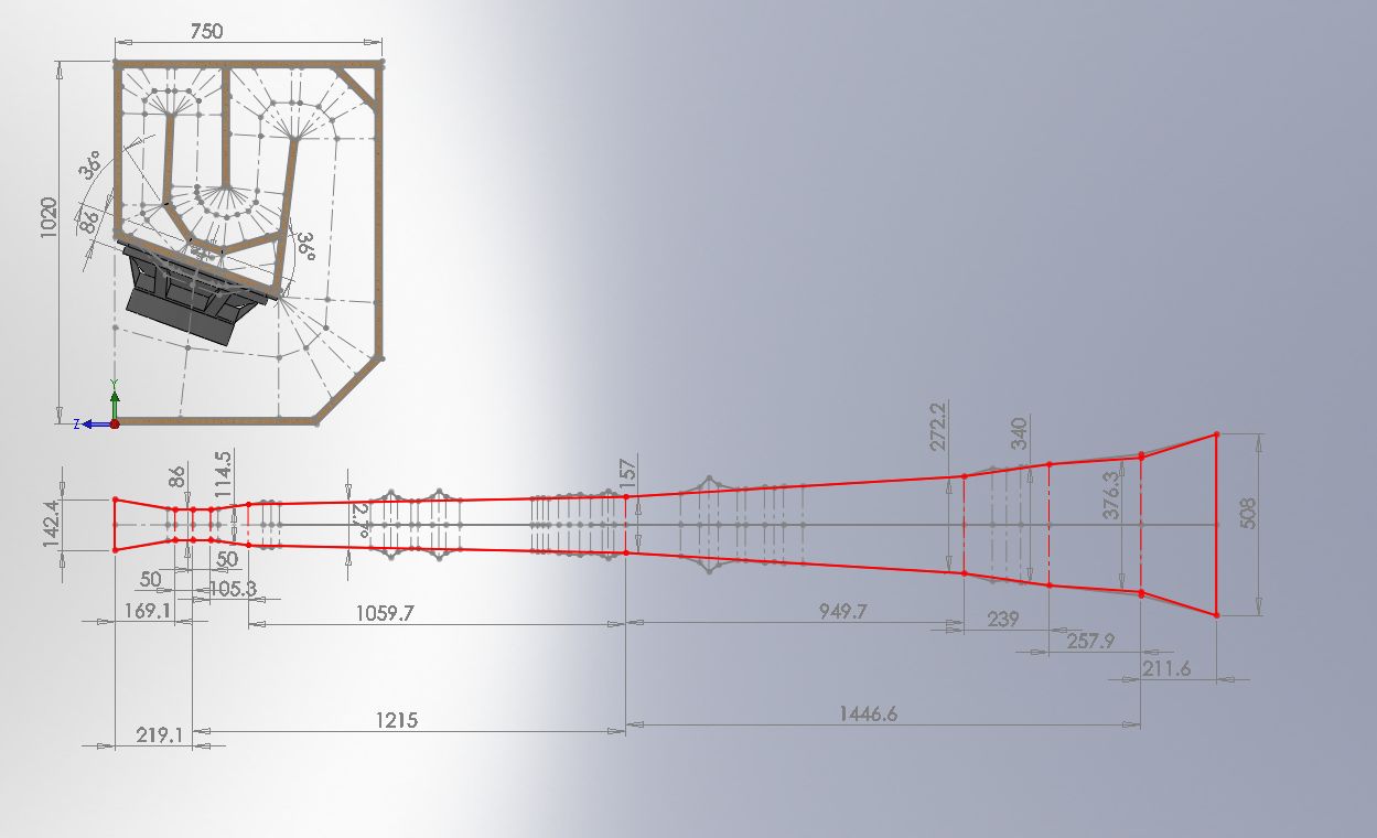

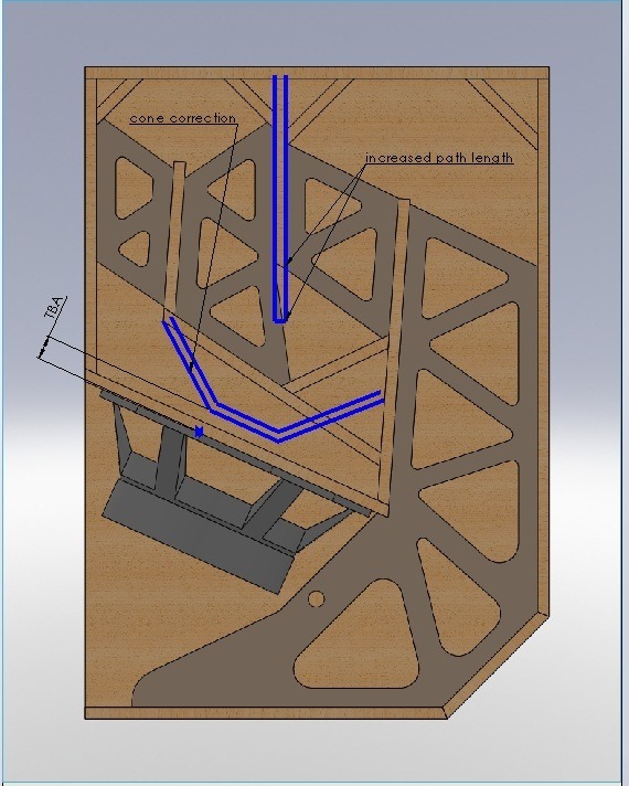

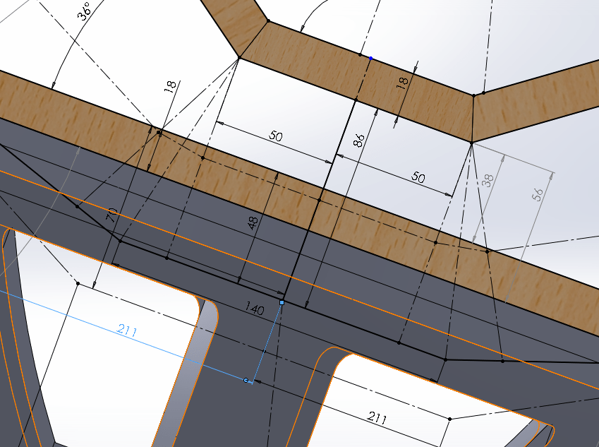

One of our crew @FinBot built a pair of mk1's many years ago, along with some of Art's SyntripP. The TH-18 boxers are pretty battered and have a few leaks and we were thinking about rebuilding them (along with another 4). I have read through a lot of this thread and debating whether to rebuild the mk1's or try the elusive mk2's.
Most of the 'bread crumbs' on the mk2's I can find show:
-the corner bracing removed (except for the one sealing the handles) for more volume
-Cone correction (eg post 2,963 for 18SW115s and some earlier posts). There's examples of builds with bracing in the stub and some without.
-Longer horn path linked to implementing cone correction.
Did i miss much else?
I know Art and a few others have dropped some hints on how DSL implemented the cone correction, but I'd rather stick to what the community has developed.
I plan to do the cad work in Fusion 360 and can share the 3d model and cut sheets if people want. Will also aim to add in skids to help them stack, pole sockets and bracing around the mouth to attach grills.

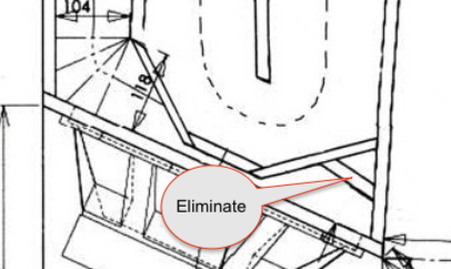

Deman,
The "3A" revision is OK, provided you eliminate the small "Y" brace in the "stub".
As Tom Danley has explained, (akin to radio-frequency engineering) "stub" or resonant stub is a length of transmission line or waveguide that is connected at one end only.
He's used them in several of his TH designs.
Art

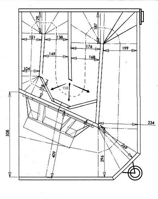

hello friends, it is an honor for me to read our passion here with good and bad opinions all threads. Well, what happened to someone here with a driver in the simple xoc version because the pressure is decreasing and correcting the cone to be flat helps a lot perhaps and i will do this type. I have 4 buckets BWP18/4 5" cone, what size should I make for this piece? I saw in the drawing 100mm, that is 50/50 middle. What should I do? how counting..
Pushed 2x PSSO HP-3200 2x800rms 4ohm
