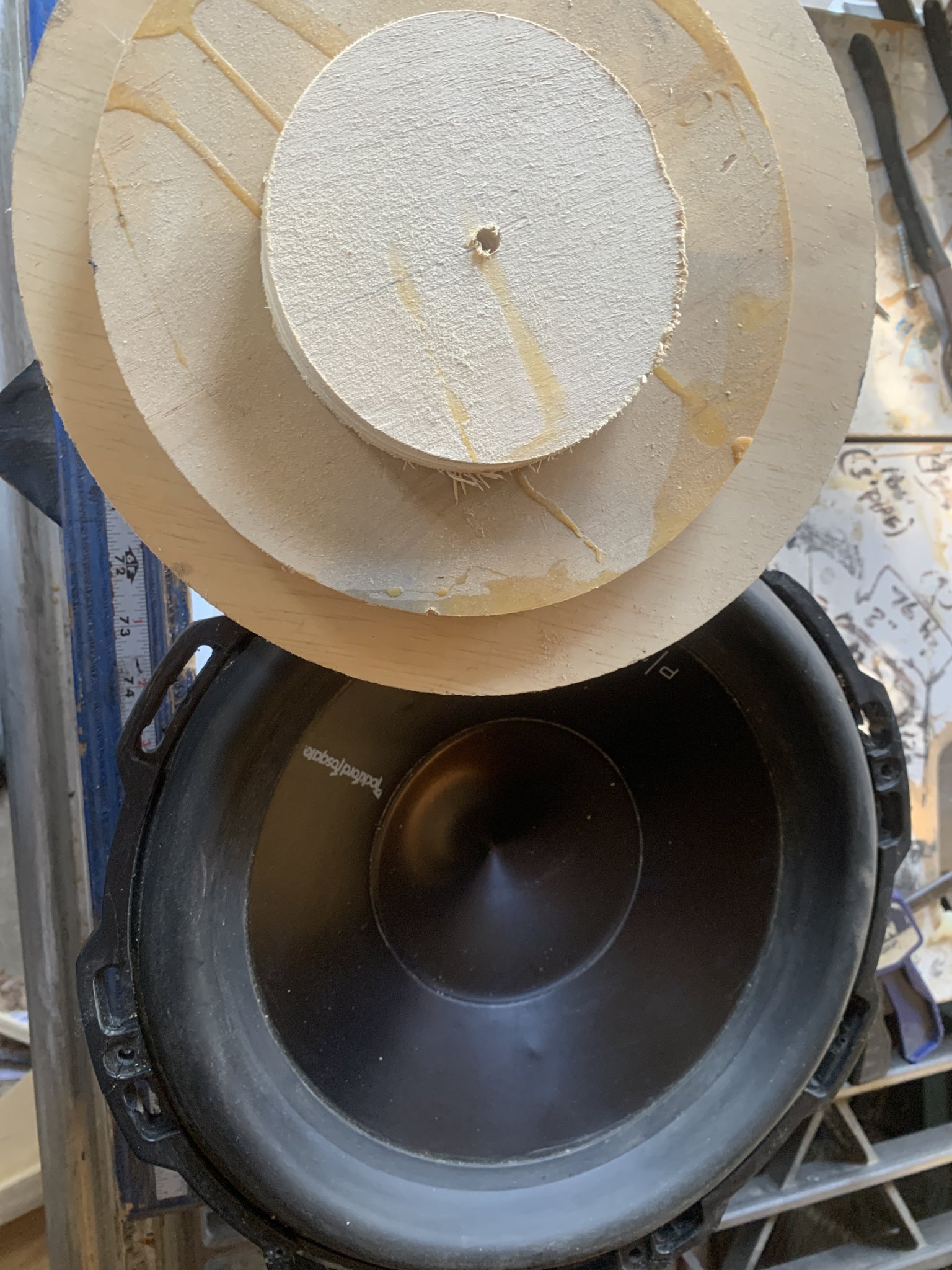

It has been stated a number of times that there are no published mk 2 plans. There are little hints here and there about changes / improvements, but no new drawing (that has been made public anyway).
There can't be a single drawing that covers all possibilities for the cone correction anyway (what people seem to want when they ask about mk 2) since a different design would be required for each different driver.
