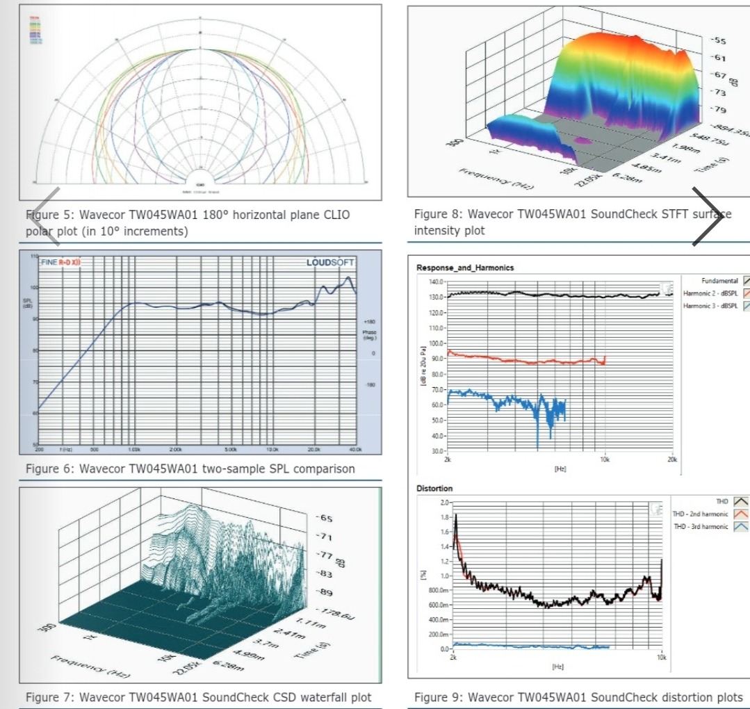

Per Voicecoil it measures exactly how one would expect resonance-riddled tweeter to measure - off-axis measurements are as bad as I've seen from a tweeter. Also, the top end is jacked up to try to compensate for the narrower directivity.

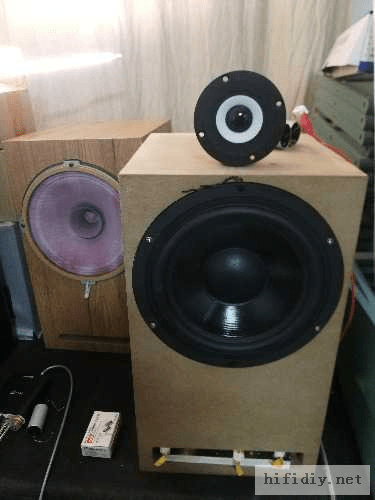

OK, to support the dismal economy and local currency I just took the June credit card repayment money and fished a pair from Idlefish Market for $175-equivalent. Maybe nine pairing candidates from 6.5" to 15", so this experiment will take all summer. At least two others on hifidiy.net just got them; it would be fun to compare notes.
First impressions: Sounds like what it is, ~2" ceramic cone tweeter whose "hard edge" is masked by a concentric ~1" silk dome supertweeter. Neither glassy nor soft-sounding. Response without baffle is slightly recessed above 7khz, more so beyond 10khz. Very high frequency dispersion is quite narrow at least the way I used it: 1st-order high-pass at ~7khz (7.4uF Jantzen SilverZ), above an 8" widerange that is run straight-through, flat to 5khz and 3dB less sensitive than the Wavecor. After half-a-day the sound improved noticeably, with more detail and less edge. Neutral-sounding and beginning to show realism.

It's a cone tweeter, not a wide-range driver or full range. Different applications for close to the same thing. It has a Fs of 850Hz or so, an underhung Xmax of 0.75mm, and a net sensitivity of 95dB! The higher sensitivity and higher Fs relationship is not normally available in a 2" wide range due to the shift in this arrangement. Lower spl and lower Fs is normal on those types meant for a different application.
According to the Voice Coil article plots posted above, it remains below 1% at 2.2kHz+ at 130dB(!) at Vance's usual short distance which is neither close mic nearfield or farfield. As this is the case, using some creative series resistance is likely to be the case, as well as maybe an Fs comp to subdue the output as well as the self resonance. On top of this, HD will likely decrease at lower levels, and may be usable lower than my supposed 2.2k suggestion before HD sets in. Most of us do not listen louder than 85dB.

Update to #51. I ordered another set of 17L cabs, solidly built 1.8mm MDF for $25/pr, with two changes: intentionally moved the driver cutout as high as possible to be closer to outboard tweeter; unintentionally got a 3cm output slot instead of 2cm. Anyway, I proceeded to make them 1.5m TLonken much the same as the Supravox, adding automotive 3-layer antivibration pads in critical places. The output slot had to be stopped down to 2cm or (possibly better) 1.5cm to sound right. The 8" widerange driver is run straight-through (35-7khz; 50-5khz audibly flat) and is made and sold locally under the name Molisio for $50/pr. In the TLonken it goes below 40hz cleanly and with bounce and gusto. By offsetting the tweeter back 32mm (faceplate-to-faceplate) the acoustic centers are aligned, I believe, as is phase at 6.3khz nominal crossover frequency, 1st-order high-pass (1ohm->7.4uF Jantzen SilverZ) combined response ruler-straight around the crossover. The result is dynamic, "holographic" and "electrostatic". I hear more fine decernible detail than with my other speakers. After a week of fiddling, still sounded dry and a bit icy; occasionally with a ceramic "edge" but less over time. Clearly, more is needed. (Second picture Molisio reverse-polarity to align phase but not acoustic centers; not holographic.)
