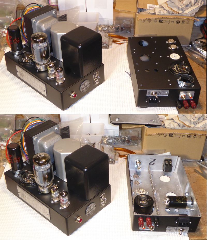

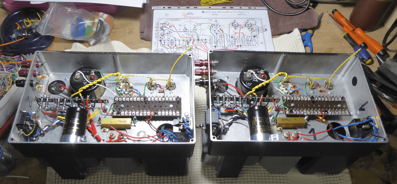

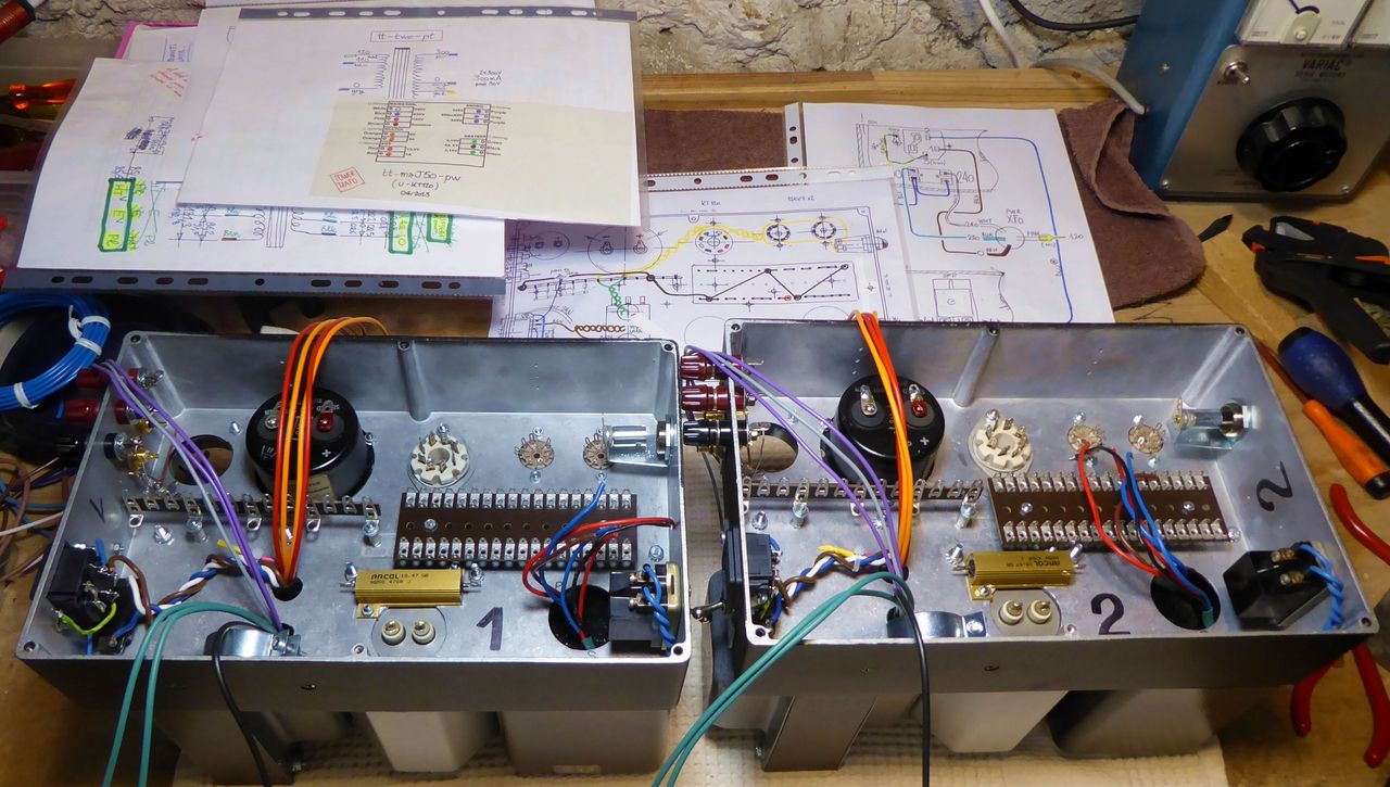

The project is now under construction - I hope to end it before the end of 2023 :
The lateral chassis plate already gives some clue :
More detailed pictures to come, au fur et à mesure...

End of the work - finally !
Measurements and final setup :
The power output reaches 10.00VRMS on 8R output / 8R load, that is to say 12.5WRMS, the onset of clipping being between 13 and 14WRMS.
The bandwidth at 10.00V / 12.5W is :
@-1dB 16Hz - 23kHz
@-3dB 10Hz - 40kHz
The bandwidth at 2.83V / 1W is :
@-1dB 7Hz - 23kHz
@-3dB 4Hz - 42kHz
The Ri measured on the 8R output is 2.36R, giving a damping factor of 8/2.36 = 3.39
The FB line is circa 6dB (5.5 to 6dB depending on the input sensivity calibration adjustment, done via the FB at 800mV in ---> 10.00V out)
I have no means to measure distorsion for the moment, but by my experience, I estimate it to be circa 2-3% at maximum output power.

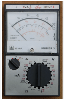

Does not exist anymore - they were something like local Siemens and a lot of things they made were maked under licence from Siemense & Altec.
Sure ISKRA was a major electric/electronic company in the East countries - I thought they were still in activity.
One of my first MM was an ISKRA Unimer III :
I would probably still have it if it was not stolen with my toolbox long ago...

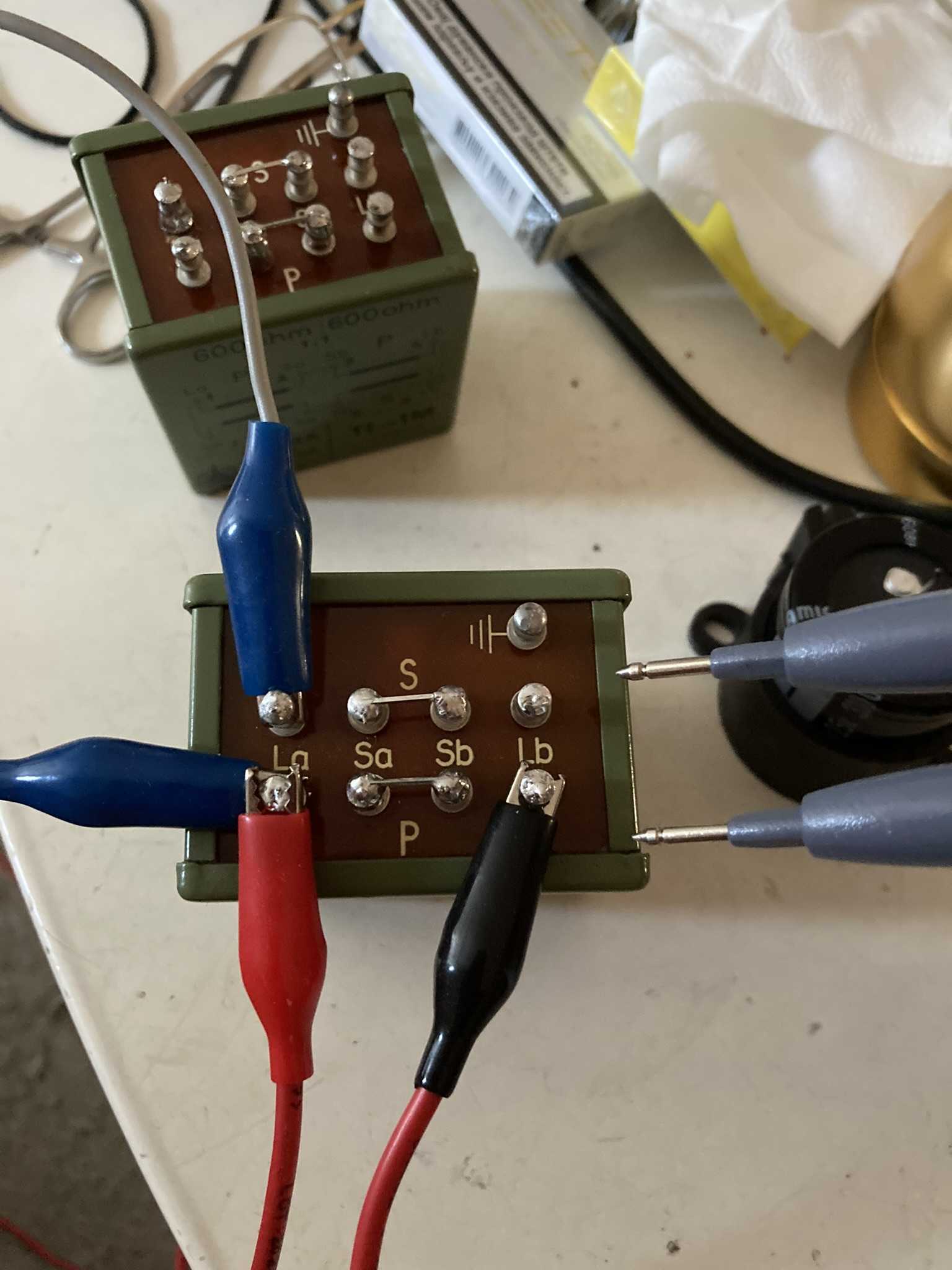

Using their 1:1 600R transformers at the output of the Pavouk DAC ( AD1865 NOS ), little rough comapred to some locally wound transformers but for the price of 20 Eu per piece they are alright.
