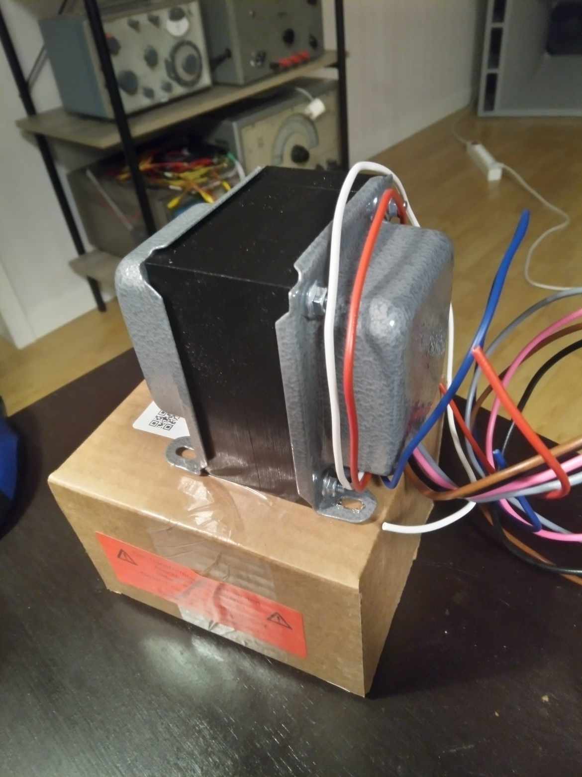

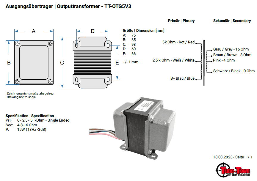

The transformers arrived today, they are slightly bigger and heavier than expected and the build quality looks very decent for the money.
With a little luck I can produce some basic test results within the next few days.

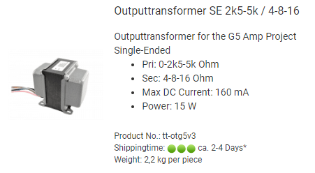

Nice! Tube Town mentions 160mA as max primary current, which seems like a lot for a VT25/10Y. Perhaps you could remove the end bells and decrease the airgap to get more primary inductance? A risky operation though.
That's right : 160mA announced here. Yes, the 10Y only needs 18-20mA, so the primary inductance will be much increased, thanks to the laminations that are rather large :
The air gap is probably not modifiable, thanks to a coating / anti-vibration treatment, I guess... I can't tell since unlike you, I don't have them in hands. If the I of the EI laminations is easily removable, then yes, a modification could be possible, but IMHO, a removable I would then mean a poor impregnation of the transformer, synonym of noises and vibrations...
Another point that I must check is if the transformer is capable to provide the 10K load for the VT25/10Y by using it on the 4R tap.

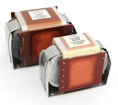

True, changing the airgap was just an idea. I think Lundahl has a small 16k SE OPT that should work well for the 10Y, probably much less expensive than anything from Hashimoto.
Yes, I see - you mean this one :
https://www.lundahltransformers.com/wp-content/uploads/datasheets/2735B.pdf

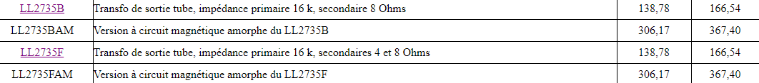

Yes, they are much more affordable than the Hashimoto transformers - prices in Euros from the French distributor :
But unfortunately, there's no casing version available for these transformers, and they have an odd mounting shape and scheme...
... That is not very compatible with a compact amplifier design like those I build :

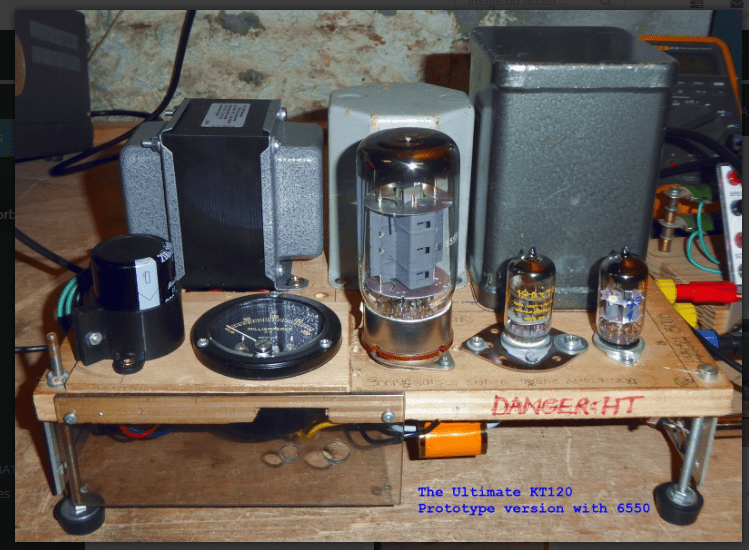

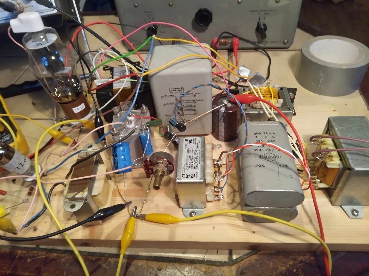

Hey ! This is a prototype, after all : built for validating a circuit, right ?
My U-KT120 looked like this at the start, reusing the platform of my U-300B :
Not much better than yours, as you can see... Except that it approached the final disposition... But with the wrong parts !

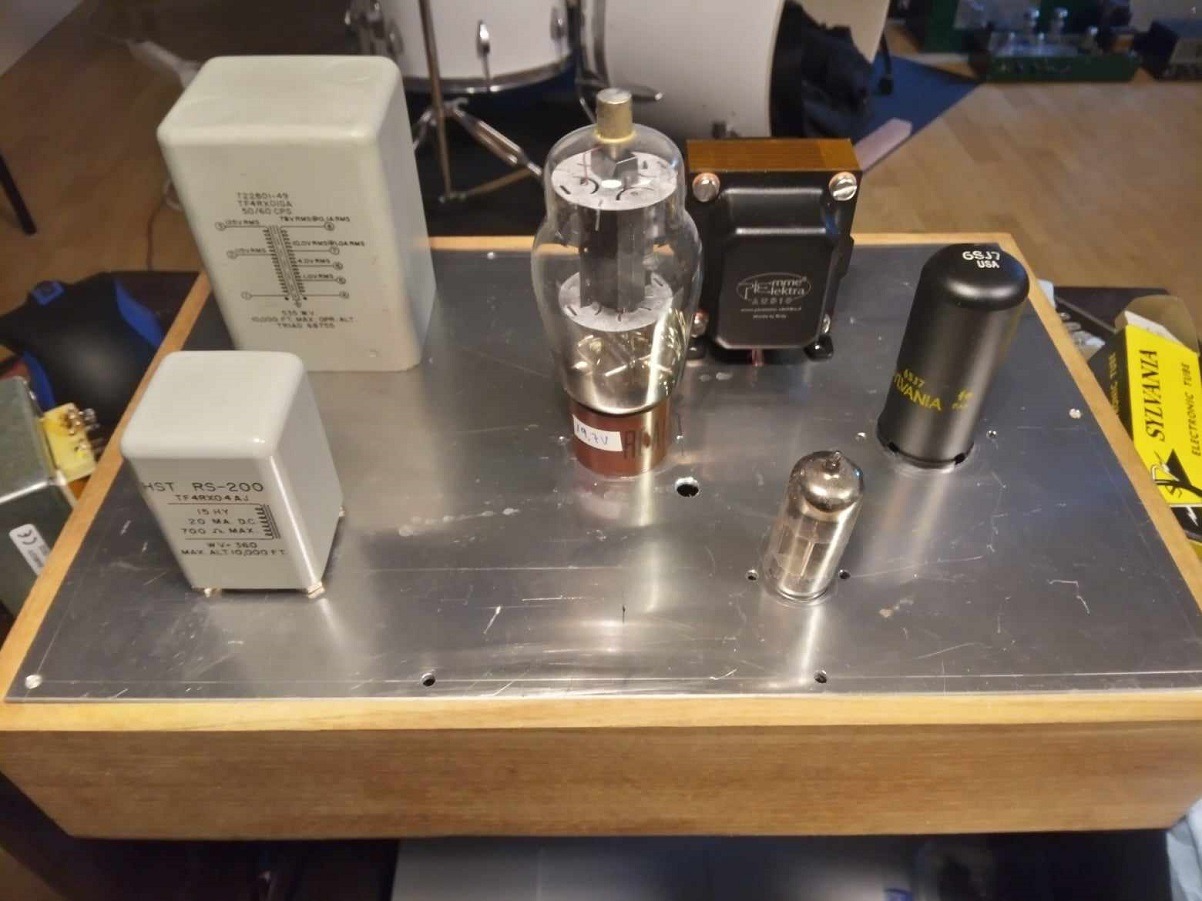

I'm sorry I forgot to mention Piemme earlier, I simply had forgotten about them until a few hours ago when I moved the breadboard to make room for a test rig with the TT transformer and an 808.
Piemme has some nice stuff, including a series of nice transformer covers that I'm using to cover the Lundahls in my PP 6S4S amp. Good prices and fast shipping too.
The transformer in your link probably suits 10Y better than the one I linked to, I seem to remember that I picked the 70mA version because of the lower primary DCR.

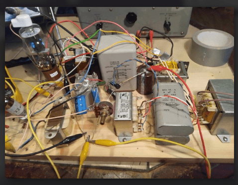

I just ran a quick test of the 808 - TT OPT combo and the results are not very encouraging: With my non-optimal setup and primitive measuring equipment in mind, a low-power test with the OPT connected as 5k/8R shows a 23Hz-15kHz -3dB bandwith.
There might very well be something off with my setup and the 808 is a problematic tube due to its high Rp so let's not give up quite yet.
Seems like there is something wrong with my wiring, my driver stage or my tone generator after all. Unless I'm completely wrong, I have pretty much the same HF rolloff at the grid of the input tube as there is at the output of the transformer. Please let me investigate this further before we draw any conclusions about the quality of the transformer. I'm too tired to work with 400V test circuits right now so I'll come back tomorrow.
