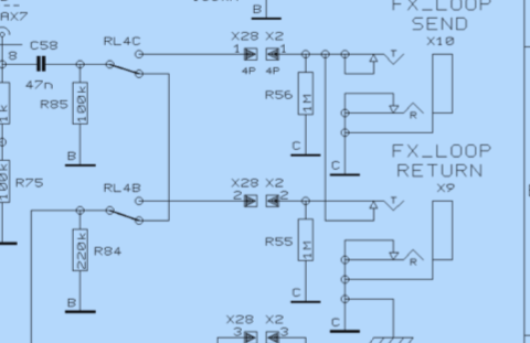

Hey all! I'd like to record my tube guitar amp speaker output attenuated to line level signal with my PC without tonal changes as I'd like to add cabinet simulation in the PC. Would something like this work? with what values?: Speaker to line level.jpg - Google Drive Reactive load example: Reactive load.JPG - Google Drive Thank for reading! I'm using a bugera 6262 212 amp

The FX-Loop Send, disconnects the pre amp/tone stack from the power amp so no need to use a power sink, take a signal, (standard jack) from that socket to your PC, that is all you need for recording. Ensure the loop link switch is off.
Thank you very much again! I'll try that but there is no loop link switch on my hardware though!
