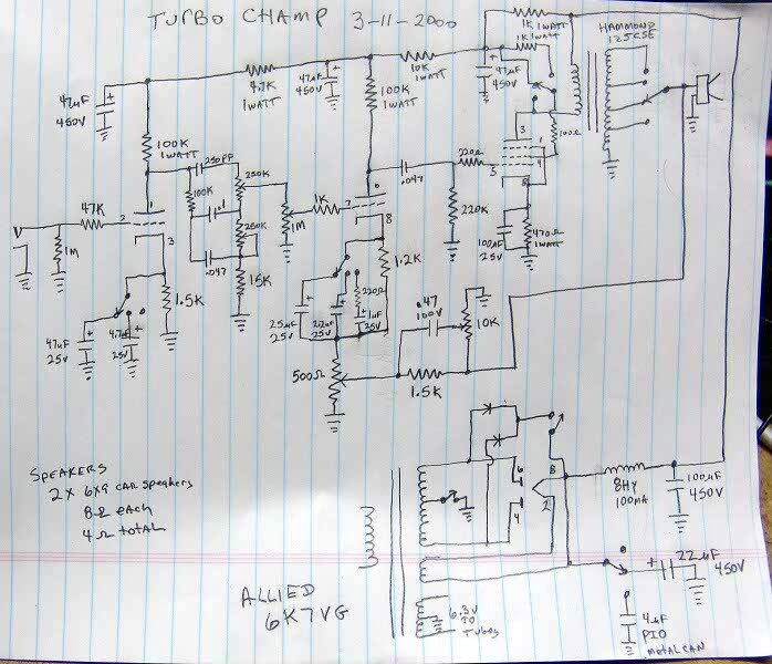

I am including the "best guess" schematic of the Turbo Champs I built in the 90's. All were different as they were made with whatever I had available at the time over a 3 year period. This schematic was drawn from memory after the fact. Most amps used a Chinese KT88 for the output tube. A few used a Chinese 6L6GC. Most used the Hammond OPT, but only a few used the Allied 6K7VG power transformer. Most used transformers robbed from scrap HP 200 series vacuum tube audio oscillators.

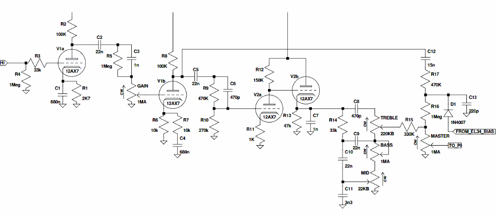

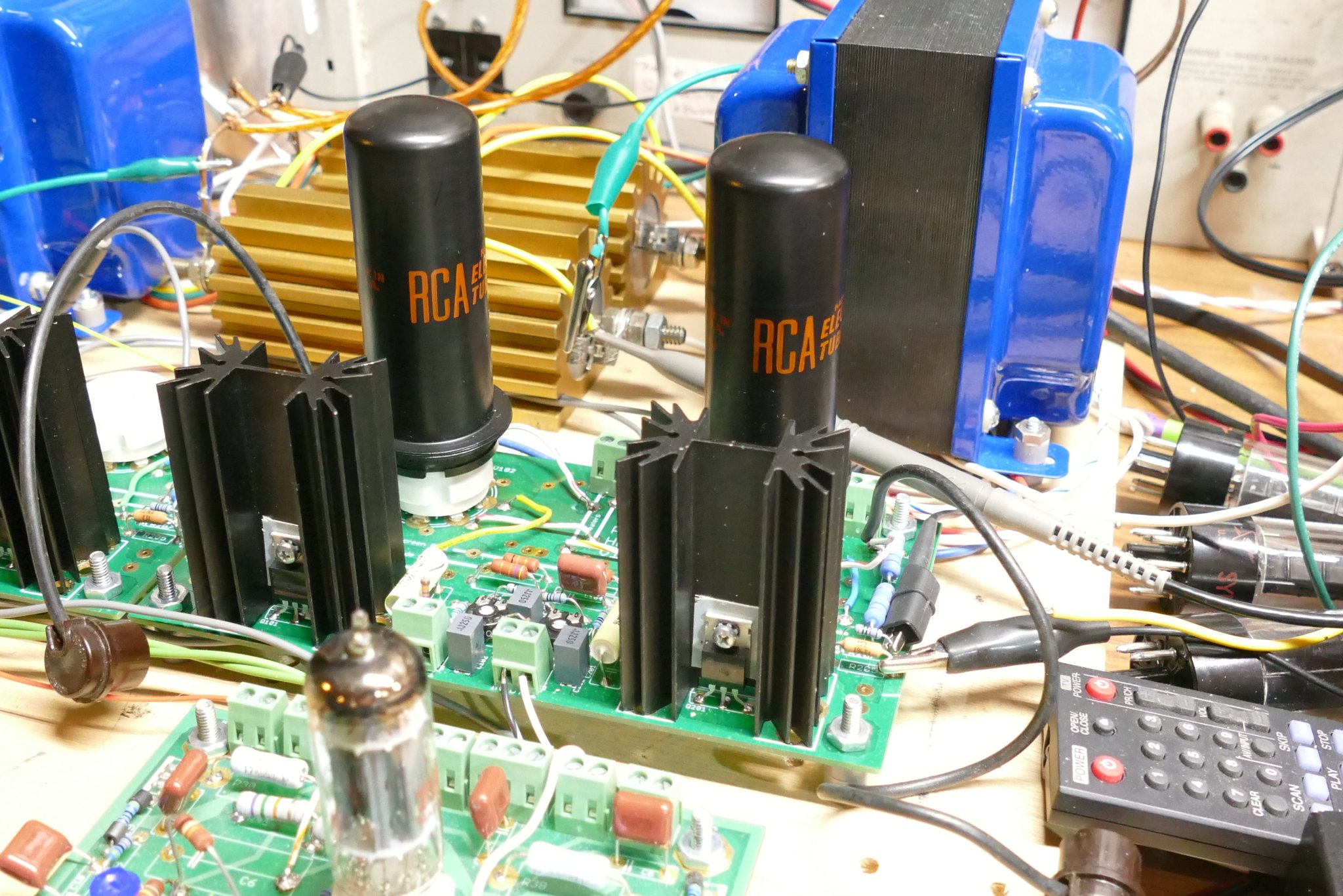

Any and all ideas are welcome. As far as the schematic in post #11 is concerned, I am interested in where the "from EL34 bias" connection goes. The path through R17 and C12 is reverse phased compared to the path through the tone stack. Both paths have frequency dependent phase shifts, so this could lead to some unique tone control action.
Pot R17 in my schematic from post #1 has an out of phase signal at each end. This should and does lead to a near perfect cancellation of the output signal at some position of the pot.

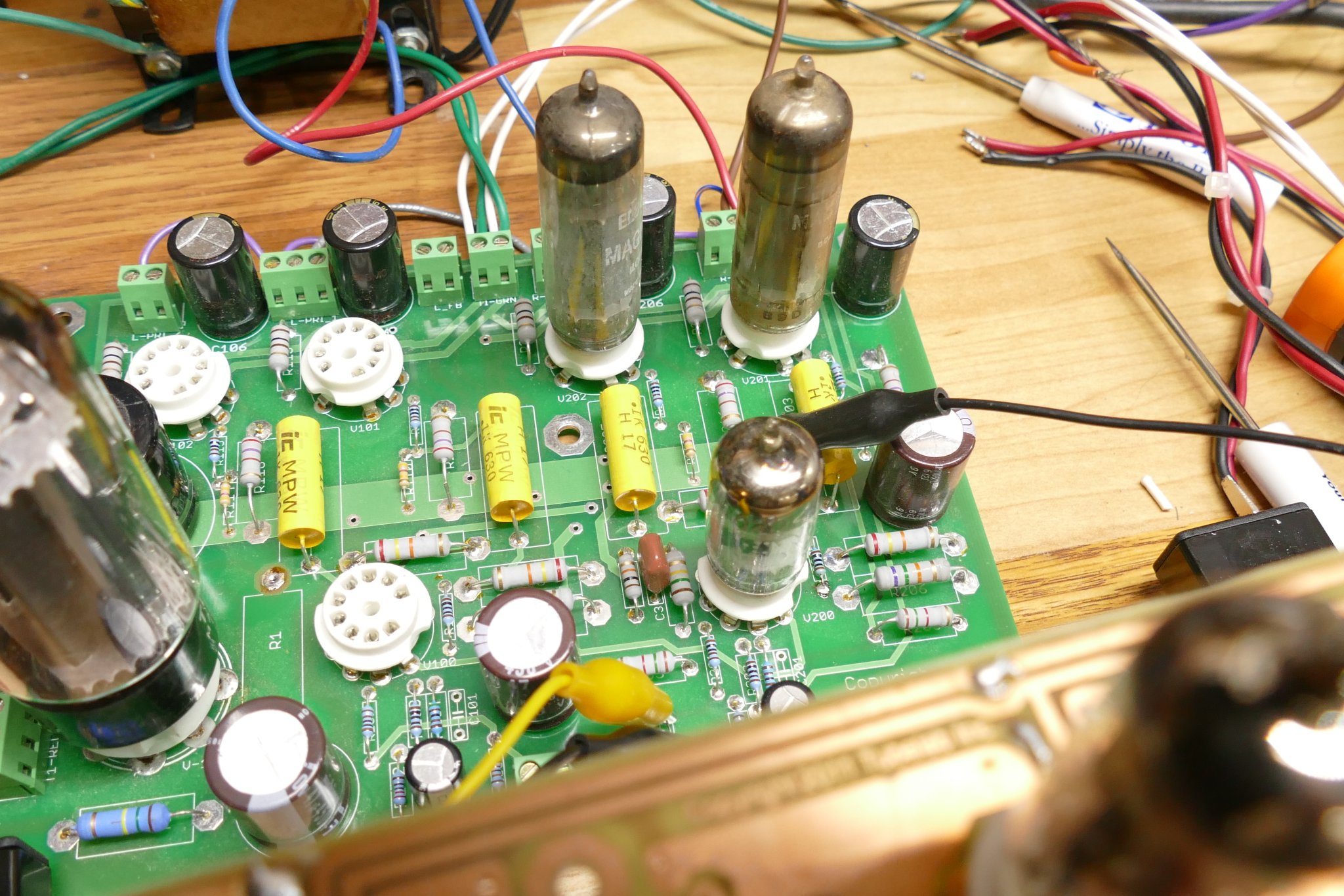

I now have the board fired up and running on a bench power supply and fed with an audio oscillator. The cancellation is near one end of the pot, but things will change when I hook up a guitar, a power amp board, and go poking around with capacitors.
I think you've been part of any thread on tube guitar amps I have ever participated in so I am not sure I can give you any new ideas.

The "from EL34-Bias" connection goes to the top of the bias pot and just provides a negative DC voltage for the circuit, in order to clip the negative wave coming from the cold clipper stage V1b. That extra clipping is not essential to the sound, though.
And yes, the partly subtractive and non-EQ'd nature of the summing happens to be a key point (I tried with additional LND-150-based inverter first and failed. I also tried mixing in at the input of the tone stack but also not good result). As long as the last stage V2a+V2b doesn't severely clip the contribution from the additional path is microscopic.
When it goes into heavy clipping, more of the second path becomes effective in the sum, basically reducing the fundamental, making the sound brighter and more aggressive.
Finally, when the cold clipper itself maxes out with strong input, the produced extra distortion is partly added in directly, again with a somewhat destructive summing. This gives sort of extra "definition" and attack, the harder you dig in on the guitar the "crazier" the distortion gets... to the point of ending up with a total mush of noise when strumming complex chords at full might ;-)
The tone controls double up as mixing controls for the additional path, the lower the settings the more of the secondary path comes into play. Not perfectly versatile but adding an accessible extra pot was not an option.
The second important aspect of the channel is the distortion behavior of the gain+CF stage, loaded by the tone stack. It is this stage that saturates and clips first, after all.
In the stock circuit, V2b often starves current on fast downward swings, provoking slewing distortion, the voltage cannot go lower faster than the discharge rate of the tone stack main cap allows, also depending on tone control settings quite a bit. This is part of the trademark 2203/2204 bite but prevents a nice smooth and gradual reduction of distortion in the decay of a note.
With a lower cathode resistor and larger anode resistor of that stage it develops distortion with level much earlier but also extremely gradual which is my strong personal preference. The final touch comes from the sightly modified cold clipper stage and its input and output networks to balance things out.
The reaction to playing style, guitar volume/tone controls and guitar type of this channel is brutal and exaggerated but highly addictive, for me at least it is. For others, it might be unplayable.
With conventional high(er) gain stages OTOH, the distortion character does not change much once past a certain gain, it just decays much slower. I'm not saying this is a bad thing, it's just different.

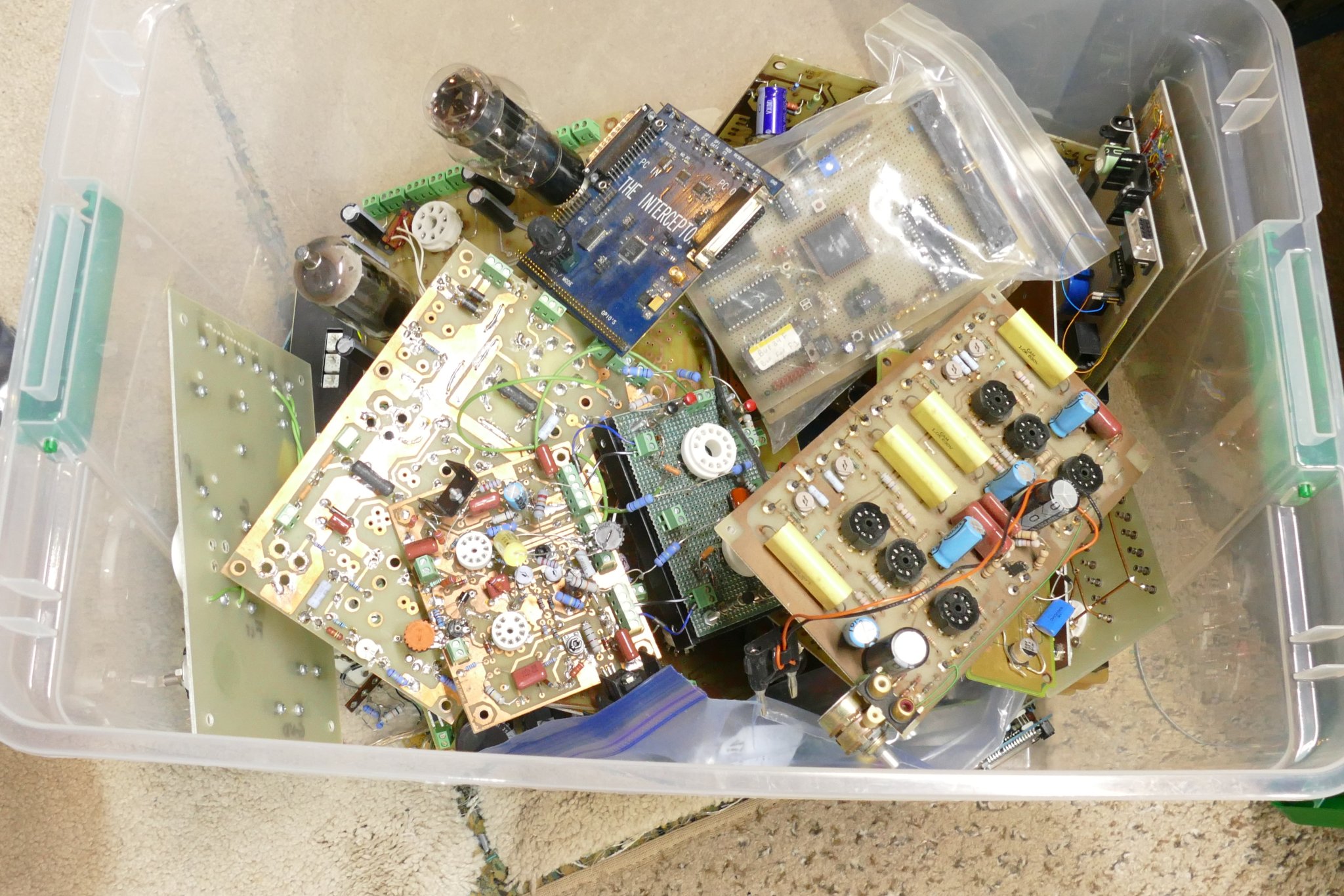

I have collected a lot of "stuff" in the 50 some years that I have been making things. There is an abandoned mobile home on our property that I use for storage. It is unheated and not exactly perfectly sealed, so I tend to store things there that don't mind temperature extremes. Things like chassis, old dead stuff and boxes full of tubes.

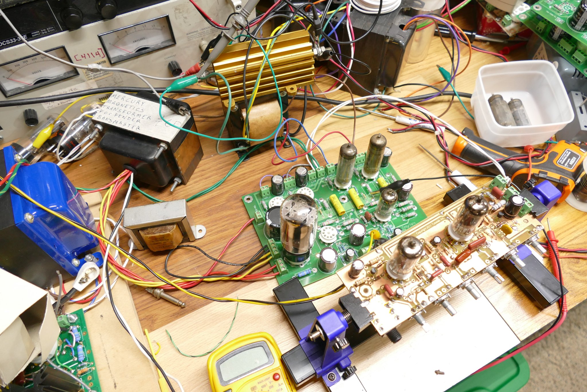

Last night I saw the little preamp work so I set out to connect it to a power amp. That's where progress stopped. I got out a known working Tubelab SPP board and proceeded to connect the preamp to one of its channels. Uh, it seems that I have zero EL84's in this house. There are some in the trailer, but there is only one way into the trailer as the front door is secured from the inside. The back door opens outward and has at least a foot of snow piled against it. I wasn't about to go digging in the dark up on a rotten deck with no handrail, so I turned to a box that has not been opened since I left Florida. The box was labeled "OLD TUBES" and did contain a bunch of stuff that was hastily boxed up in a hurry. I was tinkering with guitar stuff at the time, so.......

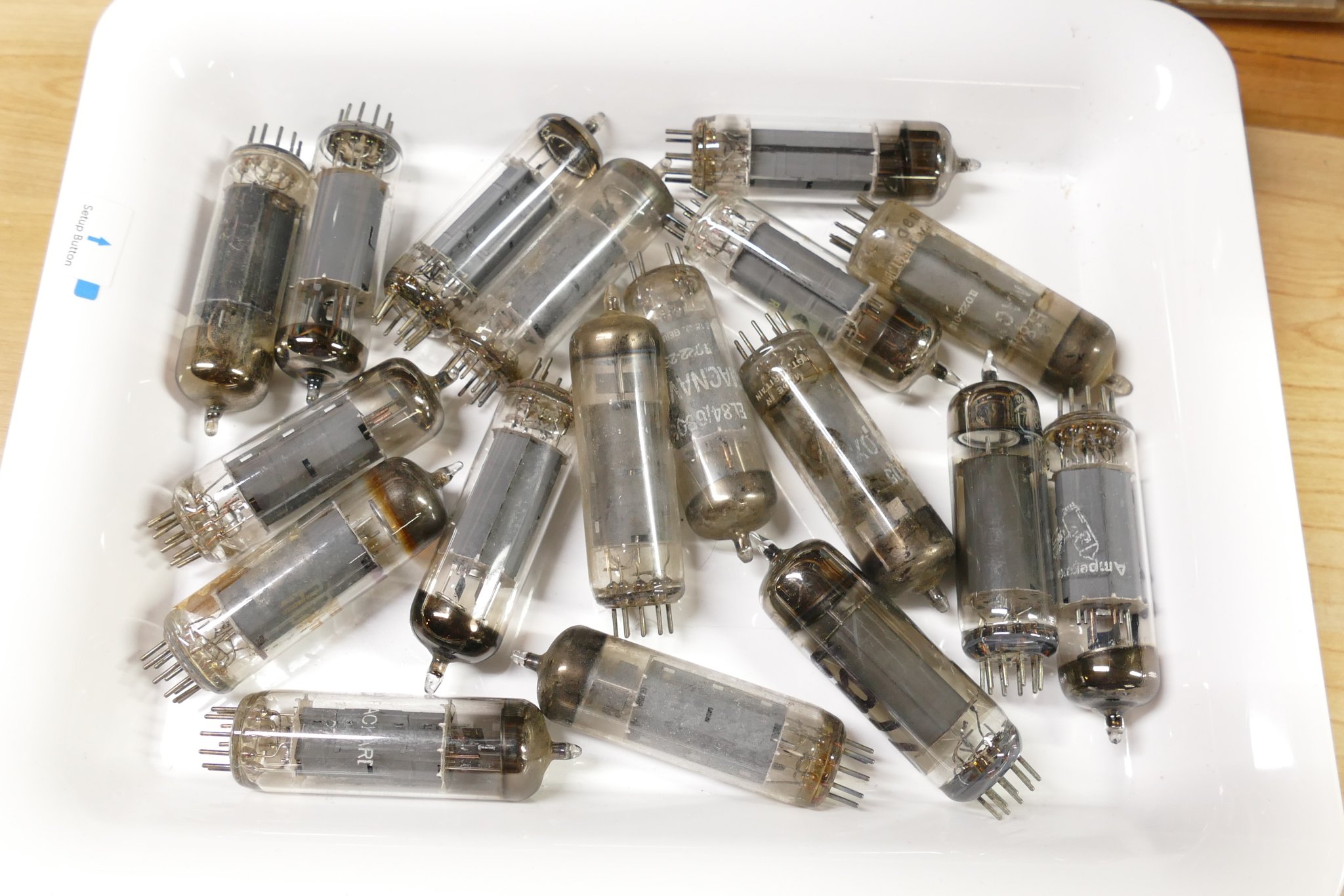

Once opened I found about a dozen more metal tubes to add to the growing list of possible "test subjects" for MetallicAmp, and 18 rather crusty looking tubes that might be 6BQ5's or EL84's. This box came from the time that I stripped about a dozen vacuum tube HP audio oscillators for their electronics because they were destined for the metal scrapper. This means that all the HP branded tubes will be 6CW5's. Maybe a pair of those crispy looking Magnavox tubes will make sound in an SPP board. I am about to find out as soon as I find one of the power transformers that I stole from the HP signal generators.
