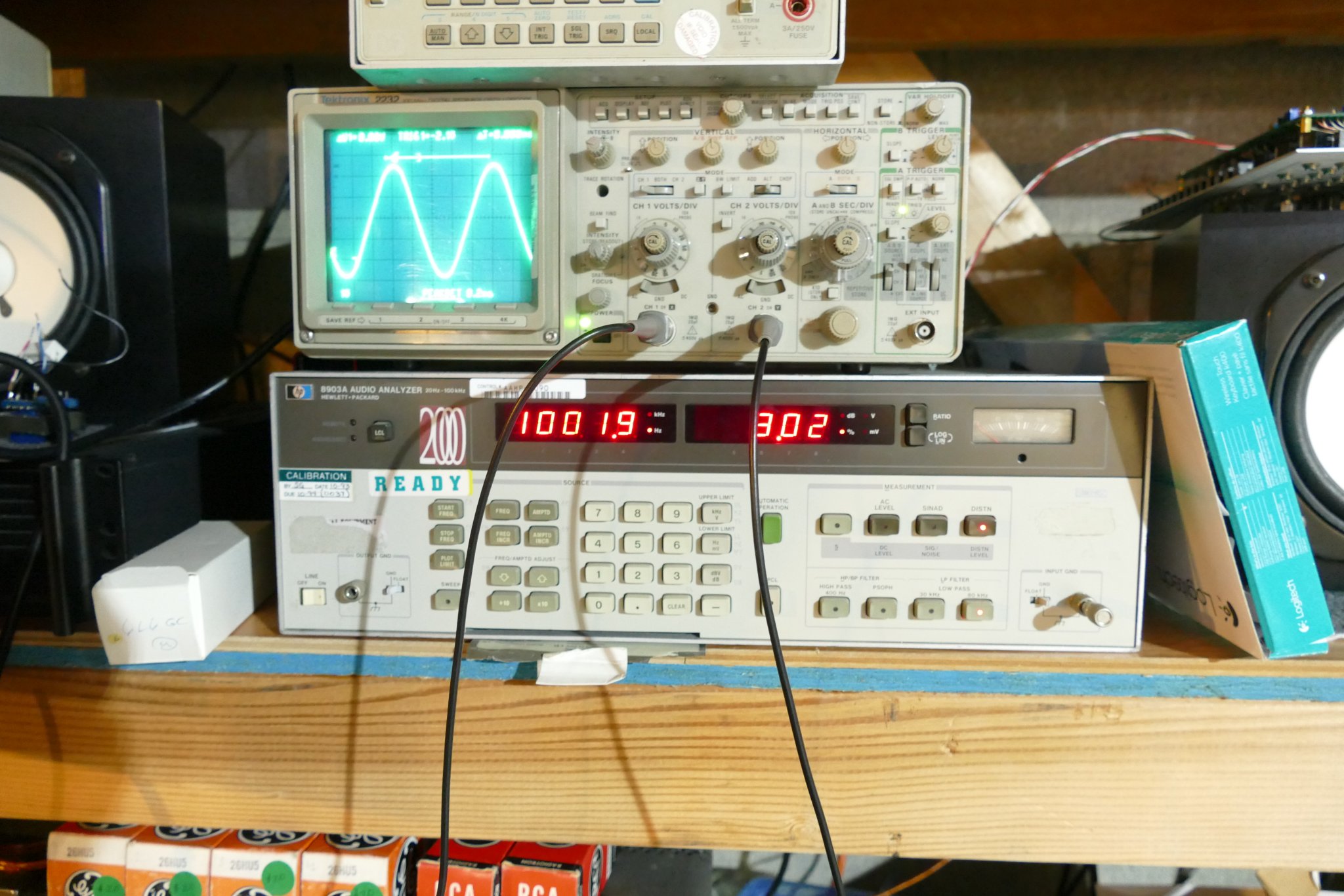

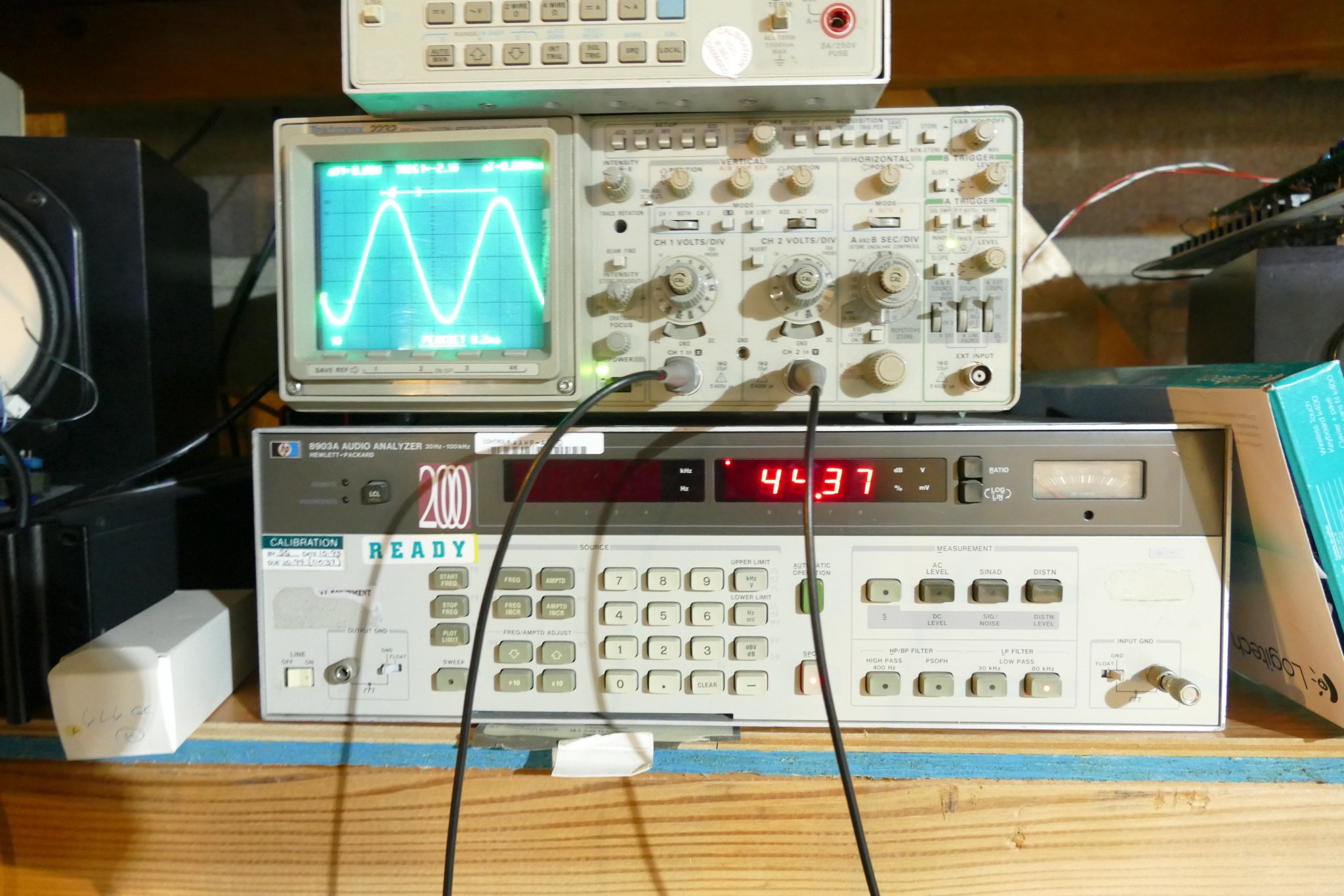

Tubelab wants a new guitar amp

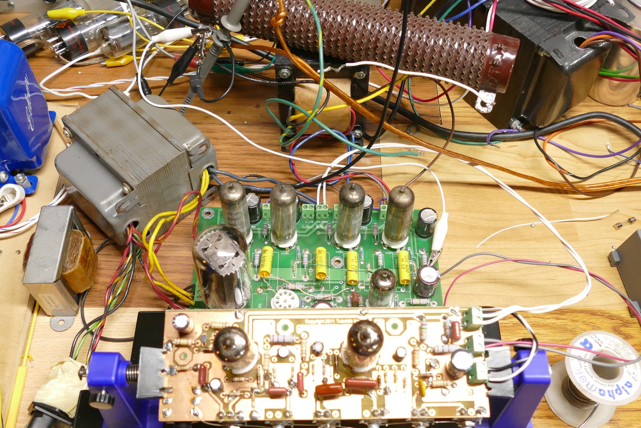

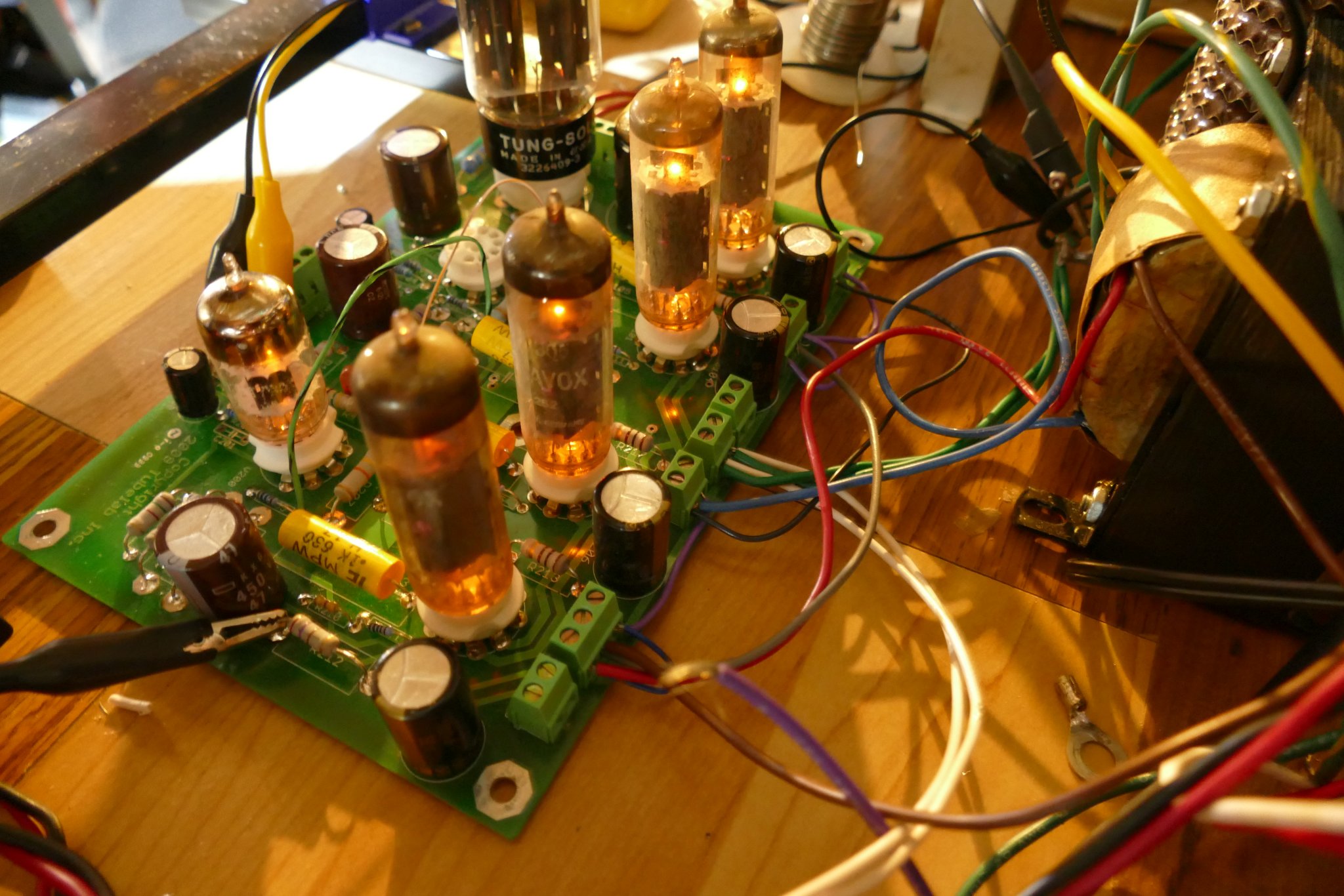

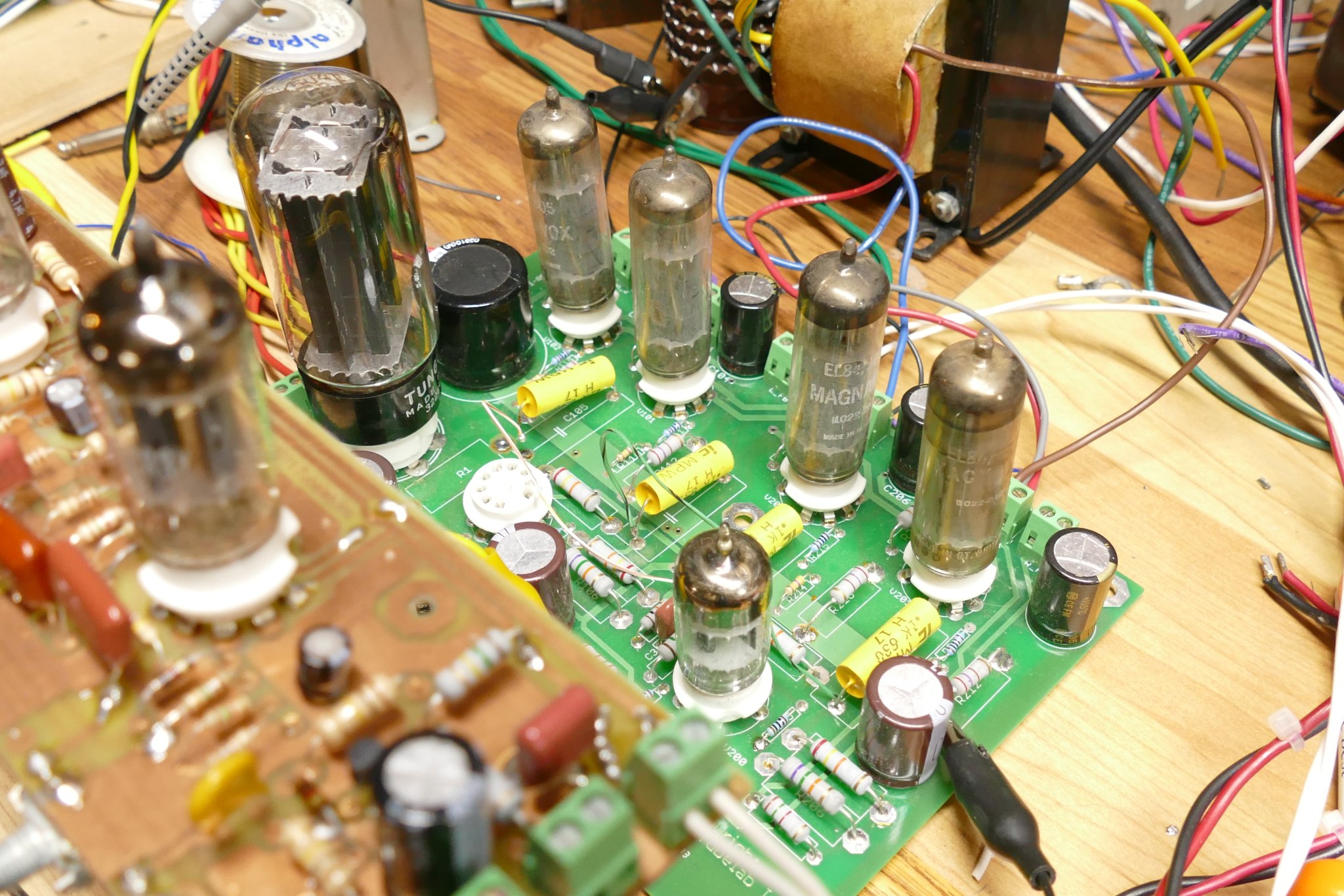

I lifted one end of the coupling caps on the second pair of tubes and wired then in parallel with the first, paralleled the plates, then rewired the OPT for 3300 ohms. Idle B+ is now 420, still too much for the screen grids. I cranked it up until I reached 3% THD where I get 44 watts. B+ at this level is 396 volts. Not bad for 6 old tubes.
Reactions: 1 users
What is the crossover distortion like in clipping? Or would that be too much for them given the operating conditions. Mind you, would not want you to blow them and have to go shoveling.
I thought of the parallel path thing a bit when going down the tube compressor rabbit hole. Thought of a Fet up front splitting the signal.

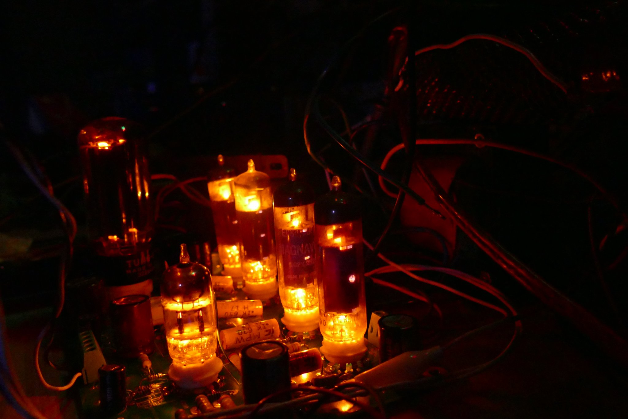

As it is now the tubes are operating way beyond spec, so I need to swap out the power transformer before the inevitable meltdown occurs. I don't know where these tubes came from, but the box they were in was packed 10 years ago and I probably had them for some time before that. I was surprised to see that the first 4 I tried actually worked. These tubes are cathode biased with a 270 ohm resistor. The cathode voltages ranged from 14.5 to 15.9 volts, so they are not exactly "matched." With about 400 volts across the tubes at idle, they are cooking at 21.5 to 23.5 watts assuming matched cathode resistors (not). I'm not so sure that my preamp will survive this voltage either, all of the electrolytics in both boards are rated for 450 volts. Cold tube startup hits 515 volts.
The distortion as the amp clipped appeared to be due to the clipping itself. No crossover distortion or notching was noted. THD at 1 watt was 0.24% so crossover at idle is not an issue but might be at a more reasonable operating point.
I doubt that I will use 6BQ5 / EL84 in the finished amp, they were just the quickest path to a working power amp with a multi tapped OPT secondary. Most of my suitable SE OPTs have a single secondary. I have two existing "guitar" speaker cabinets available currently for testing, and both are 4 ohms. One has a pair of ElectroVoice EVM10M speakers. They are LOUD @99 db each, but very heavy. The other has a pair of Parts Express 6 inch "pro audio" speakers which are not so loud at 91. something each.
As it is now there is a volume pot after the first stage plus a MV pot at the preamp output. Parallel path(s) would likely come from a second (or more) pot across the first volume control. It is bufered from the 12AX7 by a mosfet follower so several pots could be paralleled at that point.
I kinda like the idea of being able to select either a pair of EL84 or a quad of them. It's still a ''reasonably'' priced tube and commonly available.
Makes a nice wattage range about 15W paired and 30W with the quad selected.
That you got it working at 400V and 20+ watts dissipation, without the light and smoke show.. amazing! But yeah, probably not for long ;-) Cheers!

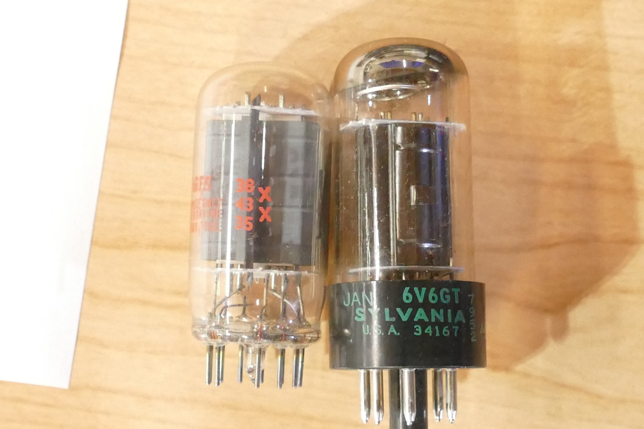

The 6DQ6 and 6BQ6 medium sized TV sweep tubes are pin compatible with the common octal guitar amp tubes. It is possible to run them in the same socket, though not under the same conditions.

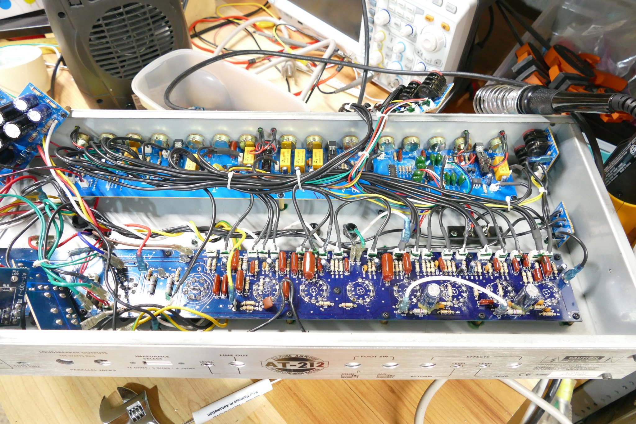

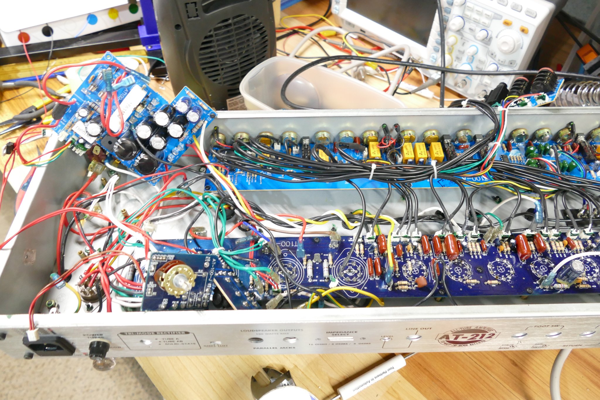

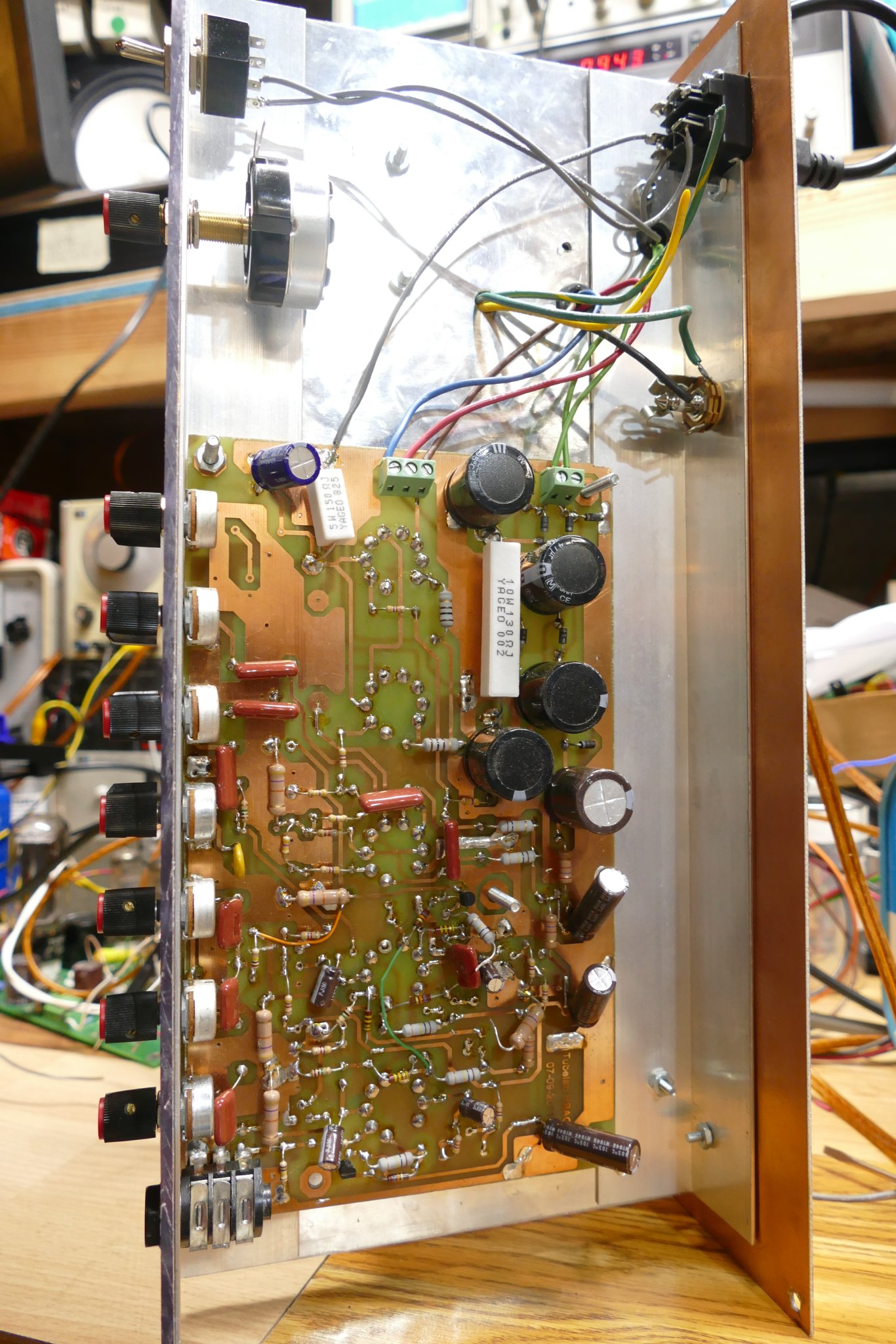

A few years ago, I was "bottom feeding" (looking for cheap junk that could be repurposed) on Ebay, when I found a "defective chassis without tubes from a B52 branded 100 watt combo guitar amp." I threw the minimum bid at it, won and paid more for shipping that I did for the chassis. I had planned to strip it and use the chassis to build the "big one" since it had 5 octal sockets and 7 12AX7 sockets. I stuck some "old tubes" into the chassis and was surprised to find that it worked, played very loud, but didn't sound great. It wound up on a shelf where it sat for a couple years. I got it off the shelf and started the disassembly process a couple months ago when I discovered the cause of the murky sound. Both of the main filter caps were bulging and had vented. Maybe it was an easy fix. At this point the disassembly process stopped, and the hulk went back on the shelf. I'll decide what to do with it later. Note the "MESAesque" rectifier switch. I found the schematic for the B52 on the web.

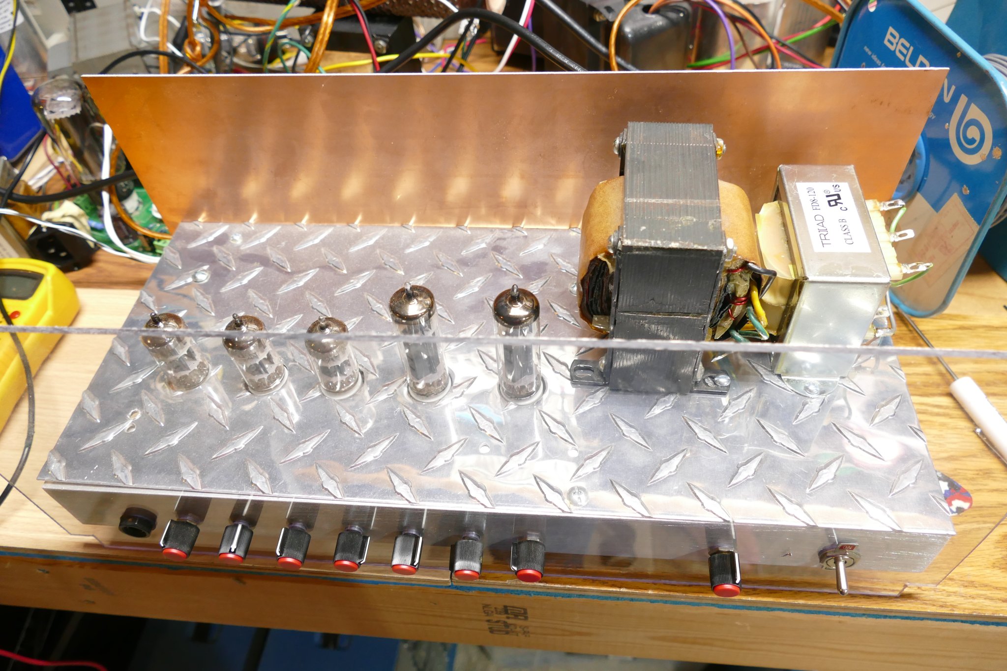

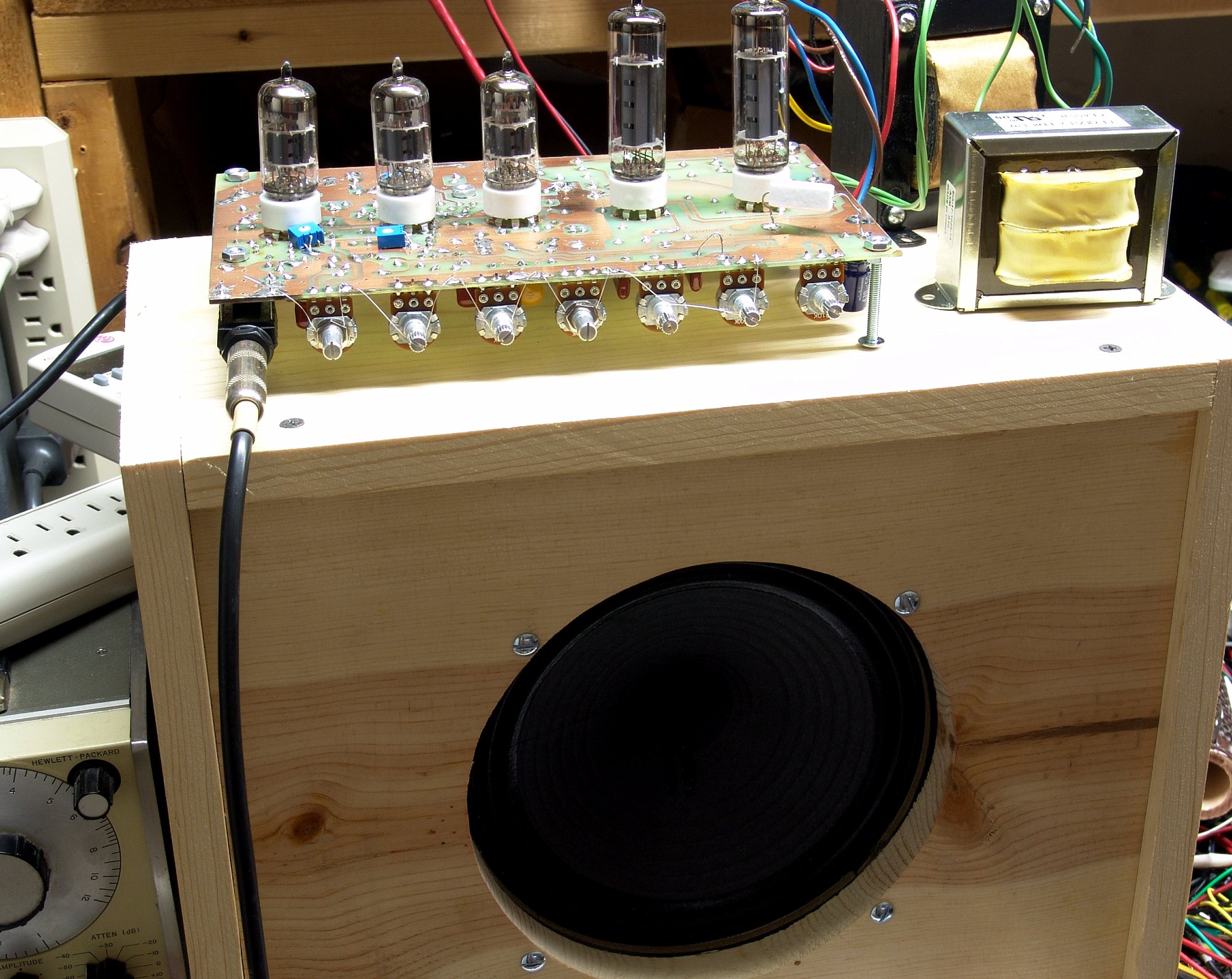

This afternoon I swapped out the power transformer for one salvaged from a HP audio oscillator. This brought the idle B+ down to about 380 volts with the preamp connected. Idle dissipation was still high at about 18 watts on the worse tube. The "shot in the dark" photos reveal a dim glow in the plate on that tube. They also reveal some glowing grid wires on the tube with the lowest idle dissipation. I think I may have partially zapped that tube early on when the plate lead from the OPT came loose while the amp was powered up. The screen grid had to eat a lot of power that should have gone to the plate for as long as it took me to hit the KILL switch, about 1 second. There was a bright glow from inside the tube during that time. It still works well enough, so it stays in the amp until I get the dissipation down further.
Upon first power up of the combined preamp and power amp I was met with some oscillation. I remembered the same kind of stuff on a guitar amp I designed and built for the Hundred Buck Amp Challenge (pictured on top of a pine board speaker cabinet), and how I fixed it. All of the pot cases must be grounded. Finding that 12 year old picture got me thinking about what happened to that amp. There were two nearly identical boards that only differed in the choice of output tubes. The octal output board used sweep tubes and never really worked right. It lives in the box of dead circuits, but the 9 pin board was not there. A few hours later I remembered building a case for it. It is the amp on the bottom of the pile in post #1 that "just needs an OPT." It had been sleeping in a box on a shelf for 12 years. It is already out of its box and a suitable OPT is being installed. It will be revisited soon.
After running a thin wire to all of the pots it appeared that everything was ready, so I hooked up the smaller speaker cabinet, and plugged in the red Strat. As soon as the cord hit the jack the feedback started. This thing has WAY TOO MUCH GAIN. There are four volume pots counting the one on the guitar. Best clean tone is found with the guitar's volume at about 5 (1 to 10 knob) and the input gain (between stage 1 and 2) barely cracked, maybe 1/2 on the 1 to 10 scale. The second pot can be turned one way to bypass the second stage, the other way to use all of the second stage's gain, or somewhere in between for partial cancellation between the two stages. I prefer a setting that uses just a bit of the second stage gain, nearly full cancellation. Even at this setting the Master Volume can't be turned past 5 without driving the power amp to full saturation (square waves with ringing on the scope across the speaker). It is possible to get some really nice clean tones with careful adjustment of the pots and the amp can be turned up quite loud with the MV before distortion sets in, feedback happens first even with the speaker pointed away. Any setting past about two or three on the input gain caused blocking distortion in the preamp! Dime the knob, hit a string, and silence happens for up to a second. It's definitely happening in the preamp since it can be seen on the scope at the preamp / amp connection, but I didn't dig deeper yet. Settings slightly above one does generate some nice, distorted tones, but things are far to touchy.

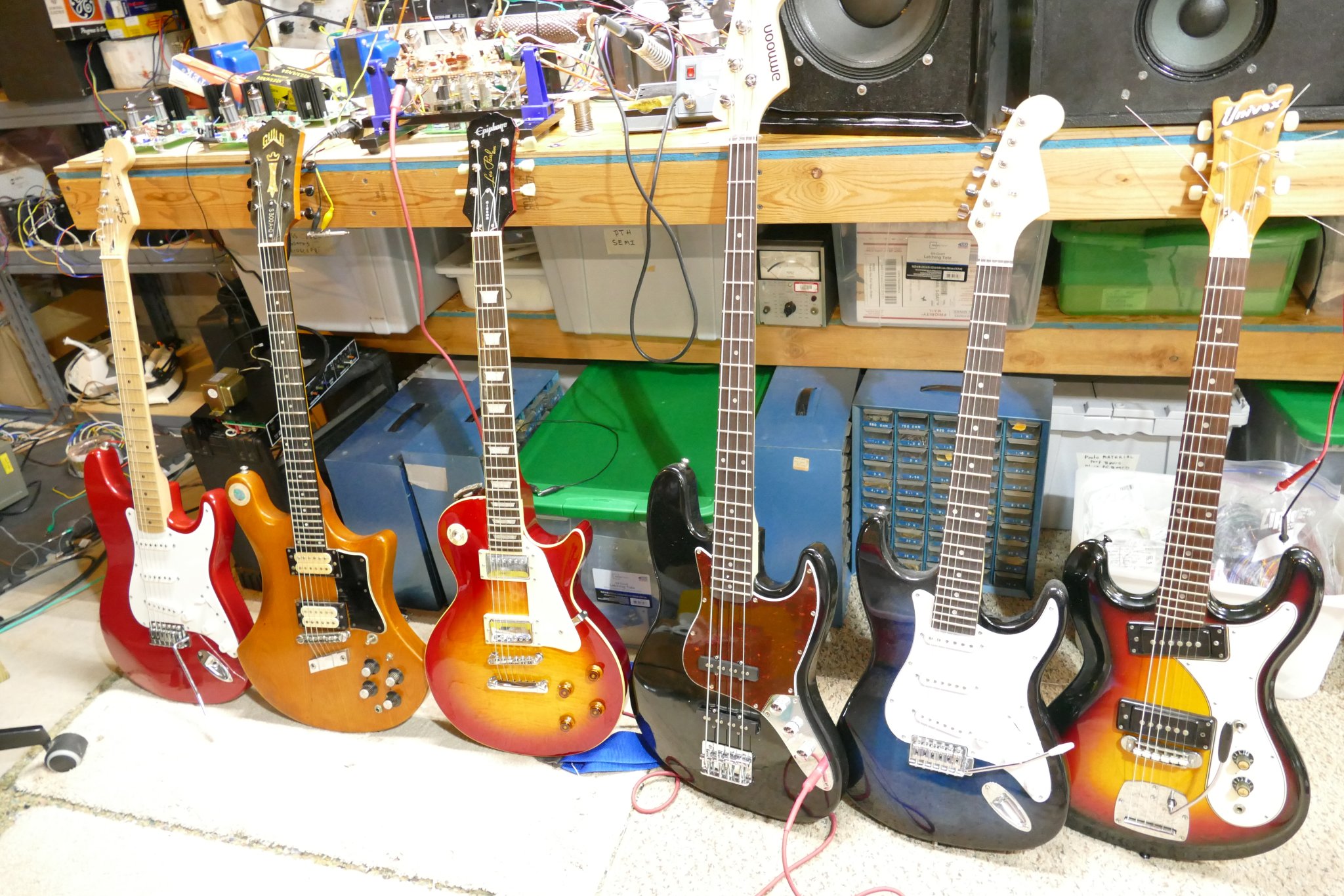

I ran through all of the guitars. The Guild has DiMarzio humbuckers from the early 70's they put out more signal than any of the other guitars, so it's hard to find a clean setting, but sounds great when you do. The Les Paul is the other extreme. I got the big 40 pound speaker off the shelf for that one, as that heavy brick of a guitar is less prone to feedback than the others. The Les Paul / big speaker cabinet combo is really good for loud clean tones......too loud to be near it kinda loud. Of course, I had to crank some surf sounds from the Univox that I have owned for nearly 50 years, but I REALLY need some reverb for that stuff. Again this setup can go REALLY loud since the EV speakers are about 8 db more efficient than the Parts Express cheapies. The amp still hits over 40 watts even with the smaller power transformer. Lastly I had to try it with a bass. I was pleasantly surprised that it sounded good, and didn't blow up even when pushed to near clipping. Tweaking the tone controls can get some near perfect sine waves across the speaker, somewhat unusual for a guitar.
There had been this background hiss which got louder as the night progressed and began to sound like bacon frying after playing the bass loudly shook up the whole workbench. Poking around in the power amp with a plastic tool made it go away, but a minute or two with the bass brought it back. Wiggling one of the output tubes revealed the source, so all 4 tubes got their pins cleaned with a toothbrush and WD40. Problem solved.
I plan to experiment with some gain reduction in the near future, but first I'm going to fire up a guitar amp I built 12 years ago and see if it goes or blows!

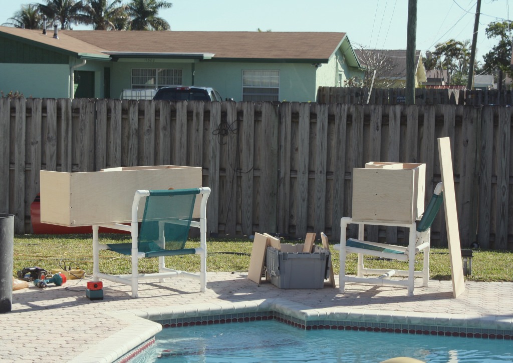

I had several projects underway before the exit, including some speaker cabinet builds. digging through the pictures on my hard drive, It seems that along with some FH-3 and EZ-10 horn speakers, a few amp cabinets were made. The picture of me at the table saw shows both the original 4 tube amp and the bigger 5 tube amp chassis on the ground to the left of the saw. It also shows three cabinets. I can only find two of them. Is there another amp somewhere that I can't find.

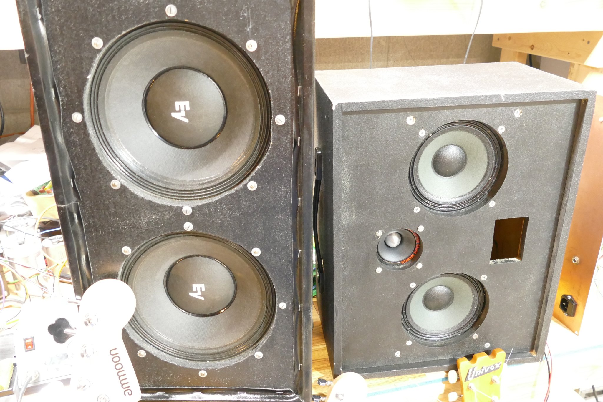

I completed the wiring for the power transformer and mounted a real guitar amp OPT identical to the one that I have been using so far in this thread in the holes that were already drilled in the chassis. The holes were drilled a long time ago as they are visible in some of the backyard pictures. Upon power up, nothing happened. The tubes glowed but there was no sound at all in the speaker until I plugged in a guitar cable. This thing is quiet, but works very well. It's not as loud as the test amp, but sounds much nicer in both clean and cranked operation.
there is obvious evidence that I have hacked on this amp, but so far I can find no documentation as to what I did, or when I did it. There is some cut traces and flying parts under the deck. I don't believe that it has been powered up since it landed in a box in Florida since there was no OPT. The Antek power toroid had been mounted, which was the magic part that was required to meet the budget. Its wires had never been cut or soldered. I ripped it out and installed a real OPT that worked better in original (2011) testing.
