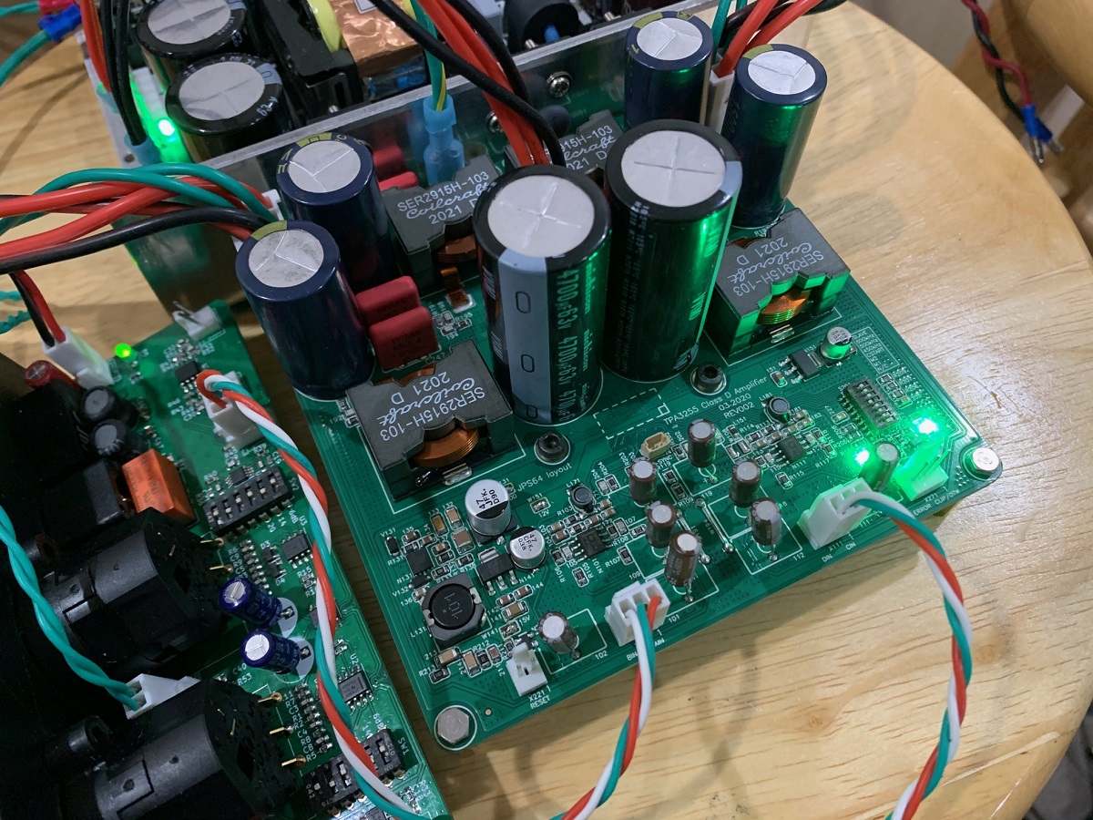

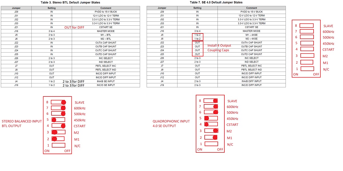

4 Channel SE Output Mode
The amp has been converted for use as a 4 channel SE amp through addition of 4 output coupling caps (where the Faston tab jumpers are located). Althought the factory data sheet for the EVM recommends setting the M1 and M2 switches to "OFF" and "Cstart" to "ON" for 4 ch SE operation, I found that it actually works with the same settings for 2 ch balanced input and BTL output, with just the change in removing the Faston tabs and installing the 4x 1500uF 63v caps at the outputs. There are probably fine-print reasons why M1 and M2 should be set to "OFF" and it has to do with the phase of the outputs, so probably best to follow the datasheet advice.
A few things to note: the installation of the output caps interferes with the 6pin Molex Minifit Jr connector's locking tab/lever. A workaround is to cut off the lever with wire curtters and the connector can still work but lacks the locking feature. Or remove the 6pin Molex header and replace with 3 Faston tabs in the same holes.
The final caution is that in SE mode, the DC blocking output caps have to charge up to 1/2Vcc and this causes a speaker thump upon turn on (if recently turned off) - but not turn off. If one waits at least 15 seconds to allow the caps to discharge, there is no pop at turn on. So main thing is to not turn on immediately after powering off.
I do not have a 4 channel quadrophonic system so I simply connected 4 speakers and had them driven by a balanced source (out of phase and flipped one speaker's polarity to get all outputs in phase). It works and is able to drive 4 speakers simultaneously.

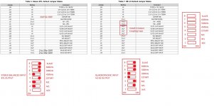

Here is a diagram of the DIP switch settings between BTL and 4Ch SE outputs:
attachment.php

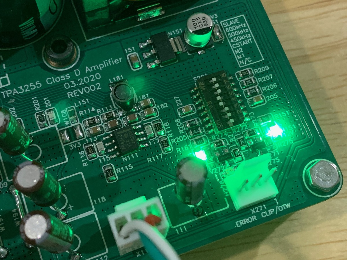

Here is a closeup of the DIP switch:
attachment.php
Here is the board with 4 extra caps and 4 speakers connected to the Molex 6pin Minifit connectors (the green wires are the ground returns for each channel):
attachment.php

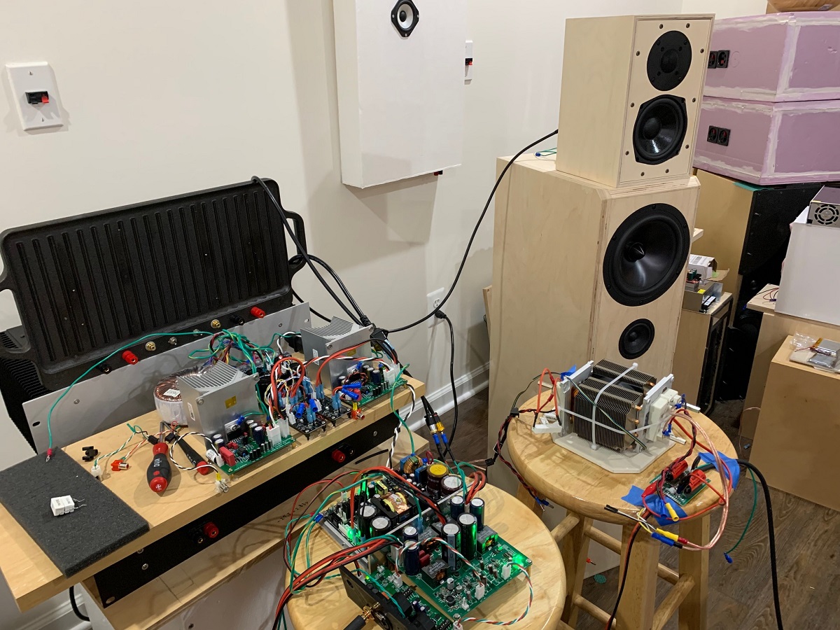

Here is the system playing with the 10F/RS225 FAST TL's and the 5.25in 2-way Rockville speakers:
attachment.php
So this looks like a good way to get 4 channels output for use with active speakers and DSP-based systems. To prevent turn on pop, something like the RTR SSR could be used, or even something like a mechanical relay based start delay circuit. There is no DC offset protection needed as the speaker is cap coupled.
