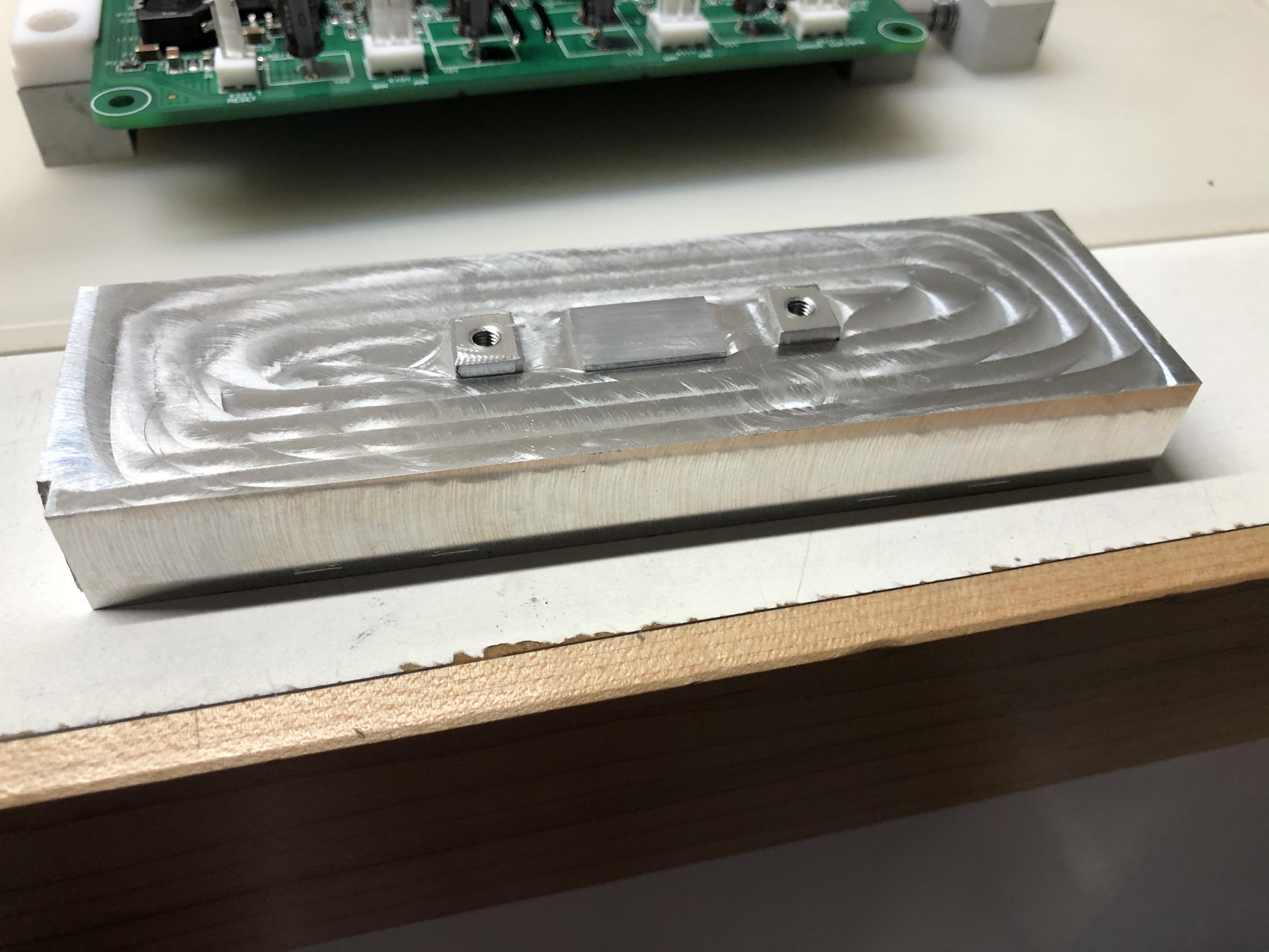

Yeah, I’ve been looking at that drawing you made of the spacer block and the CAD file that is on that page you linked. I plan to take those dimensions and either get an interface block made or get one of my heatsinks milled to match. I like the idea of the interface block for easy ground isolation between the heatsink and the interface block.
I ran it with a small heat sink for a little while, the heatsink pretty quickly exceeded 70c.

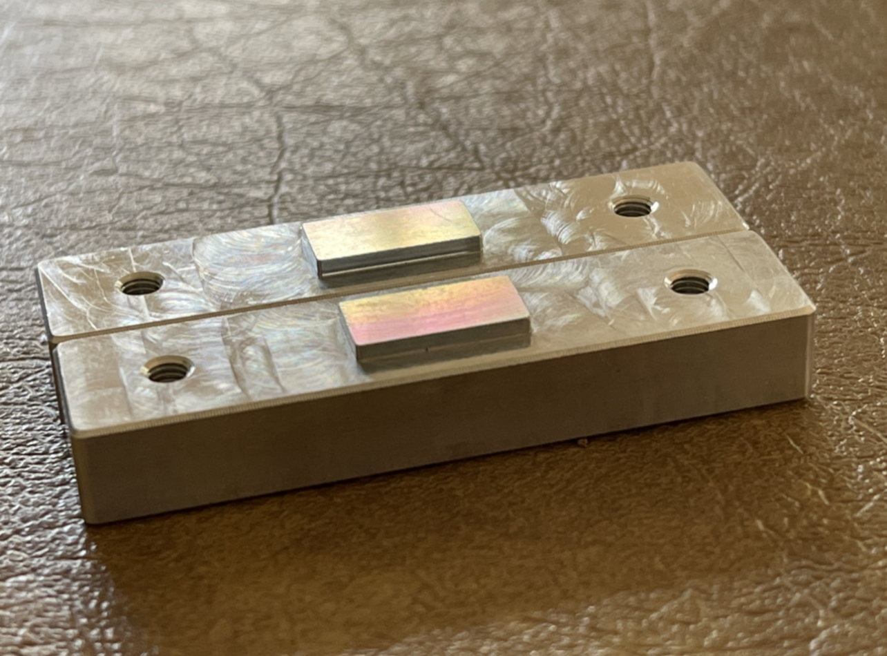

I have a batch of these nicely CNC made thermal transfer blocks designed for this amp. I’ll put them in my shop. Notice that all surfaces are milled flat. They are designed for proper stack up height using 10mm M3 brass standoffs on the PCB with this block and 0.5mm to 1.0mm thick silicone (electrical insulator) thermally conductive pad between the chassis and the block. The block is held onto the PCB with two M3 screws from above. Make sure you use thermal compound between the block and the TPA3255 chip thermal pad.

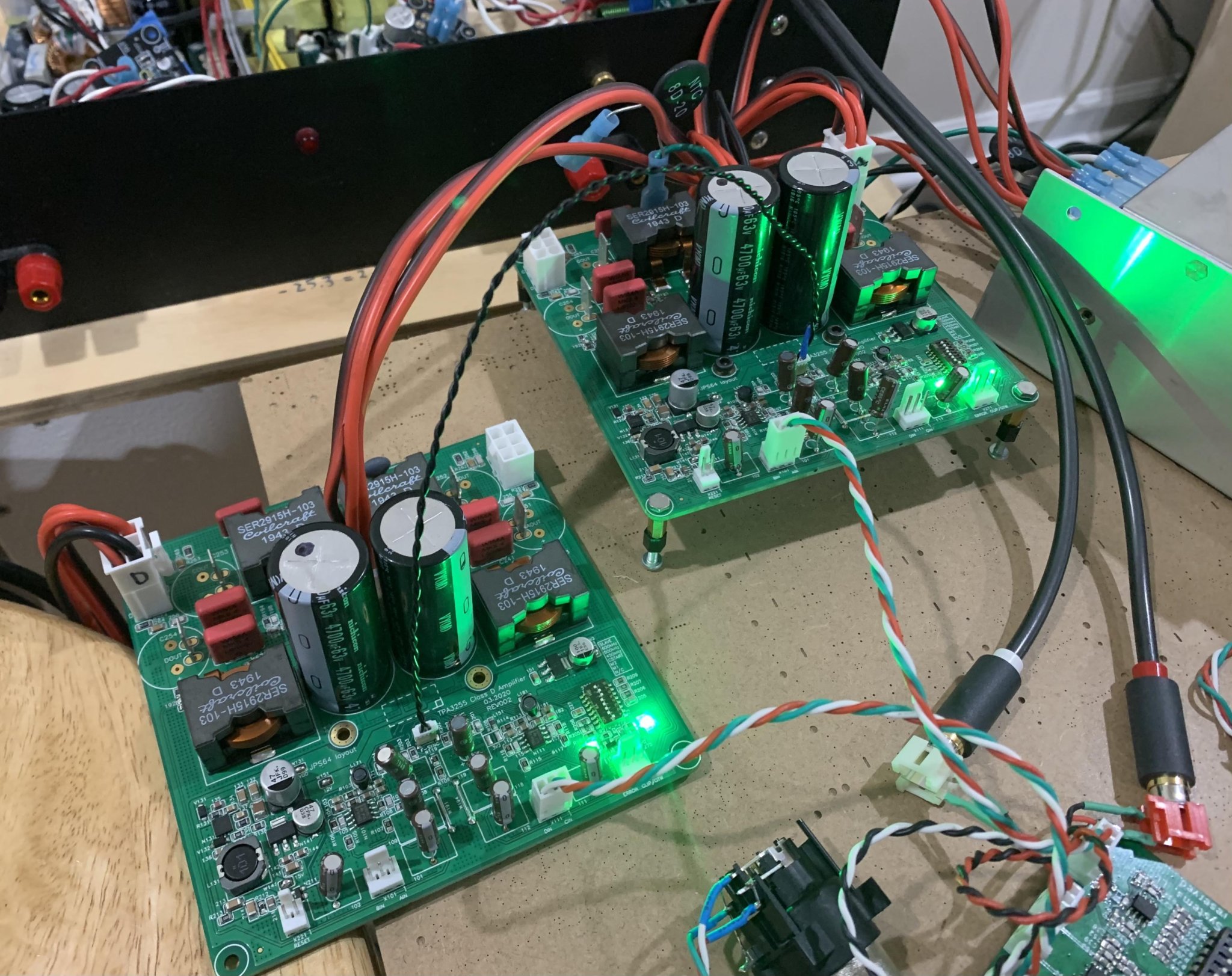

We are really close to being able to start this second GB production run. I do have some good technical news. I finally tested out the master/slave frequency sync feature designed to prevent beat-note noise when two amps are being driven together in the same box and psu. I bought pre-crimped leads for the tiny connectors and set one as master and other as slave using the DIP switches. It all works as expected. So, if you are looking to use this AN’s multi amp in an active setup (perhaps for LX521 etc) it can work very well.
You can see the black twisted pair cable between the two amps.
Can this be considered a "Dual Mono" setup? What would be output power per channel of this configuration?
