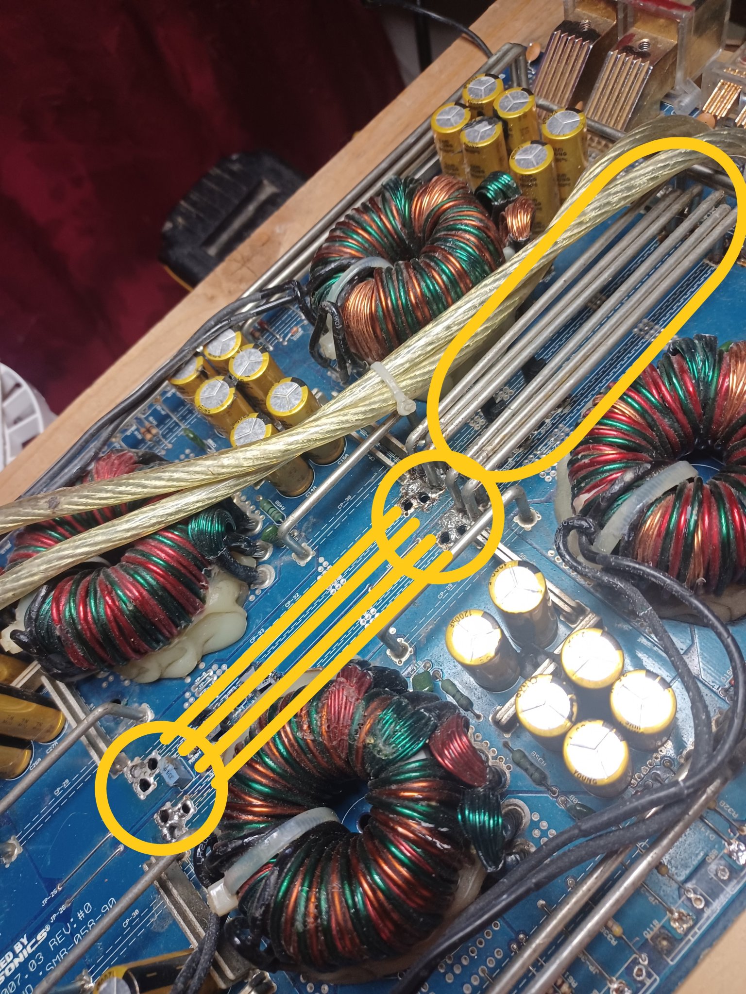

i have a few junk amp boards i could possibly salvage one from, what would I use it for?There should be no signal on the source of the PS FETs. That's ground.
Are the PS FETs in the board, or not?
Do you have a small capacitor in the range of 0.01uf and 0.1uf?
