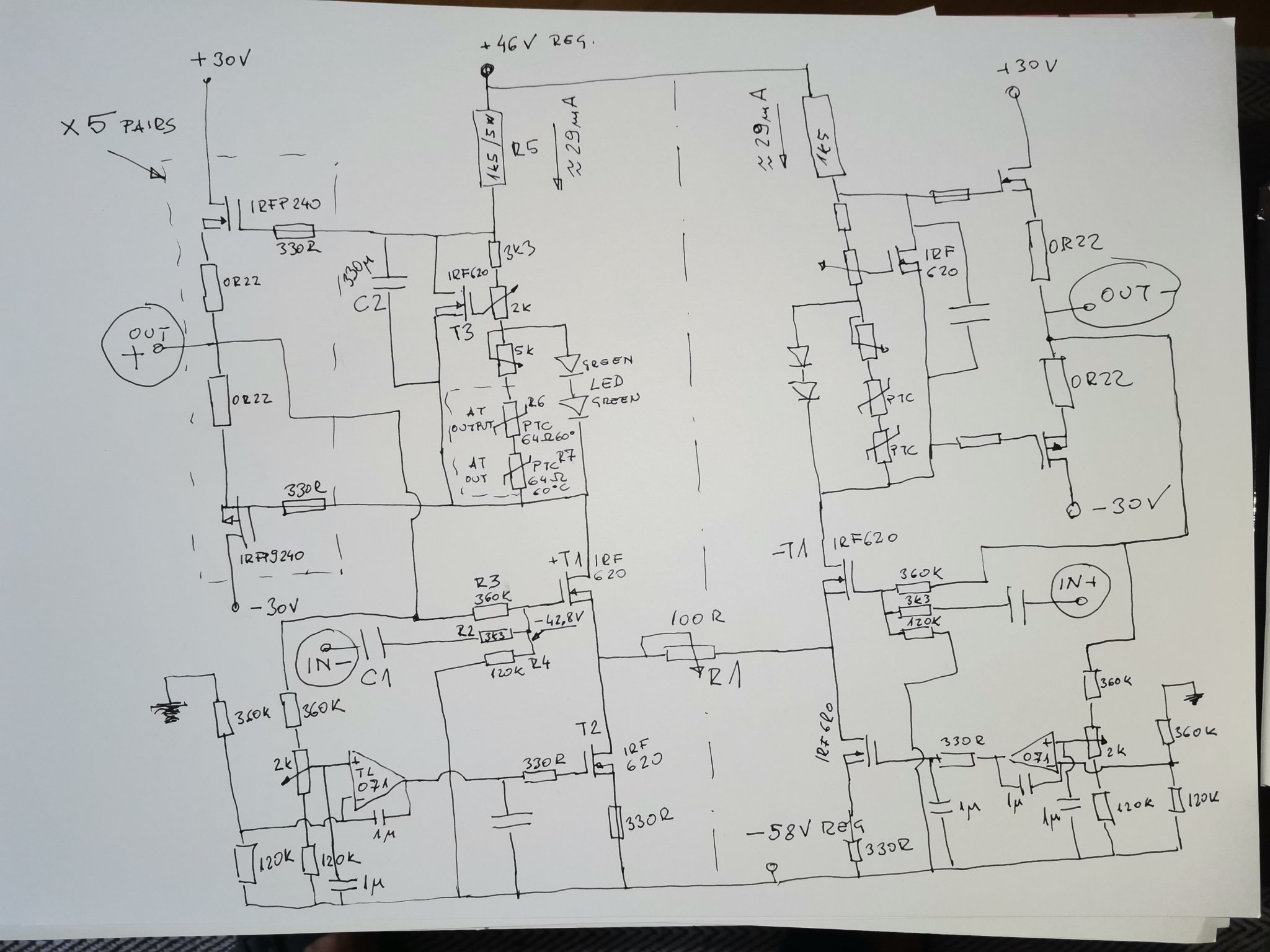

This is roughly the circuit diagram of the main amp without power supply and power decoupling capacitors. Sorry this is just hand drawing. I tried to use TinaTi but it was too much challenge for my nerves today. I will describe what is done and why.

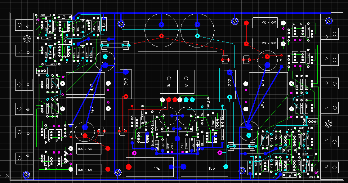

If anyone is interested this is main PCB layout, I'm mechanical engineer and always used Autocad, also for PCB drawings.
If any of skilled members would like to move my mess of hand sketches to SPICE and help with improving, I would highly appreciate!

The whole thing is an differential amp, made of +T1 and -T1, followed by push pull mosfet pairs (5 of them per + and - output, total 40 pcs of IRFP240 and IRFP9240 for stereo).
Very little feedback (in inverting amp mode) is arranged with R3 and R2, one being 360kohm, and other 3k3, that would give gain of 109 V/V if amp would be indefinite gain.
However, I reduced a gain with R1 to match 19 V/V overall gain which is used . In years when this was conceived and built, many discussions were going on about benefits of NO Feedback at all. I knew that some will be necessary with push-pull output, so minimum is applied.
Below differential pair +T1 and -T1 are current sources 2x T2, they are driven by DC servo opamps to ensure no DC at speaker terminals and close to ground output DC
On top of differential pair are + and - T3, which form a bias network for output mosfets. Here I wanted absolute thermal stability so special PTC resistors are used. One is mounted on one N, and other on one P output mosfets. Their characteristic is that the resistance goes up at 60°C. Basically its thermo regulated heater.
When amplifier is cold, bias current of outputs is 1.86 Amp. When full warmed up it is 1.12 Amp.
When music is listened on low level, A class is going up to approx 6 watts in 8 ohm, then it goes to AB class .
Of course, when party is on, this is AB class amp.
Now I opened this amp to see what I exactly did then, and at first it was not clear for me why I did bias as it is, but I remember: first I adjusted minimum AB class bias with 2k pot without PTC resistors in place to achieve AB class regardless of heatsink temperature.
Than I added PTC's and adjusted A class bias with 5k pot. As the heat goes up (from bias or music) PTC keep output transistors at 60°C , what amp class do we listen, dont know!!!, Small levels its class A, high levels its class AB

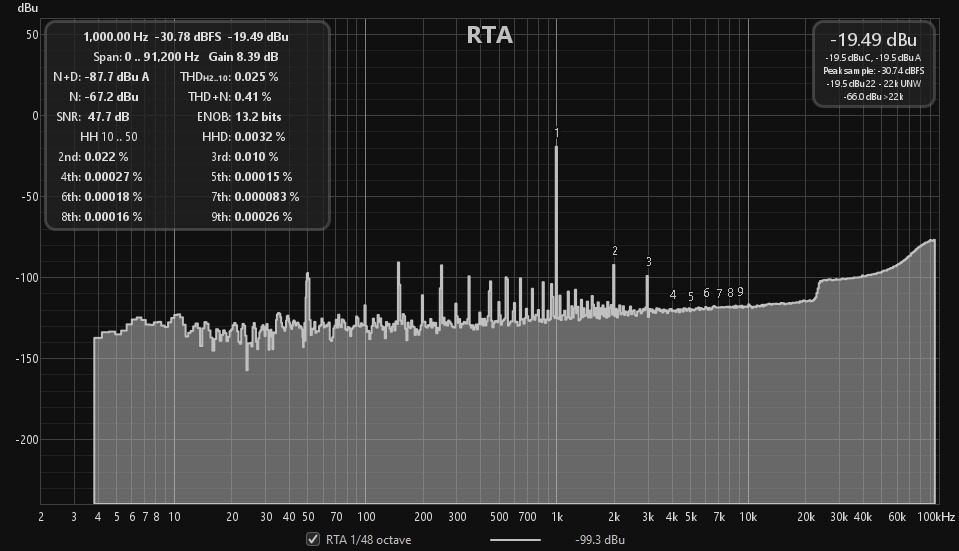

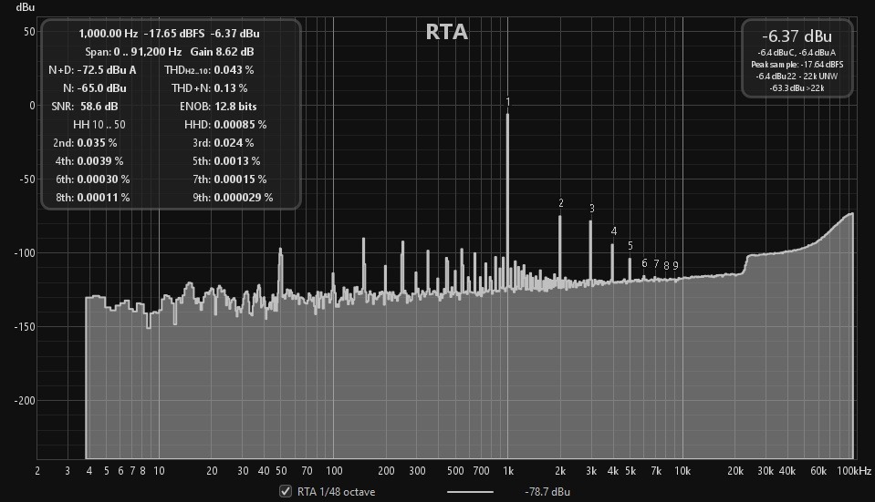

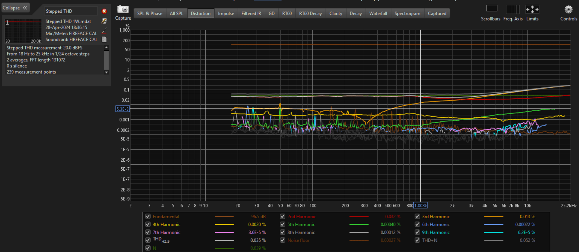

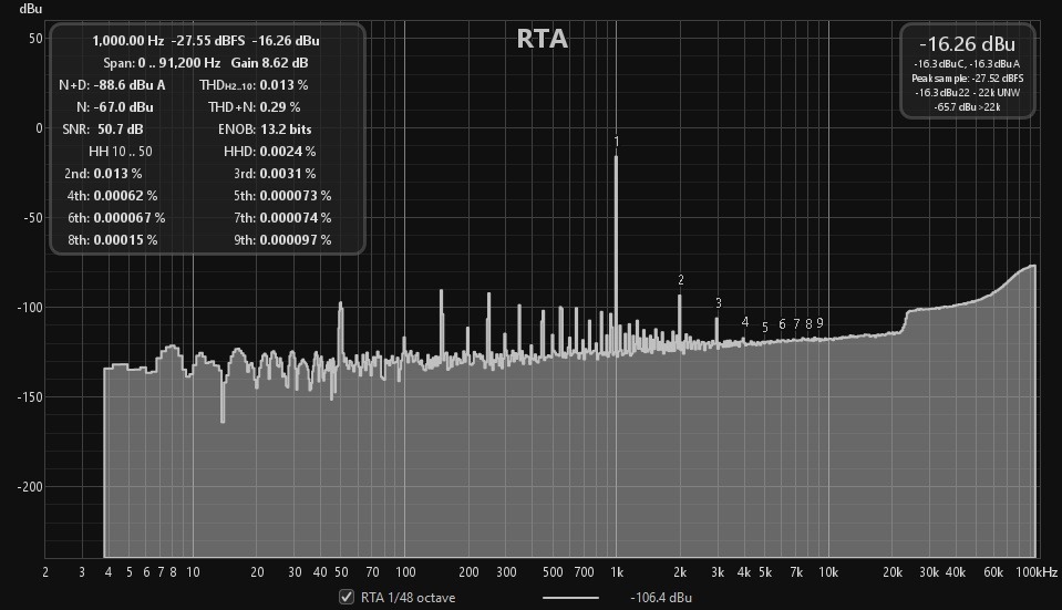

The measurements:

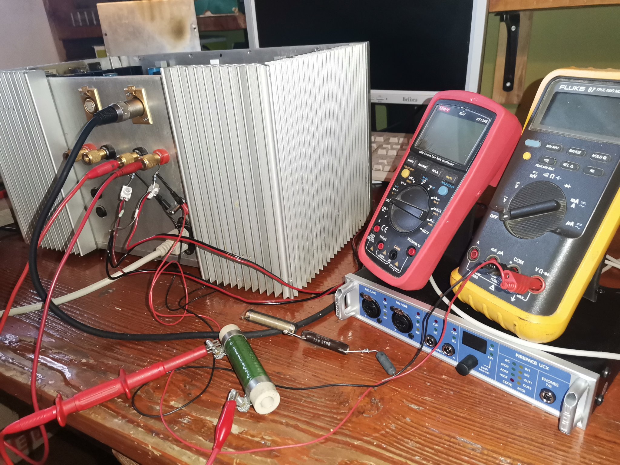

When it was built, I had only analog frequency generator up to 100kHz and good Fluke true RMS multimeter. Than I measured that frequency response was up to 100kHz minus few %, that was good enough to put it in use.

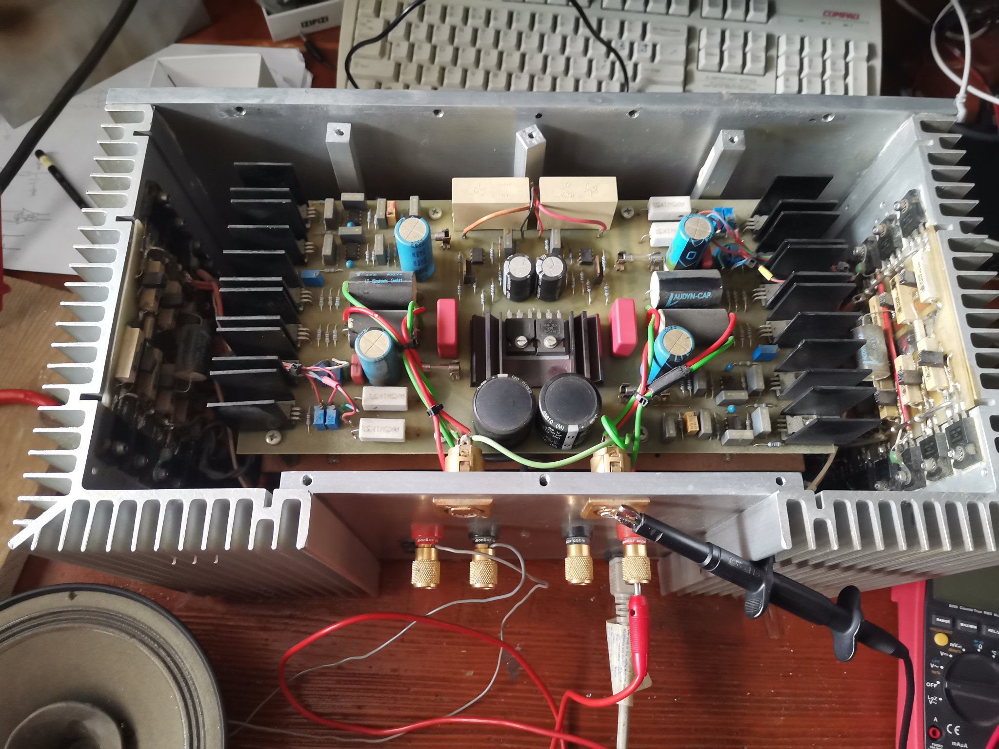

Few days ago it was taken out of setup into work bench;
Measurement set up is windows PC with REW, RME Fireface UCX interface in ASIO mode, calibrated, with one reference loop in - out, and other output going throuhg amplifier back to input. For RME input I organized 4 precision resistors to bring signal level back to unity gain, without buffering.
Amp was measured with 4 ande 8 ohm load for low medium power, for high power I used 10 ohm as this is only 100W resistor I have.

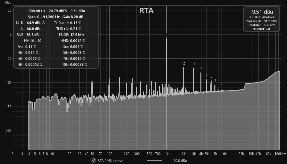

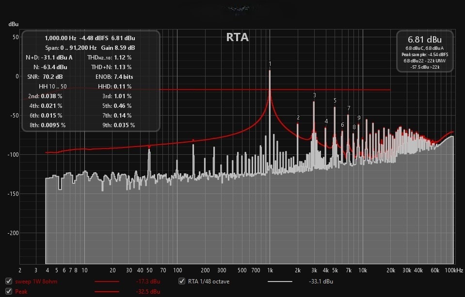

This is torture test: 41 V RMS in 10 ohms:
This is obviously last useful power before clipping, 1.12% TDH, now with dominant odd order distorsion.
As I was testing this for minute or two, I felt burning smell, quickly shut off the signal and looked, my work bench started burning under load resistor, amp was just cool as ever

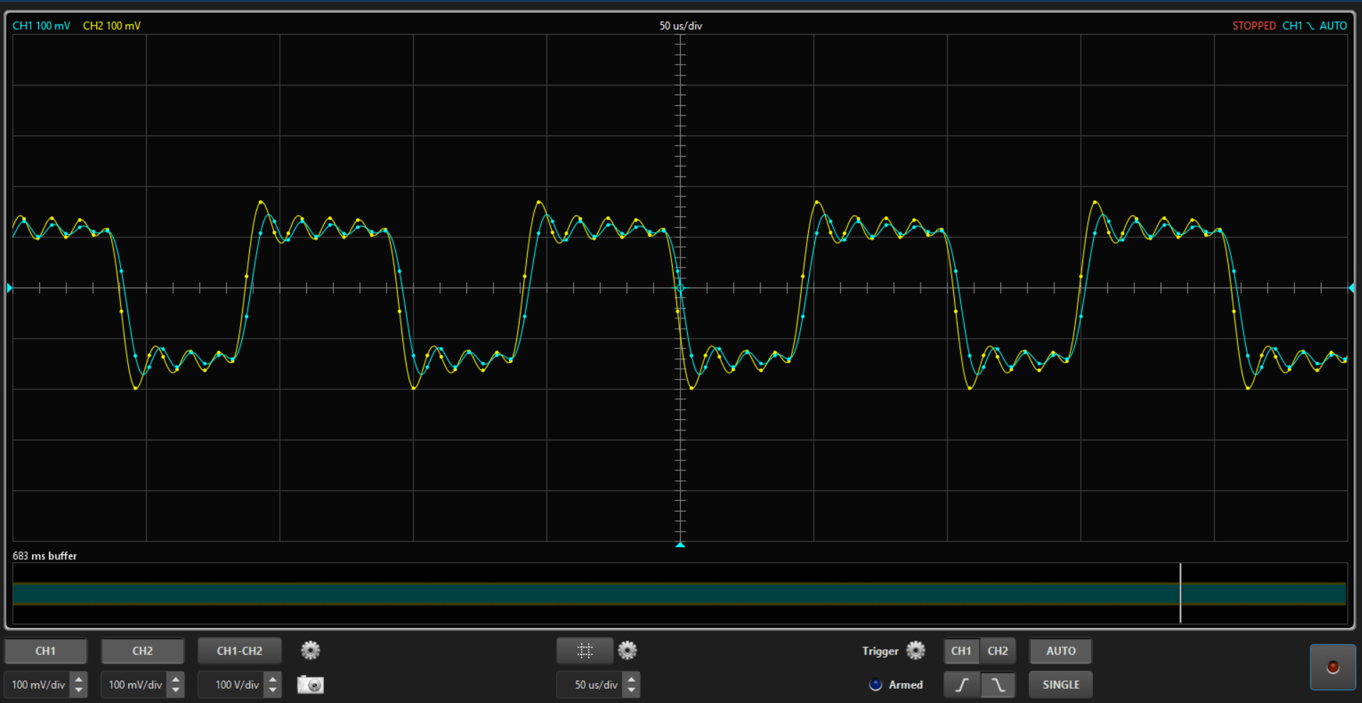

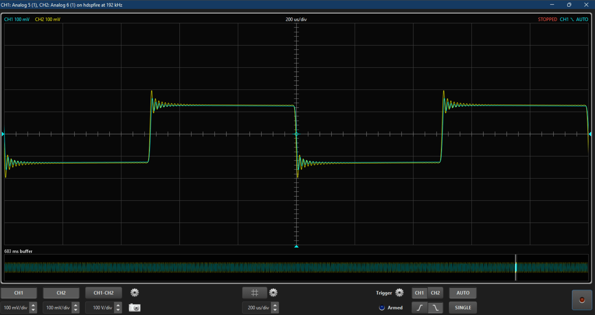

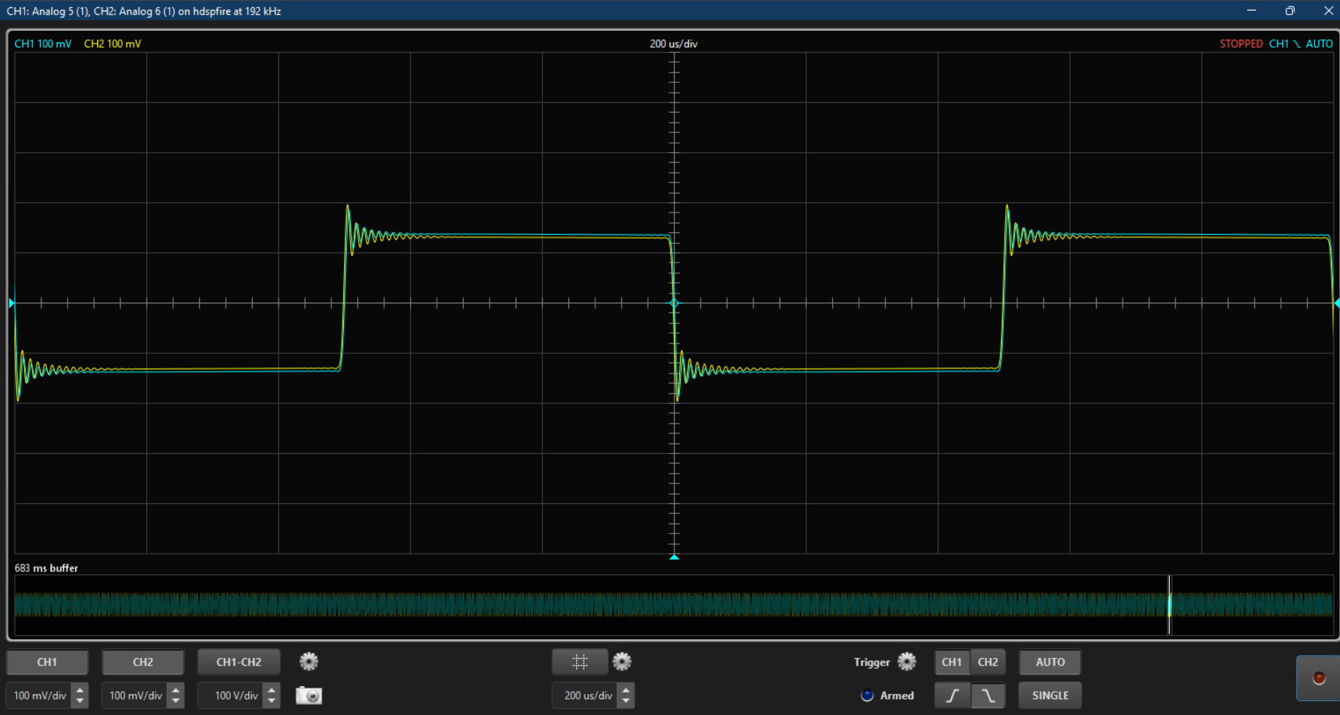

Unfortunately I don't have analog oscillator any more, only square wave I can generate is through 192Khz/24bit RME interface, this is naturally not square wave due to digital frequency limits.
To make picture little bit clear, I used digital scope measurements with both inputs: RME closed loop and signal through power amp afterwards reduced by resistors network to nominal interface input level . Yellow trace is always RME closed loop input: green is imput through power amp with different loads that are mentioned
This is 1 kHz square at 8 ohm (zoom to see difference between traces) :
This is the same thing into 4 ohms:
Than 10 kHz square into 4 ohm, this ntime at 8Volts RMS output, to see slowing down with higher frequency and power:

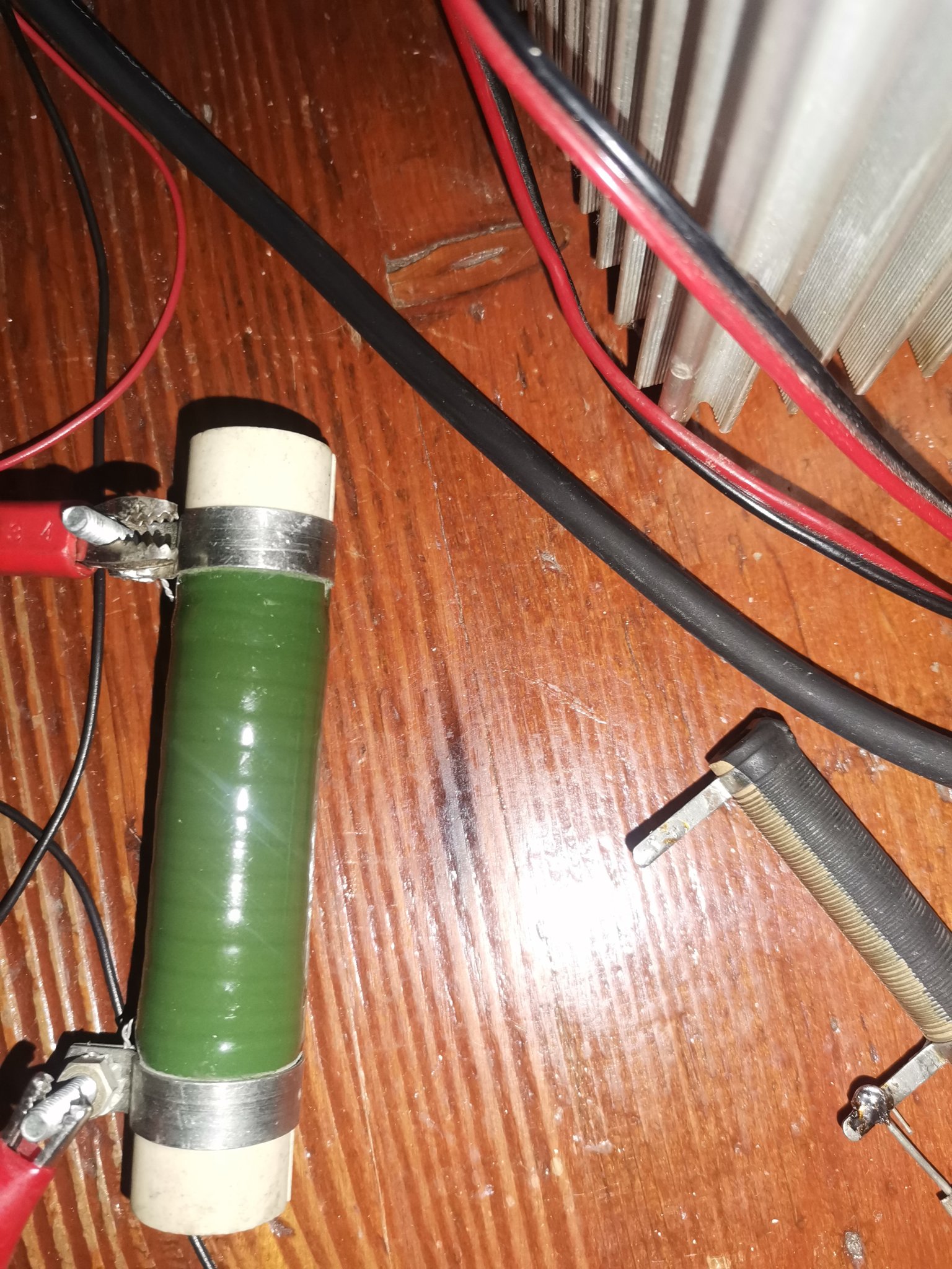

More, I tried to measure output impedance:
- With 42 Volts RMS and no load i connected 10 Ohm resistor
- Lots of sparks while connecting alligator clip!

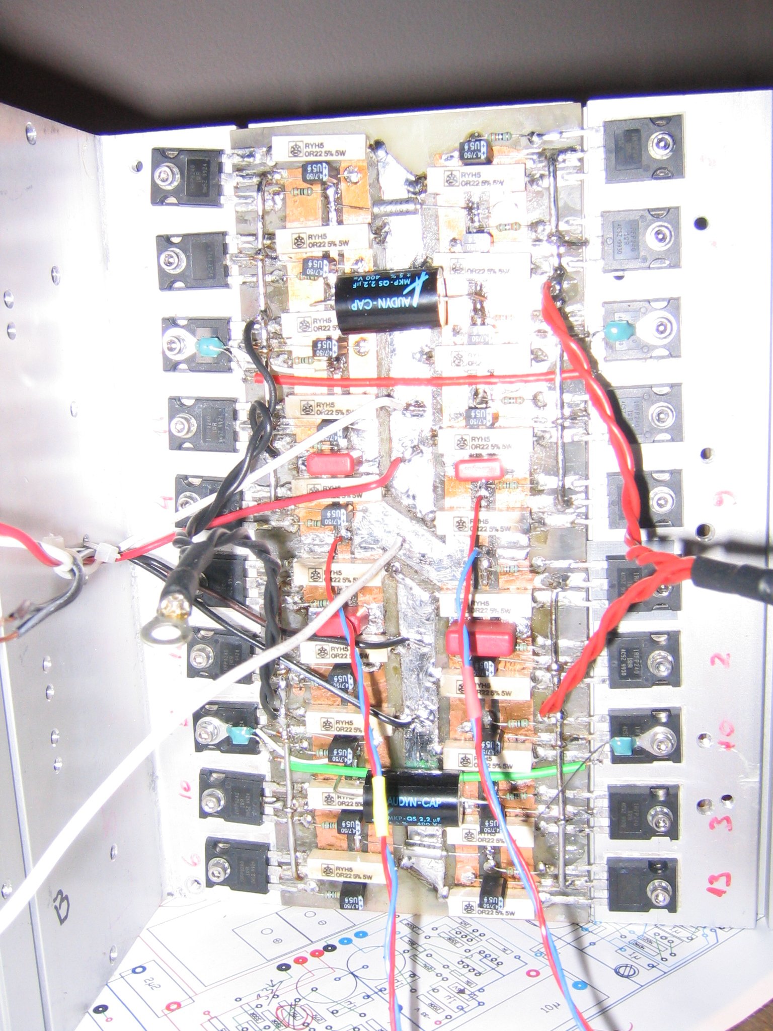

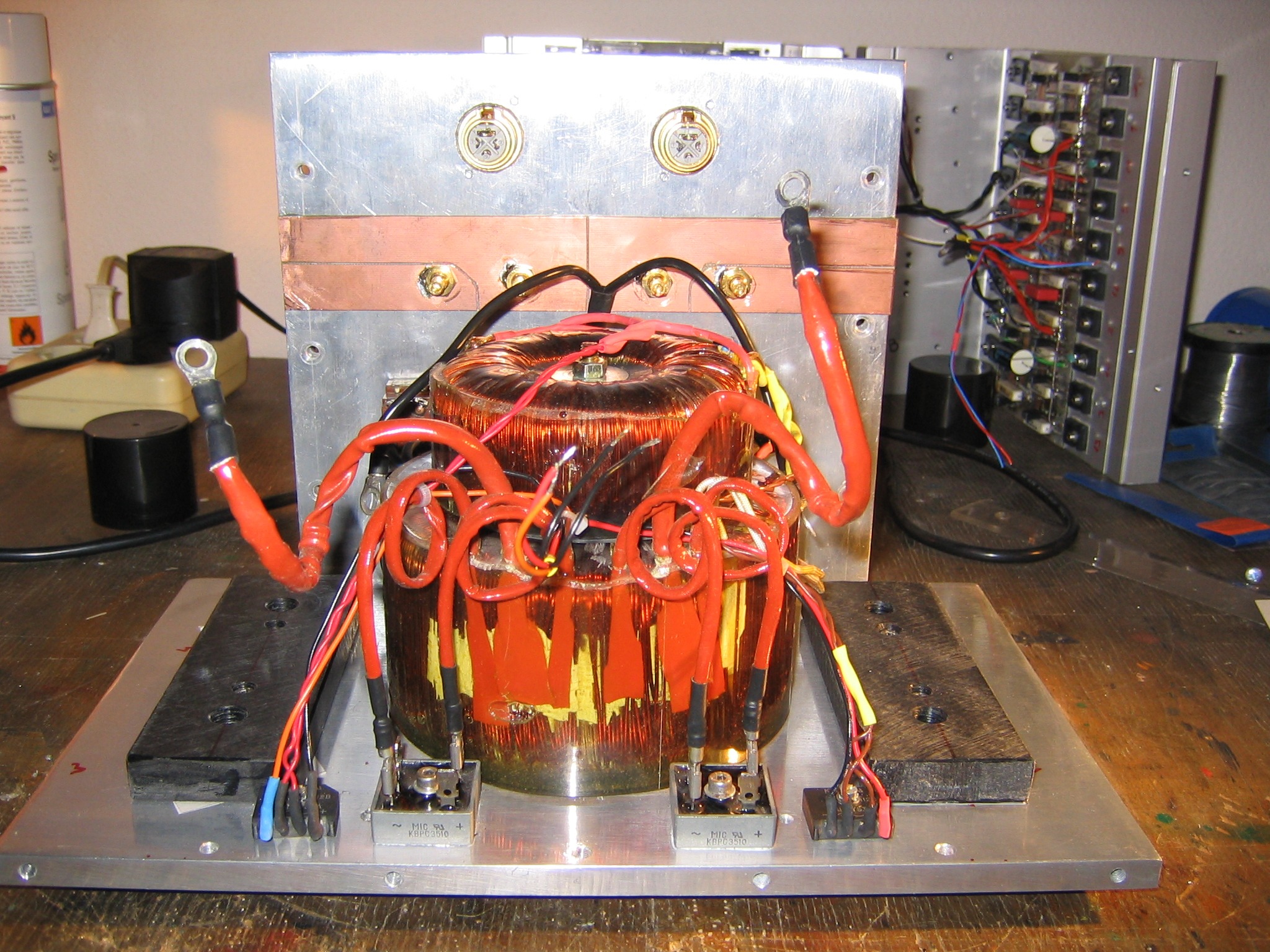

Before I need to pick up my kid from school, few pictures from 2003 and 2004, when it was assembled:
600VA transformer with 4 windings for separate l and R channel power. On top is higher voltage transformer for drivers:

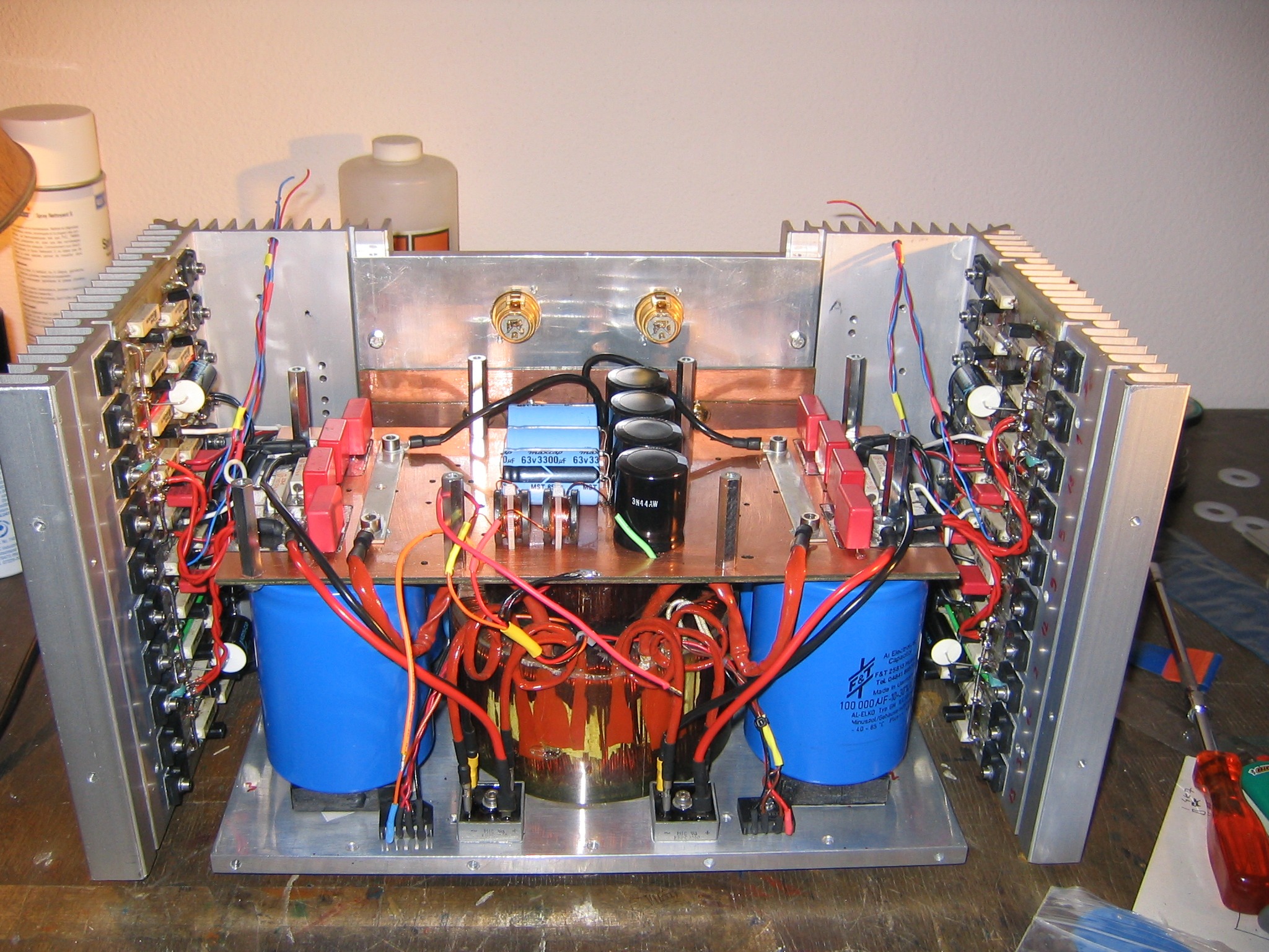

This is power c stage; 40 IRF-s for current delivery, here you can see thermo regulating bias PTC resistors mounted on top of IRF-s (green bubbles):
These are power supply filters; 100,000 MicroFarad per rail per channel (totally 400,000 microfarad) for power. And inductors followed by about 15,000 MicroFarad pre filter for drivers power supply

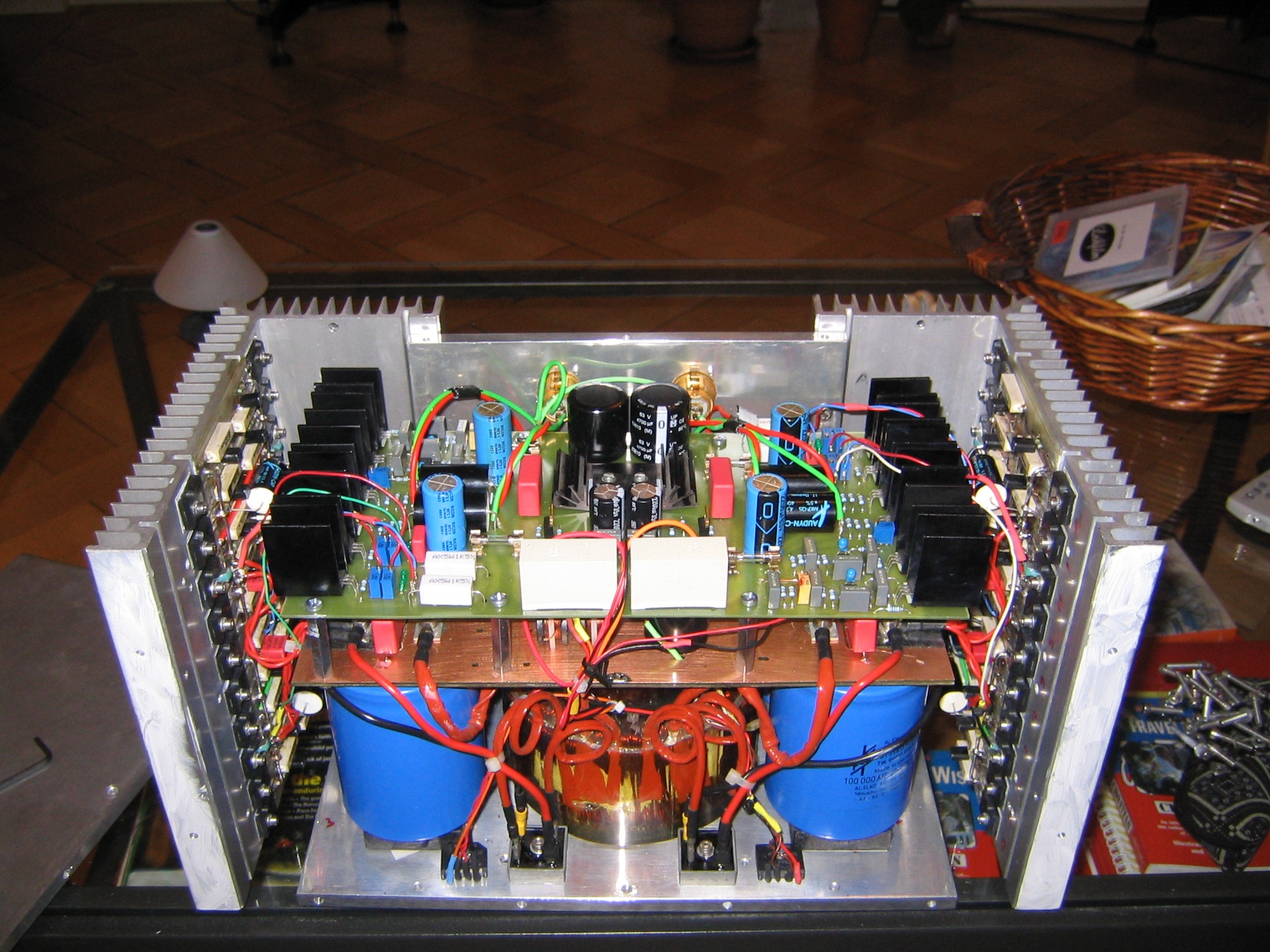

On top of everything, main PCB board, left and right are L and R voltage gain amplifiers, in the middle is regulated PS for those and DC servo opamps.

After quarter of century in use, and me being equivalently older , reviewing old diagram after the lid was finally opened; here is dusty picture of today:
I will try to update this machine;
- For sure I will open it up completely and replace main transformer. Even existing one is sealed in epoxy, this 600VA still makes some buzz. Nothing is coming out of the speakers, transformer itself makes noise, tried with mains DC blocker and filter, that's not the cause.... I have one 800VA toroid that's quiet (probably because I ordered 1kVA core double vacuum-varnished and backed. That goes in now and for that I need to disassemble everything, this buzz is not really loud and not heard with quiet music, but its matter of OCD.
When I'm already into digging, some other improvements can be made, here in forum we have many amp masters, suggestions are very welcome!
These are my ideas for improvement:

Looks like your amp does pretty well at low powers, but at higher powers, perhaps when it switches to class AB, distortion increases. Your power supply is working very well, the mains components are pretty low. Did you experiment with the bias settings? You'd really want to operate this in class A as long as it's thermally possible.
You got it right, that was intention. to have A class amp for first watts (and home listening) and still massive output capability with cost of higher distortion. Idea was is when we party and volume is high up, everyone will be pretty drunk by then and distortion is less relevant .Looks like your amp does pretty well at low powers, but at higher powers, perhaps when it switches to class AB, distortion increases.
Now if I want to increase class A portion, I can change 60°C PTC resistors to lets say 80°C . More heat and shorter life of components. Or to increase cooling, that costs in size and mechanical complications...
As above, other options are to increase NFB, just then this is not low feedback amp any more... compromises, compromises...
Might be the best compromise would be to change T1 (both +and-) IRF620's to something more linear in hard job that they have?

a 1KHz squarewave into 8ohm ( a very easy test ) should be clean without ringing
