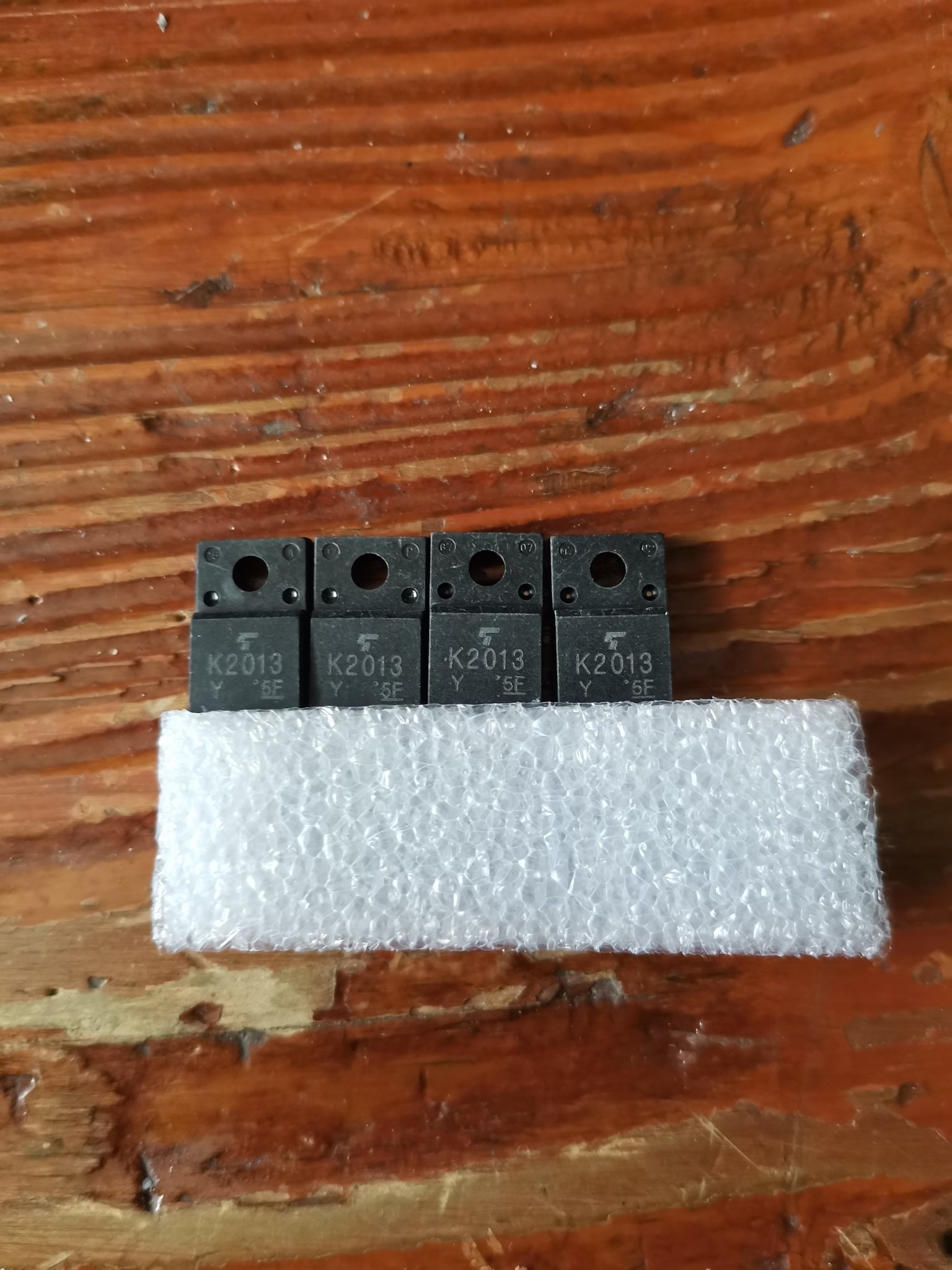

Except main transformer I would only like to change T1 for something more linear. Which Toshiba's did you have in mind? I can get 4pcs 2sk2013, do you know anything about them?

2SK2013, yup - I meant those - they're all the rage, used with cousin in, say, BA3 here and few more, besides being used in PL products

Toshibas are in the house
They even look like genuine, not fake. But I'll test those before insatlling
Unfortunately couldnt find 2sk109, than remembered they went into phono preamp for friend some years ago, dementia 🥴.
Other rebuilt material is gathering, so soon I'll start with it.
Well, not good, seems I bought fakes!!!
I just measured Vgs and it shows approx 3.7V, that's more than 1Volt higher than Toshiba spec for Y grade.
This thread shows almost exactly the same transistors as mine :
Fake or real 2SK2013?​
They look so real and genuine!!!!
Before I go to shop (which is real psychical shop with Name, address and VAT number, so possible to report to consumer protection inspection) and raise the hell;
Is there possibility that Toshiba had 2 versions of this transistor? I know there is just remote possibility but better check before accusing someone.

So I returned fake transistors to the shop, they just paid the money back without asking. When I asked why do they do that (selling counterfeits) as it was obvious guy knew it was fake, they told me that now I know so my problem is solved. You can buy connectors and cables, but nothing sophisticated... Nice...

Unless someone has to offer 2 pairs of original 2SK2013, 2sk213, 4, 5, 6 or 2SK2162 (I,m not sure if list of right transistors is exhausted by this? please propose others if you know) , first I will spend couple of hours testing chokes in main PS (results will come soon) and than I am closing the chassis and putting amplifier back in use where it belongs.
