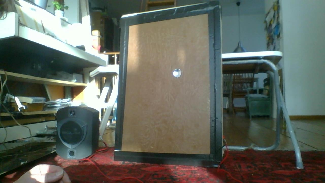

It's a 3 mm nomex/paper skinned 60x40 cm panel with a Xcite driver mounted in the position of the Russian Sheet Control patent. I made a kind of rolled paper suspension with gaffer tape all around. A small whizzer is mounted a few cm from the driver for cheating a bit more top end.
Sounds pleasant, enough bass when it's on floor (coupling?), a little dip in the 150 Hz region (probably the standard low dip I see in all the measurements here online).
Works good for nice mono recordings like Chet Baker singing etc. You have te feeling of listening "through the panel".

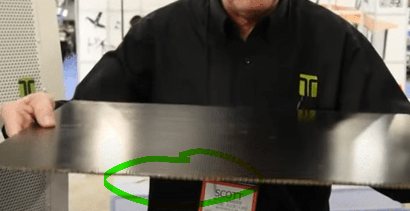

Yes @Veleric , @Groundloops , @RMAM , I'ts equal to coroplast (brand), basicly Prolipropilene Plastic comunly used for advertizing panels
and problably by Tectonic DMLs like in the following photo ( Tectonic PL12), they seen to skin the surface with some kind of vinyl (not sure), but knocking on the surface sounds the same.
Those panels cross-over the DML section at 100Hz plus a ribbon at 7Khz and a sub at 100hz (they are used more on large instalations)

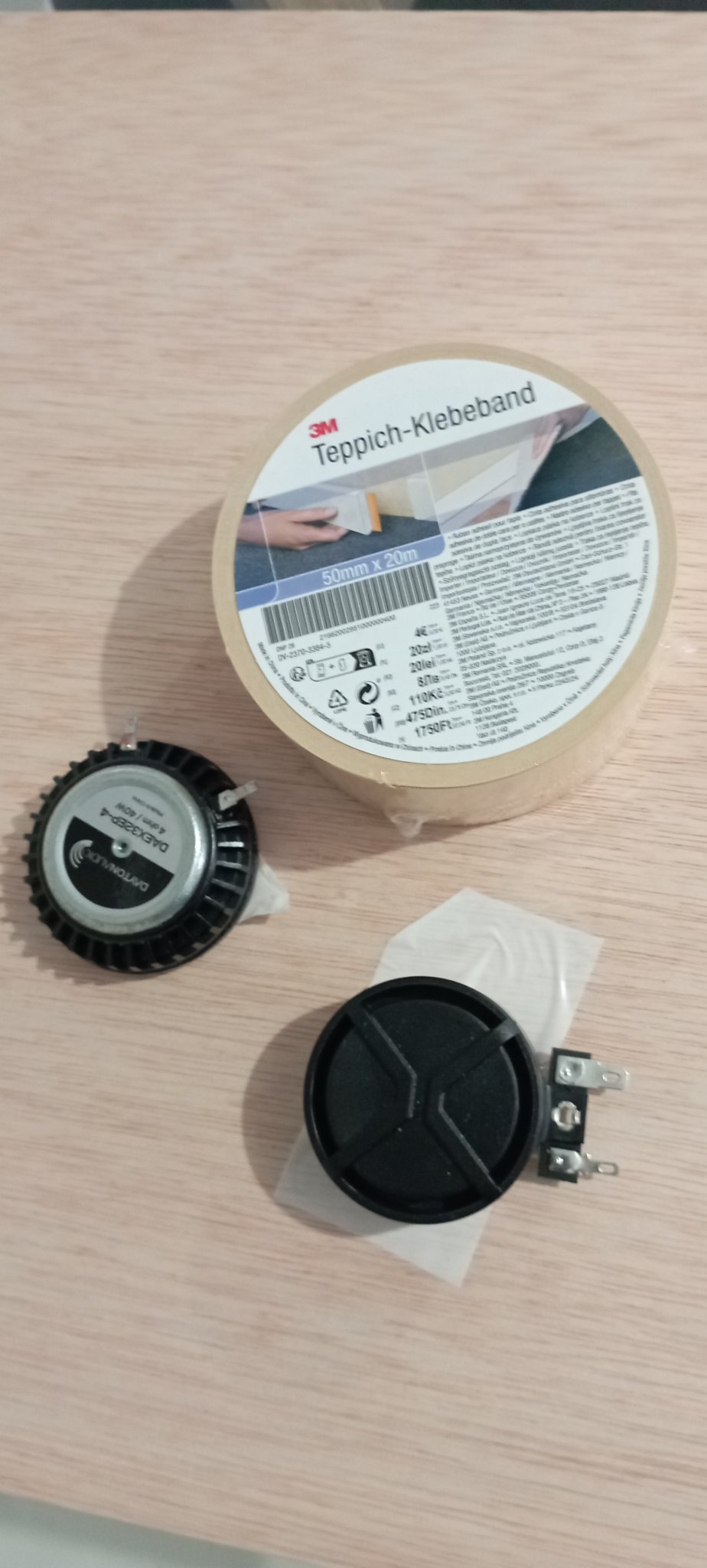

What a usualy do is : remove the 3M preinstalled tape ( the best way to do that is to use some drops of Zippo lighter fluid, it's like magic on most of labelling tapes and doesn't damage plastic surfaces, believe me ), then I install a large piece of another type of tape ( Double sided Mounting tape used for carpets ), it's very thin, so no damping at all.I to have wondered about the 'sticky tape' mounting of my 40 watt Daytons.
The tape is said to be a premium 3M product, but because I am using twin exciters > 80 watts
I am expecting quite a lot of panel movement at higher volume levels
I think I will start with the tape, and if need be, move on to 2 part epoxy.

Hello Pviegas,I'ts equal to coroplast (brand), basicly Prolipropilene Plastic comunly used for advertizing panels

I compared the panel in a bigger room (the theatre I work in), and it was ....interesting. The competition was quite stiff because I compared to a Meyer upq-1p (very expensive and high power active speaker). The panel was indeed a lot wider covering, and had less top end (but the meyer is quite extreme in that respect). The panel was sounding less direct/more difficult to pinpoint, but that could be mainly because of the dipole character.
The "natural sound" I am after might have too much downsides (too much room reverb). I'll have to built a few more panels first to really try it for live reinforcement.
My panel actually sounds quite good, but different (!). It is difficult to pinpoint what it is. It lacks in the 150-200 Hz region, but I only percieve that when comparing to other (floor monitor) speaker. When listening to music without comparing, it sounds good (to me). I have to test it singing through it. It may well be that the lack of midbass is awful/uncomfortable for PA use.
So for now the panel is great for listening music in a small room, but in a big room strange things happen.
BTW 1 I solved my problem of more drivers making the sound more fuzzy/indirect by using a dsp and x-over at about 630 Hz, and feeding the two drivers a different kind of the spectrum. That seem to work really well, but unfortunately extra complicated.
BTW 2 For the more technical minded : I'm loosely trying things and relying on my ears not because I think I have golden ears, but because it's just too complex for me. The differences I can hear are there because they are not subtle (else I would not percieve them). Then I try to solve the problems.
I tried in the centre like Tectonic, and for this panel in a line like in the Russian patent.
The setup that works best for me is also copied from the sheetcontrol monitors : 1 driver at the "best spot" and one in a corner opposite, with the low freq part going to the "best spot" driver and the rest to the upper corner.
