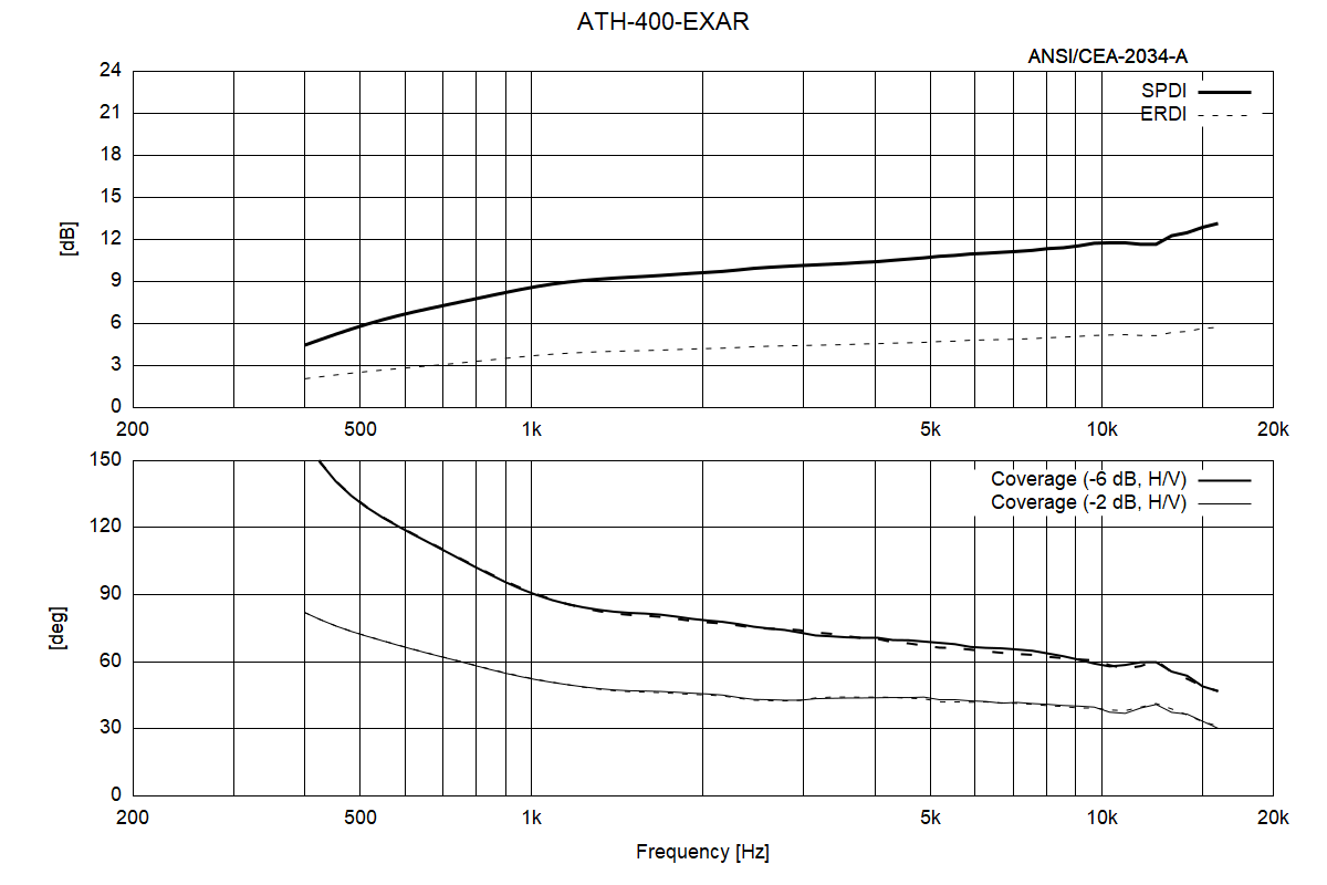

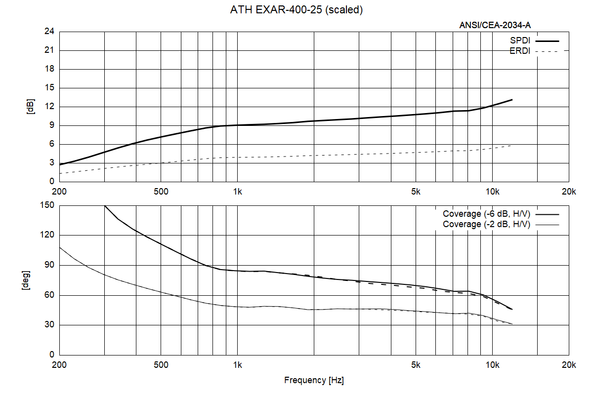

The original and the scaled version:
Reactions: 3 users
Thnx, @mabat
I was most interested in trying to extend the driver bandwidth downwards - and it works. But I'm still surprised at how consistent the treble sounds, except that in the extreme couch positions, the soundstage doesn't hold as well as it did with the 950 RCF horns. But a little more toe-in and a little more treble in the direct radiation and everything works fine again.
Reactions: 1 user
Anyone who can get the original EXAR 400s 3D printed should absolutely try it with a capable compression driver. :)
I use it with SB65CDN-T with a 1.4 inch to 1inch throat insert (horns partnerd with Satori WO24P woofers). The complete system is driven by a small Zoudio amp. The system is magical. Best music system I have had/made/heard at home yet. :)

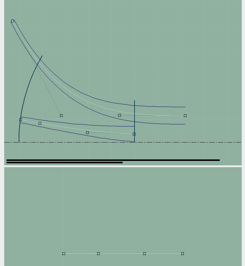

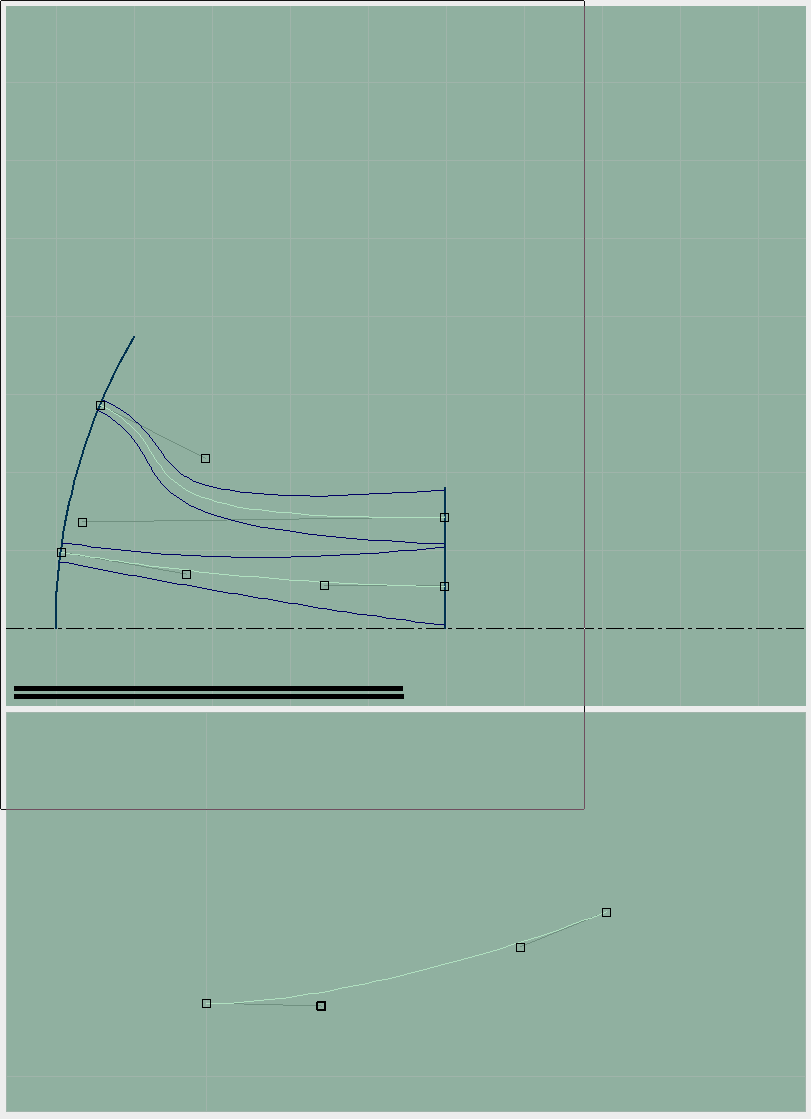

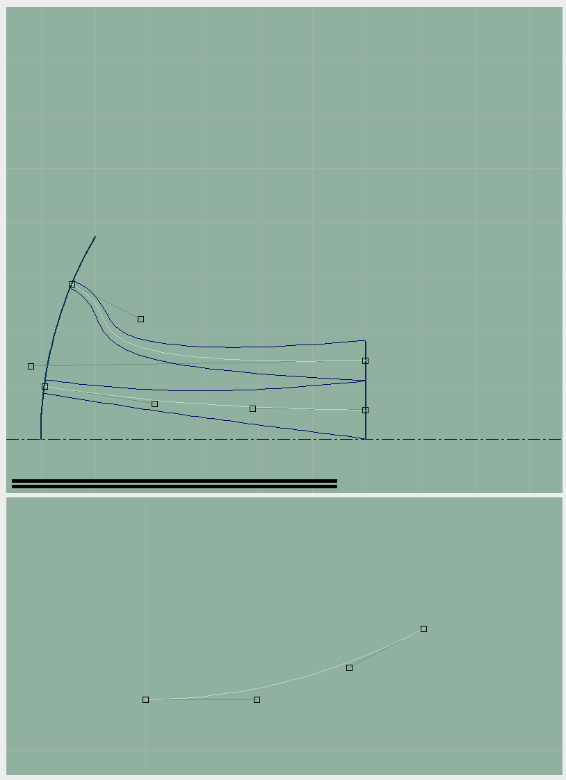

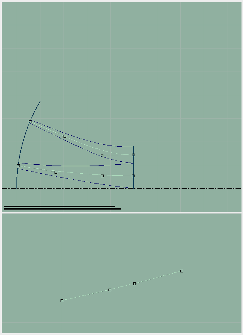

Working on a new toy - a phase plug design tool.
You freely draw a channel centerline (as a Bezier cubic) and it automatically sets the area expansion to the one prescribed by another user-defined curve (the one at the bottom). The black horizontal bars indicate the lenghts of the channel.
I played with it for a while and it's not so easy to design a good phase plug :). Now I need to implement an export to ABEC.
Reactions: 6 users
Any number of channels. Convex dome will also be an option (for a spherical output wavefront, which seems impossible with a concave diaphragm).
I only wonder if a cubic spline is enough. It depends on how wild meanders are acceptable for the channel length equalization.
I can release a try-out version when I have it a bit more polished.
I wonder if no expansion what so ever was good? Like 6 channels or something. I mean, why there seems to be 3 channels on 1" drivers? Perhaps due to the wavefront shape: less channels have more room to affect length of the channels? I'm thinking loud, if the channels (inlets) were more close to each other perhaps there was less smear on top octave? Or perhaps channel size to cavity size needs to be something particular, which then dictates number of channels per diaphragm and throat size ratio, or something.
Your observation of concave diaphragm not being able to make spherical wavefront is interesting. Can we assume from here no ordinary compression driver has spherical wavefront? conversely, any compression driver would likely have flat wavefront as target, and perhaps even miss that. Anyway, interesting stuff :D
