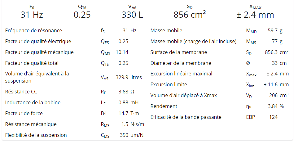

I think the low QTS (0.34) isn't optimal, in that a lot of EQ would be needed to offset the resulting low end roll off, and a Ripole already suffers from that anyway, so why add to it. That said, that woofer has the excursion and power handling capacity to take a lot of EQ boost so perhaps it would work if you can feed it the power. Personally; I like the QTS to be around 0.5, which is also less than optimal for flat response, but higher QTS (>0.5) usually equates to a floppier suspension and a less clean response, IMO.

I'm not sure that the Eminence Kappa 15C would be the epitome for a Ripole subwwofer : Fs is fine, Qts is a bit low and Xmax is small, where you would need 8-10mm...
But OK, as usual it is a matter of test : build a cheap Ripole test box and see if it already works as you expect... As you already own the speakers !

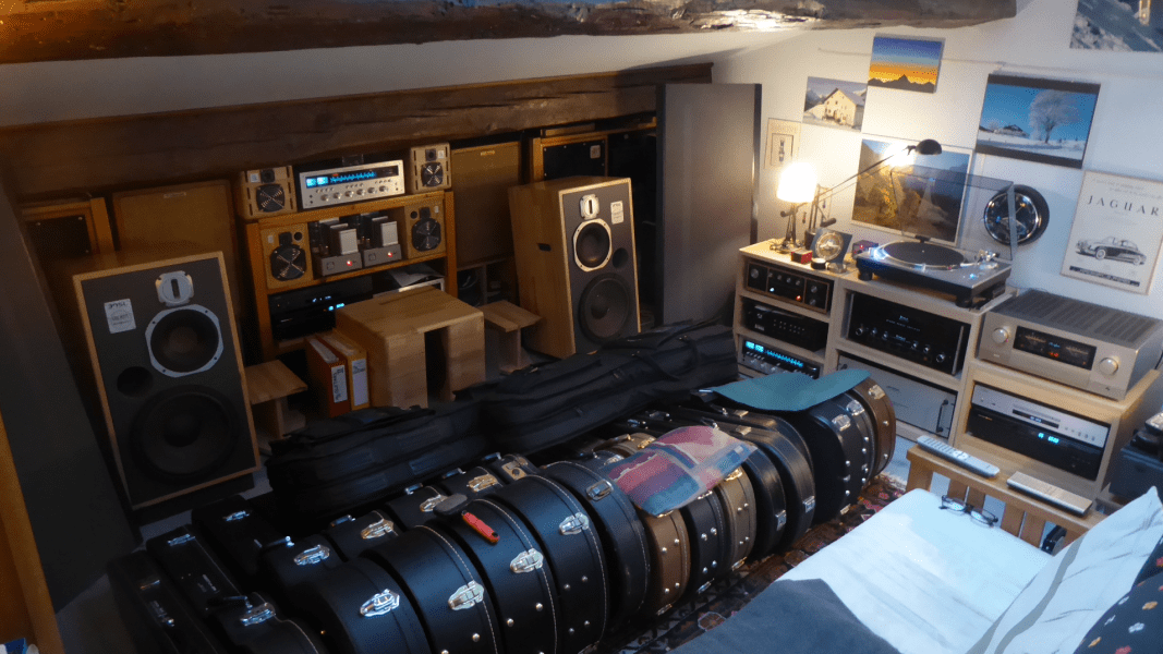

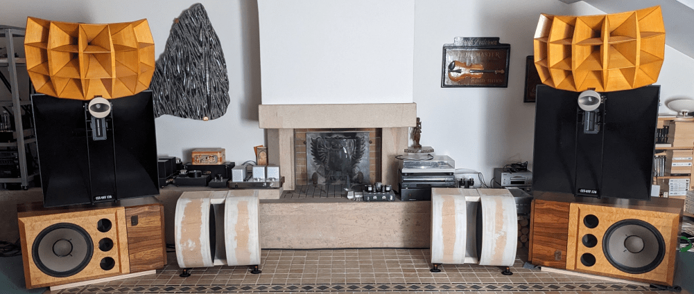

Well, yes : I choose the 12" format for place matters... My little auditorium is small and fullfilled of equipement (it has also storage virtues). You see my Omega Ripole in center position, as recommended by Axel Ridtahler (the creator of the Ripole principle). A 2x15" would have been a bit larger (think circa 500x500x550mm instead of 400x400x440mm) but too large :
A friend of mine decided to go Ripole after listening to my Omega Ripole, but in the XXL way, to match his big install... 2 Ripole subs with 2x18" in each ! They are visible on the picture below (unfinished white-ish wooden cabs) - OK, he's crazy, but they nonetheless works so fine that he sold his two Velodyne subs :

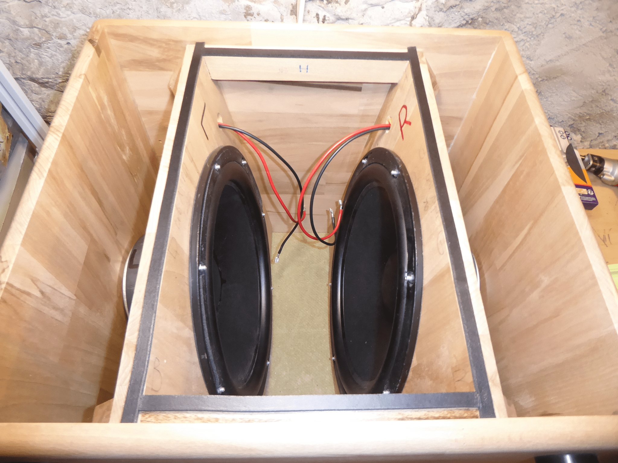

My Omega Ripole design (derived from A. Ridtahler's idea) have some advantages - having the goal of "global compactness" in mind :
  • it incorporates the subwoofer amp/crossover module (no separate element, unlike on my pal's install above)
  • it hides the magnets of the speakers inside the cab (no ugly protruding parts, no sealing needed at the pack panel openings).
  • it has internal slanted faces, which is potentially good for taming resonances (and also allow chamber reduction and ports expected sizes).
I use it only in the Infra-Bass range, typically cut at 40 to 60Hz, 12 to 24dB/Oct. , depending on the speakers associated, the idea is to achieve an extension of the low range, not a substitution, the speaker associated having their natural bass cut-off. With my Magnepan SMGb, the Sub module is set at 40Hz / 24dB/Oct.
So yes, even with 12" speakers in my Ripole, I use also very low FC... That's where the Ripole design is perfect : restituing that deep, floating bass atmosphere you can find on EM space ambient music.
