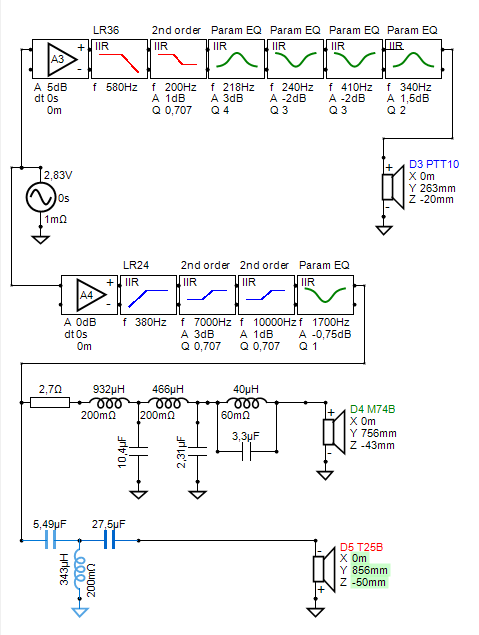

The plan for hybrid (of couse can only be finaled with enclosure build and measurments taken):
The plan if going full activ:

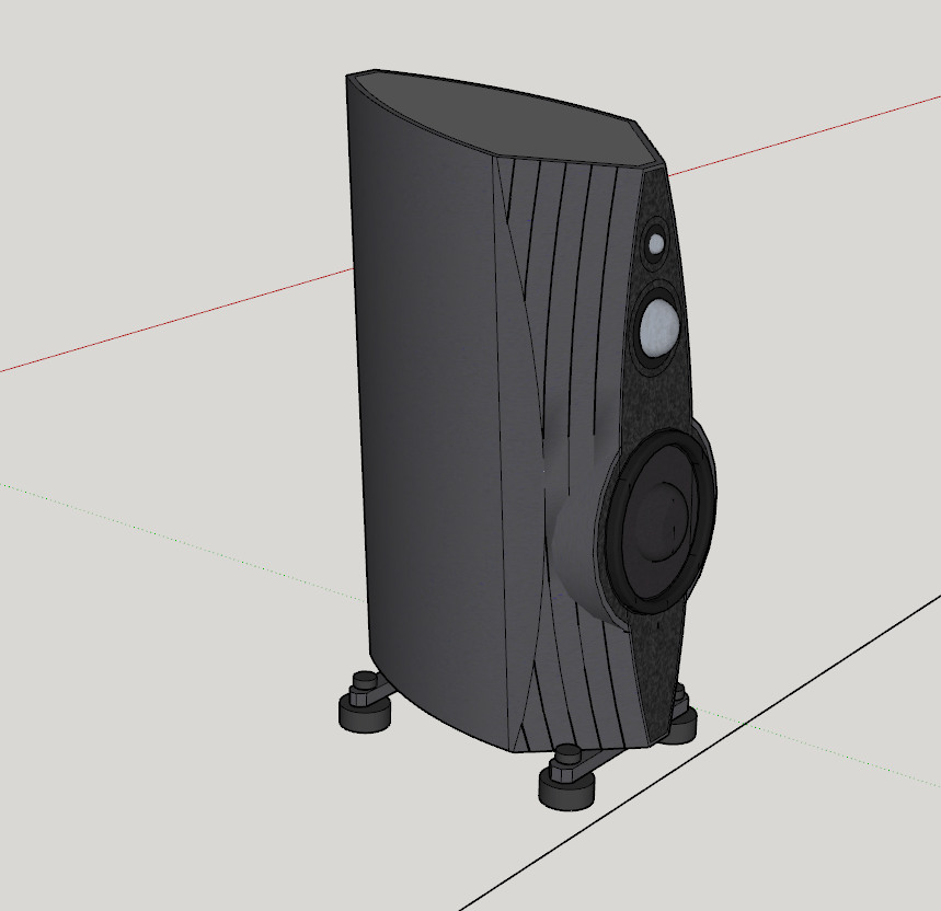

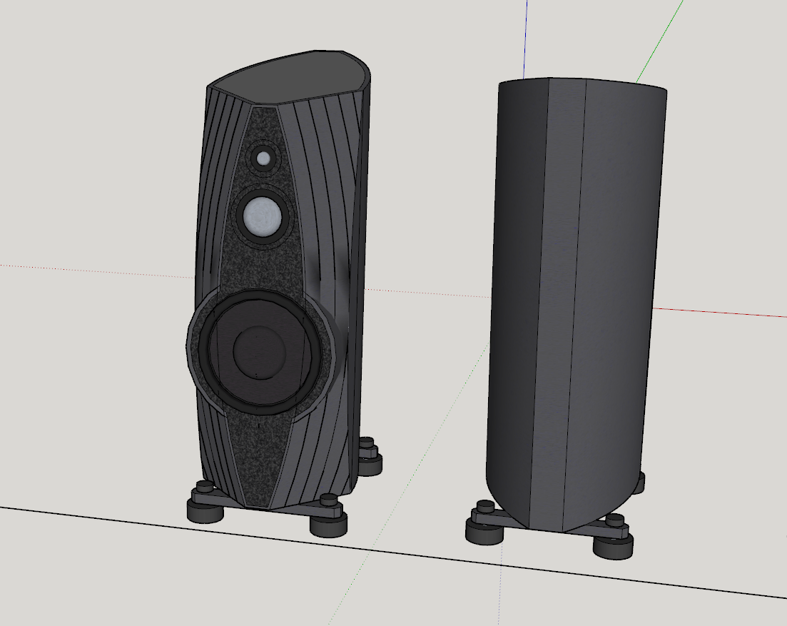

The enclosure plan:
Volume for the Purifi is exactly 24,8 L like Purifi datasheet and WinISD consider for 0,7. (You can get the mm² from sketchup for every object and than get the volume out of it. Volumen displacement from the Purifi is also considert.)
It maybe look like the enclosure for the purifi goes all the way to the top. But there is a plank under to M74B without any holes.
The bracing you can see in the pictures.
The front is in total 30cm wide. At the mid of the Midrangedome its 142mm wide and at the tweeter 88mm wide. C-T-C speacing between tweeter and midrange is about 1,2. (I follow some of HifiJims (and his friends) recommandations, I found at diy audio.
It will be build ot of 22mm good quality MDF and all parts will be glued with SikaBond T1 Purform. I have a fully equipt woodshop in my basement with a format circular saw, routers and so on. It will take time to do all the parts, but that's what make the design possible for me. You can print every piece in Sketchup in 1:1 and than use a router and flexible curve ruler to get it perfect. Than use the finished one as template for the same pieces.
The Tuned Mass Damper at the top will build out of steel with a total diameter of 110mm. It will be damped with small adjustable oildampers you can buy for RC cars. And it will be adjustable in height. I consider to make it out of aluminium and hollow to adjust the weight with damping oil. But this will increase the costs and chances are, the oil will escape.
I want you to ask, if my design is completely ******** or are there some mayjor design flaws?
Should I skip the hybric crossover and take a miniDSP Flex 8 with 3 Amps instead and for what reasons?
What I could maybe improve?

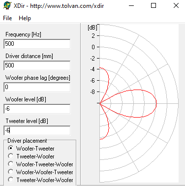

If you can keep the physical distance between acoustic centers of the tweeter and mid to less than the wavelength of the crossover frequency, it helps retain phase coherency. Closer is usually better, so that the crossover frequency can occur at a frequency the tweeter can handle and still keep that wavelength less than the distance between the acoustic centers. It helps generate a single wave from two drivers.

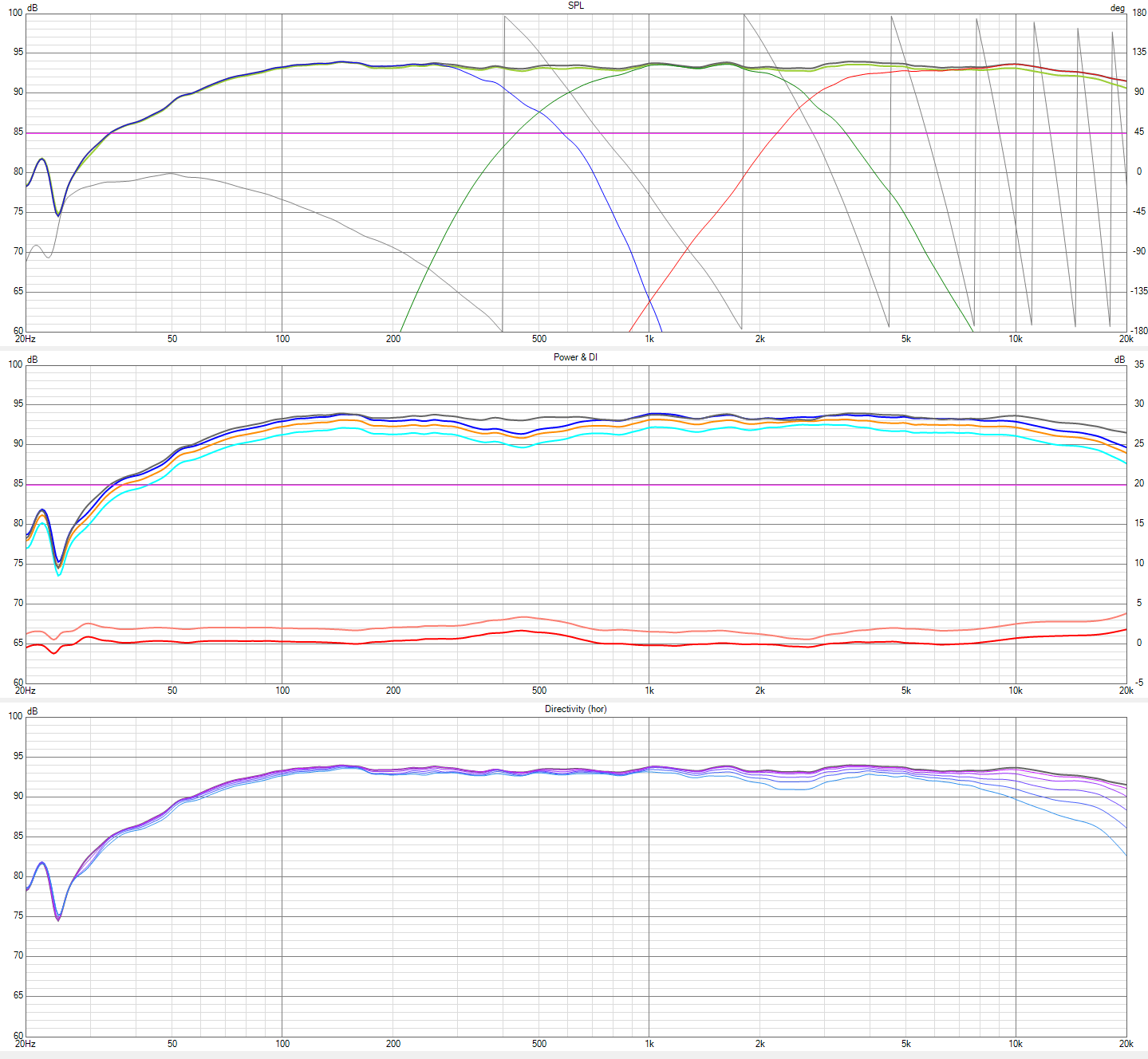

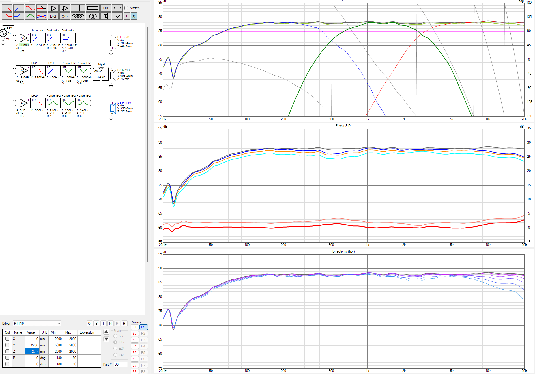

Heyho, I had a hour and played a little bit.
First I noticed that Z axis looks wrong to me. I googled some pictures of Vituixcad builds and noticed that all of them seem to use Y axis for height. I googlex XYZ axis and there are 2 common models. One uses Z the other Y for height. So i settled with Y for height and Z for depth. I measured in sketchup from ground to driver mids in a straight line 90 dg. and then went from this line to the mid of the driver to get the depth. Makes the most sence for me in a 3d space.
Thanks for your input knotscott. It seems closer spacing works better in Vituixcad. So I went with this. I managed to get the drivers 50,5mm closer in Sketchup and CTC spacing with the crossover at 2750hz is now 0,72.
I switched to LR6 for the Woofer, which mostly solve the dip immediatly. I tried some other crossovers but it was not possible to get the directivity flatter at that point. Getting the driver closer worsen the dip. Putting the driver a lot more appart (20-30cm) seems to help, but not drasticly. But this is no option, then the tweeter would be to high for my listenting possition. Could you guys recommend something or is it fine as it is for now?
For the tweeter I went with a 3rd order bessel filter, considering a 6 ohm load impedance. For the Midrange I stick with LR4 with a 8,7 ohm load impedance. Here the question, is this correct? 6ohm load from the driver + 2,7 ohm from the resistor in series?
So asymmetrical filters on both sides. The second order shelf for the woofer could than be adjusted to solve the bafflestep in the finished enclosure.
Here is the current build:
Hi, for my taste and experience the CTC distance between mid and woofer is also unecessary too high - especially with the relatively high crossover frequency - and will cause strong lobing and a resulting -3dB dip in the power response around the xover frequency; this may result in a "thin" sound of the fundamentals. Also the large distance with the relatively high xover frequency needed for a dome mid may cause that you hear seperate sound sources if the listening distance is too near.
I see this as the most critical point in your design: keep the sound sources tight together, especially with a mid that requires a high xover frequency like a dome mid.
Another thing is the "tube" you build for the woofer, which will act as a short transmission line (assumption: Length = 20cm --> 343m/s / 0,2m / 4 = 428 Hz; this is fully in the passband) and will show a strong radial standing wave (assumption: Diameter = 28cm --> 343m/s / 0,28 / 2 = 612Hz; this is around the assumed xover frequency and on the falling slope of the woofer).
Have a look at the group delay in the fundamentals with a LR6 for the mid/woofer xover. From my experience do not go steeper than LR4 to keep the group delay below the hearing threshold...
The design/shape may look good, but in my eyes it is is not the optimum to get all out of the very nice SOTA drivers...
Reactions: 2 users
Hallo Kwesi, thanks for you input. Thats why I want to ask here, to avoid horrible mistakes.
I really liked the design of the Orion, so I tried to mimic it somehow. But your right, they use cone drivers and will cross maybe at 200-350hz. I thought that 3.8m distance to my listening position (only need to get good sound at 1-2 spots at my couch) with a CTC distance arround 500mm and 500hz crossover would be not to much of a compromise. I could half the CTC distance of it to arround 250mm. Can you maybe say how much would I gain by that? I would go LR4 again but the directivity doesn't seem to change much.
The Tube is 130mm long and the inner diameter is 250mm, but wont stay so as shown in the picture. I want to try two Ideas. 1: is to do a large roundover on the top and a little one at the bottum of it. As the baffle above it is solid and could be made more hallow. 2: maybe even better would be just a small coupling "tube" to close the sides and make the baffle completly hallow above and under the woofer. This would be also necessary if I shrink the enclosure to match the volume if I decide to go with 250mm CTC distance between woofer and midrange.
One point for the larger 1.2-1.4 ctc spacing was a thread of augerpro about the cea2034 spec and his findings with this larger spacing. Helping with vertical reflections as it mostly dont hurt the horizontal. As I dont want to go the waveguide route and have hard cellings at 2,5m I thought it would be a good choice. I think hifijim and fluid from this forum said similar possitiv things about this uncommun larger spacing.
I just want to say that, so there is not the misconception I only did this large spacing for optical preference and dont care for the sonical quality. The idea for large spacing was there before and than I saw the Orion design.
I now want to try both. Build some test baffles and measure and listen to it. But have the simulations done, now I have time for it.
Whats your thoughts?

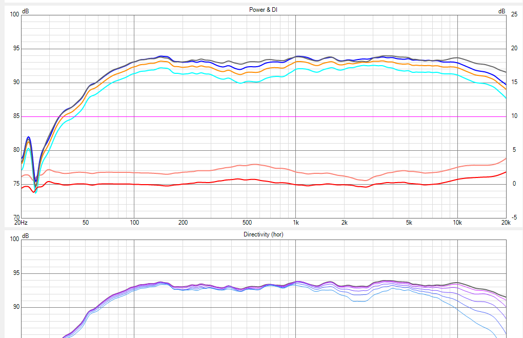

Hallo,
I did another similar design for closer CTC matching.
The new crossover:
I come to the conclusion to go full activ, no hybrid. I have the parts for the Tubelab TSE-II and SSE and I dont want to have one laying around.
LR4 for Woofer and Midrange crossed @ 500hz. 3rd Order for Tweeter crossed @ 2750hz. Tweeter inverted.
The Directivity Index at 560hz peaks with 1.6db. I could get around 50-60mm closer to the midrange, to get the DI to 1.2db, but then it looks wierd and the woofer would be close to the middle of the baffle, what also should be not optimal. So that 0.4db will be a compromise I would take for a better design. 710mm for the tweeter height is also closer to ear height now, because im mostly "chilling" on the couch instead of sitting straight. So thats also a plus for this design.
The tube will open in the baffle top and bottom and just the side walls will be rounded for closing the gap of the beveld front, that will be around 30mm thick at that point. So there should be no standing wave by a zylinder.
A smallish tower speaker with overall height of 815mm.
I will try to put the frequenzy responses in the Diffraction Tool to come closer to a realistic simulation.
Do you guys have some more points I should consider?

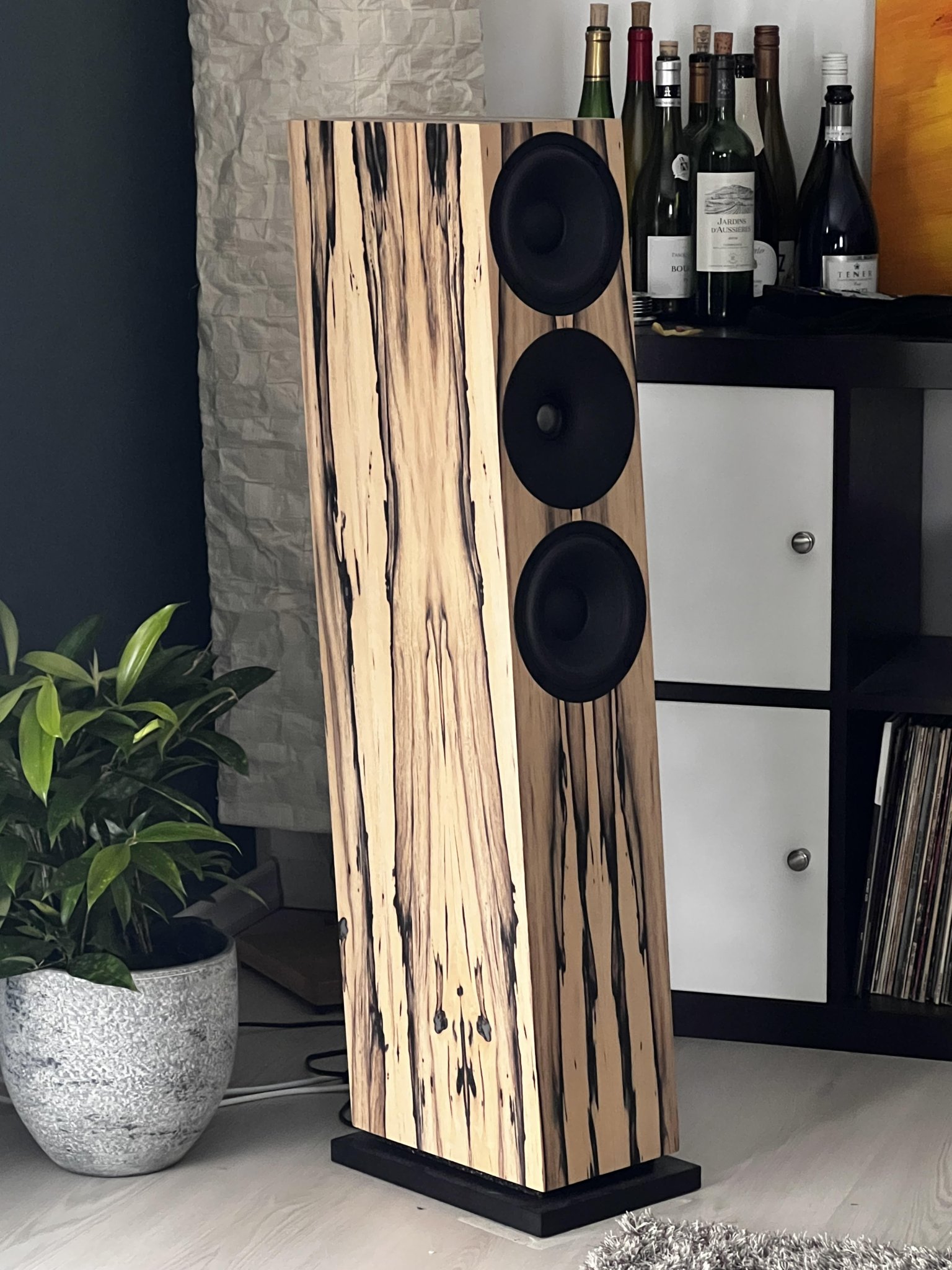

Hallo, I build speaker enclosures before. I build two bookshelfspeakers, my tower and I build a full activ caraudio system with 18. My current speaker is a design by YouTuber "Franks Werkstatt der Lautsprechertechnik", I attached a picture. I build it, as people said: "build somebodys else design, dont try to do your own". And now im unhappy with it. Not because it sounds bad or looks bad, but it was not something I designed my own. I tweek the crossover to my liking and EQ it's Inroomrespons. I'm a DIY guy, not in one department, but in many. I fix and build things my self, if its possible. I will build our kitchen, as soon as our kids are old enough, that they wont dmg it asap. I build a large outdoorkitchen already. I dont need speakers to be moved arround easily. I own my house, they dont have to go anywere soon. But my design is now not very big. 81cm tall, 30cm wide (at its widest point) and 40 cm deep.
So now I have those beautiful speakers, but something is missing, something you cant add to the crossover... I knew it would happen, but I led others convice me. I had some Dali, Monitor Audio and Sonus Faber speakers. I had some KEF and Wharfdhale at home for testing and listen to many other speakers in our local hifistore with friends. In my living room I have some vintage Walsh Ohm F speakers. I love all of them (ok not all, KEFs are not mine). I dont want to build a pair of speakers to say: "I build 60-120k€ speakers for only 6k€" like a lot of those YouTube Videos claim. If they sound like my current speakers, Im fine with it. Even If they cost a lot more.
So I kindly want to ask you, If you can help me with my design, to avoid mistakes you could see in the first place. Not to convince me to do sth other I dont like.
