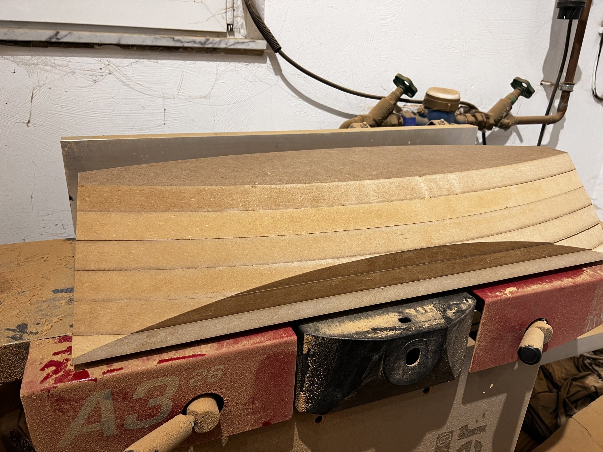

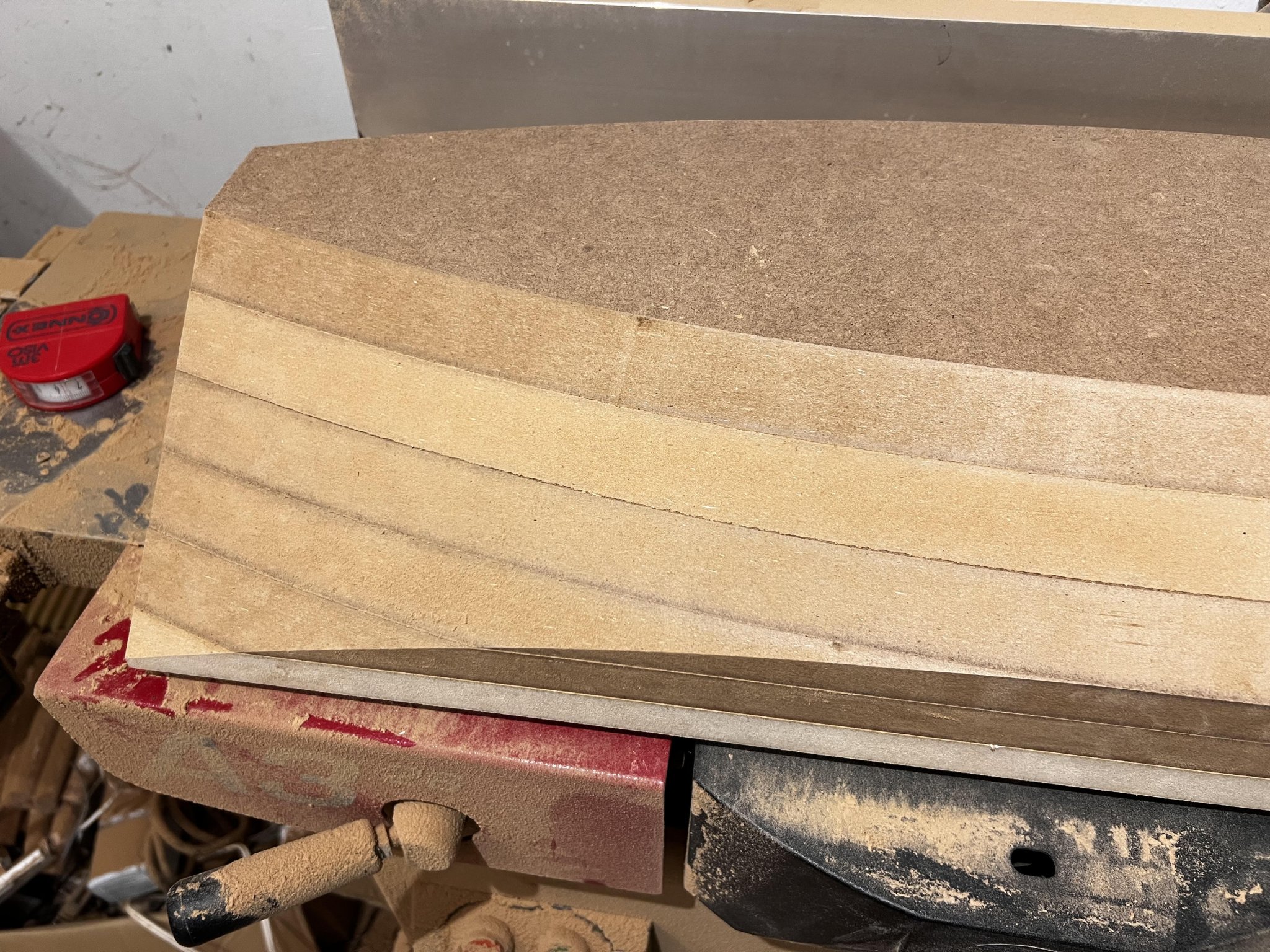

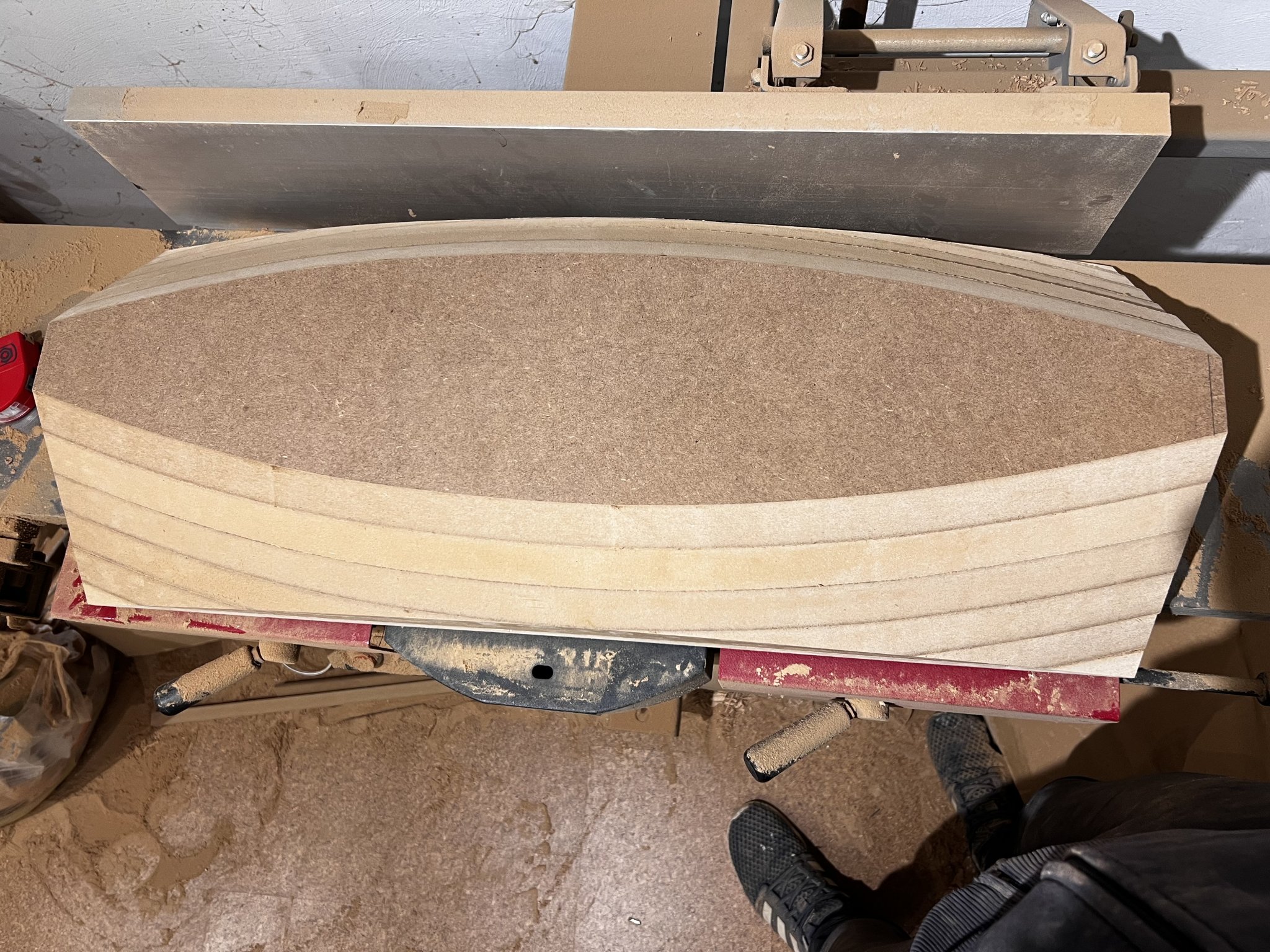

Hey, just a short post with some pictures. Just to prove this is not another dead project Like I said, will take some months to finish.
First front starts to look like something, some small adjustments needed. I will make large holes/matrix in it, so it's not as thick. Baffle will be arround 44mm or around 1 3/4 inches. Than I will glue the single boards to together, sand them a little and use some 2k polyester to fill gapes at the edges, give the MDF outside more stability and a better surface for painting.

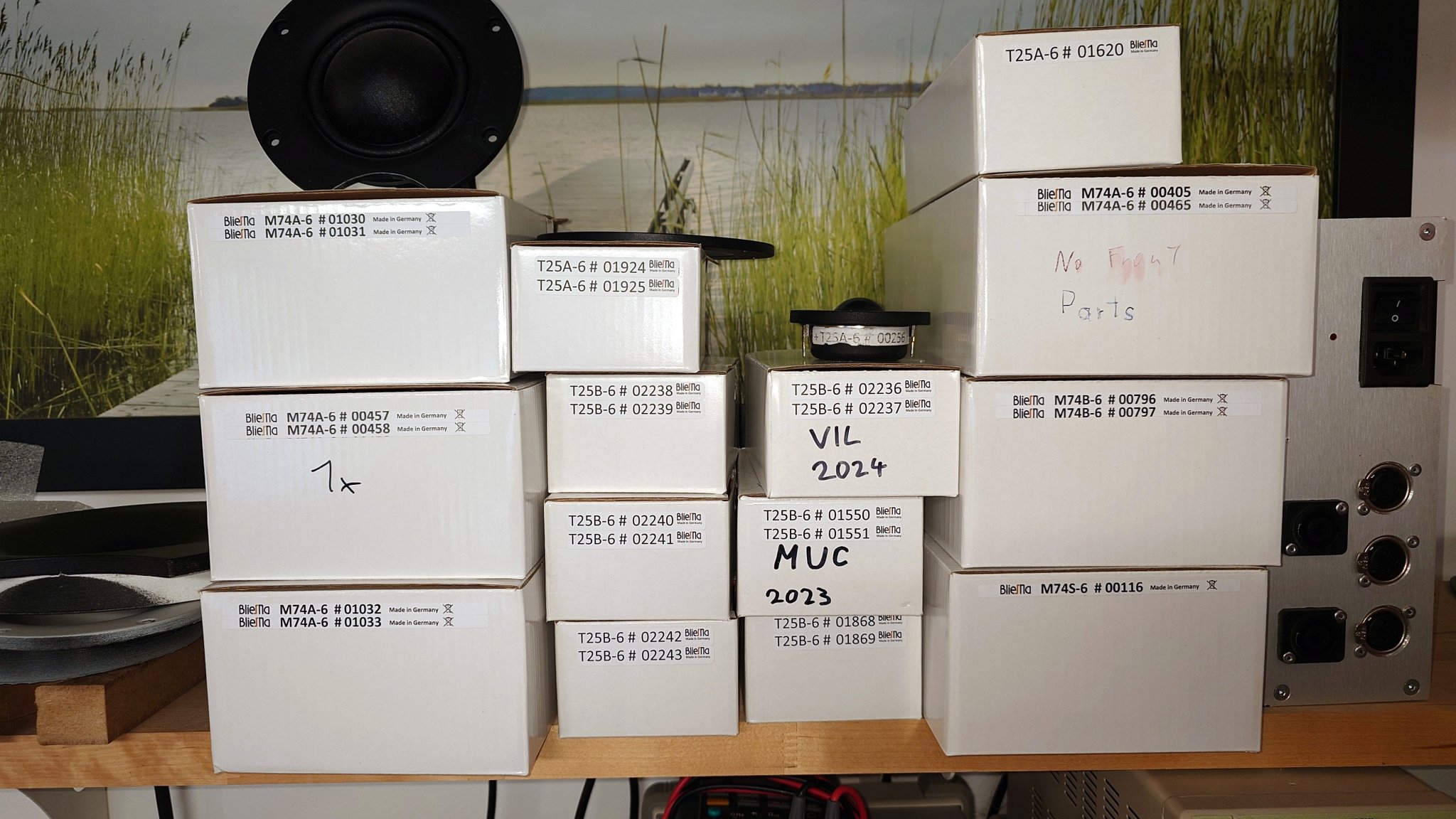

The PTT10s I ordered December last year should be arrive mid-end January.

when you say 2k polyester your talking about filler is that right ? I've had good success sealing the cut edge of mdf with 3 or more coats of good pva prior to painting . you might still need a bit of filler of course but it stops it being soooooo absorbent so gives you a much better surface to fill and paint . looking like a really interesting design what are you going to cut the holes for the drivers with do you have a circle jig ? also hoe did you cut that shape please ?
no, some filler will be used later on. Prior to painting.
I googled the correct word for it: The 2k polyester is a putty from Presto. Very strong stuff I used before in my car and has no problem to resist vibrations. I sticks to metall and wood with no problem and even after 7 years of driving my last car, there was no way to get the stuff off the car. (I tried to reuse some fittings). Can be sanded very smooth also.
I have a router jig for the circles.

@Lukerhunter - - what is the angle between the front baffle and the beveled sides, particularly around the tweeter? From the images, it looks like it is greater than 45 degrees...
Hallo wgh52, I didnt thought on come back on this topic. But after the sugestions from the others, I checkt the reviews about the Minidsp Flex again and looked at the threads about camilla dsp and others. I dont know excactly where it was (I think camilla) where even the author stated, that the new Flex is so good, that you should use it right away if you are into 2-4 ways. So I think I will go with it. But as said, I will use Hypex Fusion to start and build some custom amps. Will take a long time anyways.
Hi neo, size matters. Not that much that I would go with 6,5" woofers, but not to a point, where I would like to have a 15-21 inches. If you look at the picture of my room, you can see, that there are windows. The room is also used for Home Cinema/Office and the 130" screen dropps right between the speakers, so it covers the windows. So the space between the speakers is limited and to place the speakers closer to the corner would be also limited and counter productive. Hugh speakers would also drag to much attention in my opinion if watching movies. I think 10" is the sweetspot for size to me. 10inch seems to me as ideal for directivity matching at around 500 hz. For the given Xmax, the achived distortion and for an active system with a closed enclosure, the PTT10 fits perfectly.
Hi hifijim, the baffle is exactly 45°. I know from https://heissmann-acoustics.de/en/schraege-fasen/ that the ideal would be 25-35° but I already had a hugh 45° router bit to make the baffle that way.

Baffle - you can round your 45° edge to have a better transition. I normall use big roundings, biggest router is 31mm radius.

The baffleedges will be a little bit more rounded as I will sand by hand. But not much. The front will also be covered with 4mm sheep felt (German: Filz). As Rockport or Wilson Audio have done it before (the darker part at the front if you look at the pictures). I think this will also help a little with diffrection? But to tell the truth: I mostly do it as I like the look.

Ok that is good. It looked like 60+ degrees in the images.Hi hifijim, the baffle is exactly 45°.
As @IamJF mentioned, if you can blend the sharp 45 degree edge by sanding, you will reduce diffraction, and every little bit helps. If you can create a 20 - 30 degree transition bevel, perhaps 20 mm wide, this would be ideal. Very low diffraction leads to better imaging and 3D spaciousness.
