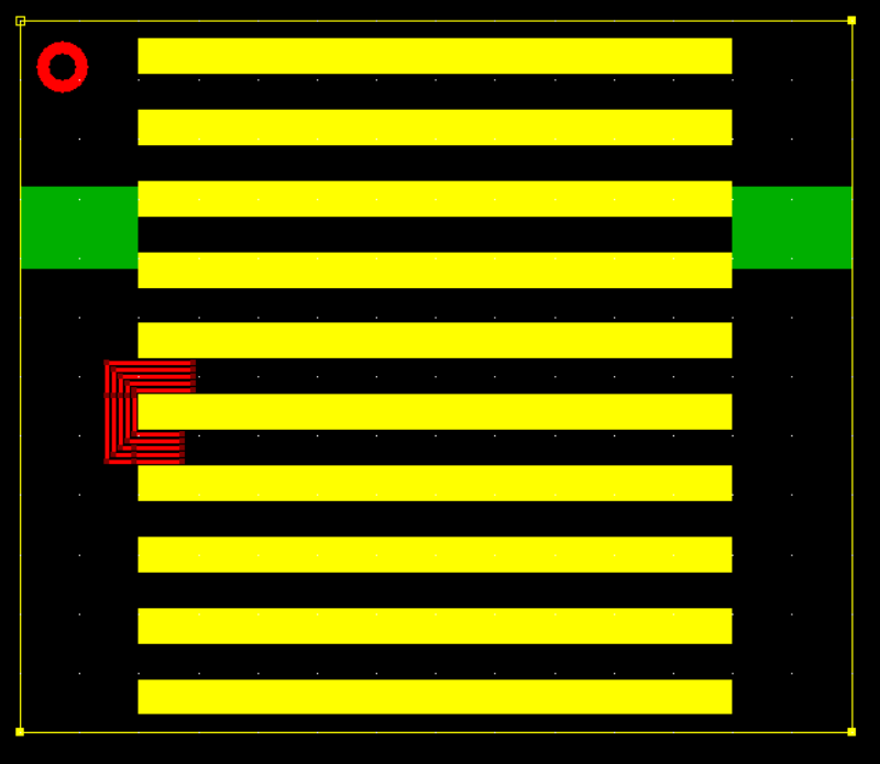

I'm currently toying around with the PCB layout since I can adjust all the other parts easily. I'll also have to think about how deep I want the corrugations to be and design a 3d printable corrugating mill to match. @WrineX has very deep corrugations but the Radian LT2 and BG Neo10 corrucations seem to be very shallow. I can't have them too deep since that will probably mess up the xmax but say 2 mm peak to peak might be enough to stiffen the flex PCB. Or maybe 1 mm is enough.

Possibly. I did some calculations for 0.15 mm trace width since JLCPCB has high enough precision to handle it which would net twice as many windings of the coil. The impedance would be annoyingly high at ~ 56 ohms but still workable in my case since I can connect multiple in parallell in the shading network to reduce the impedance seen by the amp.
While I might start at 0.38 mm if I get a design I'm satisfied with it might be worth doing a run with 0.15 mm trace width and then ramp up the current and see how much it can handle until it burns 🔥. If it can still handle say 3W then it would effectively be free efficiency since it's output at 3W should match or exceed the thicker traces at 5W.
Or if you all think it's a good idea I might start with 0.15 and go bigger if it burns too easily. 0.15 mm traces @ 5W would bump the temperature by 12 degrees in above mentioned calculator.

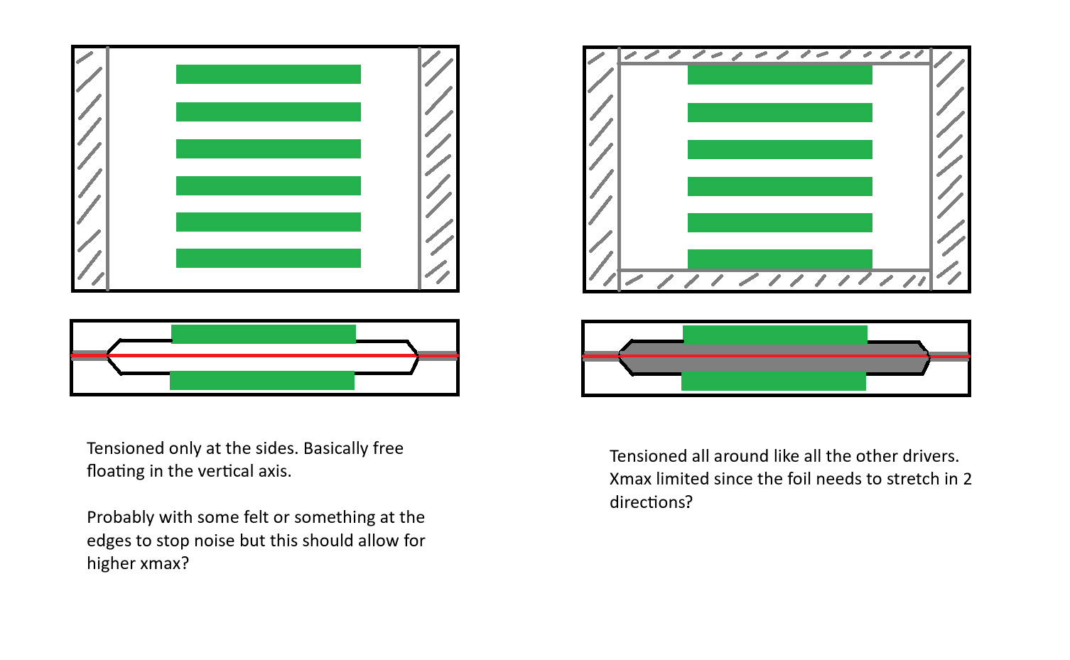

I'm thinking about how to get enough xmax without overcomplicating things.

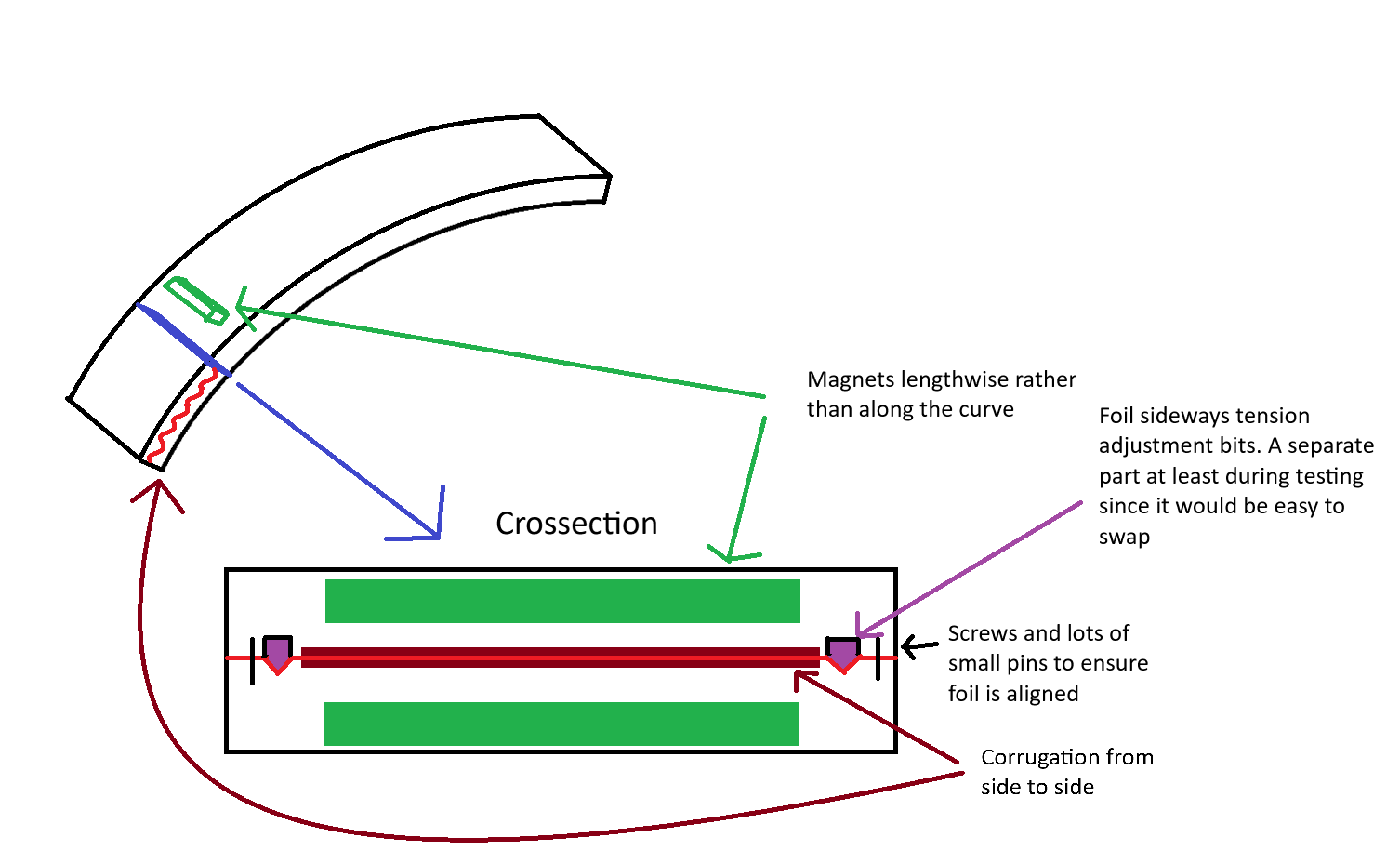

I can do the above mentioned idea of 6 cm tall 7 cm wide drivers. But I'd probably have to do some fancy suspension of the membrane to allow enough xmax since they are quite small. Although I could probably get by with reducing the xmax requirement to +- 0.25 mm that is still more than normal for the size.
Or I could scale it up to say a 20 cm tall 7 cm wide driver but curved to fit on my CBT (0.75 m radius). With a much bigger driver I wouldn't need fancy suspensions since it would be big enough to naturally go down to 400-500 hz. If anything I'd probably want to tension the membrane sideways same as all the others do. In this case my main 2 questions are:
1. It should be OK to mount the magnets sideways right? instead of lengthwise along the driver? Mounting them sideways would make the curve more smooth and eliminate the magnet gaps. Also, it would be much easier for me to manifacture since the strongetst parts of my print would be the sides and then I could lean on the mechanical strength of the magnets themselves to reach across to the other side.
2. Corrugating side to side should still be a good idea even with sideways mounted magnets right?
And as a side note I'd have to try the tensioning trick @WrineX mentioned in one of his videos that one manifacturer did. Hopefully the parts would be identical enough that I would be able to get close enough tension even without individual adjustments. But in the worst case I could always size the tensioning parts individually for each driver.
you can use magnets sideways. problems might be you have much more turning of the coil wasting resistance on parts that do no play. secondly if you want to corrugate to follow you curve better. (witch i would) you get the problem i had. havintg to know how much the coil shrinks. or else you coil will be sitting on top of the magnet or whatever.. not aligned where you thought it would be.. since your foil gets x amount smaller after corrugation :( so when ordering foils. i would not recommend that. unless you know exactly how much it shrinks. another thing is the JLCpsb things dont corrugate nice like alu on mylar does :( its to stiff
Hmm, that sounds like it would probably make it hard to dial in consistently. It is probably a better idea to just build smaller but flat drivers.
Would I want to mount and tension the membrane in both the vertical axis and horizontal or could I get away with only mounting and tensioning in the sides? My naive thought is that it would allow more xmax in the same volume since the membrane only has to stretch in a single axis + that axis is longer.

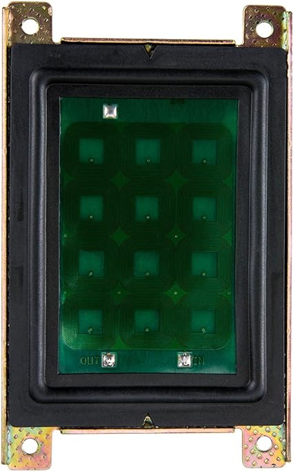

Or if it would be a better idea to just add a surround like this MCMA Planar. I should be able to print a small surround in TPU. The softest I can print is 80A which is more rigid than most surrounds but hopefully still soft enough to allow +- 0.5 mm of xmax without too much loss in efficiency.
