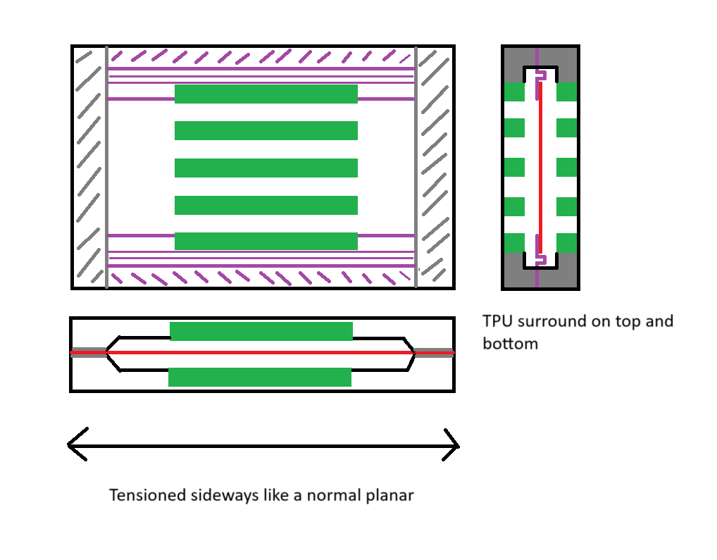

Another crazy idea: what it I did a hybrid solution? Normal planar tensioning in the long axis to make the resonance frequency low but a surround on the short axis? Although it is more complicated so if it would work to just not connect the foild on the top and bottom and leave it flapping while filling the area with some foam to dampen noise might be a more simple and easily reproducable solution.
yeah using a suroound i thought about it a few times but since the mylar is not rigid... i asume it still moves like a drumm. the surround might terminate some troubles who knows :) you can use different tensions in X and Y, sideways dictated resonance since its the smallest distance. but getting it to low. might hurt distortion (foil ratling etc)
look at the carver style. they use corrugation to make it sort of more rigid then use no strech sideways.. really low resonance. but it remains to be seen how wel it does really low... i think i posted a tweeter that uses this idea somewhere. its also in the discussion from Solhaga !
I guess there is no free lunch :)
You mean like you did in this thread? https://www.diyaudio.com/community/threads/carver-stratec-b-g-rd-and-some-personal-sauce.397812/
As long as the flexible PCB can be corrugated that might work. Your experience that the flex PCBs didn't corrugate as well as your mylar + alu ones might be a problem though. My guess is that it is mainly the metal in the membrane that responds to corrugation. If we roughly calculate the thickness of metal vs not metal by percent then your mylar + alu membranes have ~ 75% where the flex PCB is ~ 11% single sided and 22% with dual sided. Although for all I know copper might hold it's shape better than alu given the same thickness so dual layer copper might corrugate decently enough.

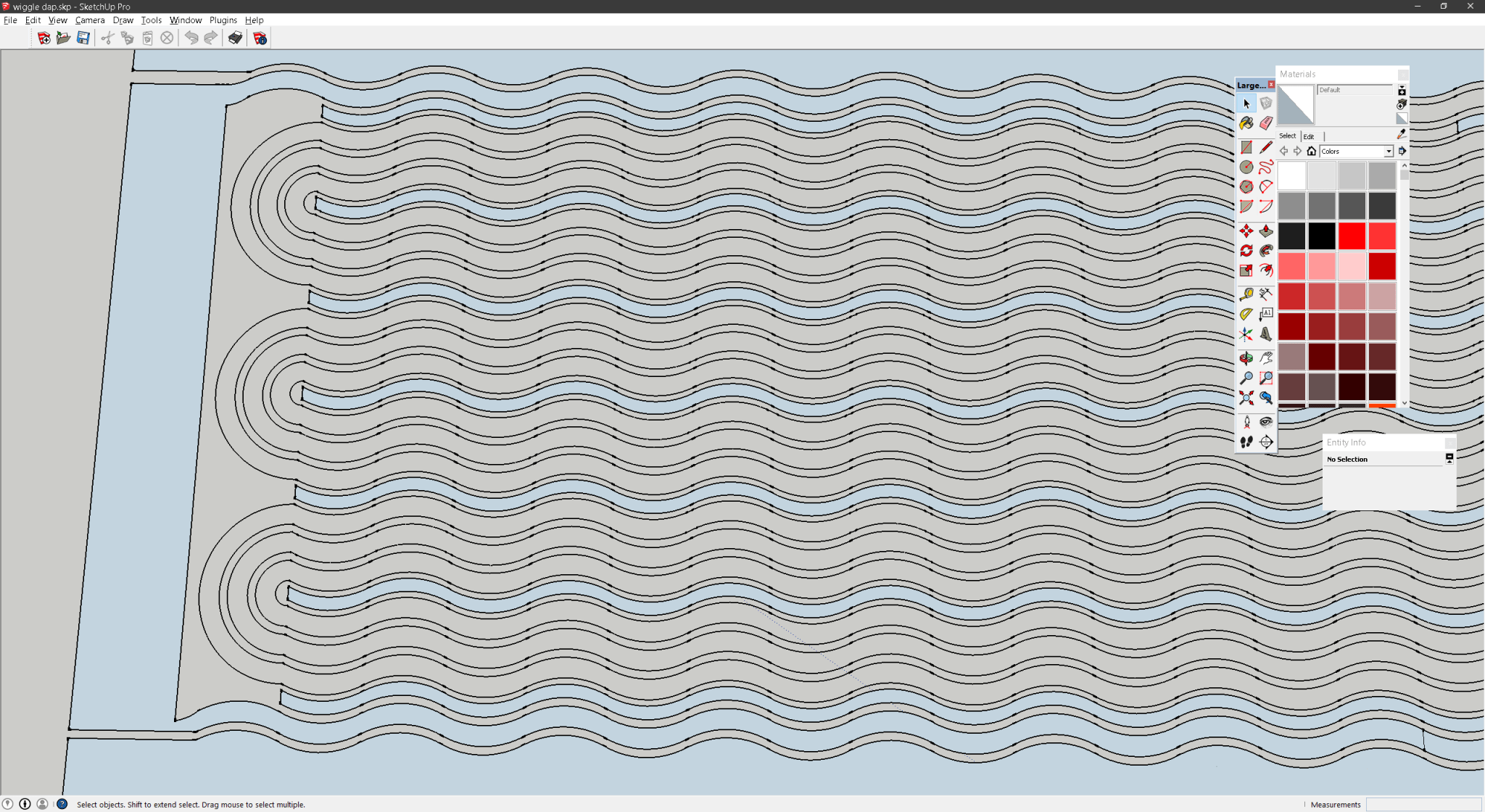

A possible way to get have a wider planar but still have a good dipole response without a dipole peak is to wire the traces on the membrane like a coaxial. Say we have 9 magnets and 8 rows of traces with turns but instead of wiring them all in series we wire 2 outer rows, then 4 inner rows and 2 outer rows again. This would allow us to, in theory, say short the outer 4 rows with a highpass crossover and thus halving the radiating width above the crossover improving the performance as a tweeter.
It would make everything more complicated though so if I don't have to I'd rather not. Or at least not until I have a driver I am satisfied with but am looking at ways to improve :)

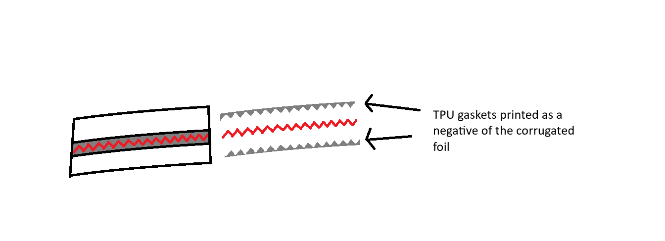

But with the carver setup, will the kapton + copper flex PCB hold the corrugations? Or would I need to print negative gaskets of the corrugated foil in TPU? I'd have to calculate the depth of the grooves and distance close enought though to it would be a bit more complicated. And I'm not sure if such a setup would increase the resonance frequency since it isn't floating anymore.
But then it might be easier to just have a corrugate shaped TPU surround that is glued to the foil which is then connected to the sides.
hmm i really dont know, how well it holds. i did corrugate the second one, but it works only if you manage to order without solder mask, or they add 2 extra layers i believe. adding a tpu gaskets etc, might get waay to complicated i think. you can also use the 3d printer to plot a simple alu foil :) just add a blade holder and off you go. or with a cheap laser setup and add a blade holder instead of a laser.
Yup, I assumed I'd need to ensure without solder mask. I think the best option should be the JLCPCB single side since then the rear would also be without glue and coverlay layer which amounts to 15+15 um.
Complexity is not necessarily a problem as long as I can model the parts, then produce them with high accuracy and in large numbers on my printer. The toothed gasket is more complicated yes but if I can print 100 of them with excellent tolerances so every part fits just right then it might be preferable to manually cutting a foam gasket.

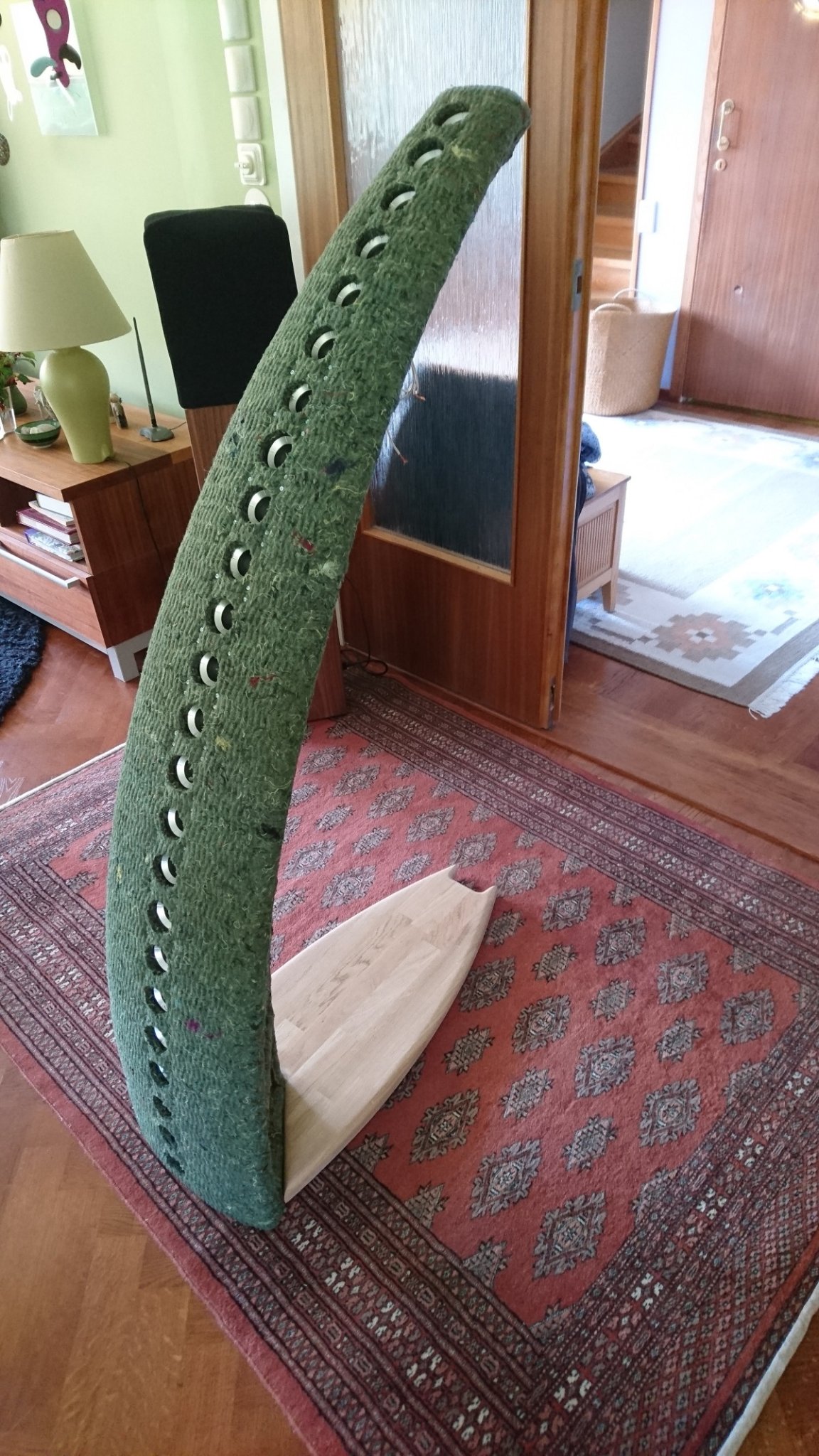

Exactly, I want to make a dipole CBT planar.
Basically this but as a planar + with a line of woofers is N-frames behind the planar to take care of the low end. Although the wool carpet baffle which helps low end efficiency below 300 hz wouldn't be needed for the planar.

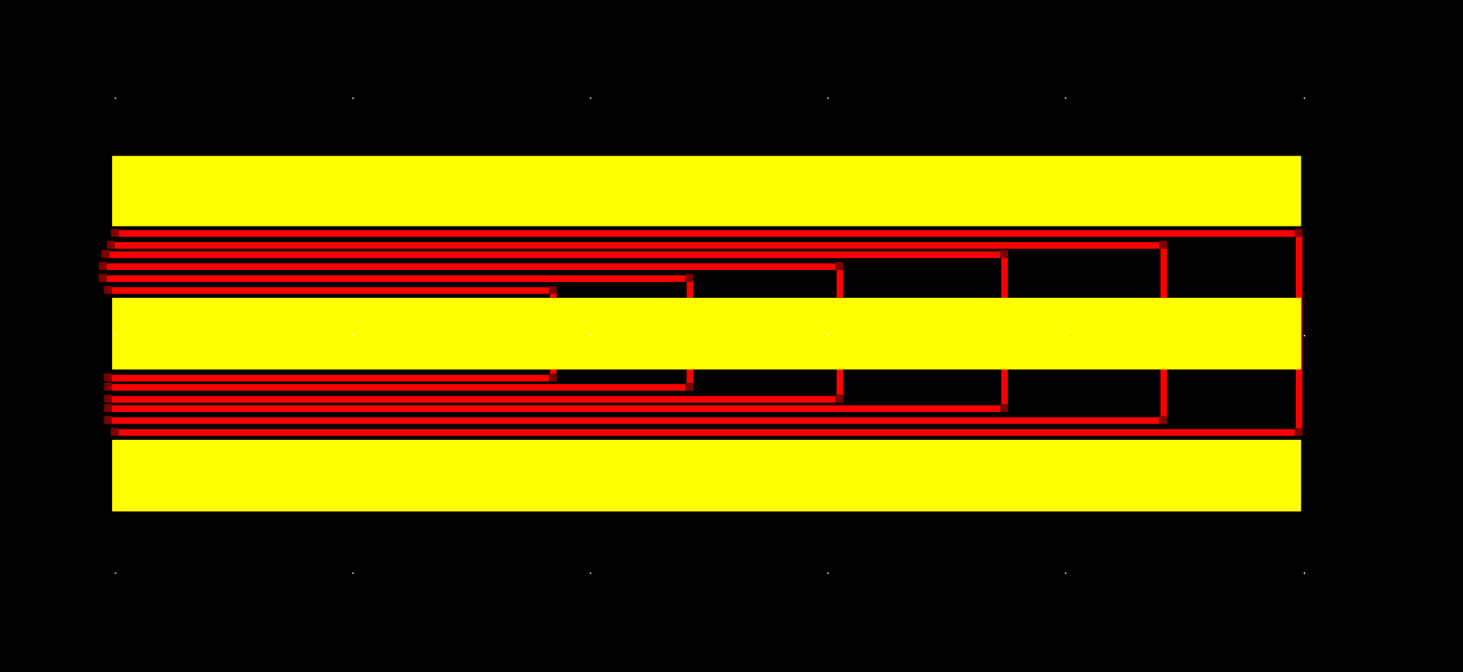

If I did the route traces back-trick, wouln't the efficiency be able to be increased to same-ish as without shading if I after having one trace return home made the other traces bigger in turn? Then resistance would go down so less losses but the current would stay the same so the same SPL?
