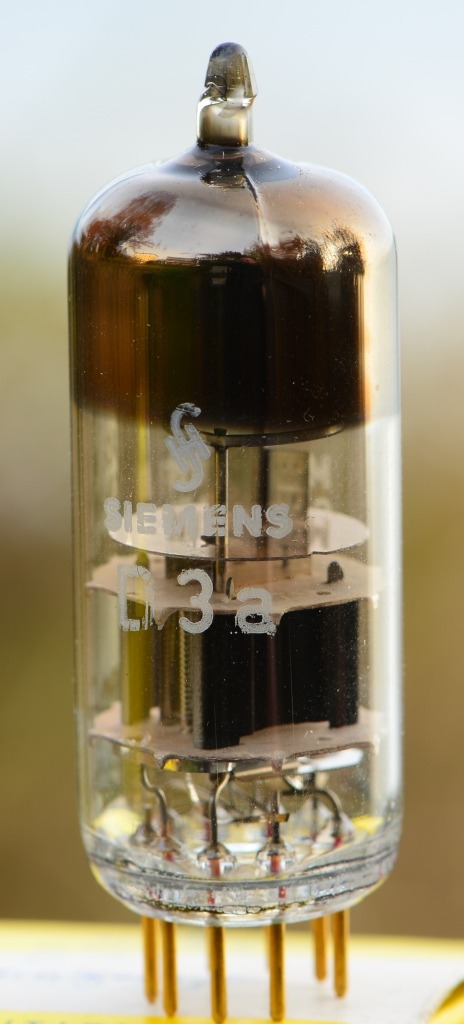

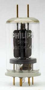

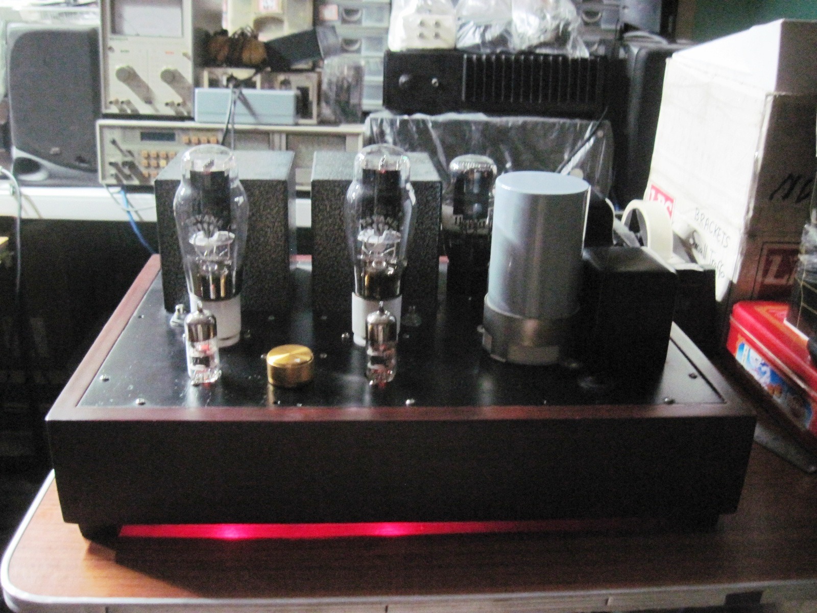

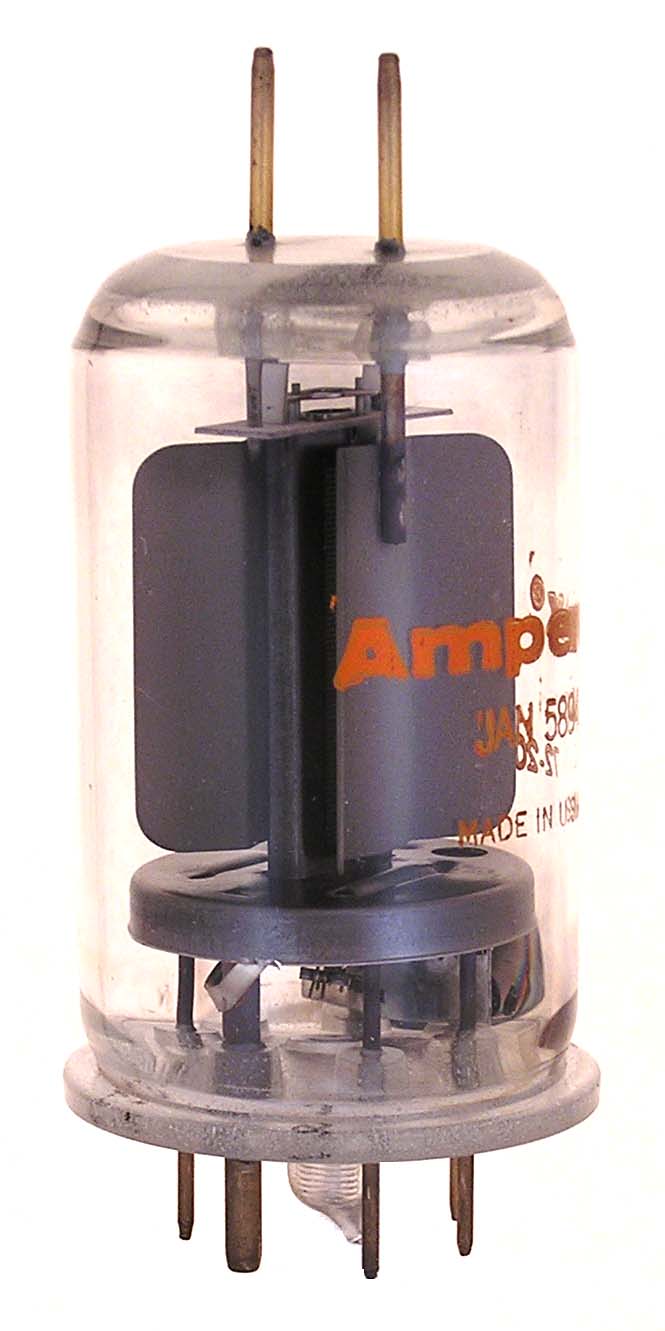

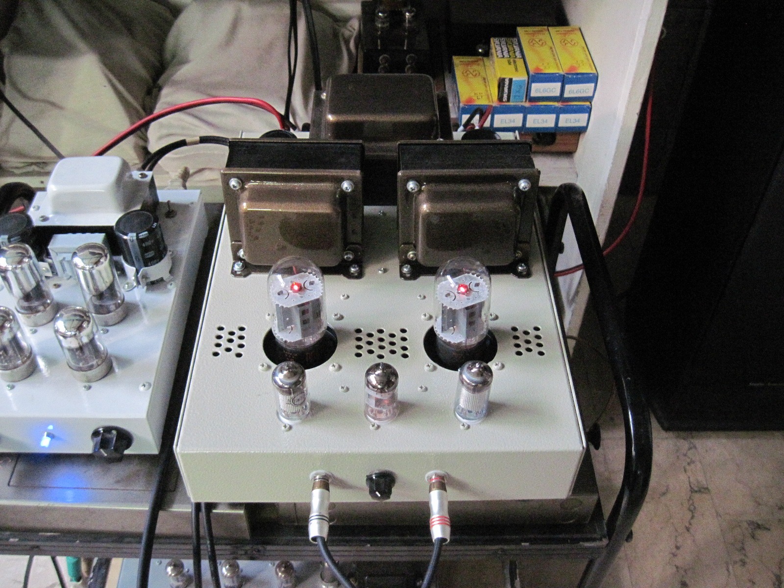

the D3a did not have round plates, but was well received.....
so is the 12HL7,
the 5894, a dual pentode, sounds fantastic in my amp, go look at their plates...

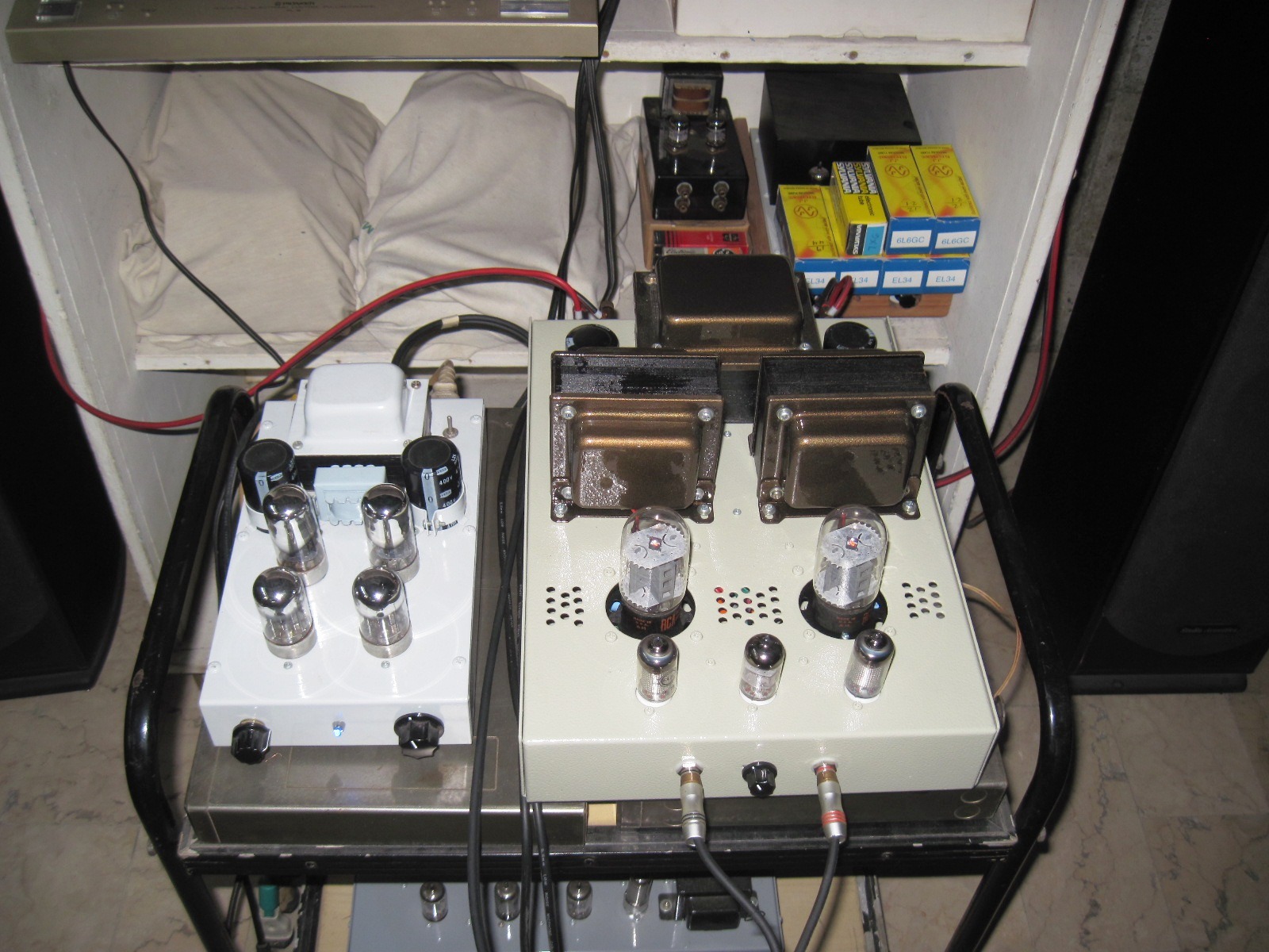

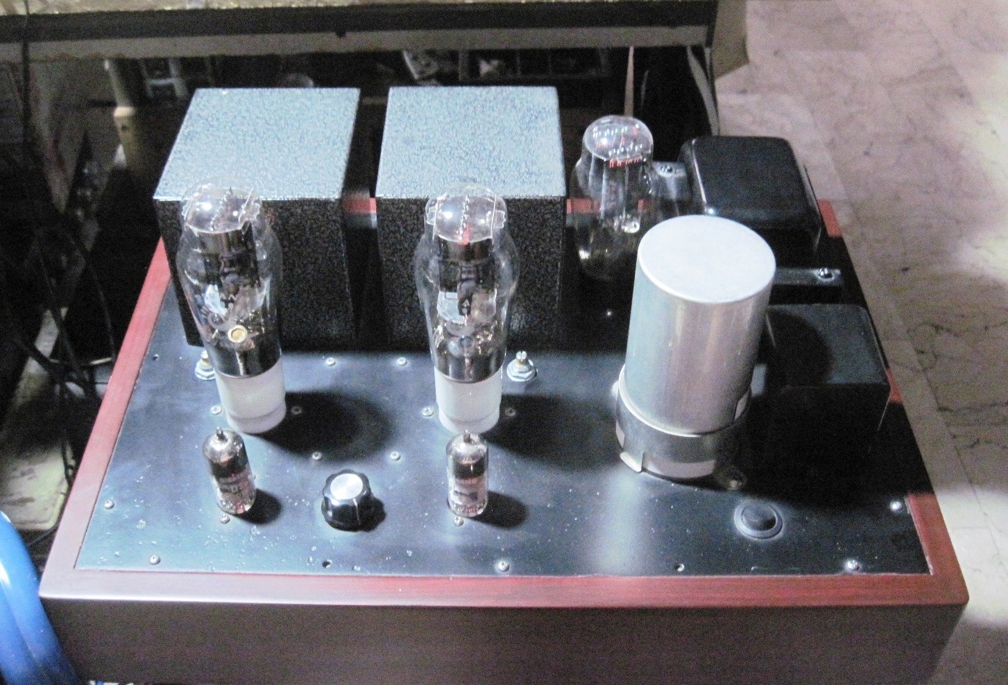

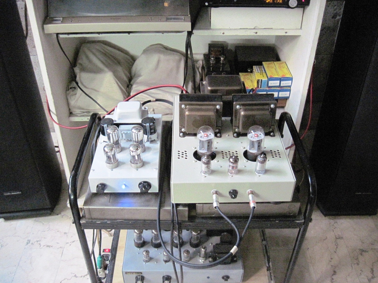

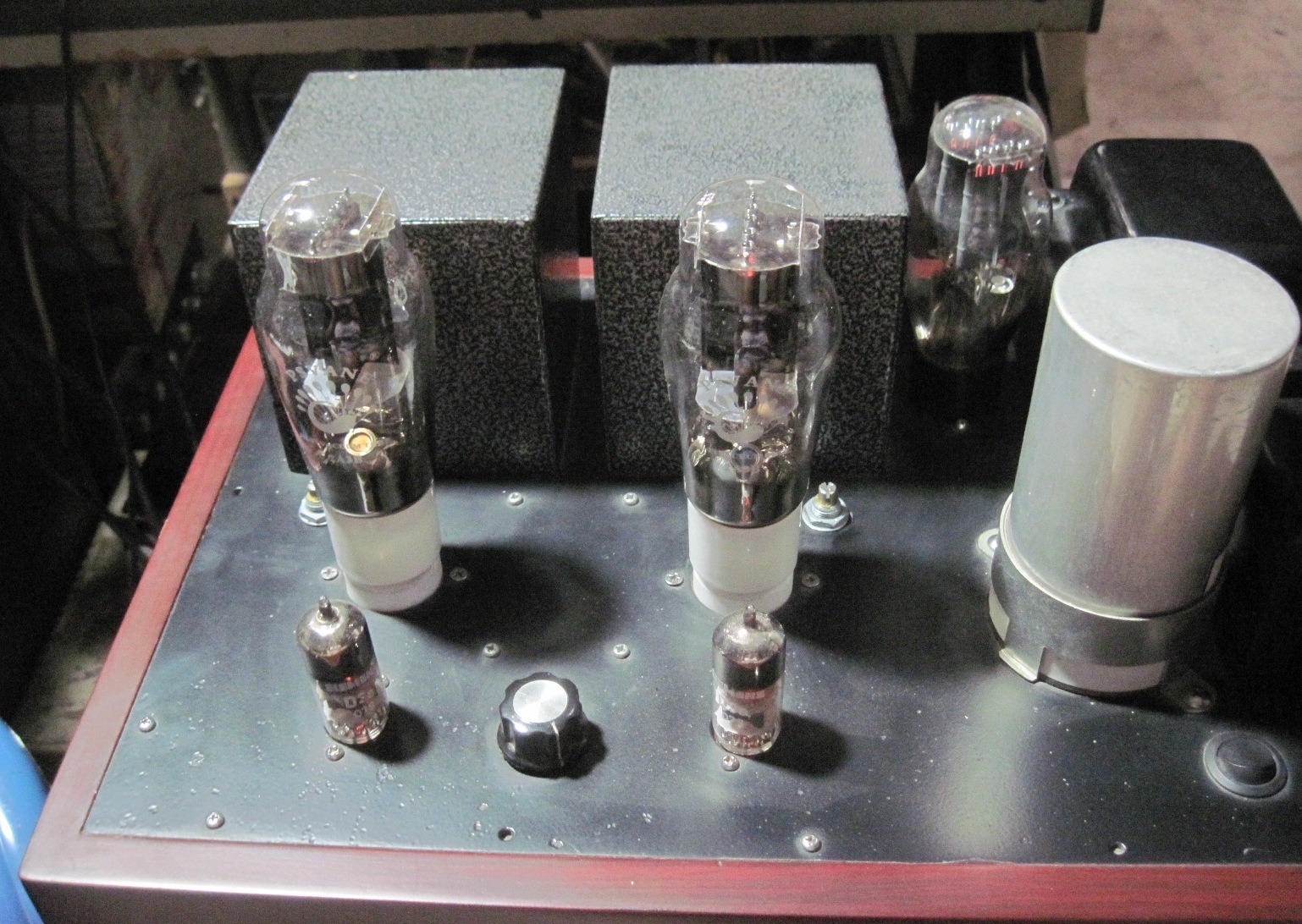

i attached pictures of tubes that i actually used in my amps...
