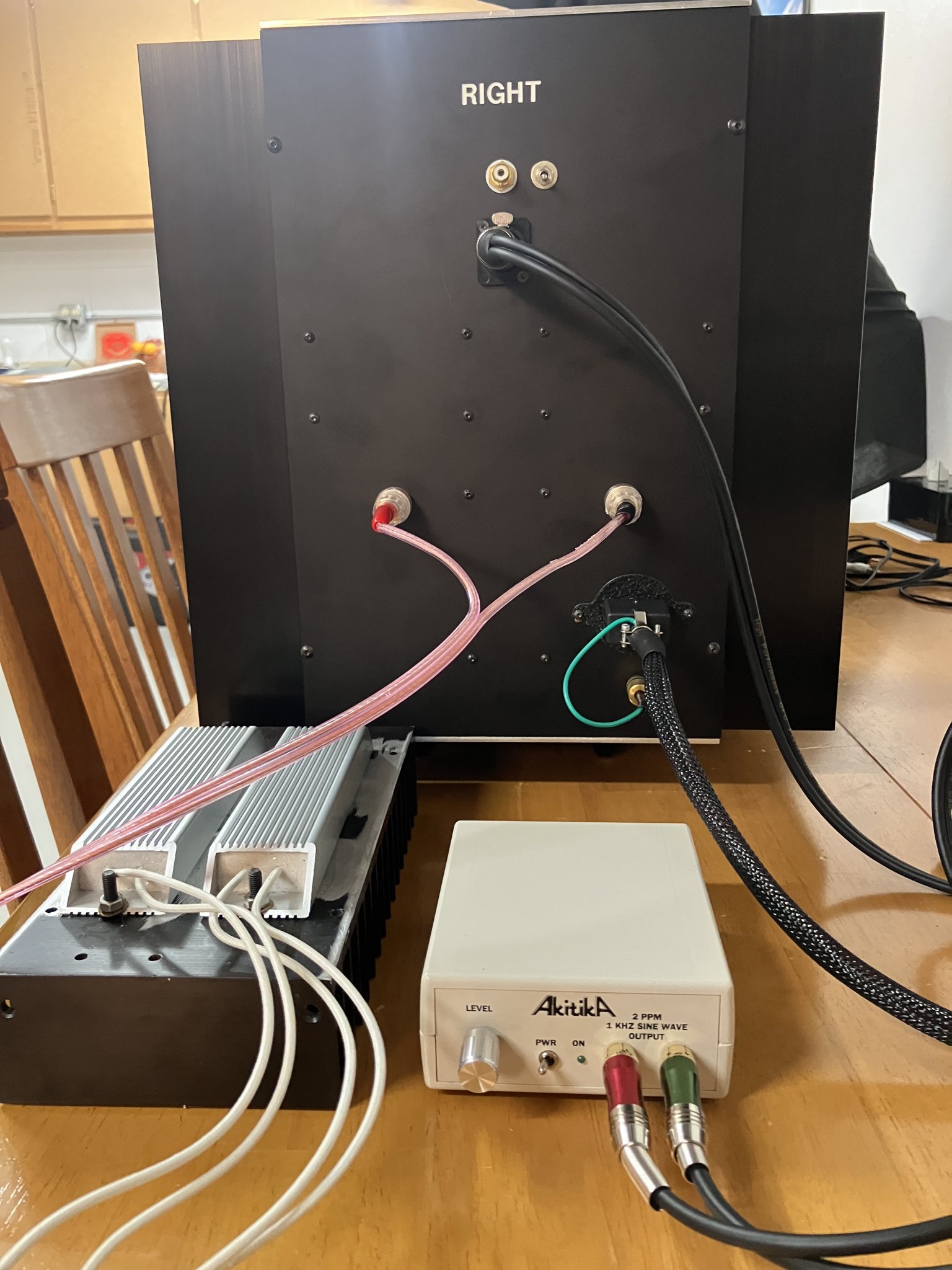

What would be the best approach for adjusting P3 on a balanced F5T with connected feedback loops - feed a symmetrical signal into the amplifier and measure/adjust distortion for each "half channel" output vs. ground, trying to get similar distortion characteristics for both halves? Or is it better to "separate" both halves prior to adjustment by grounding the feedback loop...
Sven
Sven
I don't know if this is the best way to adjust P3, here is how I did it on mine. The Akitika 2ppm 1K sine wave generator has a cable with two RCA's going into the XLR (Amazon under $10 USD) which feeds the amplifier XLR input. The amplifier speaker output to an 8 ohm load, which then feeds a voltage divider to a Behringer UM 2 sound card. The sound card has a USB output to my laptop with REW software for FFT.
BEFORE I connect the sound card/voltage divider to the 8 ohm load, I adjust the Akitika for 2.83vrms into the 8 ohm load. This gives the 1 watt output into 8 ohms.
The voltage divider is set to output 1 vrms into the sound card, any more than that could fry the soundcard (did that once). Building the voltage divider is lots cheaper than buying soundcards.
Since there are two P3's to adjust, I have a note pad to record which P3 I adjust and how much (quarter turn, half turn) and which direction (CW vs CCW). It keeps me from getting lost with these adjustments. It is possible to get 2nd order distortion, just beware the adjustment can be positive 2nd order or negative 2nd order. REW FFT software shows the phase angle for 2nd, 3rd, 4th, etc.
It took me a full day to adjust, 2 hours to get the amps to operating temperature, and usually 15 - 30 minutes to stabilize after each adjustment.
The 2 hours to get the amps temperature stabilized is from the FirstWatt F5 owners manual.

Here is a little datapoint for you. Next time you have the Akitika out to play, set the volume control on the Akitika to an arbitrary level (say 1V RMS or 2.8Vpp) and then measure the voltage outputs using your analyzer.BEFORE I connect the sound card/voltage divider to the 8 ohm load, I adjust the Akitika for 2.83vrms into the 8 ohm load.
What I found was each of those RCA outputs had different distortion levels which shocked me. They are not the same. Moreover the voltages on each of the outputs were not exactly the same either (but close, so a non issue).
On a scope, each of the RCA outputs had the same waveform. One was not opposite in phase which is what you need for a true differential input source.
For me, the RCA output closest to the volume control had lower distortion so I use that exclusively if I need to use the Akitika. Unbalanced source only.
For reference, I am using the QA403 analyzer.
