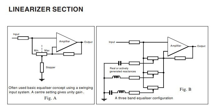

ok... can we really
sir... it's obviously a conceptual circuit... of course you want the network to be terminated into a impedance [aka a resistor} to earth to facilitate proper real world operation ...cmon guys lets be real here. lets NOT just bash the concept.. lets really flesh this outAs drawn in post #14, you have a voltage follower, a rather complicated impedance network and another voltage follower. The second voltage follower ensures there will be no signal current flowing through the rather complicated impedance, so the signal voltage drop across it will be zero, so you might as well leave it out. When you do, you have a cascade of two voltage followers, which can be further simplified to just one voltage follower.
this was done using gyrators, both passive and active. A high quality factor of the circuit has a phase change in a small octave interval, so it is believed that phase disturbances do not occur.does anyone out there have a block diagram or any idea of the circuit configuration in a fm acoustics linearizer...? regardless of model i suspect they are the same.. i would REALLY like to see how to achieve frequency manipulation without destroying frequency phase relations in an analog circuit...

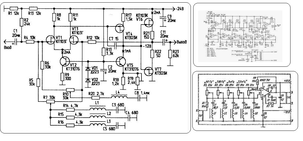

Here is a block diagram of the innovative “breakthrough” of modern “engineering”:
but here are real working diagrams from my childhood, i.e. more than 40 years ago))))
Yes, you are right that they don’t do this and don’t say why, but I will add that they stopped doing this because gyrators or inductor circuits for compensation circuits must be connected between low-impedance levels, the inputs of the operational amplifier or transistor circuits in the attachment in my post from the middle 80s of the last century, have a high input impedance, so this adds noise and was subsequently abandoned, but the principle itself cannot be different, and based on the fact that they can place this block both in parallel with the preamplifier and in series - in the gap between the preamp and the amplifier, I think that we can only talk about low-impedance inputs circuits.I had the impression Fig. A and Fig. B were prior art diagrams, showing how they do not do it.

and by the way, those two circuits in the first pic you provided sir are NOT the circuits used... the actual circuit is laid out like the conceptual one i provided
yes... and thanks... i am aware that these circuits exist... but i cant remember seeing MEASURMENTS for phase response ...this was done using gyrators, both passive and active. A high quality factor of the circuit has a phase change in a small octave interval, so it is believed that phase disturbances do not occur.
It will probably correspond even more closely to the original from the article if the operational amplifier U8 is made with a low-impedance input, then the phase response will be almost linear.the actual circuit is laid out like the conceptual one i provided

I have found similar circuit concepts using non global feedback in the design of two other brands and they both complement and boast the superiority in sound quality using this method..
One of them is the Sony SE-P900
The second doesn't come to mind at the moment but it was used in their top tier products ...
... the CELLO palatte is also rather close ..
Again..it is an additive /subtracive design not using global feedback..
I dare say this concept seems to provide superior SOUND quality..
I have simmed a design in lt spice and it works as intended, but have yet to actually build it and listen...

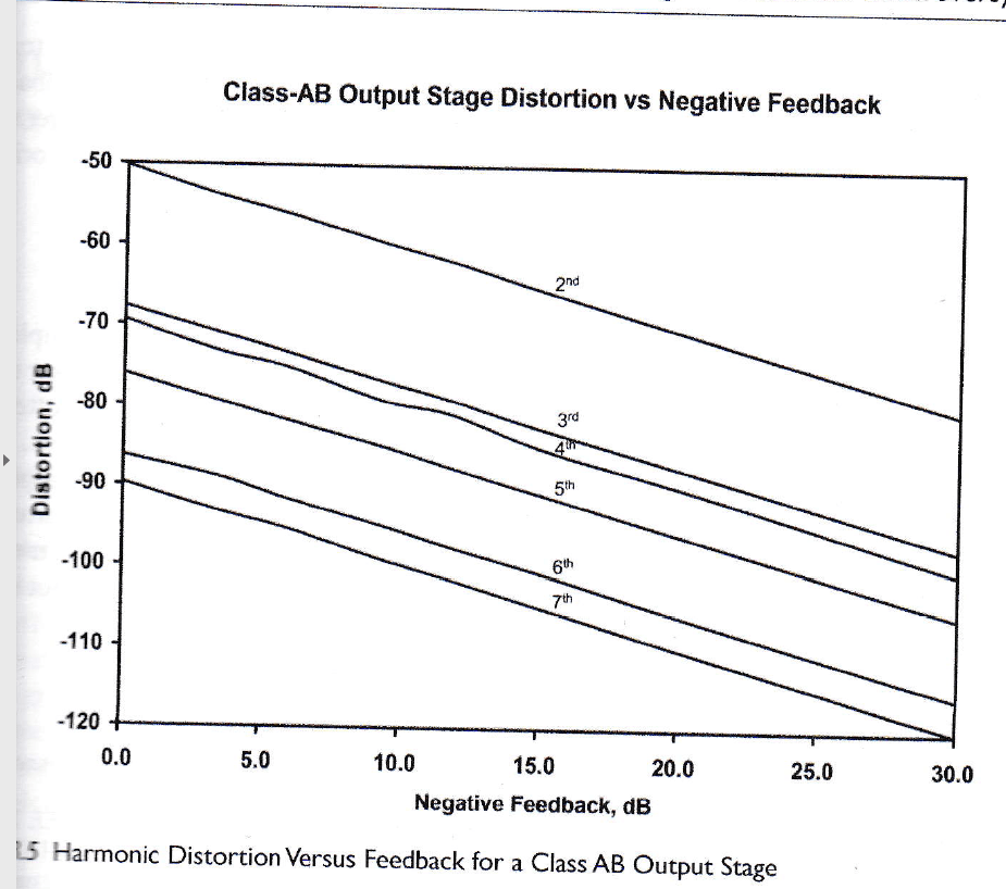

In general I've heard years ago that you can make an OK amplifier, use a ton of feedback to make it better - or - you can make a really good amplifier design and use just a little feedback to make it better. Supposedly (and intuitively makes sense) the good amp with little feedback sound better than the just OK amp with a lot of feedback. Even though they measure FR and THD similarly.he already knows "I dare say this concept seems to provide superior SOUND quality..".
So the "lean" is toward not using feedback so much for better sound. One would think a linear circuit with no feedback technique at all to make it work properly would sound best. Perhaps so. Anyway I think this is the thinking embodied in these particular products.

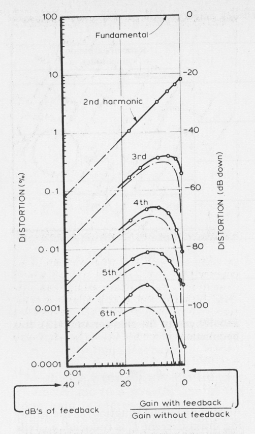

Yet, it has been proven again and again that the worst thing you can do is use a little feedback. That increases high order harmonics and not decrease low orderr harmonics significantly. They definitely do NOT measure THD similarly.In general I've heard years ago that you can make an OK amplifier, use a ton of feedback to make it better - or - you can make a really good amplifier design and use just a little feedback to make it better. Supposedly (and intuitively makes sense) the good amp with little feedback sound better than the just OK amp with a lot of feedback. Even though they measure FR and THD similarly.
As Bruno Putzeys said, if you want to use feedback, use a ton of it!
People believe all kind of stuff they read on the 'net from someone who who read on the 'net - ad infinitum.
Only a few really research it, and they build awesome amps.

Problem is that they don't read enough, as in proper literaturePeople believe all kind of stuff they read on the 'net from someone who who read on the 'net - ad infinitum.
With always the default excuse; "Yeah but my math isn't so great" or "yeah but it's so many pages".
It's ironic how much time some people spend on just chatting in circles.
If you would spend AAAAALLL that time in reading proper literature, you basically have a degree of engineering in your hands. (well, more or less)
