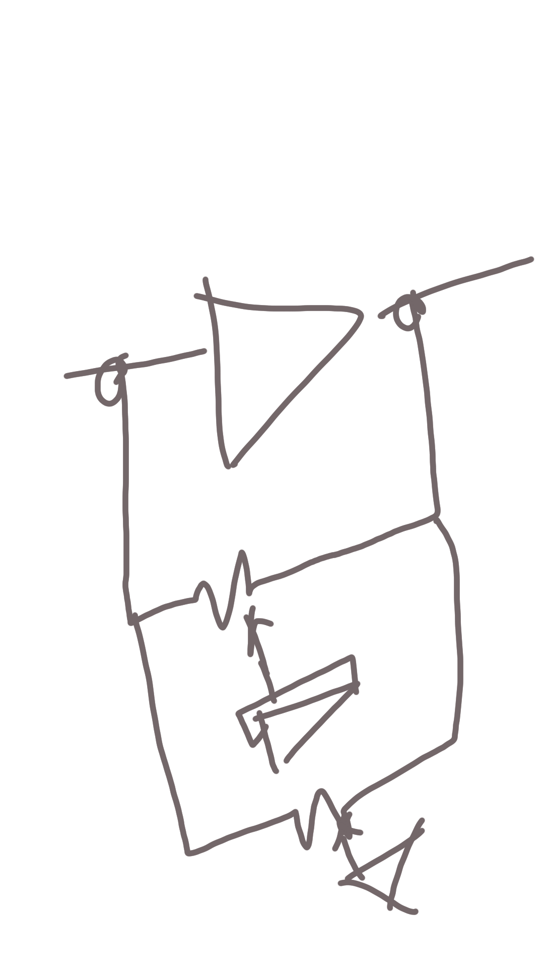

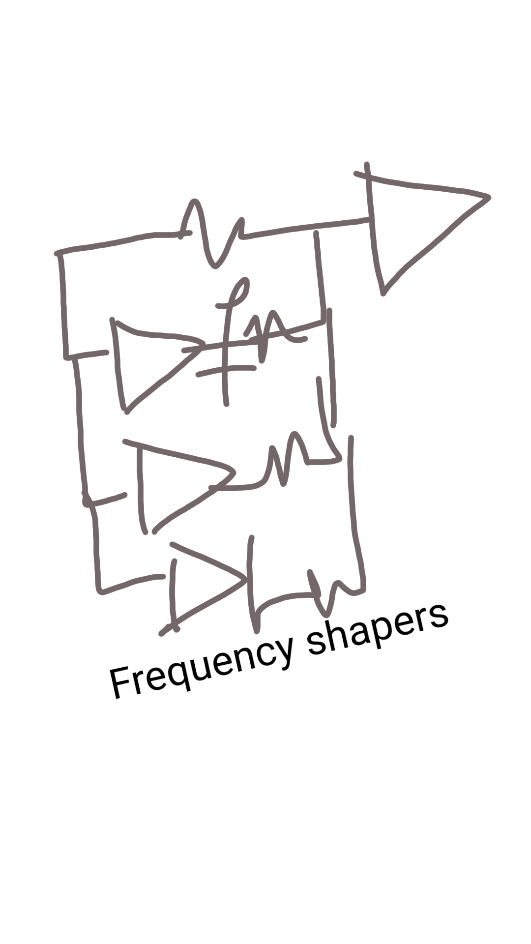

If it is Audible..i think the culprit is some sort of intermodulation ...which is similarly why bi, tri et al amp speaker setups tend to be superior...
In the first the main opamp is simply summing the output from each freq shaping network... It becomes additve or subtractuve based on the phasing..
In the second..the main opamp carries the entire burden of summing the shaping circuits whilst at the same time its global feed back network is being manipulated To produce the add/subtract feature...
