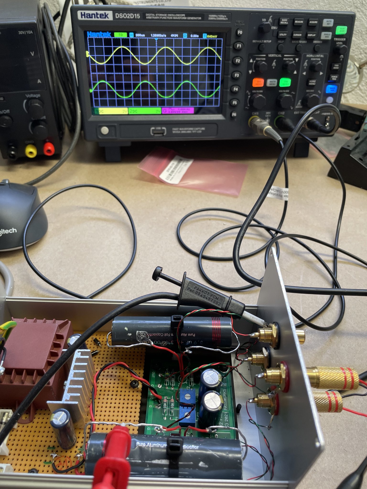

So now there is silence when previously you said there was noise. Is there still AC voltage?
If you measured good voltages at T1 and T2, that is a good sign that the J113 is working.
If you input an AC signal, you can track its progress at the J113 gate, at the J113 drain, at the input and output of the output capacitor, at the RCA output jack, at the output end of the RCA interconnect. There are lots of clues to be found.
@Ben Mah My mistake, from this H2 I never got sound or noise out. I had another channel in parallel with H2 and input from signal generator then from one channel connected straight from signal generator to amp I can here that signal noise but the other channel that goes through H2 I do not hear any noise or sound. I think that i will give up and wait for H2 PCB-s from DIYaudiostore with right J113-s and then we will see if that is working with my set up. Shipment from US to EU may take quite a long time.

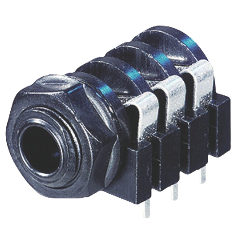

I have good news. H2 boards arrived from Diyaudiostore. I had same issue at first that no sound. Then using DM I somehow was touching this Stereo Connector 6.35 mm tip pin pushing it and I heard sound. This NTR-NYS216 connector did not gave any contact to my 6.3 mm amp input cable. I could not believed it. Then I changed this connector to better one with another type and now sound comes out. So my first board is also working and now I have some extra boards if anybody interested.
