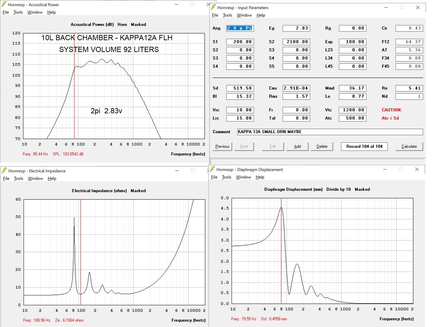

Does "this" make sense? -like "in the ballpark"? - or did I flub my dub ? please correct. (It looks to tune somewhat high -?)

In your example, the 3th segment should be roughly 46.5 - (13.9 / 2) = ~39.5 cm. In the 2nd segment I would add (4.5 / 2) + (4.2 / 2) + 1.5 cm(material thickness)
I calculate a total axial horn length of 110.2 cm. With the magnet inside the horn you can add the volume inside the cone to Vtc and subtract the surface area that the cone occupies in the horn (roughly 100 cm2). Both further lower the tuning.

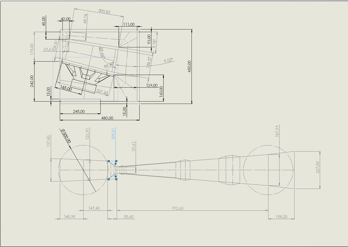

Hi I have set out & unfolded the Cubo 12 Note the unfolded sketch would require one more segment than Hornresp can handle so it needs to be simplified or the large chamber method used. Not tried to sim this yet but thought the info would be useful. also attached as a zipped up DXF file. Regards Martin (Xoc1)

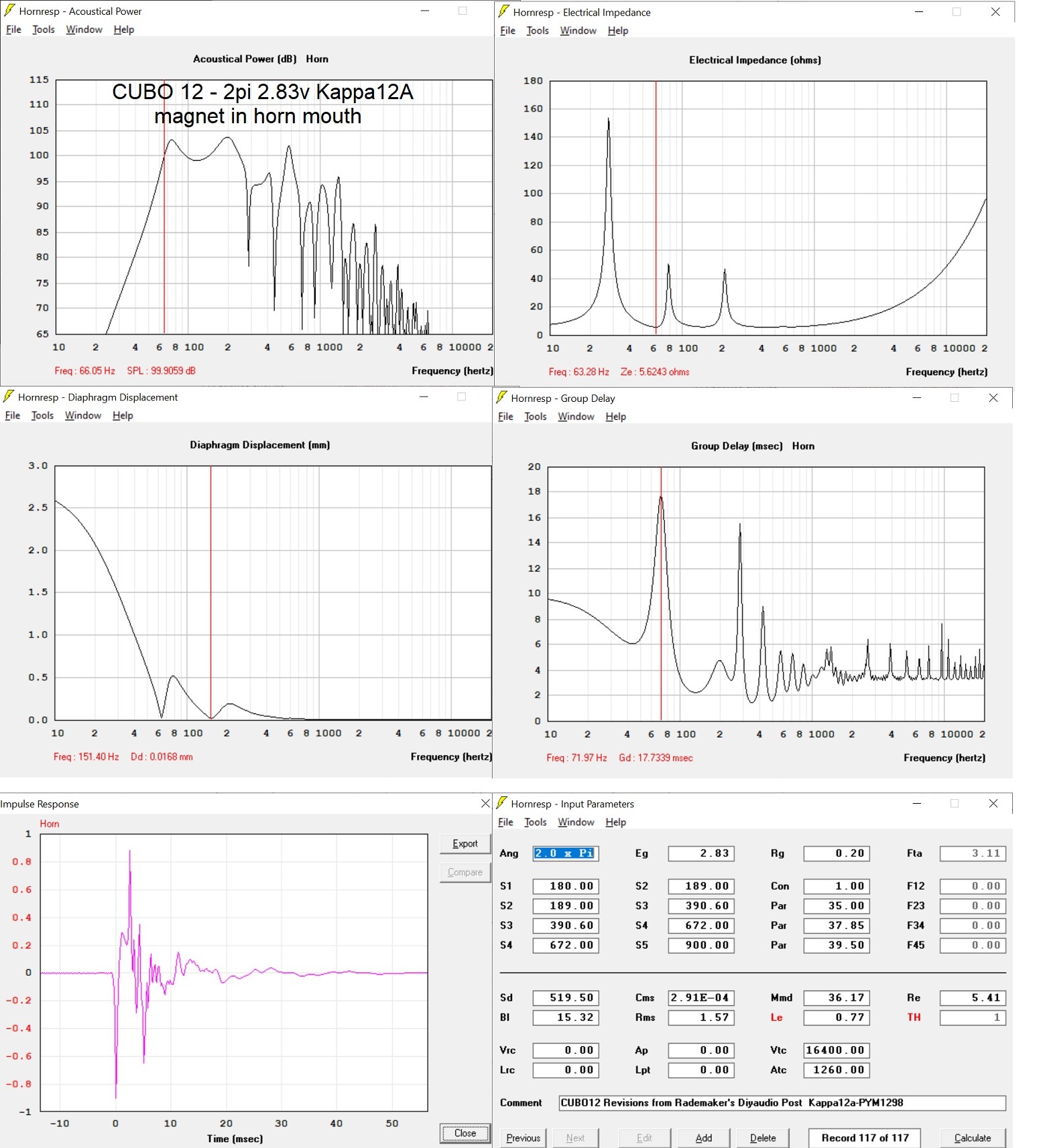

Hi Rademakers - I missed your post - Here's a revised hornresp for CUBO12 - I interpreted something wrong and its length is a bit more than what you stated - plus I wasn't sure how much to subtract from the mouth for the cone and magnet
Anyhow - if it performs like this - I will be quite happy.

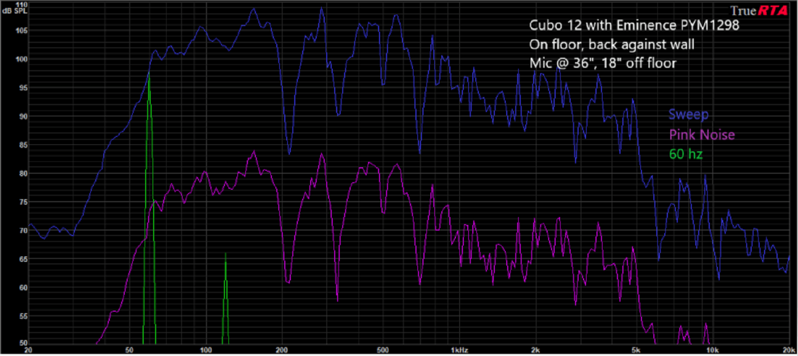

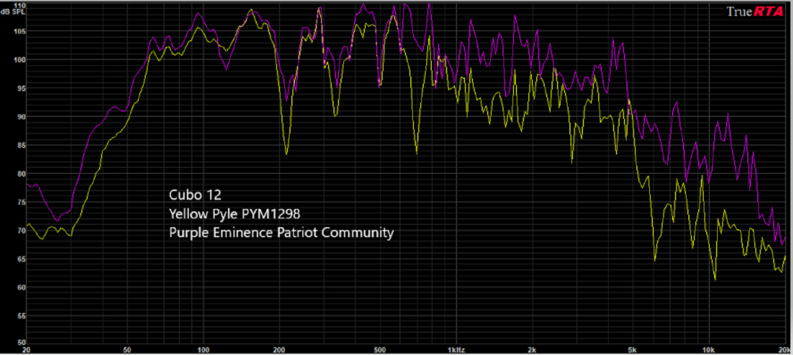

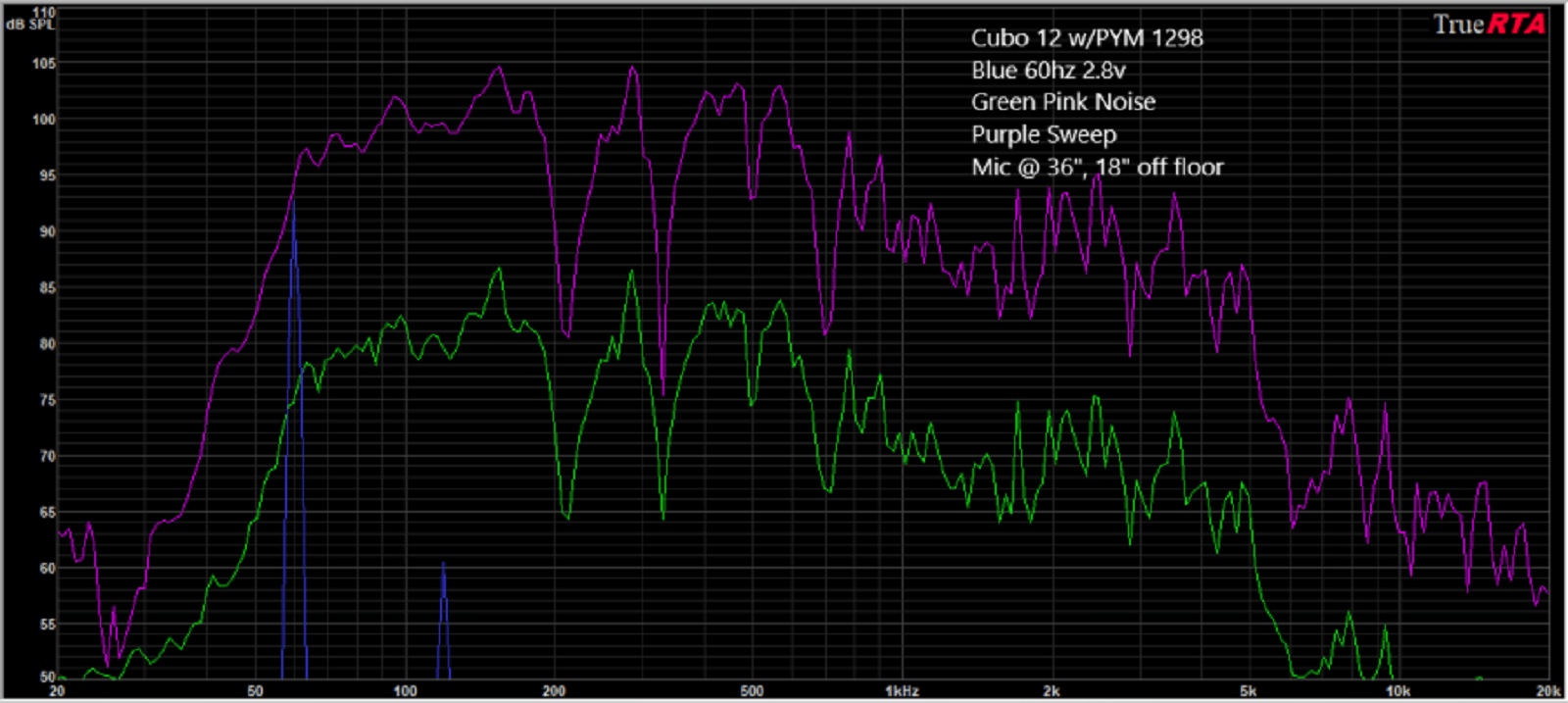

Gee - It measures very nicely with the Pyle PYM1298 (~Kappa 12A spec - maybe a few more ounces magnet slug) -
I'll have to verify whether that was outdoors or not as the legend mentions "floor".
60Hz H2 (120Hz) is 32dB down at one watt nominal drive so good there tho very low drive level.
