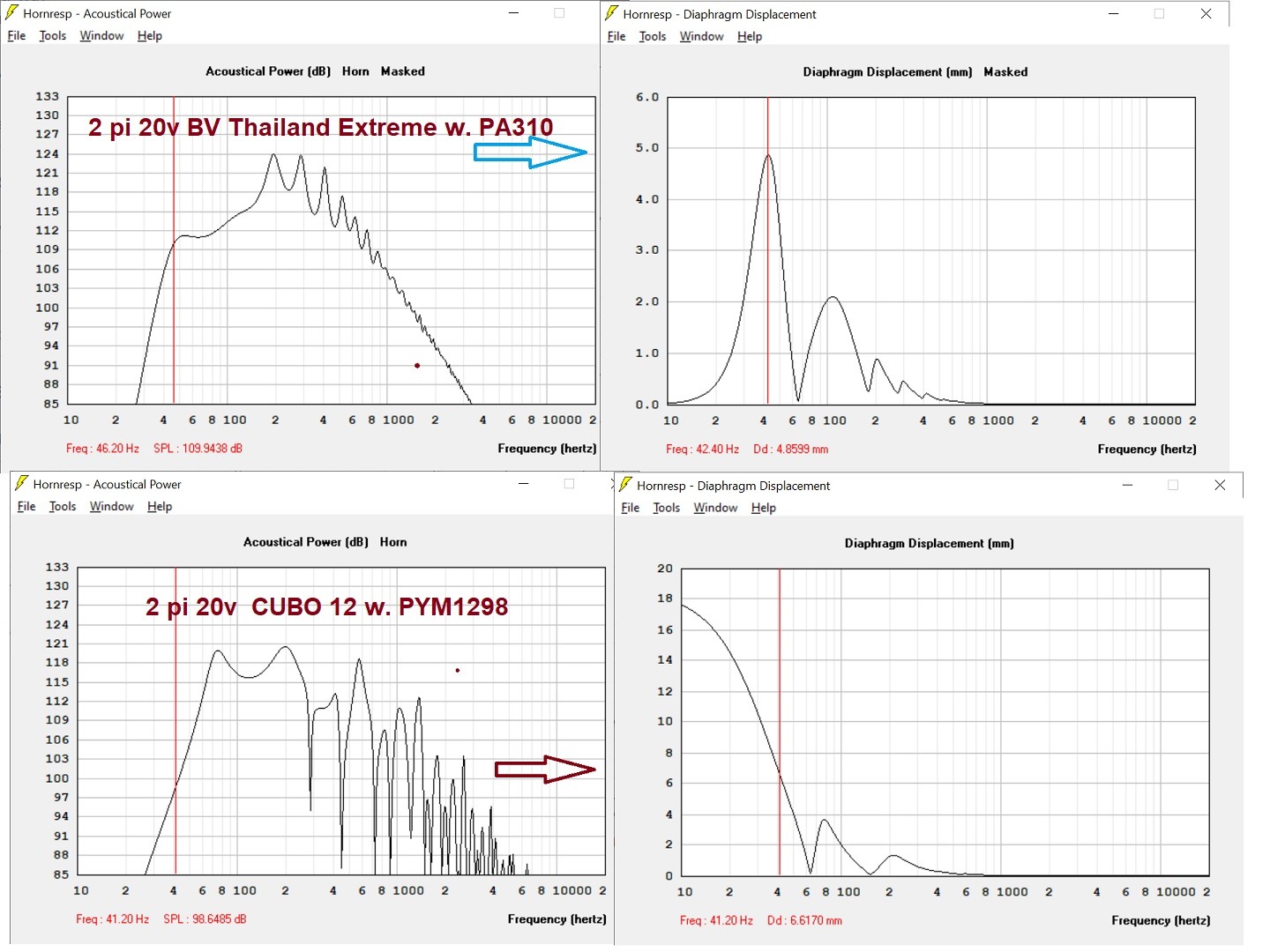

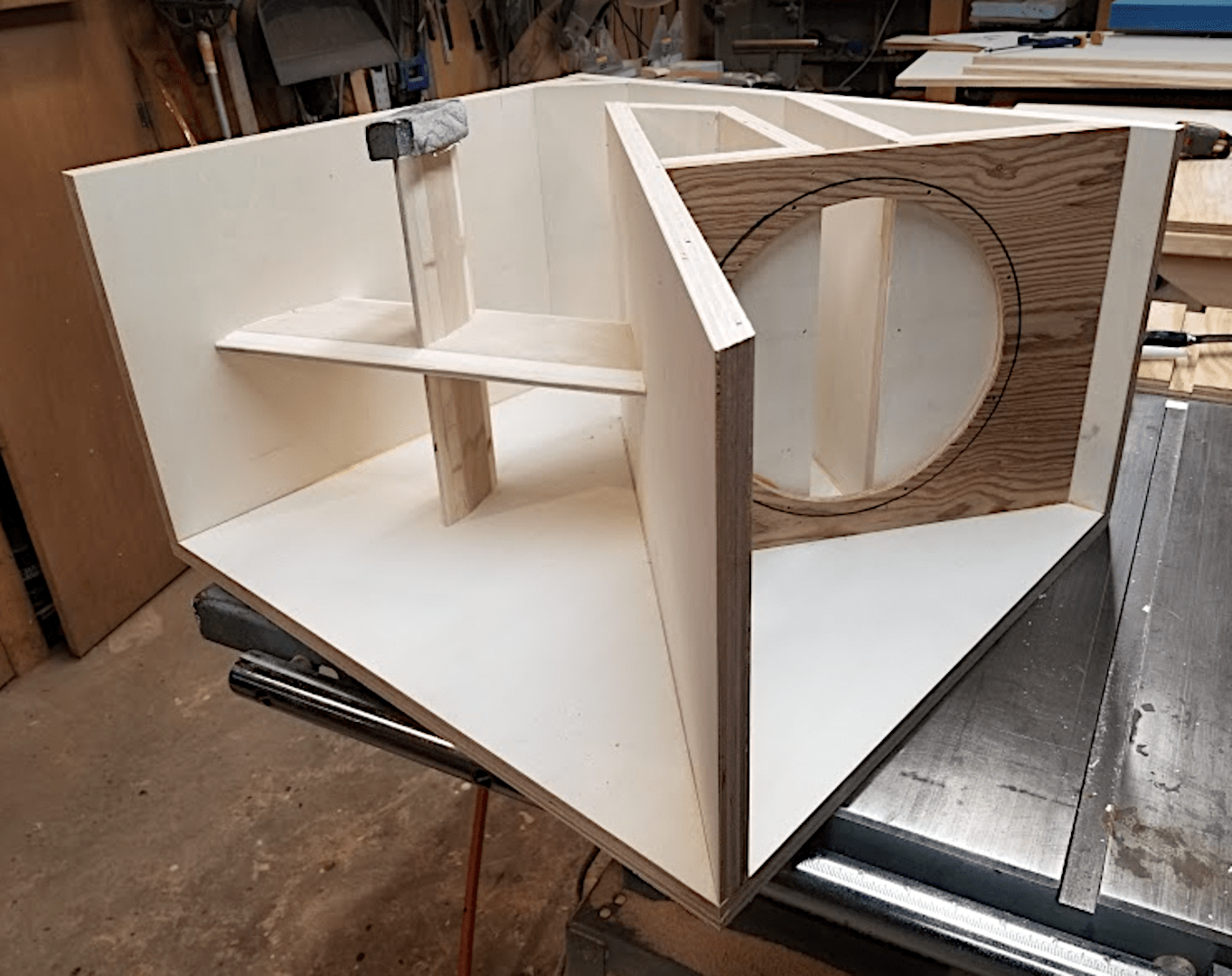

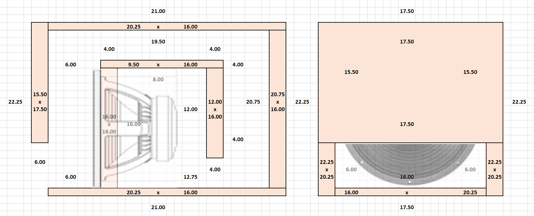

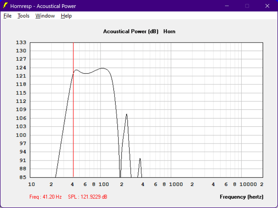

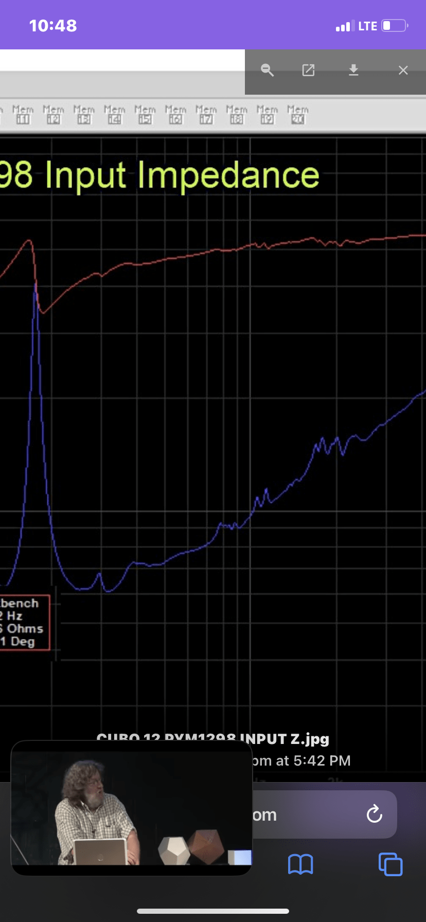

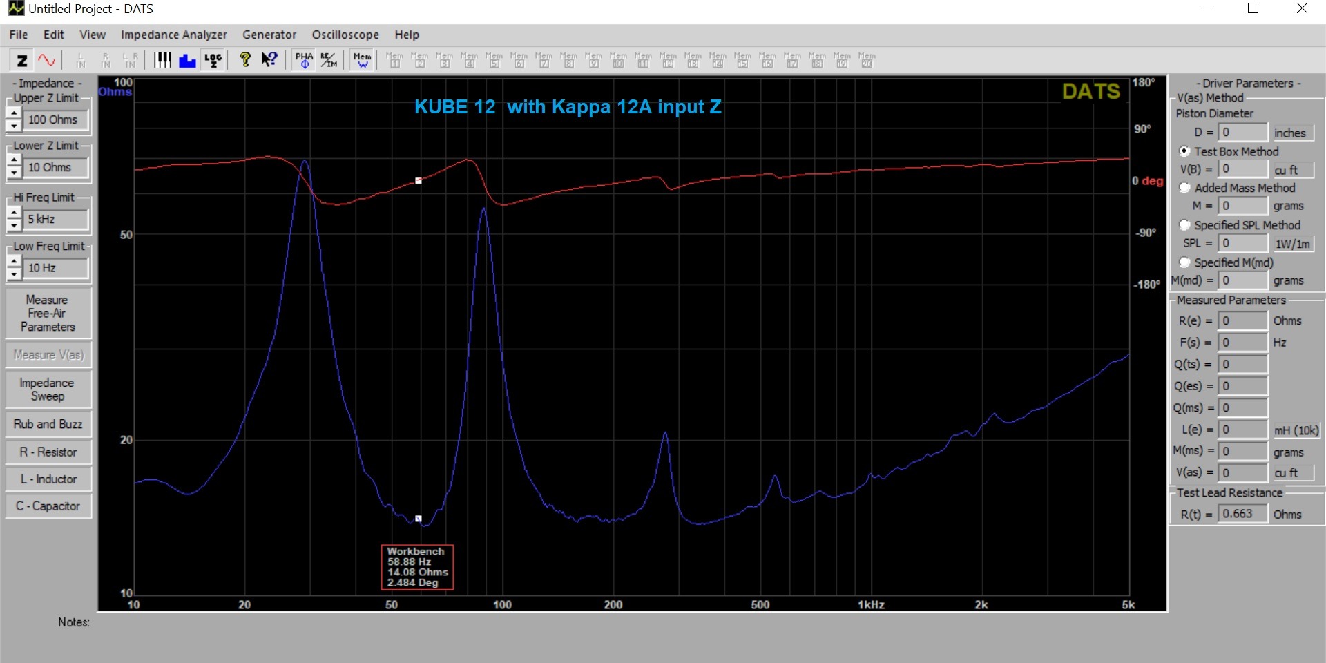

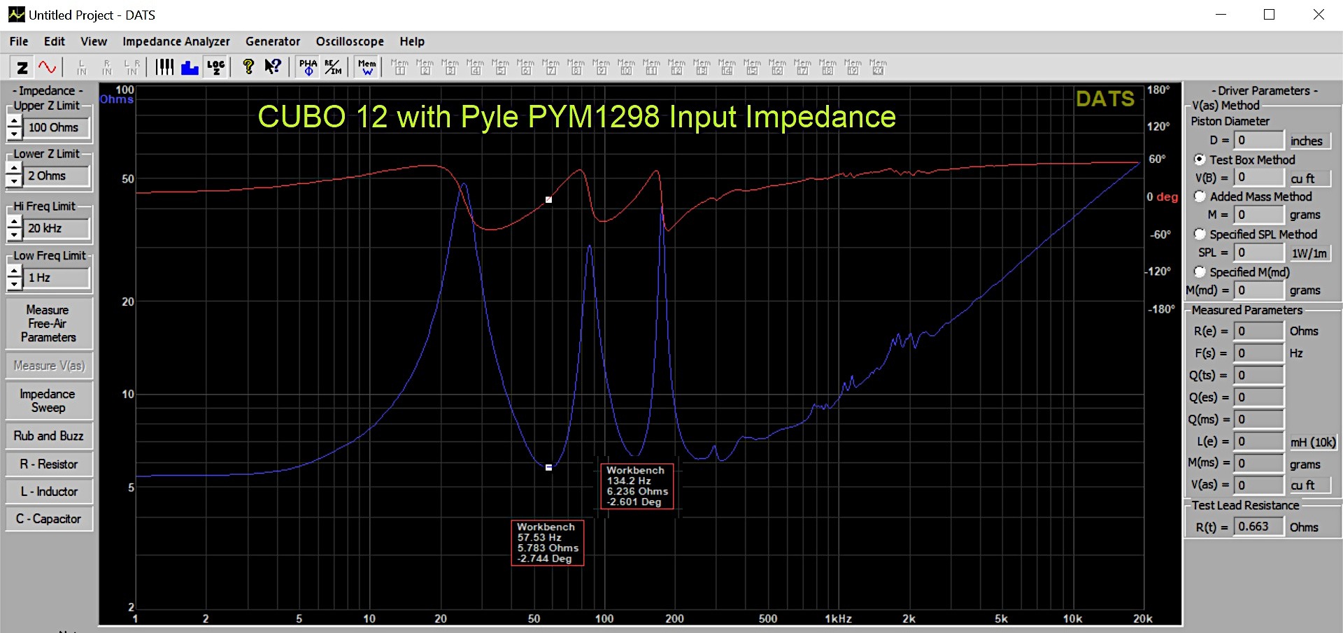

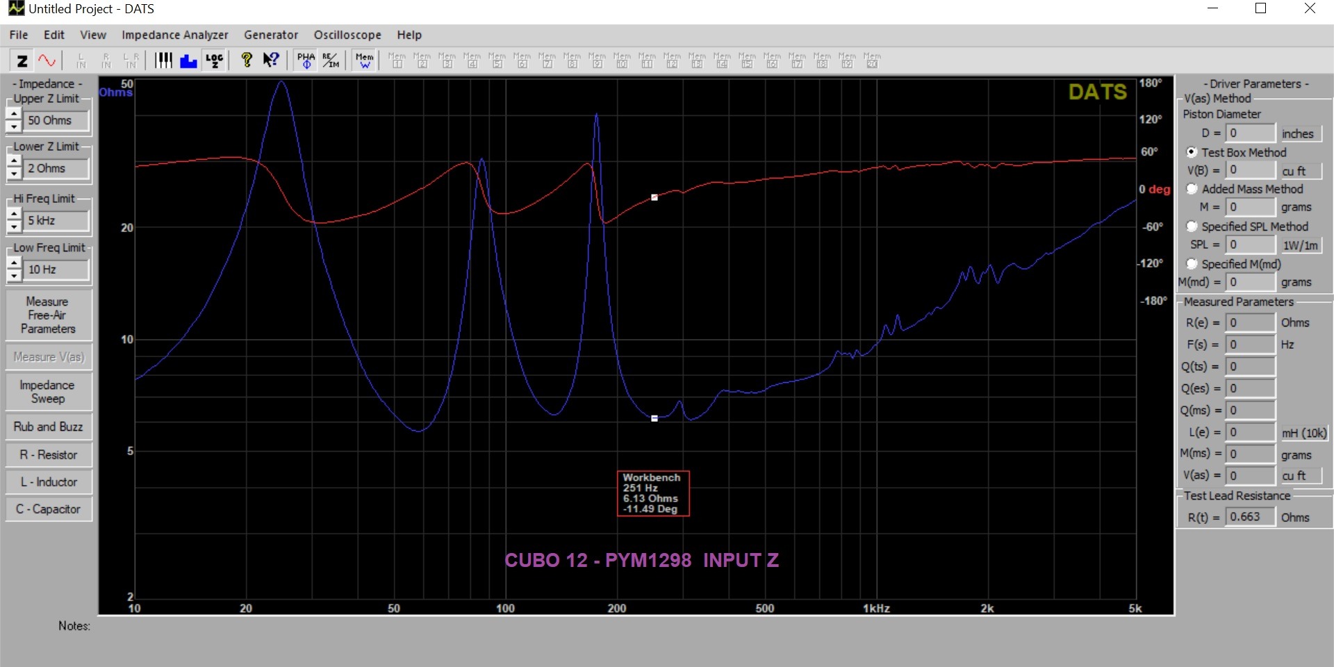

Here's the input Z for CUBO12 loaded with a Pyle PYM1298 12" speaker. PYM1298
was built by Eminence and quite close to Kappa 12A. (a fave of mine)
Cubo 12 is nicely tuned and makes a nice fat "horn-like" 60Hz sine wave in my listening space.
I guess it makes me a "junior CUBOTEER" ;^)

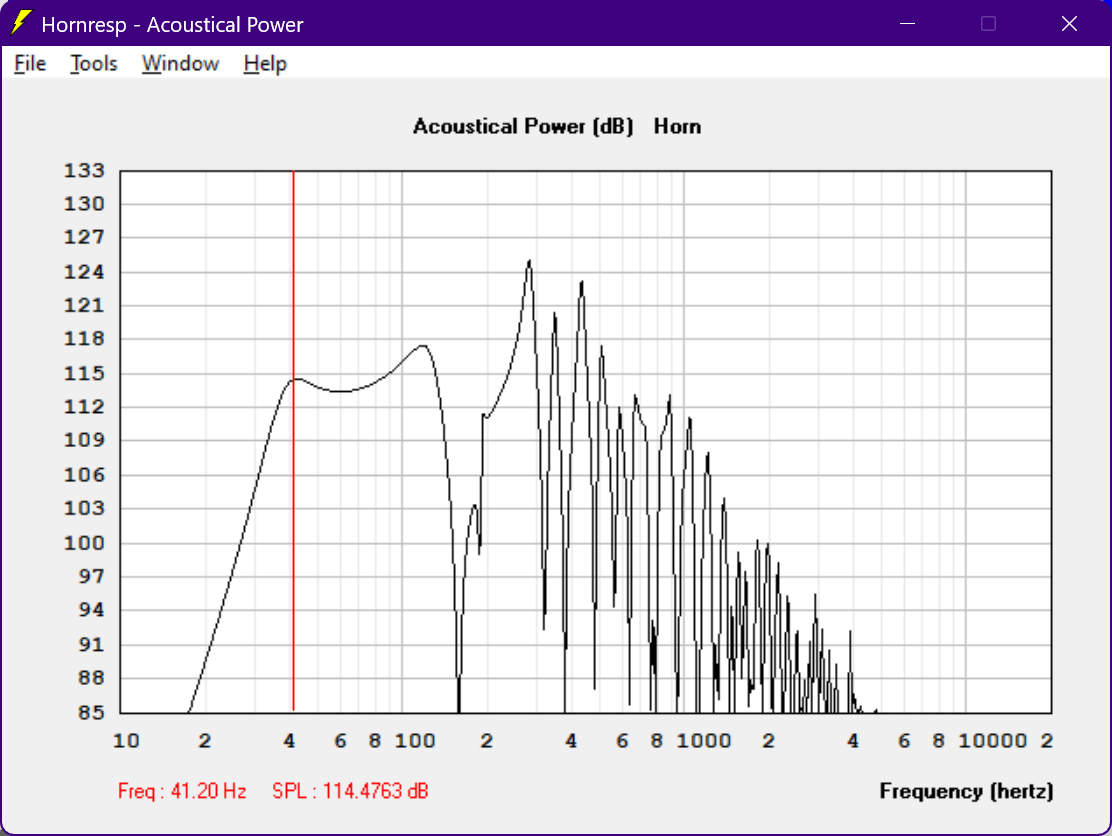

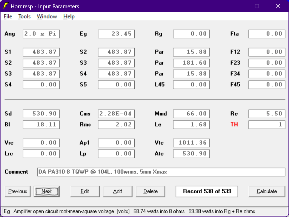

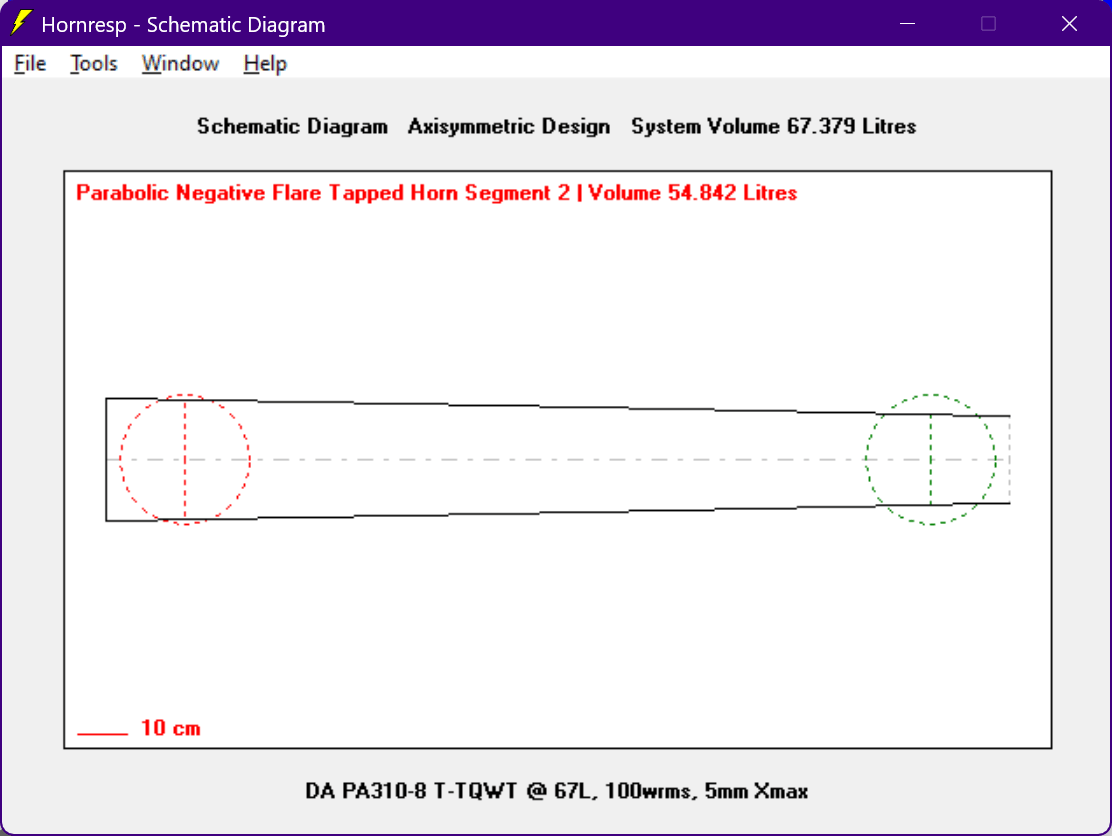

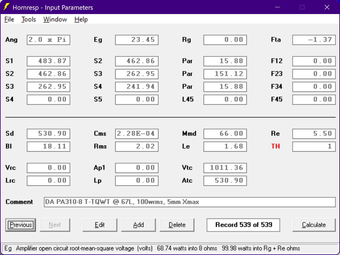

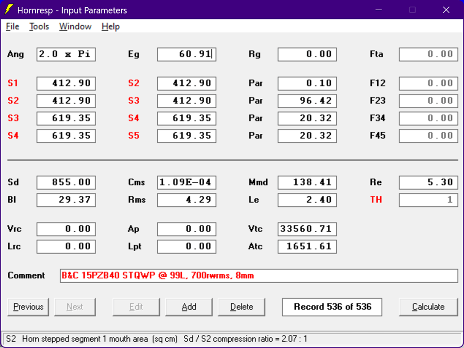

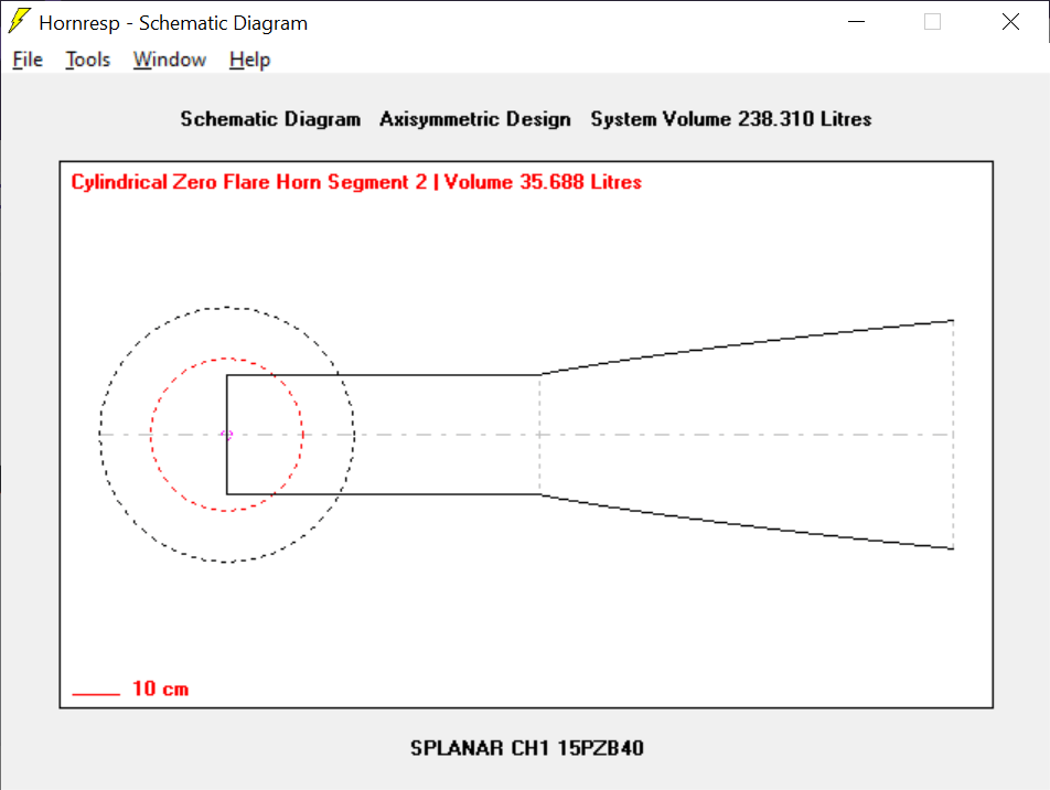

IF I copied your input screen correctly:

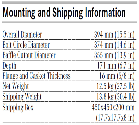

15PZB40 lossy Le
Is that model for a PA310 or a 15PZB40?

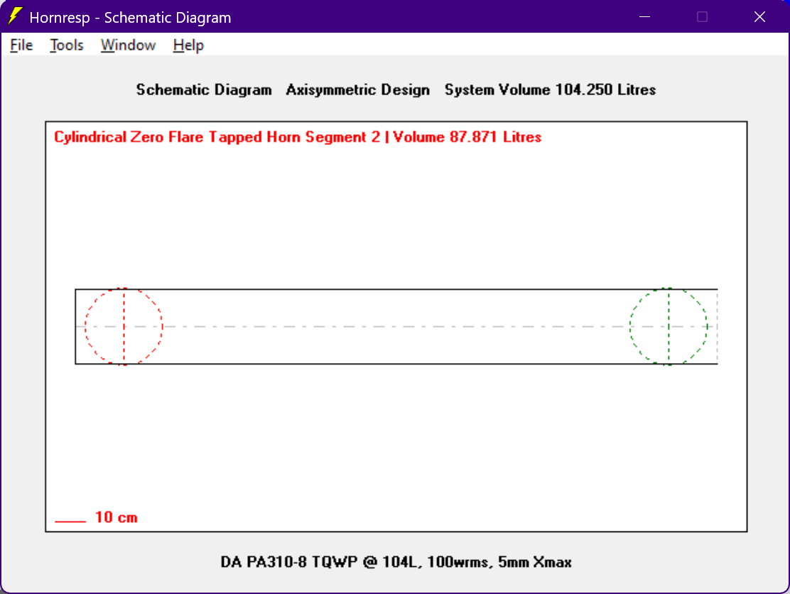

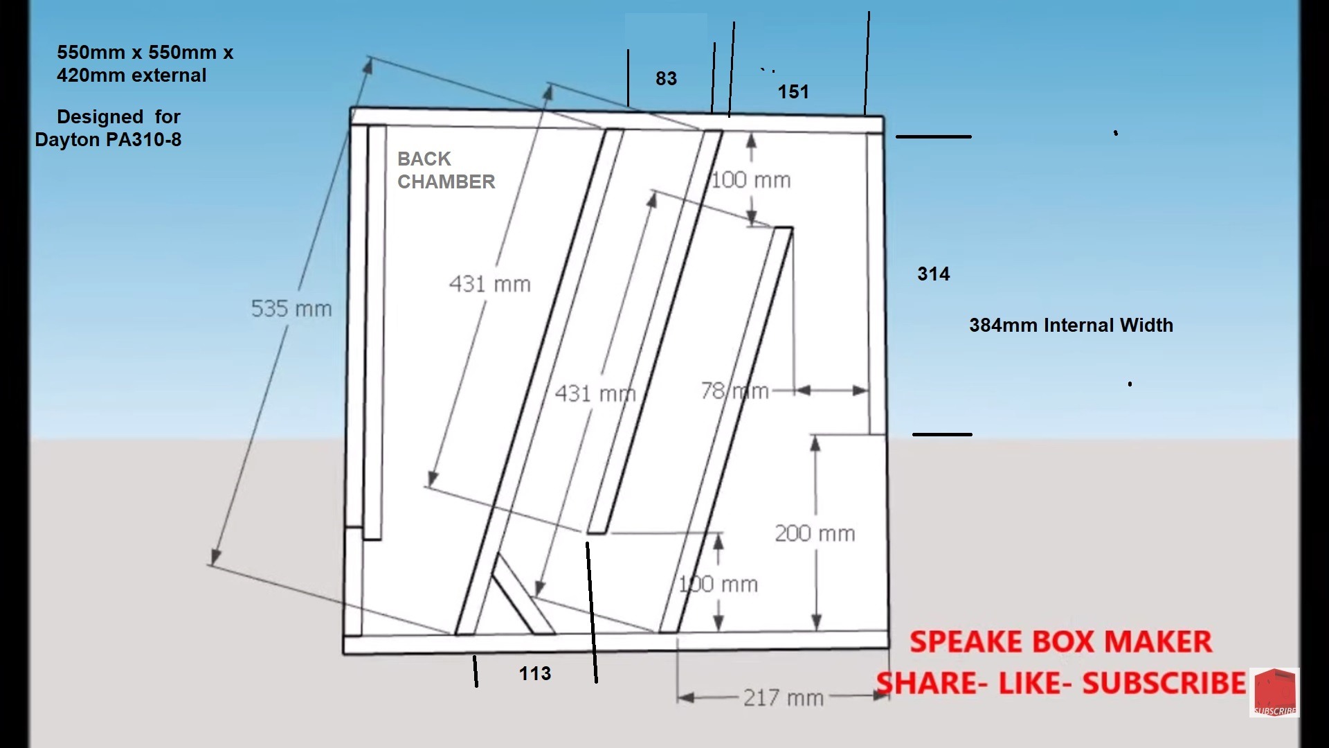

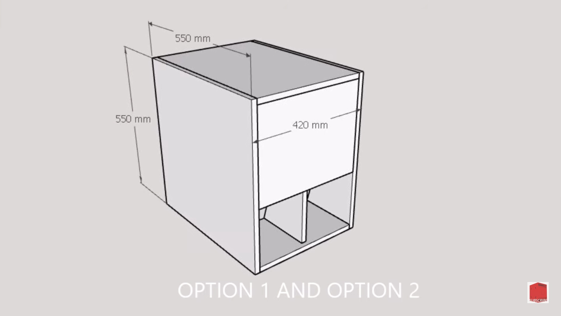

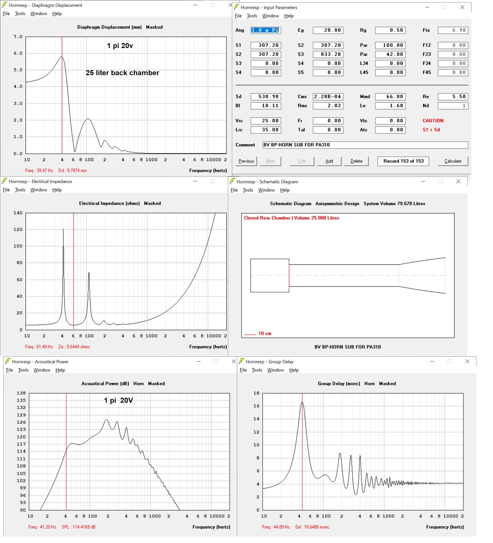

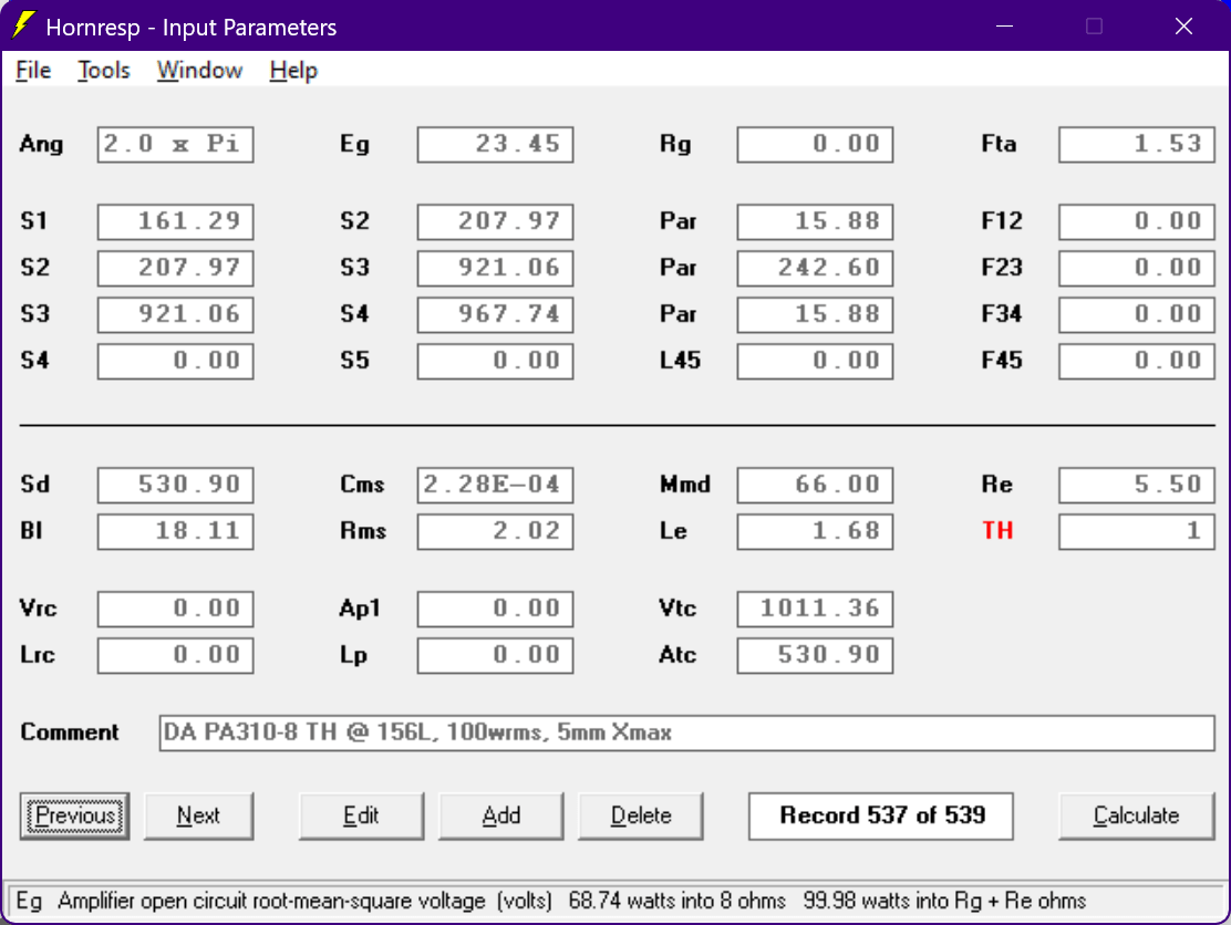

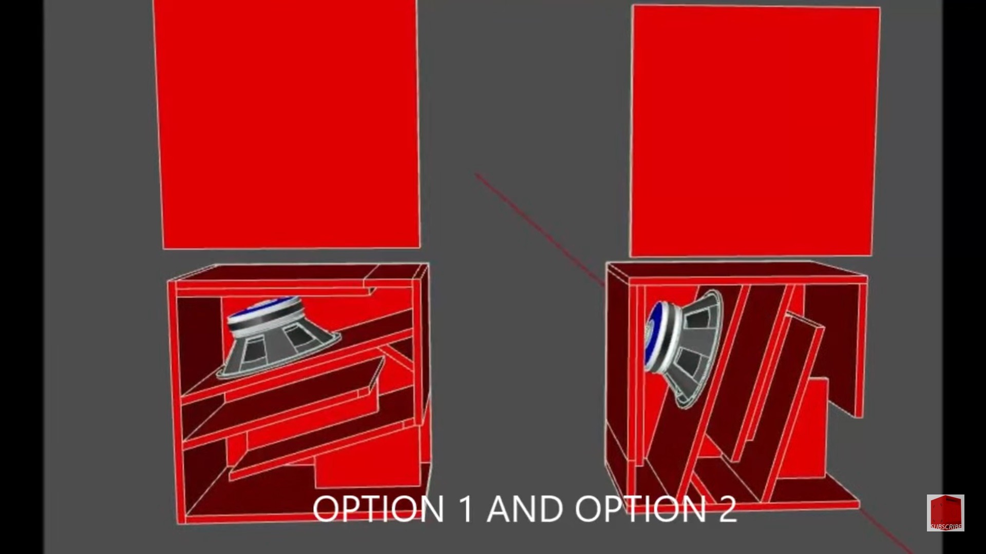

Gee- - that's very impressive - I've got one for you to spin from Youtube for PA310-8 to see if it oes what's claimed an worth building.
Its' aspect in this picture looks a bit off as is supposed to be 550mm x 550mm x 420mm external with a 384mm internal width.

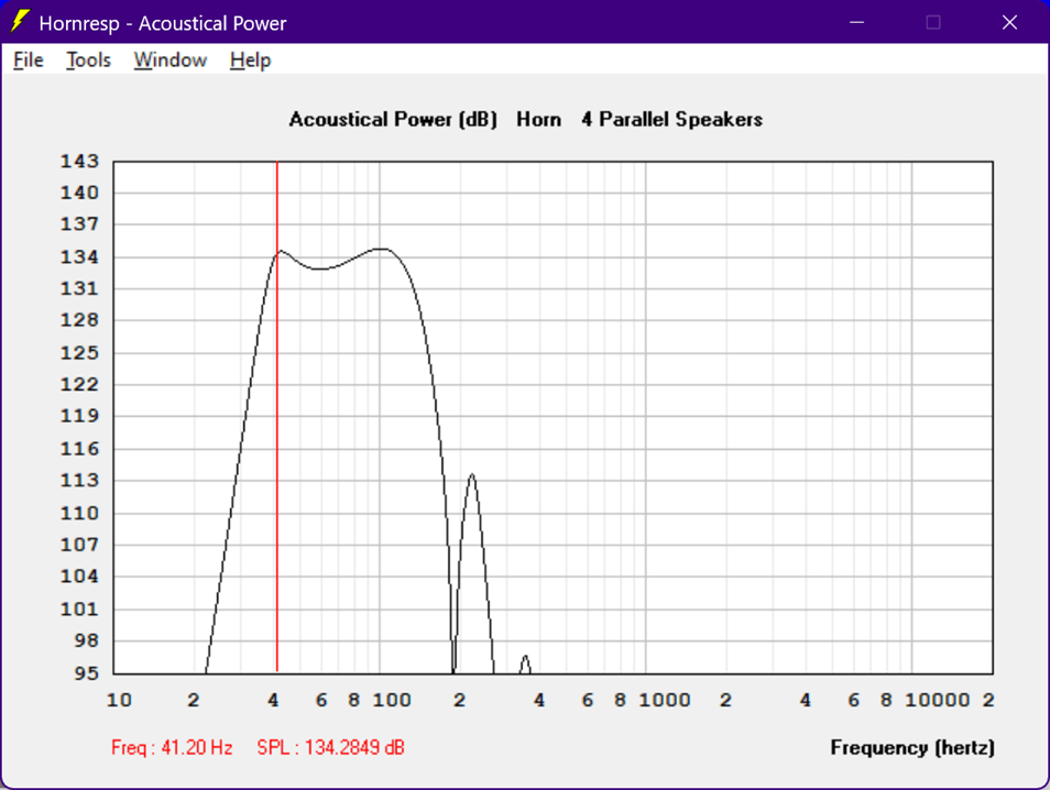

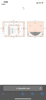

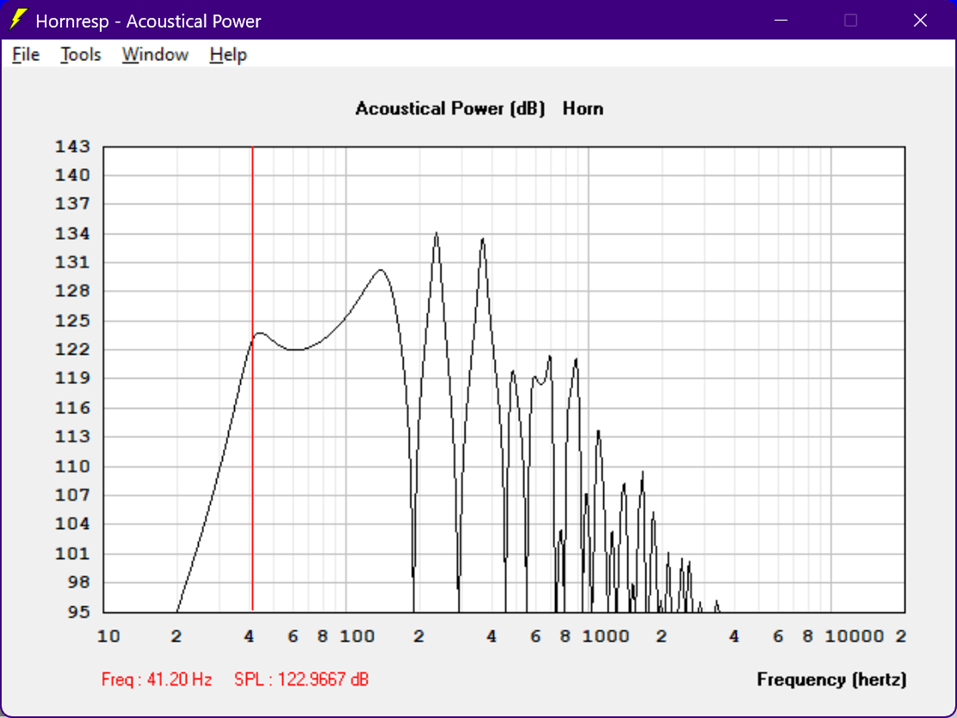

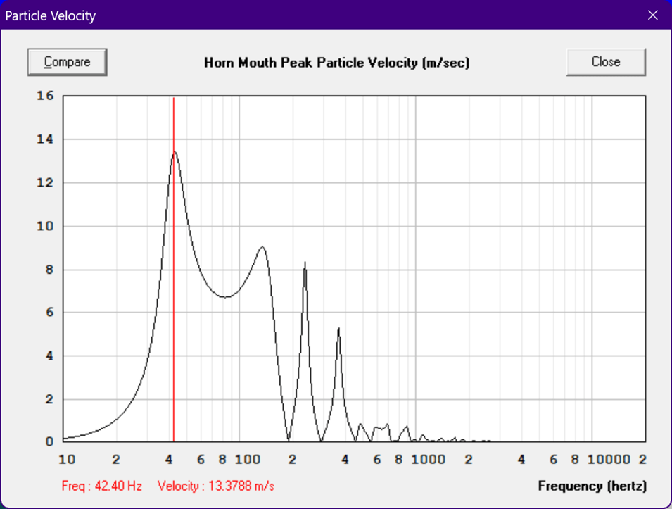

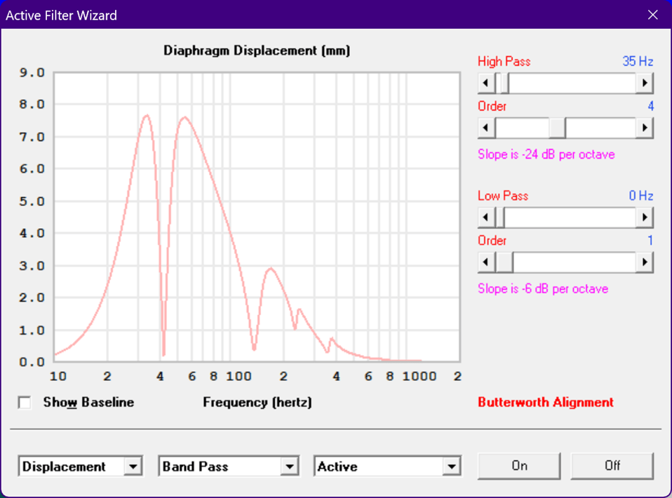

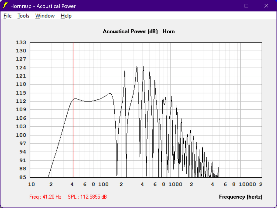

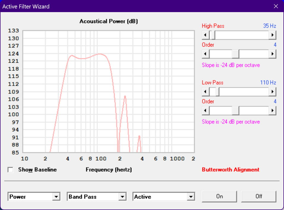

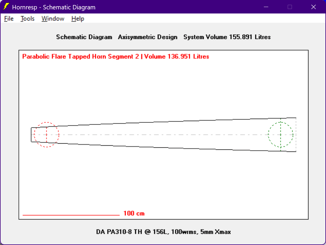

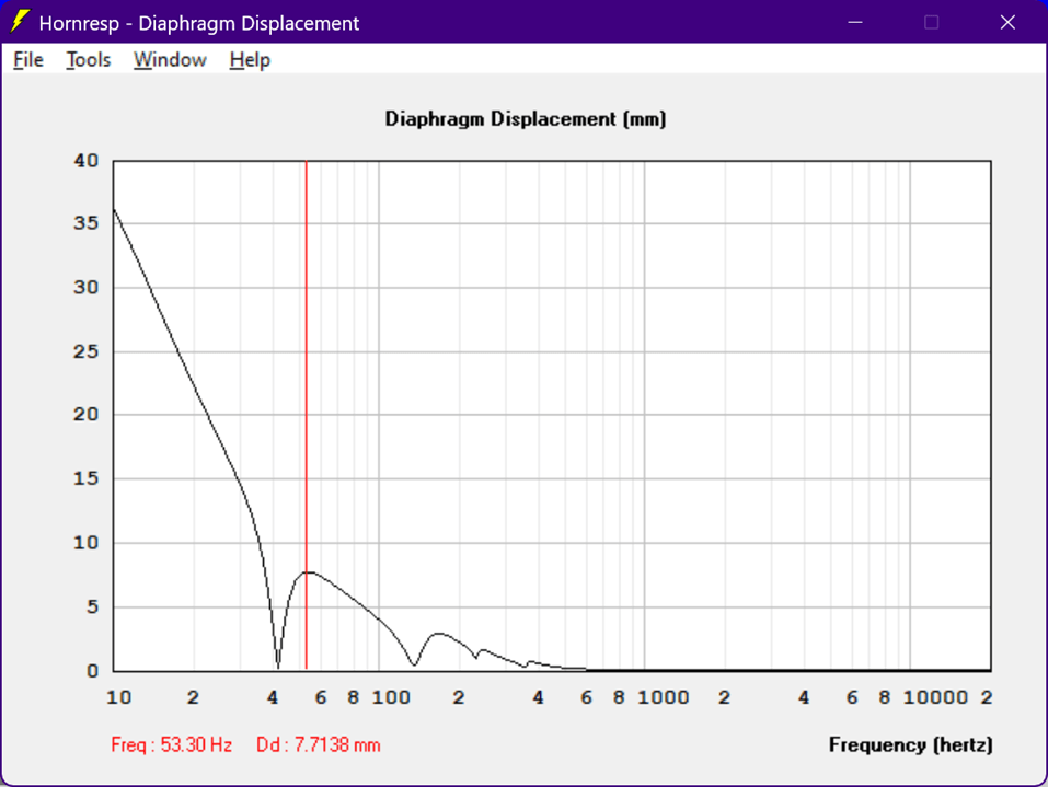

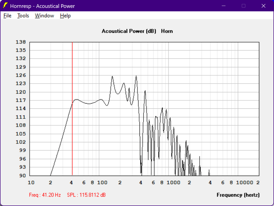

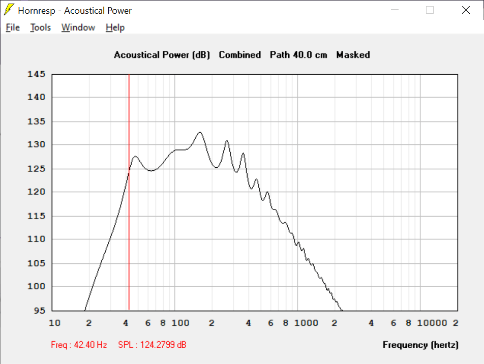

Here's what I get eyeballing the little PA310-8 Youtube plan. I did not know what to do to model the offset.
- it looks good to 20V input at 41Hz - -ok for indoors support of smallhorn3 in a small house trailer

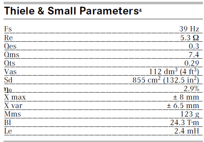

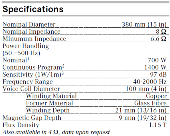

15TBX40 ought to sub fine for 15PZB40
@BP1Fanatic - Extreme thanks for the extreme effort and plan - that looks like a winner and may well get a build. I'l put 15TBX40 spec in your hornresp input.
