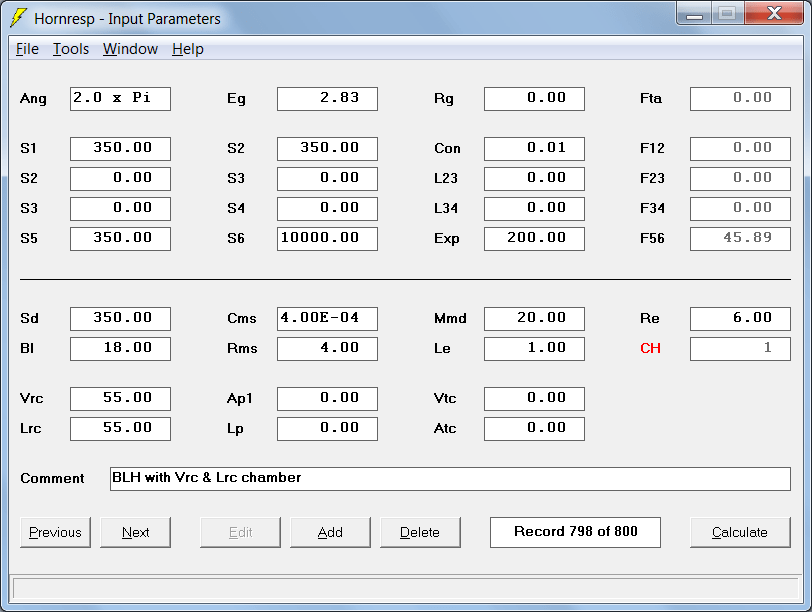

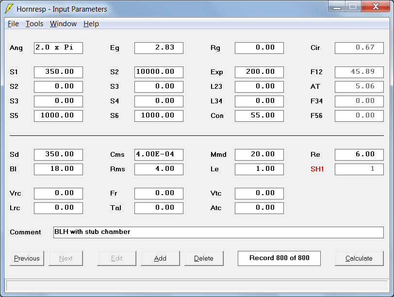

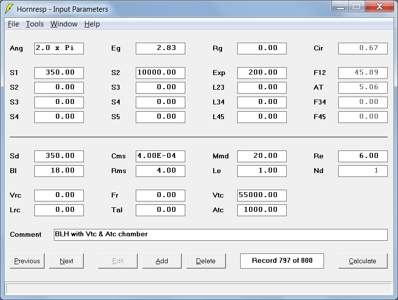

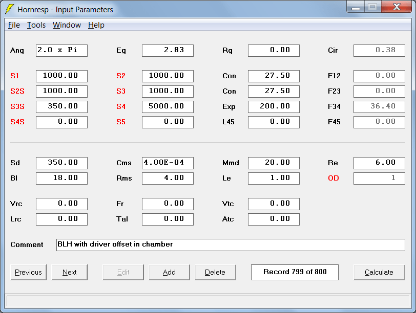

The chamber parameters in Hornresp (Vrc-Lrc) are for a closed chamber, while in BLH it is an open coupling chamber so I wonder if the simulation of the chamber in hornresp is accurate enough also for a BLH
Vtc & Atc would normally be used to specify the chamber in a BLH system, as shown in Attachment 1.
Vrc & Lrc could alternatively be used, but then the design would need to be as shown in Attachment 2.
Attachments 1 and 2 use Driver Position Ratio = 0.0.
Attachment 3 uses Driver Position Ratio = 0.5.
Attachment 4 uses Driver Position Ratio = 1.0.
Thank you David that's a very useful feature.

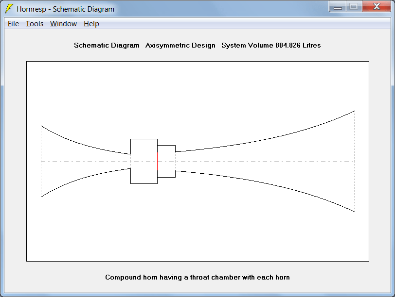

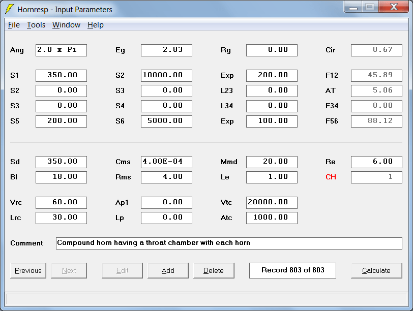

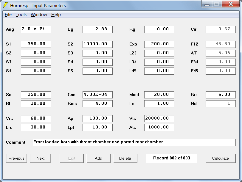

Is it possible to simulate a front loaded horn with a rear chamber which has the same characteristics of the coupling chamber of the BLH ?
Not sure that I understand - if you are asking can the sealed rear chamber on a front loaded horn system act as an acoustic low pass filter, then the answer is no.
In the case of a horn which has both front and rear loading the same chamber serves both the FLH and the BLH.
Once again, not sure that I understand - are you perhaps referring to a compound horn, as shown in Attachments 1 and 2?
But how do I simulate a "ported" chamber for the FLH
Specify the rear chamber using Vrc & Lrc, and the port tube using Ap & Lpt, as shown in Attachments 3 and 4.
You can also use the CH function to model BP6P's, basically a straight flare compound horn with compression (coupling) chambers. I modeled a couple of CH's in this thread a few years ago and compared them to the BP6 function, Nd segments+Vrc+Lrc+Ap+Lpt, and OD segments+Vrc+Lrc+Ap+Lpt. I think I even used Atc+Ltc as a chamber.
