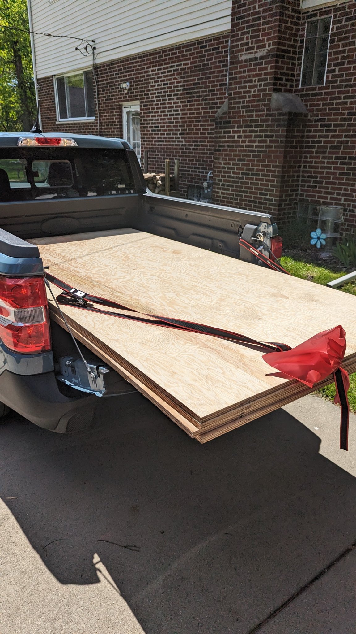

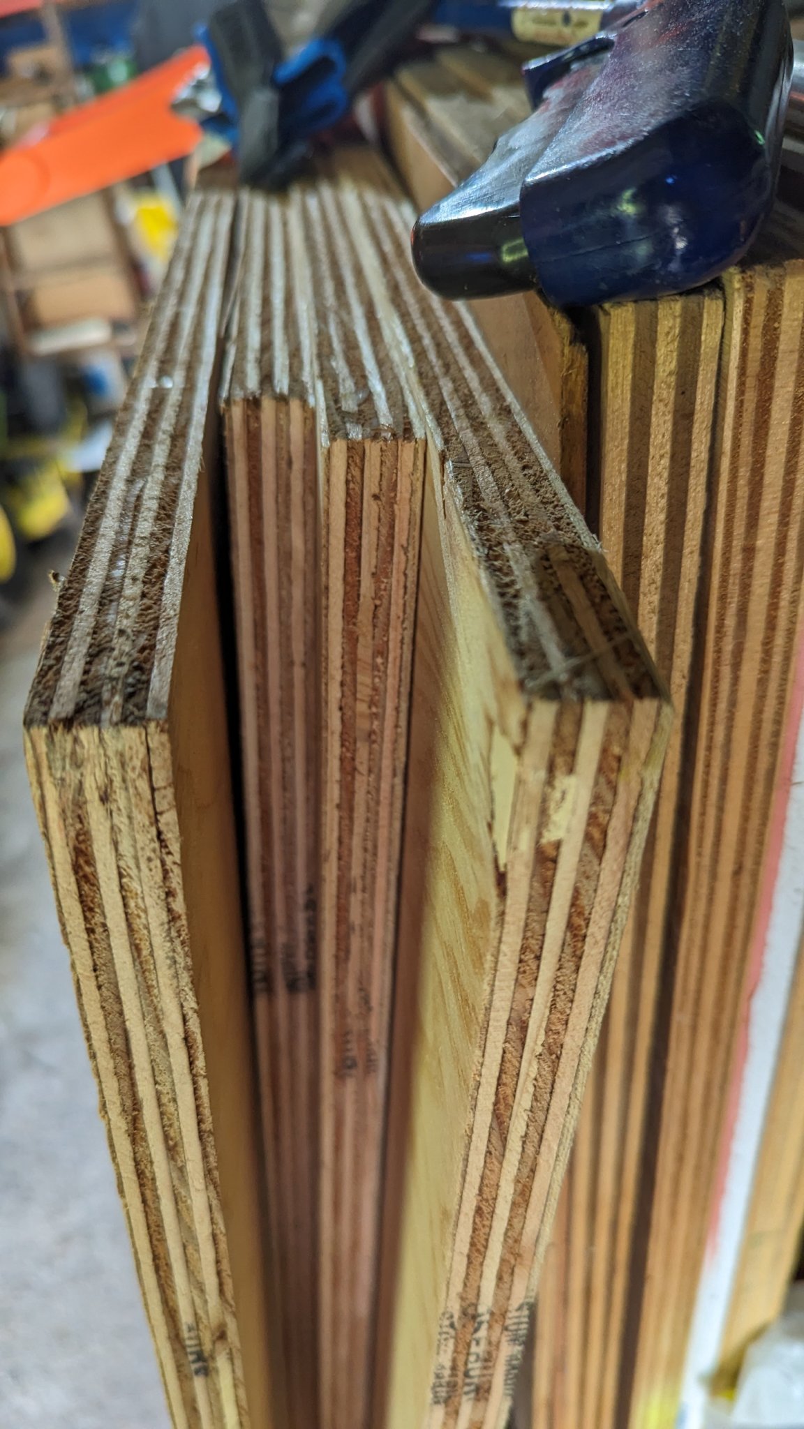

ACX could work OK, without working with a particular plywood brand hard to say.
"A" and "C" refer only to the front and back plys, "X" denotes the use of an exterior grade adhesive to join the panel’s veneers together.
The knots and other imperfections in "C" grade could be a problem on some pieces like the baffle.
The amount (more is better) and what is in the inner plys is important, avoid plywood where gaps, loose knots and "waves" are visible on the sides.
Reactions: 1 users
Ended up with four sheets of marine grade, though I'll likely use acx for future builds (my wallet is on fire)
It's void free, but lacks as many plys as birch. The birch was just a little more pricy and only comes in 5x5; which makes the layout more inefficient with more waste.
Reactions: 1 user

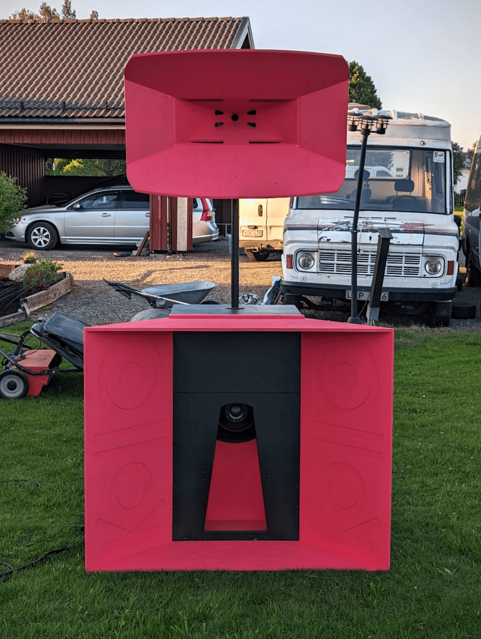

During the last few months I've been building a pair of Keystones to match the SynTripPs I built last year. Have been running them at three parties so far and maaaaan do they kick! I've lost count of the numbers of compliments the subs have recieved. Like others has stated, the output and overall "tightness" is out of this world.
  • 18TBW100-4 powered by a NX6000
  • 30hz BW24 and crossed to the SynTripP at 100hz with a BW24
  • Limiter at 50v
Some build photos: https://photos.app.goo.gl/ZFY16m1YwE1VHc7u5
The only downside is that I've come to the realization that sub-bass gets a lot of neglect in music production haha. After playing around with the subharmonic synth on the PA2 and adding a tiny bit of SX3040-processing I could really feel the sub-bass come alive on most tracks! I like it when the air feels like liquid :) Highly recommend!

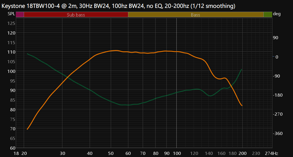

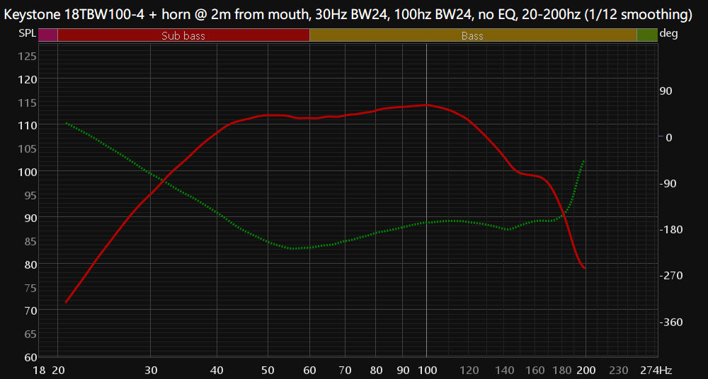

Built horns as well! 35cm deep with 45 deg sides. Now in retrospect I'm not really sure why since I was already more than happy with the power output... Anyways, got to try them out today and took some quick measurements with and without the horn extension:
Taken at 2m distance ~5cm from the ground, 1/12 smoothing. If you look close you'll see some minor fluctuation, but it's most likely due to my dying computer having some grounding issues. The measurement with the horn attached had the microphone moved back 35cm to account for the added depth. Here's the separate measurements with phase:

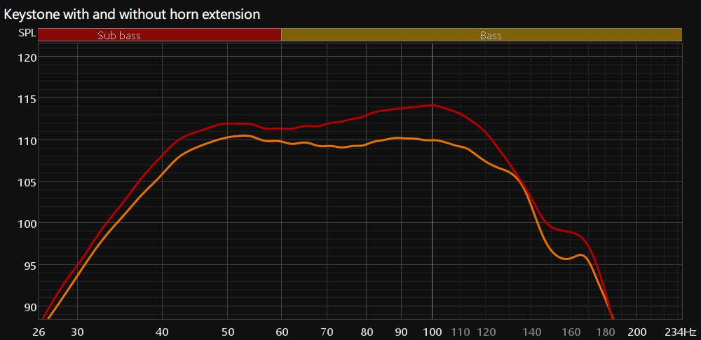

Overall a 2-4dB increase in the whole frequency range! While I could have hoped for an additional dB or two in the 30-50hz region I'm still extremely happy with the results! Art, as I said last year in the SynTripP thread, thank you!

Leo,
Nice looking extensions!
2-4dB increase is like doubling power with no thermal compression, hard to beat.
Your BC18TBW100-4 response looks like it's dropping off below 50Hz, using the BC18SW115-4 it's flat from 40-60Hz, and rises ~+6dB above.
Was there any processing other than the 30Hz/100Hz BW 24?
What was the distance to the van behind, and any other structures?
Art

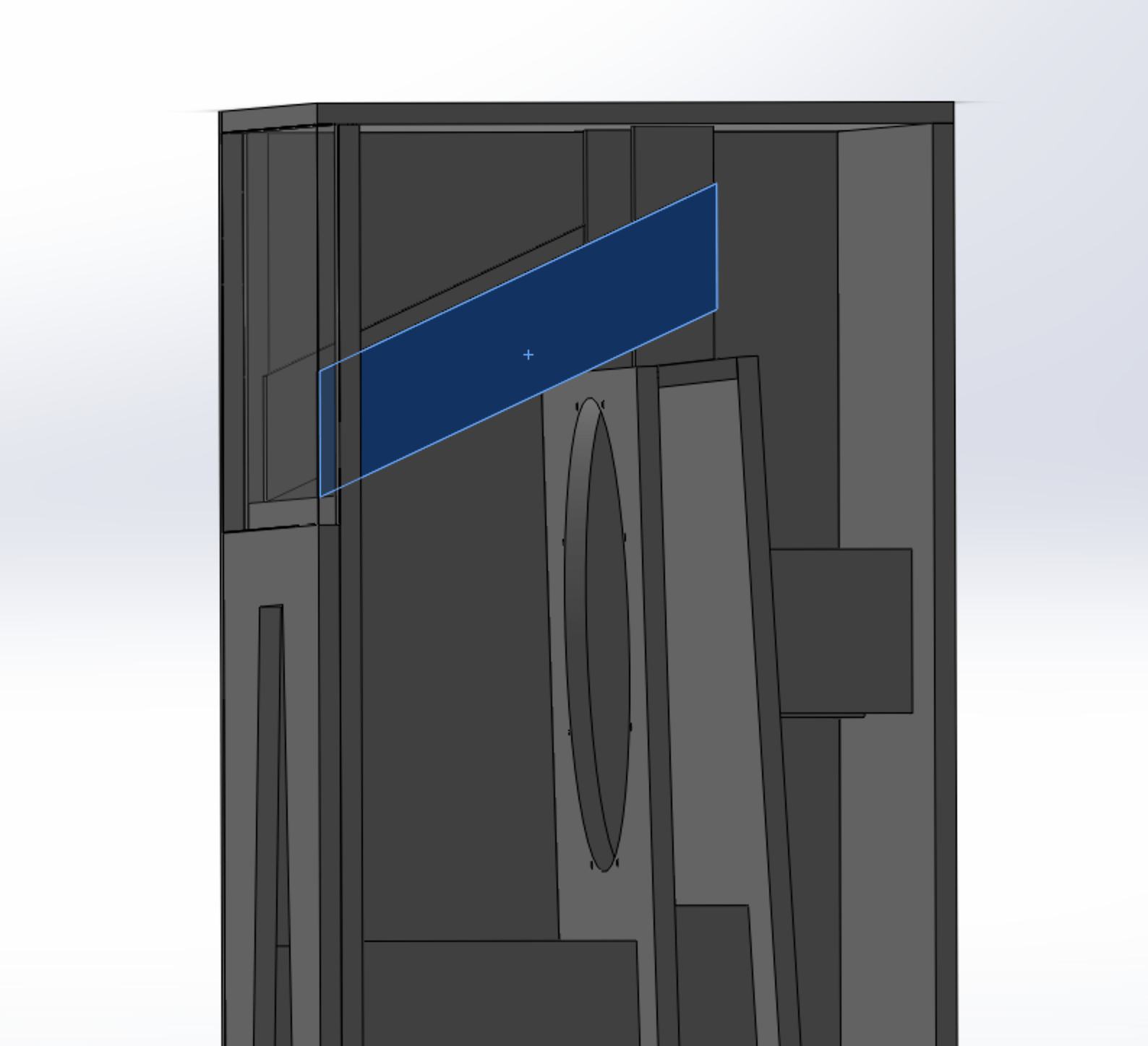

Quick question - I'm looking at the Front Brace (M). Does anyone think there would be a problem with flipping this brace and connecting to the Back panel (B) instead? I'm toying with some ideas for customizing the Top Front Panel (D) and this would simplify things.
The back panel is already braced with K & J, it does not need additional bracing.
Brace M braces the front panel above P, that area needs to be stiff.
If your ideas for customizing the Top Front Panel (D) include some alternate bracing above P, no problem with deleting M.
