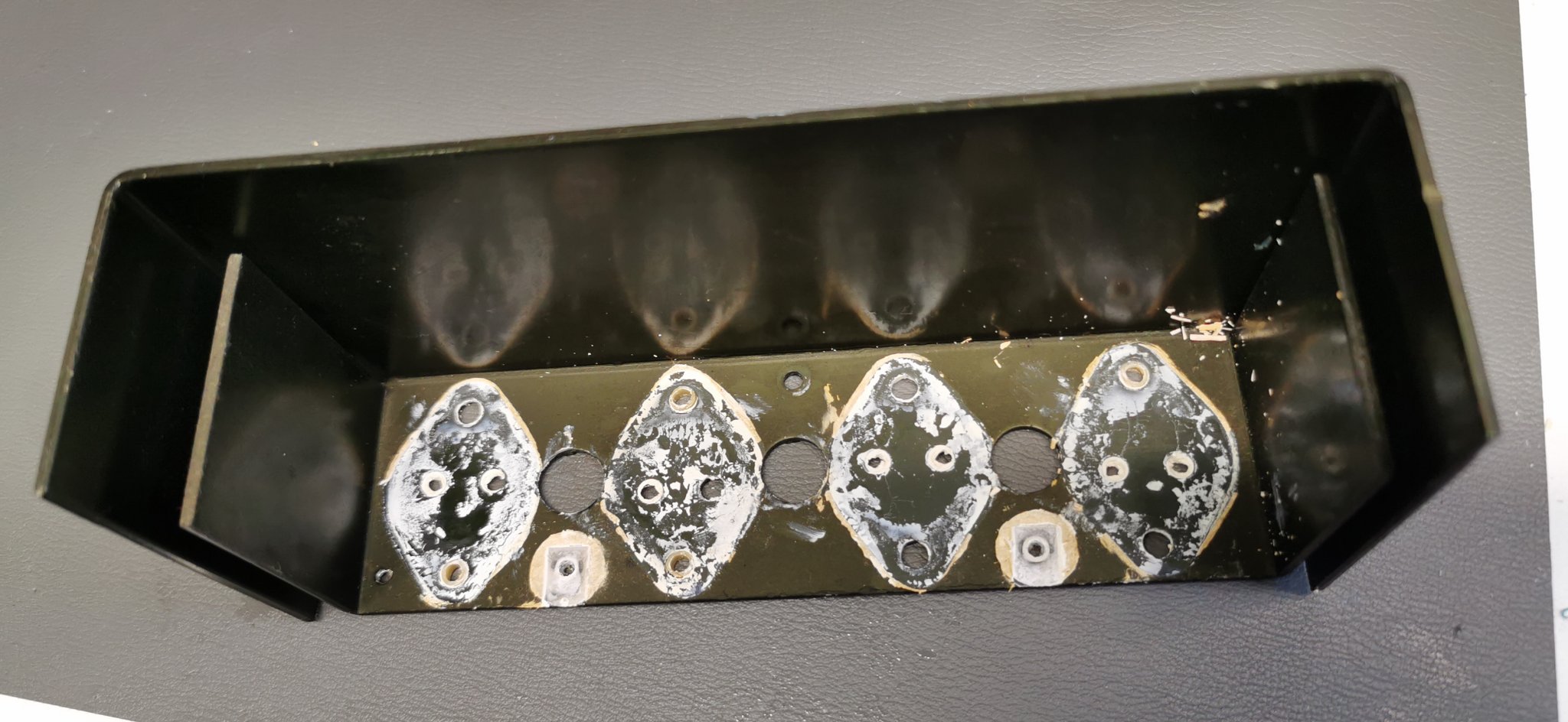

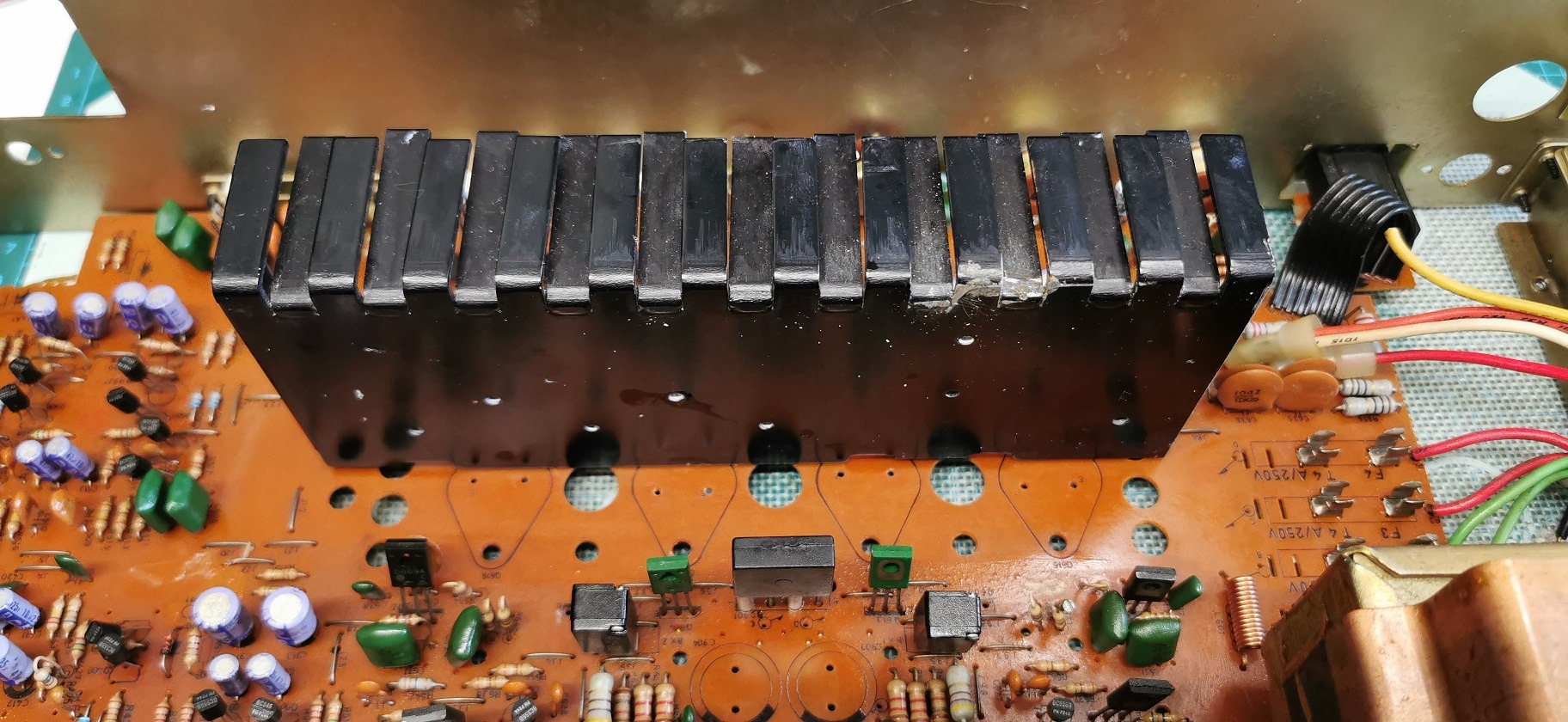

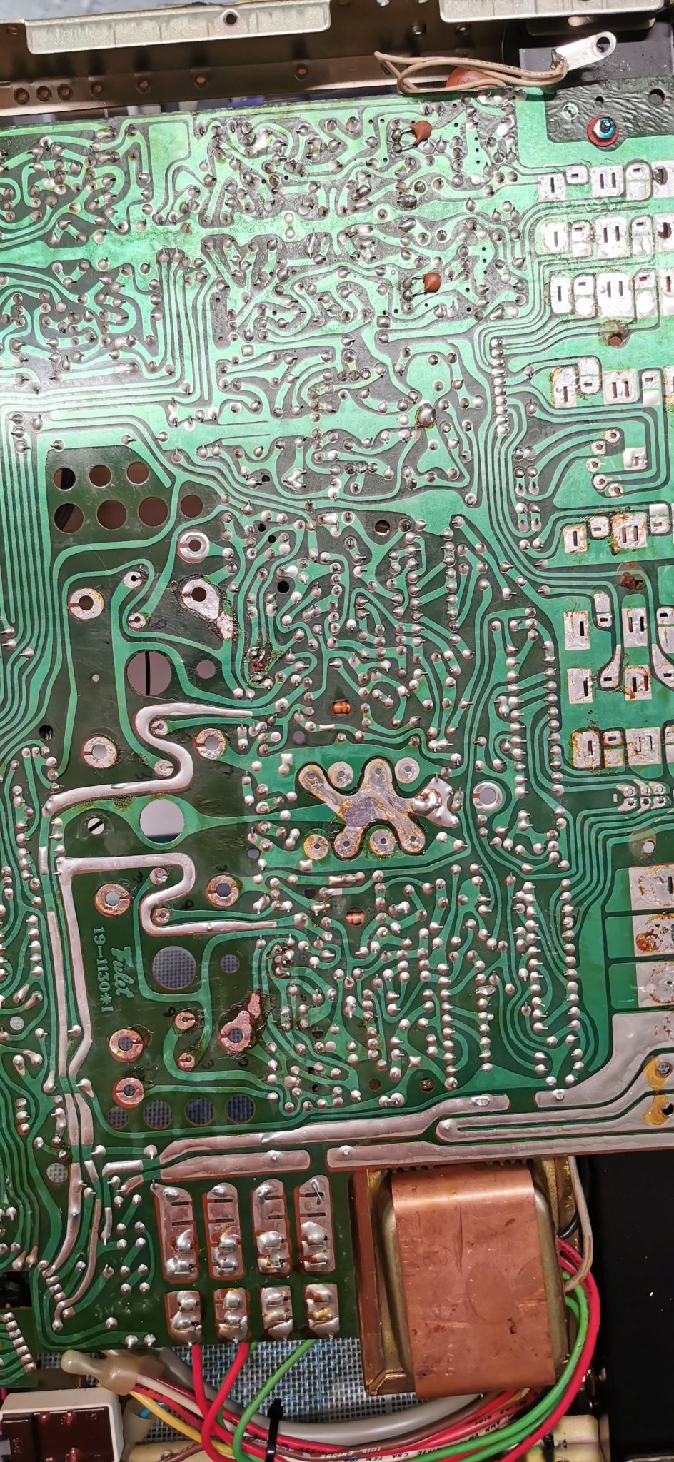

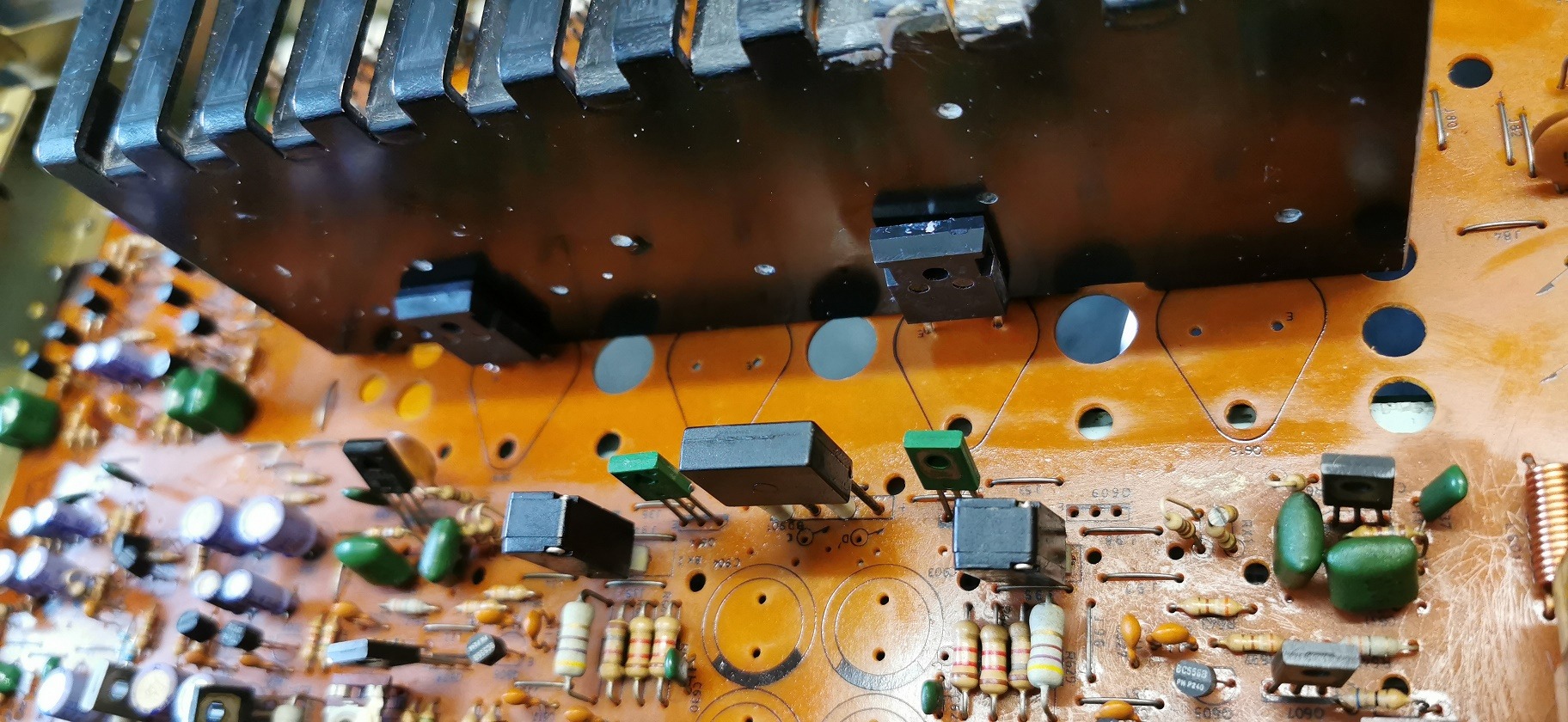

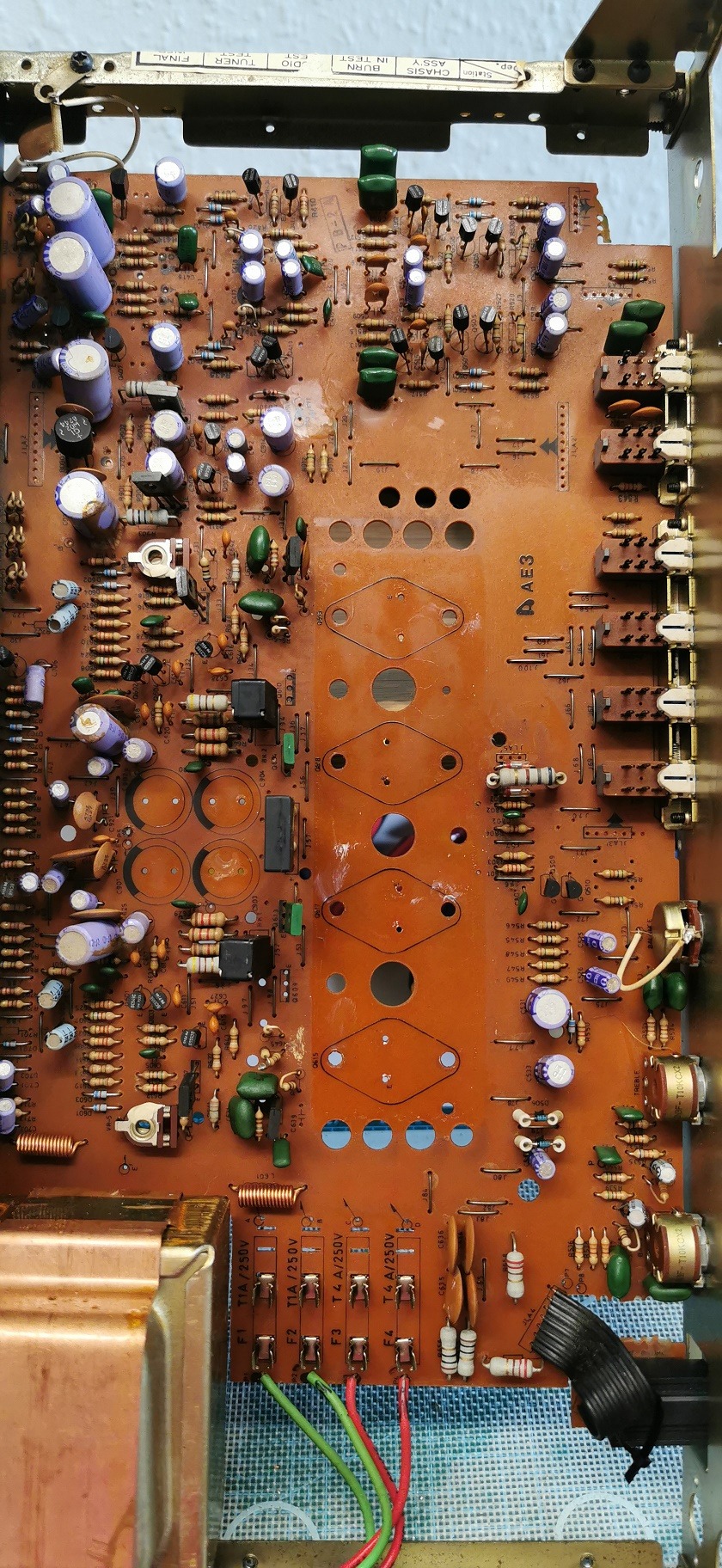

So the transistors have been stripped out with the heat sink. Excess solder removed from the terminal pads so I can see any cracks and the board cleaned again. Tomorrow I shall look at the heats ink and how I can adapt that or Introduce a complete new one, I'm also going to strip all the wiring out

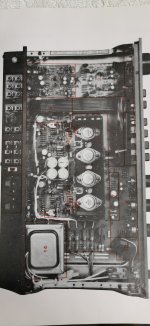

i think the answer to this question, or at least in this instance is that the practical outlay came first, the country lane effect as a result of that.I found this in one of the original manuals and it clearly shows each section numbered, well at least that would be my therory.
It might also explain why some other amps have a diabolical design, in that the printed side took preference

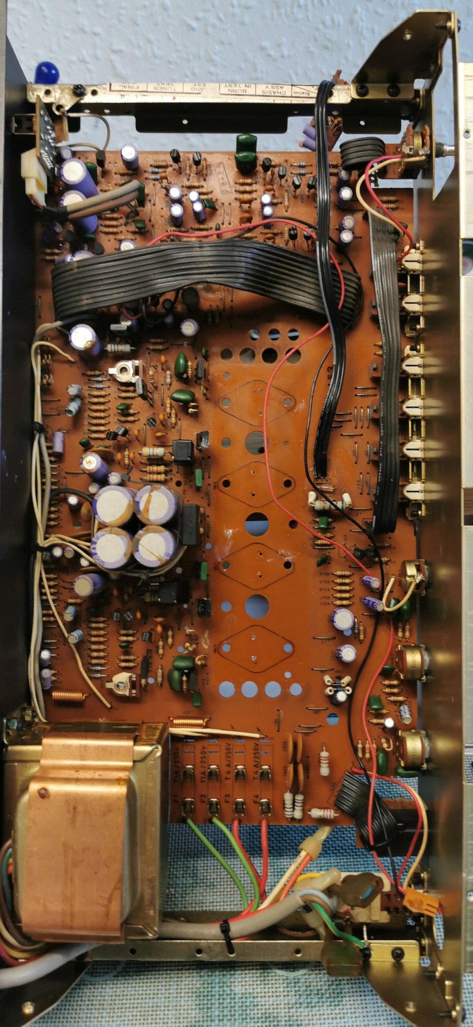

so continuing on then with STEP 2
All of the wiring has been stripped out and i now have a clearer view of the areas.
I want to try and get a heatsink in where i can mount the FETS verticaly rather than just use the old heatsink and lay them down as i have before
The 2 multiplier positions need some work as the print came off when i moved them off the heatsink, but that should be too much of an issue, i will create some wire anchors.
So this will be the basic concept for the heatsink,but i will have to add some surface area behind as i dont think this on its own will be enough
