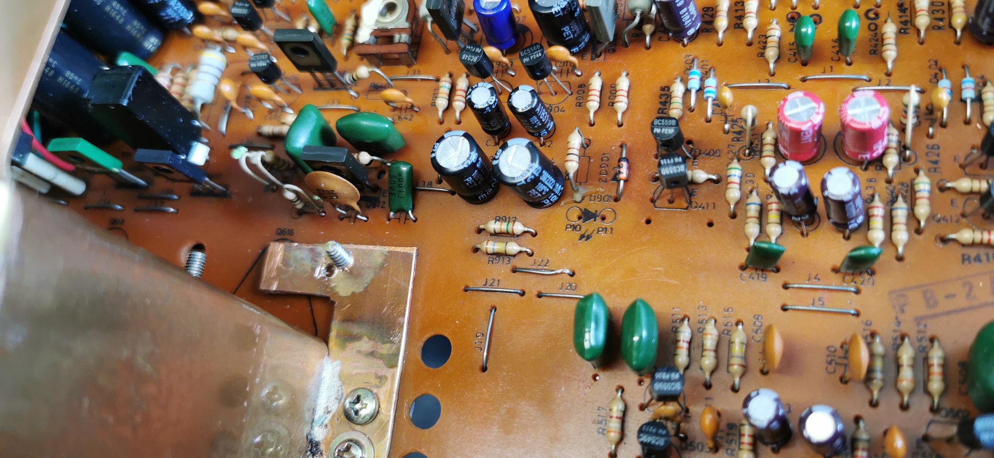

@Protegimus ,I made it from scratch, so I'm pretty pleased with it.Power supply is OK, it's the caps that flounder. They are 35v,but I measured the voltages and they do lag behind a bit if you have it switched to the higher rail voltages, so I use either 50v or 63's and that seems to do the trick

@inphase01 ,i did a full recap of the electrolitics, replacing some with film caps. I do have some original RCA(H) MJ's but it looks like you are a long way away.You realy need matching pairs. If when fitting these so you may be batter off changing all 4 and get matched sets. I always fit emitter resistors to the H's as well. What is the serial number of you amp?

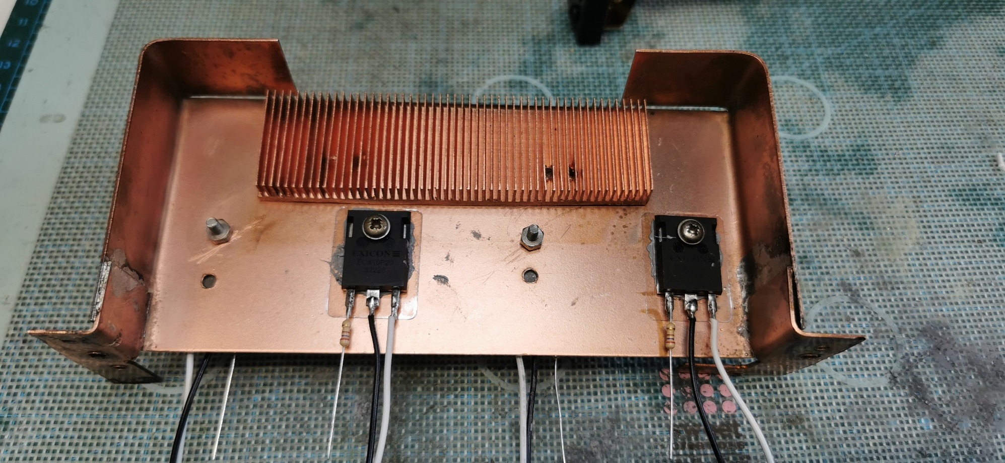

This looks really very neat! I can see that you take great pride in your work, well done. Definitely going to steal some ideasSo I've finally finished making the heatsink

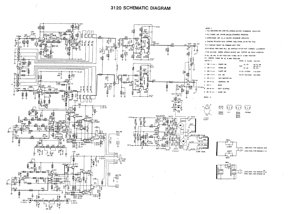

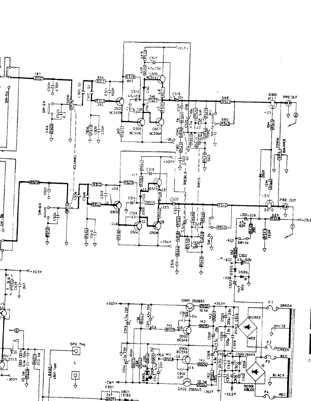

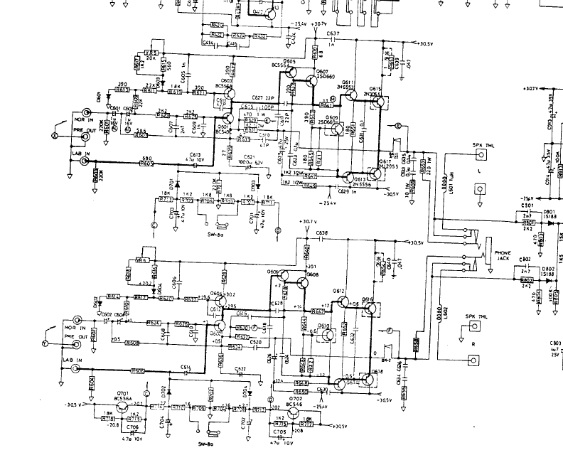

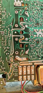

ok so that is a realy late one, just before the 'b' version and will have the board represented in these 2 diagramsI am really keen to take the RCA's off you if you want to sell them. I have family in the UK and my brother-in-law will be visiting there next week for 3 weeks. Maybe we can make a plan? The serial No. is B3224084
Your phono and power amp set up will be as diagram 1(3120)-your tone sections as per the next diagrams
Ive never been able to find an 'A' version manual so ive had to work it out working on various versions
The series 20 original had 2 setups basicaly, the late ones having the 'A' board but without the MM/MC circuit
The 'A's a combination of below and the B's a slightly different set up and power supply

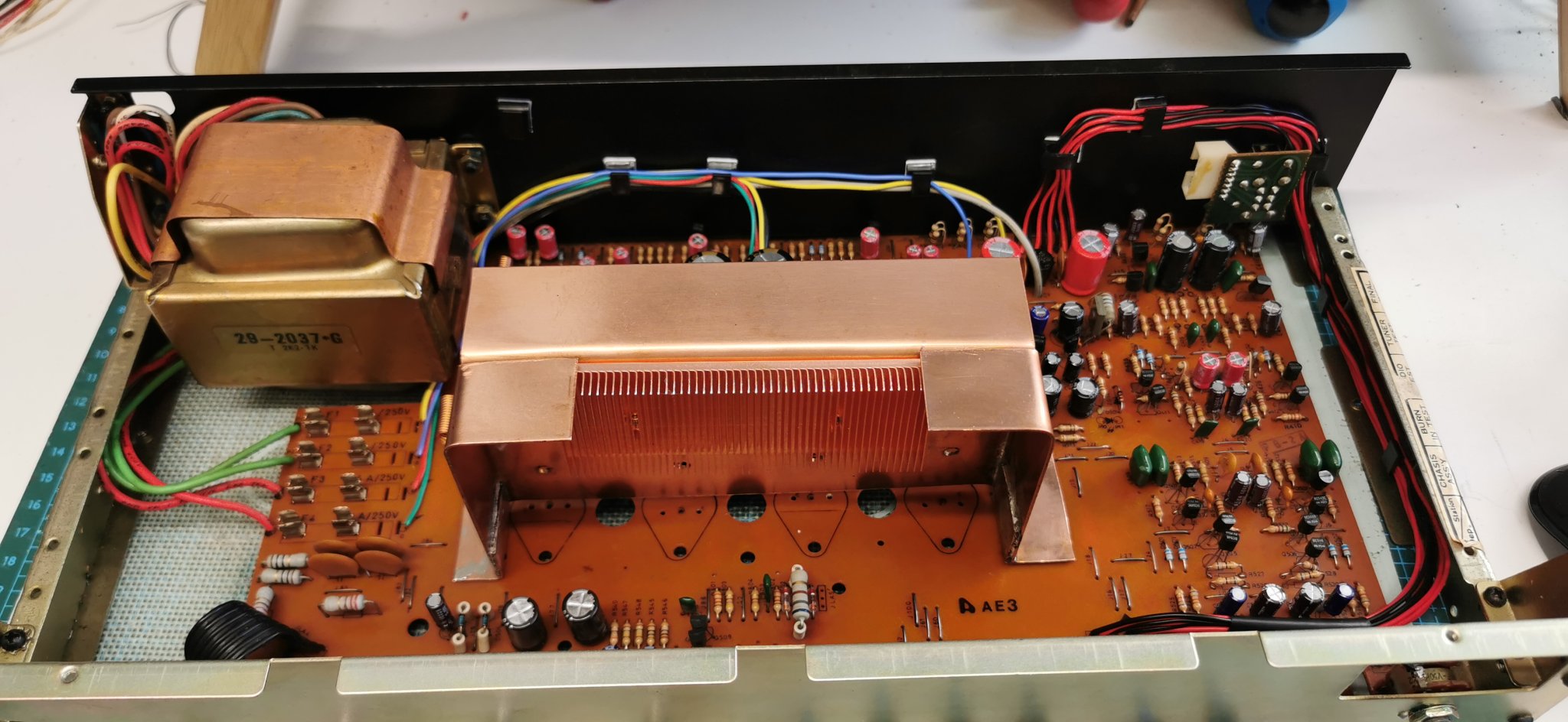

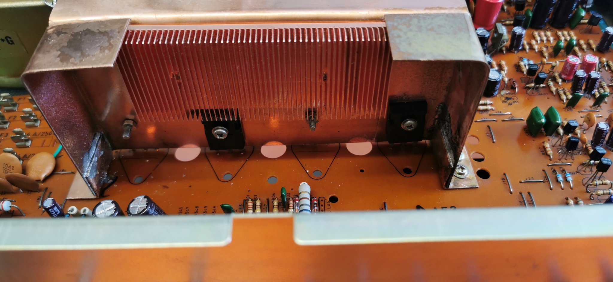

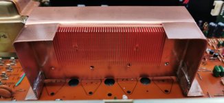

So the heatsink is finished and I've changed the right hand foot to encorporate the grounding connection. I made 2 small plates to screw through to from the foot plate. Now I'm about ready to start modding the transistors
I will trim the screws etc once I'm 100% happy I haven't got to alter anything.its taken alot to get to this point, but rather satisfying to see the end result so far
Yep they do that's why I've altered the pins so they are away a bit from them 😉The problem is that the caps are next to the regulators (trannies) , and the heat from them dries out the caps.

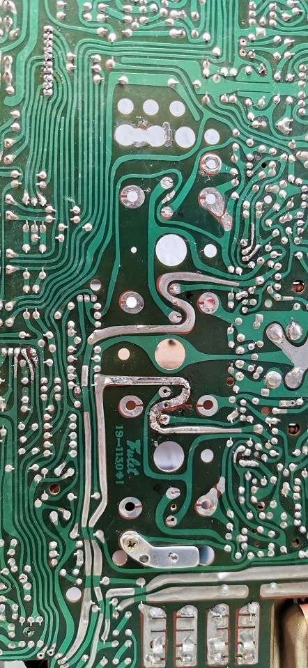

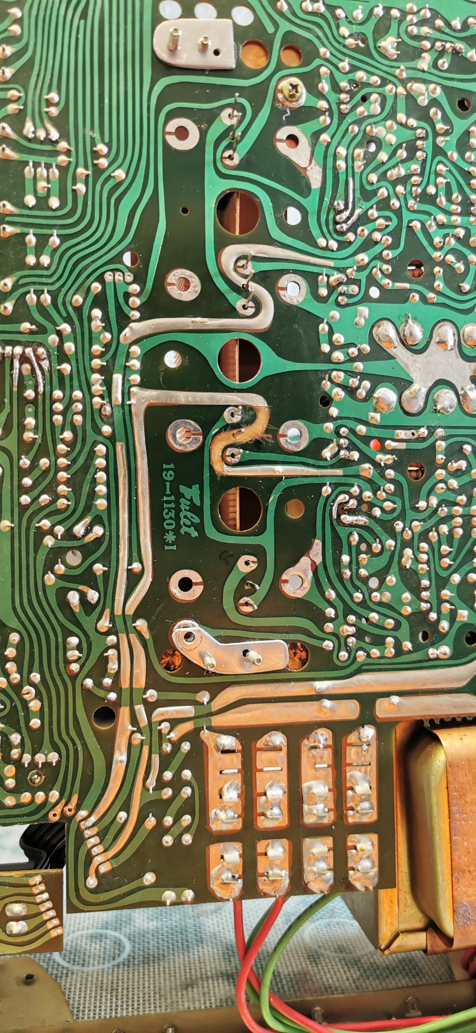

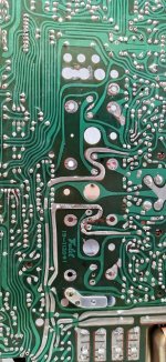

so ive come away from dropping them straight through each hole and swapping them over on the board.I didnt want to destroy it, but leave it in a way it could be put back as it was.
so the gate stopper is connected directly to the FET Gate and then i have a wire on each of the source and drains.This means i can cross them above and solder 3 at least direct to the original connections on the print
