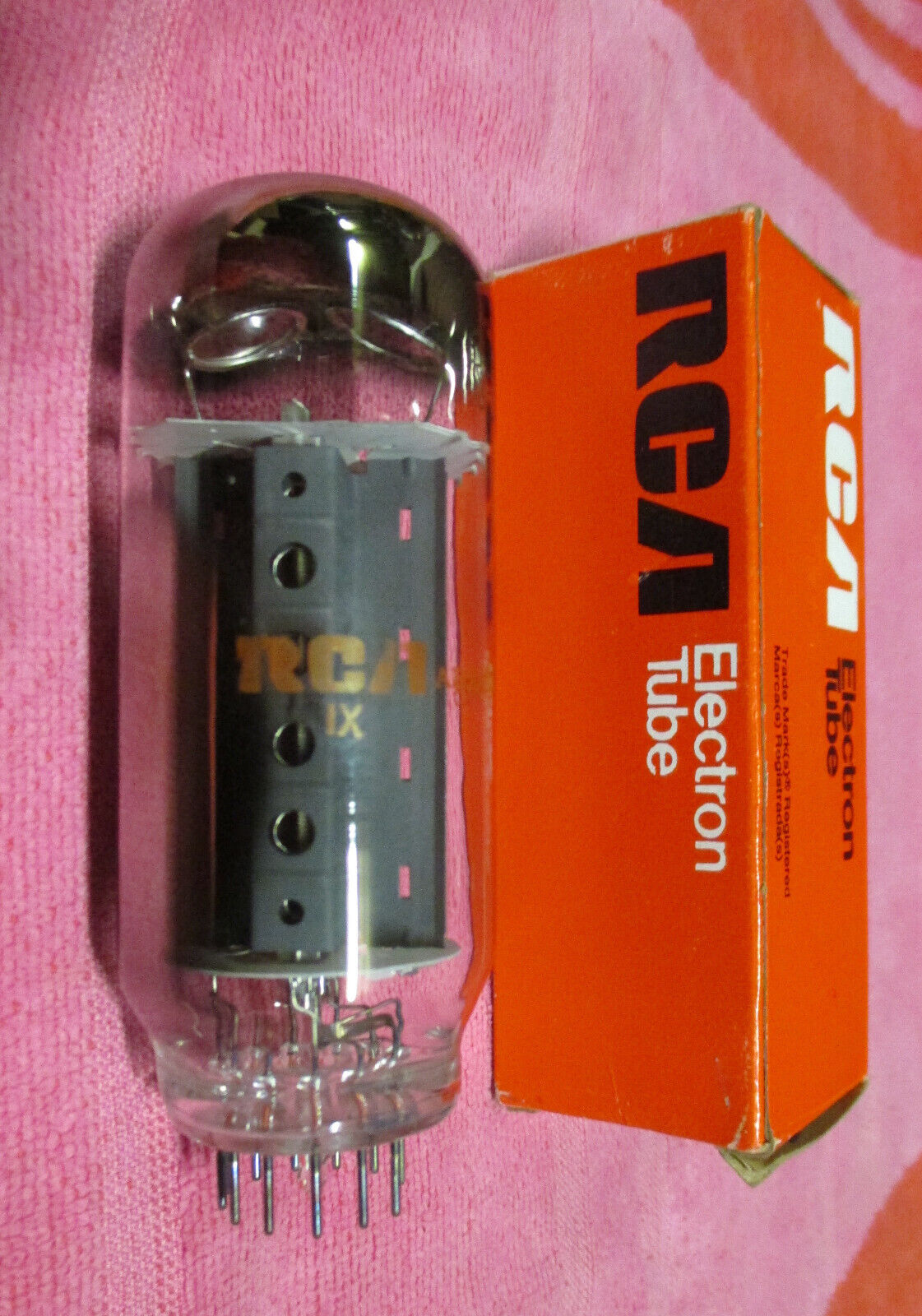

6HZ5 6000V 30W 300mA pk
Reactions: 1 user
I believe that it is to limit the Pa as they are HV regulator tubes, but there are no charts
on lower voltages.
I doubt that you cold make a wire thin enough to fuse at 1,5 or even 25ma and have it survive
as a lead in wire in a tube.
I am wondering, those HV reg tubes with Va up to 25kV with Ia(max) 1.5mA.
Would they break if Ia was 25mA peak?
Look at the heater power. 6BK4 6.3V 0.2 Amp , smaller than a 12AX7/ECC83
I have a 6BK4 here, and the cathode is miniscule.
That PD500 looks better though. 7.3V 0.3 Amp
The PL519 looks better than the 6HZ5 for continuous HV, since it has a plate cap. The Compactron socket (only) of the 6HZ5 would probably break down with continuous HV, unless you submerge the socket in silicone oil.
