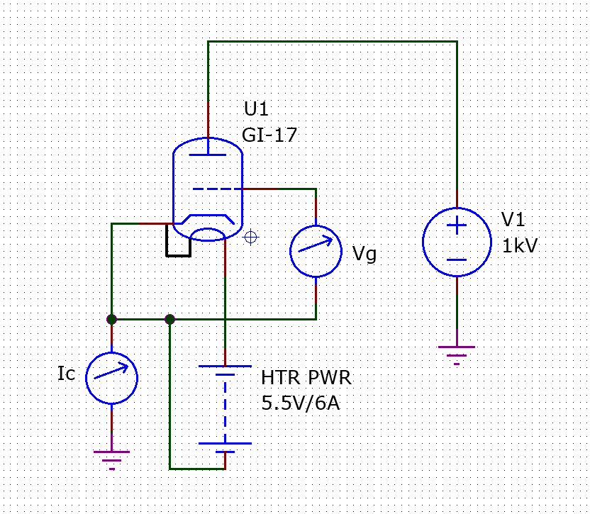

Well, the first test was an unmigitated failure!
See attached test circuit. First I started with Vg at -250V and slowly turned it toward zero, expecting at some point Ic to start coming up.
No joy. Tried 2nd tube, no current at all up to Vg = 0 V.
Reversed Vg and started to turn it up from zero to positive, and saw grid current coming up. Still no Ic!
At one point I did hear/see something like a short flash inside the tube though.
I measured Va directly at the anode metal and 1kV was there.
Heater was as expected, 6A at 5.5V, nice red glow.
What am I missing??

I probably did something wrong. If I purchased dead tubes, how would that manifest itself?
They were in their original Russian boxes, looked unused.
Another thing I looked at is that the grid contact (which is an M6 threaded stud) has a bad contact to the test clip; it looked somewhat corroded but I DID see grid current with Vgk>0 so that contact looks OK.

Anode current meter broken.
I tested a module of the direct drive amp yesterday and it worked then.
Murphy at its finest.
So prelim results:
Vak 1kV
Vgk Ia
-63V 10mA
-55V 20mA
-50V 30mA
Vak 2kV
Vgk Ia
-130V 10mA
-116V 20mA
-107V 30mA
The design calls for 25mA quiescent current, with +/-20mA swing.
I am hoping that I can drive it in grounded grid with the cathode not too high in voltage.
I don't have a 4kV source right now but I hope that I can get down to 5mA Ia with no more than -250Vgk and 4kV Vak.
We'll see.
First test looks promising right now.
Jan

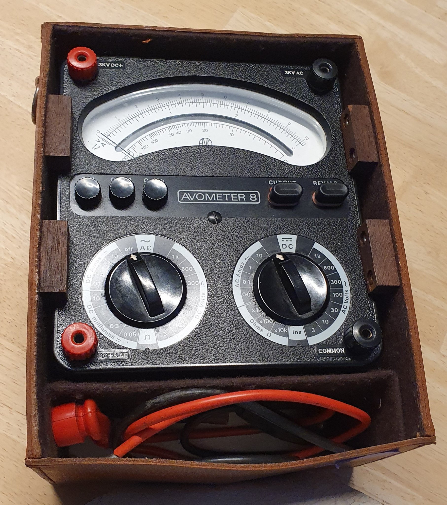

Of course not! And no watches, rubber soled shoes, one hand in the pocket.
And I need to throw three switches before the HV comes on.
I started my career working on 25kV color TV power units.
As they say, good practise comes from experience, and experience comes from bad practise.
Knock wood.
Edit: Time to break out the 3kV DC/AC vintage AVO I scored last year at the ETF!
