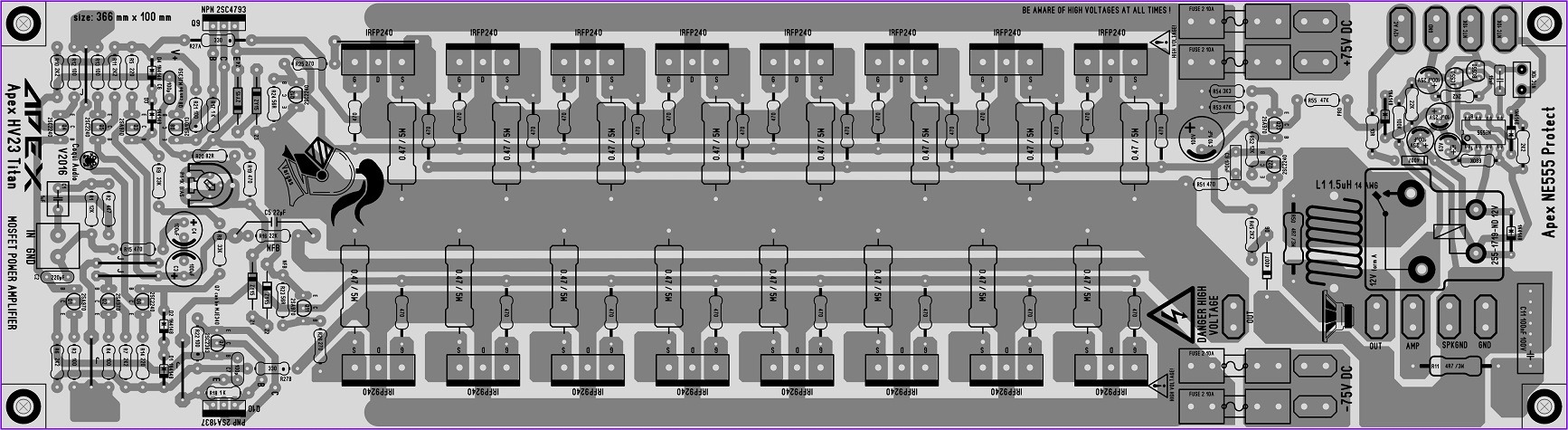

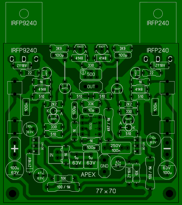

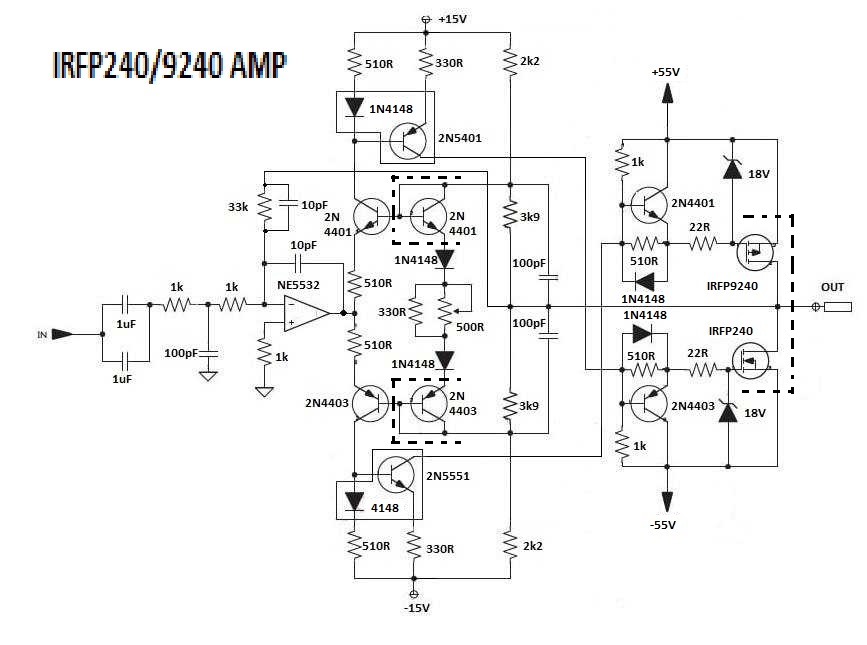

My contribution for this amplifier.
  • Apex 5532 PCB.pdf
Reactions: 1 user
thats quick Andrew, . meanwhile i made another version. but the one you already made is best.
just remember to use metal film / carbon film for the zobel Resistor, as wirewounds can cause oscillation . just something i learnt recently on Mooly's mosfet amp thread.
regards
prasi
Hi, build this prototype and it works great with + -47vdc, I got 112w (30v at the speaker output) with a consumption of 3.75A
a marvel

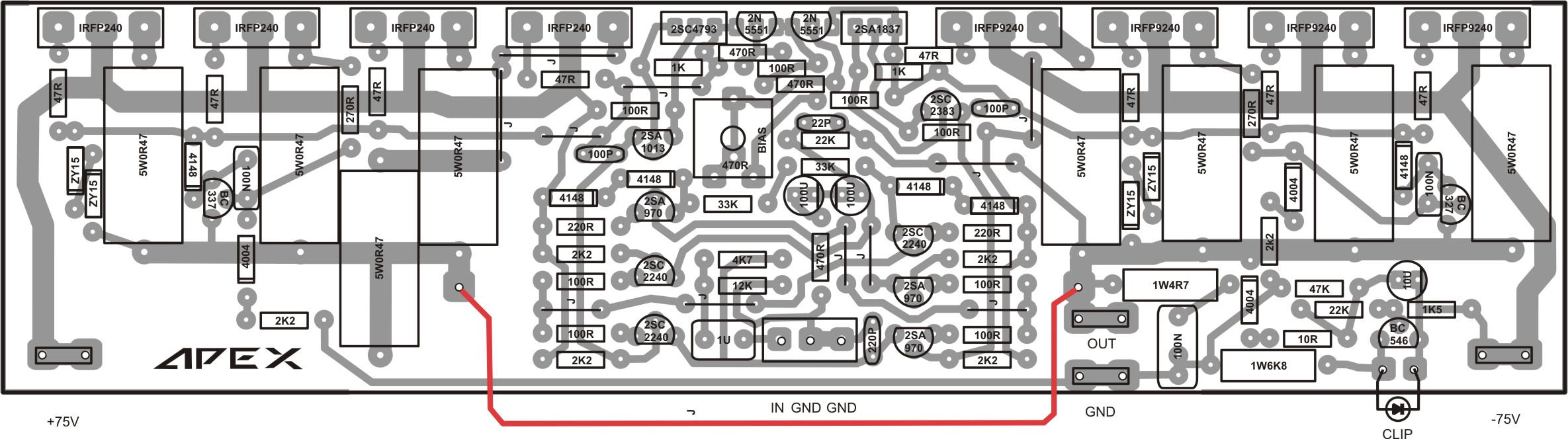

9240 and 240
are not complementary, look at the curves.
These are switching devices and its properties are not suitable for linear amplification
You only have to use N Channel Switching Mosfets. Build the same amplifier with just N-Channel IRFP240 and you will hear the difference
Then you will throw the 9240/240 Mosfet amp in the bin
9240 and 240
Hello NMOS, can you suggest any good amp with N-ch mosfets only
