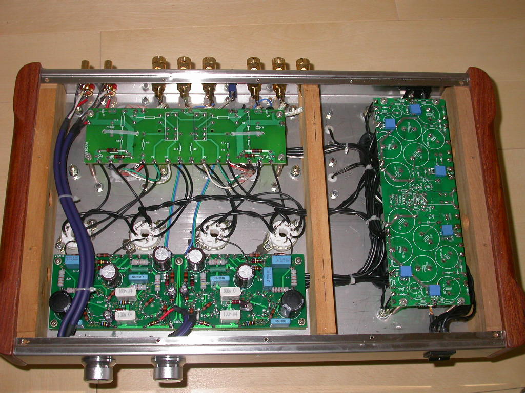

From a different pic I have of a similar amp, I think the relays are for triode/pentode mode switching. R11 and R12 are feeding the screen grids in one channel in the pic I have. Edit: I had a couple of ideas but not so sure now...

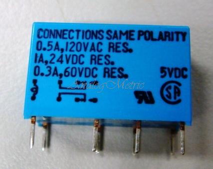

The relay is for triode/pentode switching.
The contacts can burn or stick together if the relay is operated with music playing.
Relay type: TAKAMISAWA (Fujitsu) RY5W-K
I propose to unsolder and check this one.
The reason for the burnt cathode and screen resistors is most likely either defect tube (shorted) , or missing bias supply.
When you have replaced the burnt resistors again, turn on the amp without KT88 tubes in this channel, and measure the grid voltage (pin 5). It should be about -50 to -60 volt.
Normally the kathode resistors are small wattage so that they burn out if something is wrong. I see you have replaced with big ones.
