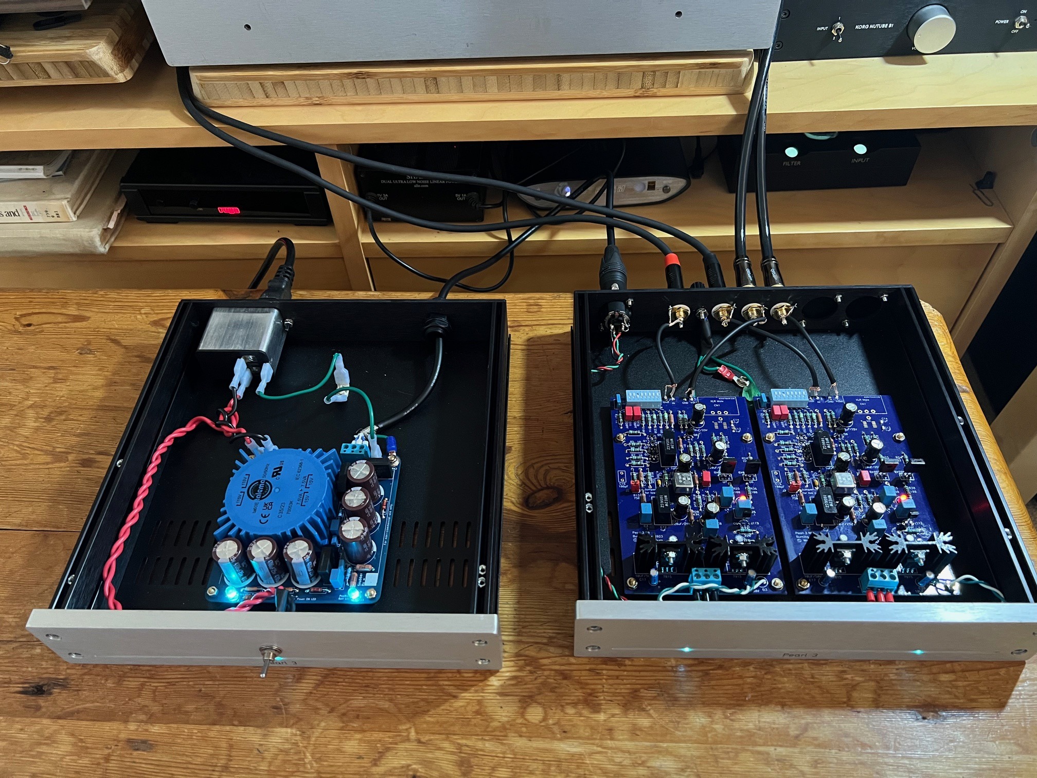

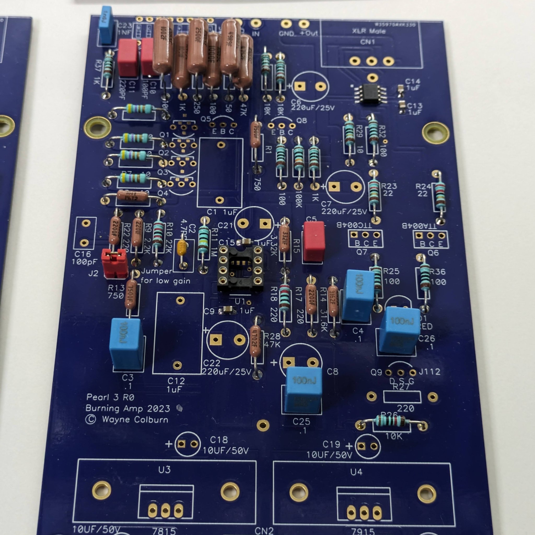

Build in progress. I chose larger Dales (RN65) for the MC load resistors.
First time I use an LCR meter (Victor 4091C). It makes matching components so easy. Since it is fanless, I leave it on all the time and match everything between left and right pcbs.
Boards and kits are very nice.

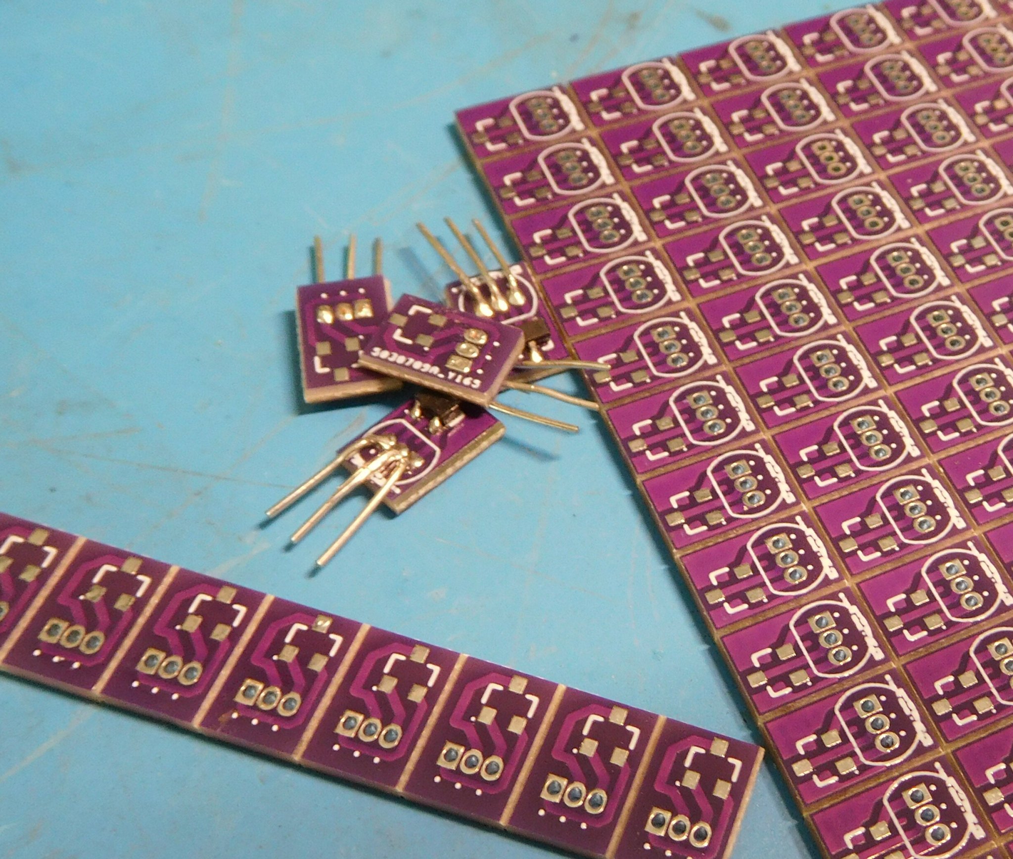

I made my own, smaller boards for adapting 2SK209s to 2SK170 footprints. 209s can be mounted on either side for versatility, and the boards are the same width as the TH devices. These can be mounted facing each other with the transistors in contact for thermal tracking. I've matched up a bunch of 209s for these.

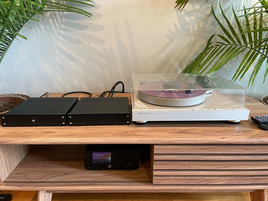

Listening to my newly-completed Pearl 3 as I write this. I'm not surprised that it sounds as good as it does, but to actually hear it is immensely gratifying. It's dead quiet, and presents a big, wide soundstage. Stage depth is very good too -- right off the bat I'm getting a really engaging sense of three-dimensional space (my system tends to image behind the speaker plane). I built this because I was anticipating upgrading my Goldring E3, and wanted the option to try out some low-output cartridges (e.g. the Grado Opus3/Platinum3/Sonata3 low-output). But with the Pearl 3, the E3 sounds just lovely, and I may just stop now while I'm ahead.
The build was straightfoward but moderately challenging, especially compared to building a pair of ACA monoblocks, and then an ACA Mini. It took me a good four days once I had accumulated all of the parts. On the other hand, besides having to fix the polarity of the power-indicator LEDs, this thing just came up and worked first try! Great testimony to the circuit and kit design, and the build guide.

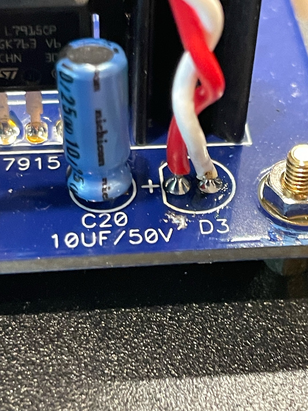

Couple of notes that might help others:
  • The font-panel LED terminals on the audio board (D3) has a "+" next to the negative pad. The part outline is drawn correctly, and the "+" is actually associated with the adjacent capacitor (C20), but it tripped me up. Non-catastrophic, and easy to rework, but worth looking out for

@ekobi Nice work. BTW, your's is the only other HK T60 turntable I have ever seen besides mine. It's a great piece of kit. What kind of cartridege are you using to feed your Pearl 3?
Thanks @audiosteve . The T60 is nice, and randomly "gifted" to me: when a friend of mine moved to NZ for a few years, I bought his car from him, and discovered the turntable in the trunk, along with a few boxes of LPs!
Currently fitted with a Goldring E3 to replace the Grado Black after the latter was destroyed by rambunctuous teens (allegedly!). How about yours?

My preamp is a Benchmark HPA4, which is driving the ACA monoblocks, into a pair of Spatial Audio X4s (from 2022, not the Ultra variants). The Benchmark is astonishing. For a while, I was running my DAC directly into the ACA monoblocks, and using its built-in attenuator for volume control. As expected the HPA4 was a tonally neutral addition to the signal chain, but the increase in resolution blew me away. I think it's the relay gain control that's shining here, but whatever they're doing, it's kind of neat.
