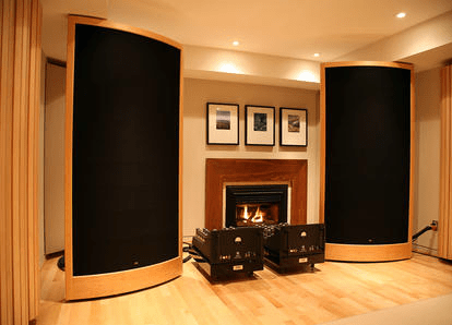

Looking at the two paintings gives me an almost instant feel and impression of how these two DACs may/could sound. Indeed much more so than "a thousand words" likely would do.
I got the same feeling, but it does not comport with what I hear on electrostatic speakers, along with the rest of my system here. Horn speakers and NGF amps might give a very different impression. Part of it is surely human preference though.
EDIT: Forgot to mention, my dual SE Andrea dac is different from the one listened to at the session described by @Joseph K
The one here uses two SE dac boards and dual power supplies to get stereo Vref. Also, found a trick adjusting damping of the BCK lines to the dac boards. In addition, I am using SOA clocks, not Accusililcon at the moment.
As You might noted, I am talking about a specific, different DSD dac model (without Andreas clocks, different topology, no FiFo, etc..) Did you have the opportunity to listen to that specific design? Which is a very promising, liked what I heard, just not the same sound profile which is warmer, more impactful & vivid in both the R2R and DSD 'classic' versions.
Large size electrostats are throughout most of their operating range chaotic mode resonators, you cannot reliably predict the exact position of a specific point on the diaphragm reliably with the input signal.
Together with many other challenges they are neither low coloration or low distortion (objective Magisteria) despite being hawked as the ultimate in transparency.

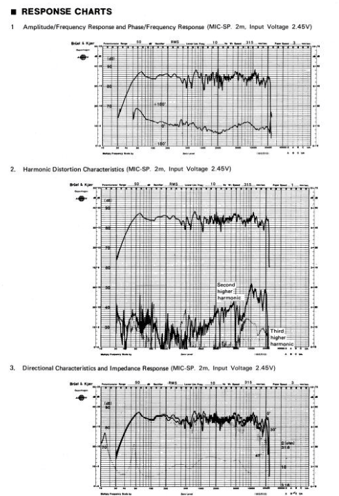

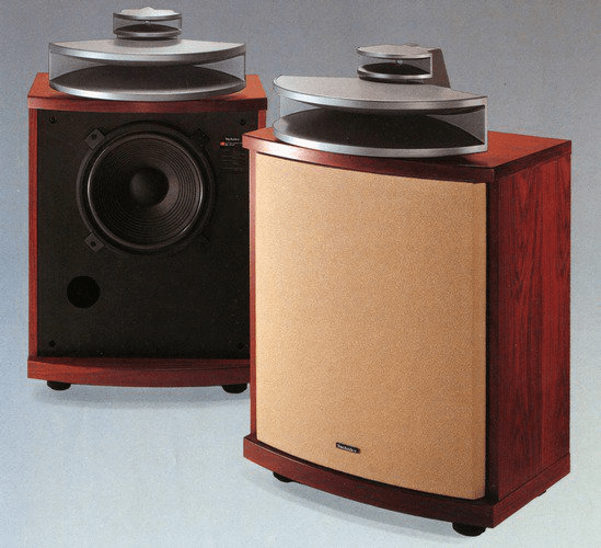

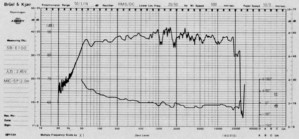

FWIW, here I listen to horns, in the main system Technics "Linear Phase" E-100's:
The Amplifier is "super high GNFB" non-switching Class AB (read Class AA) solid state amplifier with build in TDA1541 DAC fitted with a dual PLL for clock recovery and a short memory buffer (at the factory) driven from a USB-2-SPDIF converter from an micro PC (Windows etc.).
No room treatment, mostly bare room, modern minimalist design, well stuffed sofa. Speakers are toes in at 45 degrees.

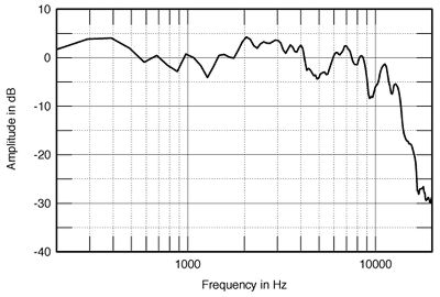

ESL 63's have a fairly flat response and a low distortion at most frequencies.
This is with 1/3rd octave smoothing.
Low distortion - I found that the distortion has many spikes (even ESL-63 which were quite common in London).
I don't know if it is still the case, but the main issue with (DIY as well as commercial) electrostatic loudspeakers used to be that many were designed by people who didn't know or understand Walker's equation. They would try to drive electrostatic loudspeakers with a frequency-independent voltage, leading to a +20 dB/decade far-field response. They would then try to correct for that by not damping the fundamental resonance and by using much too large radiating surfaces for the high frequencies, leading to cancellation effects between the signals coming from different parts of the diaphragm.
Yes, this applies not only to DIY Electrostats.
This problem of partial resonances patterns from a large undamped diaphragm and the problematic horizontal directivity was what my friends designs addressed.
The downside was that below somewhere between 80...200Hz it was necessary to hand over to dynamic woofers. For the largest system there was a 4-Way setup with a crossover at ~120Hz and 480Hz. Below 120Hz a "M" shaped dipole with dual 18"Pro Audio drivers and the final extreme low bass handled by 18" drivers venting into the basement of the house taking over at around 30Hz IIRC (yes, this system could reproduce a 32' organ pipe and even a 64'one).
I doubt a purely ESL system with a single Panel would be able to compete.
Even then I preferred horns at my owm place. How to say, I respected this system and appreciated what it could do, but it was more of a cerebral than visceral experience of music.
Thor

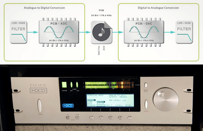

It shouldn't be, when the ADC and all requantizers are properly dithered.
With a classic Multibit ADC or DAC there is no dither and no requantitisation.
If you used Pacific Microsonic Model 1/2 at 88.2/96k or 176.5/192k you got in effect a direct recording via a 20 Bit Multibit ADC and playback via 20 Bit Multibit DAC.
The ADC and DAC modules used were direct Voltage In/Out.
The units are still legendary:
https://reverb.com/item/14637550-pacific-microsonics-model-two-hdcd-processor
In a TRUE PCM system there is no dither and no requantisation.
Nicam used transcoding from 14 Bit 32k LinPCM into 10 Bit LogPCM to fit a digital audio signal into the analogue Colour TV Signal. The DAC used however was not a LogDAC and the source signal was 14Bit/32KHz linear PCM.
So NICAM is a CODEC, not a recording system. NICAM actually survived and is now in effect the main high quality Bluetooth Codec - aptX.
Thor

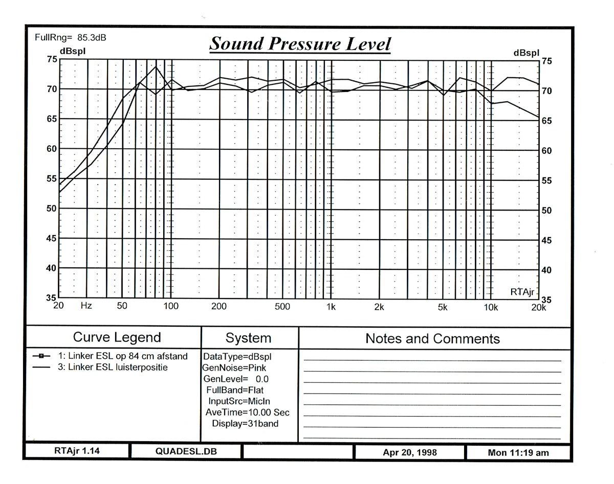

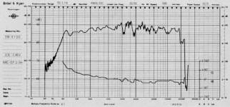

What a ridiculous and unrepresentative frequency response with -30dB at 20Khz.
In the attachment the left ESL63 recorded in my living room without any correction.
One curve is taken on axis from 84cm distance, the other curve at my listening position.
I have the same recording from the right speaker, practically identical.
Hans
