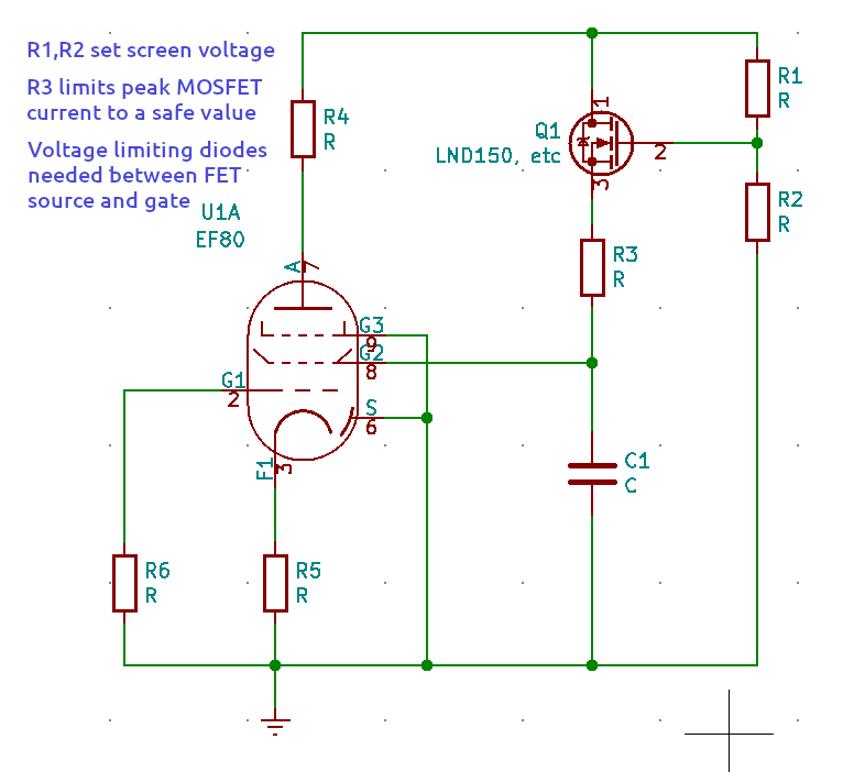

...how to provide a more or less stable voltage for the screen grid way below B+ on the plate?
<snip>
a simple resistor...creates a compression effect...
I encountered the same issue with a guitar preamp I designed and built some years ago. A bit of compression is okay for a guitar amp, but I was getting more than I wanted to.
One fix I tried was to wire two resistors in series (a voltage divider) from ground to B+, feed the gate of a small MOSFET from the junction, and feed the pentode screen from the MOSFET source.
Basically, the MOSFET acts as a DC source follower, providing the screen with the current it needs, but with a more-or-less regulated voltage that never strays far from the voltage you set on its gate. (Small changes in Vgs with FET source current will cause slight changes in screen grid voltage, but this will be a small effect compared to not using the MOSFET.)
You need overvoltage protection - in both directions - between MOSFET gate and source, and also a small resistor from MOSFET source to pentode screen, to limit peak startup currents into the screen decoupling capacitor. It also serves to limit peak screen grid current - we don't want any melted screen grids!
The MOSFET has to be able to handle the power dissipation involved: {(B+) - Vscreen} x Iscreen. For a small-signal pentode, screen currents are small, and this will usually turn out to be very little power.
This idea doesn't need a special transformer or power supply, but of course you do waste some power in the MOSFET. It may not matter, particularly for a small-signal pentode.

thanks for commenting. Strange - with a small signal Pentode's screen current (<< 1mA) I would have thought a simple voltage divider with a sufficiently large cap to be more than enough! Can you somehow quantify the difference in sag you've achieved?
In my case I'm facing a screen current running from ~4mA to ~15mA at 300V HT. With a voltage divider I'd be burning up some 20W...

It might very well be, depending on how many volts of sag you want. (But beware of the "large cap" - more on that in a moment.)
The relevant parameter for the screen voltage "sag" is the Thevenin source impedance of the potential divider, which equals the value of R1 and R2 in parallel, i.e. R_Thevenin=R1xR2/(R1+R2).
It's been a few years, but IIRC, I had a pentode supply voltage in the vicinity of 150 volts, and the actual screen voltage was, let's say, 75 volts (it might have been less, I forget the exact value I ended up using.)
Let's say we decided to use two 100k resistors in series to make a voltage divider, providing 75 volts at the junction when unloaded.
However, the Thevenin (source) impedance of the voltage divider is 50k (the parallel resistance of two 100k resistors). If the screen current of the small signal pentode changes by 1 mA, the voltage at the junction drops by 50 volts! That is a lot of sag, especially if the initial voltage was only 75 volts!
You could instead use two 10k resistors to make the voltage divider, giving you a 5k source impedance, and therefore a probably negligible 5 volts of sag at the screen grid (for a 1 mA change in screen current). However, the two 10k resistors now draw 7.5 mA of current from the 150 V supply, and dissipate over a watt between them.
While a watt of dissipation isn't all that much, having the screen grid bias resistors draw an order of magnitude more current than the anode (plate) resistor is a little annoying. At least to my picky brain.
On the subject of using a bigger cap in conjunction with a voltage divider, keep in mind that using a bigger cap only changes the time constant of the sag, not the total amount of sag after a sufficiently long amount of time. Because the DC source impedance of the voltage divider isn't changed by the addition of a capacitor, there will still be lots of sag if the pentode is overdriven for a long enough time period.
In the case of a guitar amp, if you use a very big screen grid decoupling cap, and the guitarist overdrives the pentode continuously for many seconds (say during a heavily overdriven guitar solo, or by passionate chord strumming through an entire verse), she will then drag the screen grid voltage lower and lower and lower throughout the solo or verse, gradually choking down guitar volume and altering the amount of overdrive, as though someone were twisting gain and volume knobs slowly.
With guitar amps I've found it a surprisingly good rule of thumb to never use a bigger capacitor than absolutely essential, in any location where the actual guitar signal is affected. Big caps tend to lead to excessive bandwidth, excessive bass, and all sorts of odd misbehaviour.
I have a little experience building and testing out a few small-signal pentode gain stages in guitar amps, and I found that it was definitely possible to have a screen decoupling cap that was too big. This produces a very spongy, compressed sounding guitar amp that responds very slowly to the guitar, like a low-quality compressor set with a too-long decay time. It might be suitable for some types of music (slow blues solos, say), but is very poorly suited to fast guitar playing.
At the other extreme, if you use a very small screen decoupling cap, you start to reduce bass response, and get a quicker sag and recovery. The quicker sag/recovery makes it possible to play the guitar at higher tempos without the amplifier misbehaving. And the reduced bass response is usually a good thing too - in a recording studio, guitars are typically high-passed at 300 Hz or more, to remove "mud" and keep the guitars from treading on the territory of the bass and drums.

Sure. It depends on the transconductance (gm) of the FET you selected, at the operating point you chose.
Let's look at an LND150 MOSFET as an example. The manufacturer's datasheet doesn't even quote a transconductance (unless I missed it), but data sheet graphs show drain current dropping by about 1 mA when Vgs changes from 0 volts to (-0.5 volts).
So if we run the pentode's screen grid current through this MOSFET, and the screen current changes by 1 mA, the MOSFET will require about a 0.5 volt change in Vgs in order to accomodate the change in screen current.
Since the MOSFET gate is held at a steady voltage by the potential divider, it's source voltage will drop by 0.5 volts as the screen current increases. If the screen grid were connected directly to the FET source, the "sag" voltage would be 0.5 volts.
This is actually too little for my purposes, which is one reason why my schematic showed an additional resistor (R3) beween MOSFET source and screen grid, to re-introduce the desired amount of voltage sag. R3 also protects the MOSFET from excessive peak currents.
Incidentally, since gate current is virtually zero, we could use a pair of 1 Meg resistors for the voltage divider, and still get a very "stiff" screen grid voltage, if that was what was wanted. And the voltage divider would only draw 75uA from the 150V rail, entirely negligible by any reasonable standard.
Heck, you could use a pair of 10 Meg resistors, if you had those in your parts box, reducing current draw of the divider to 7.5 uA.
In this example, power dissipation in the LND150 would be only 75mW at 1 mA screen current, 150 mW at 2 mA, and 225 mA at 3 mA.
I like to be conservative and keep these little TO-92 devices at no more than 300 mW total dissipation, which is sufficient to support up to 4 mA of screen current in this particular application. Way more than needed.

...screen current running from ~4mA to ~15mA at 300V HT. With a voltage divider I'd be burning up some 20W...
And if you used the MOSFET idea, the FET would only dissipate (15 mA) x (170 V), or 2.55 watts worst-case.
Clearly an LND150 wouldn't do the job here, but a small power MOSFET with a little clip-on heatsink could do the job. I would use a device which is fully encapsulated in plastic, so the heatsink doesn't end up with dangerous voltages on it, waiting to shock an unwary finger.
You could even put a resistor between B+ and the FET *drain*, to drop some of the voltage across itself, reducing power dissipation in the FET. Size the resistor so that the FET still has enough Vds to operate properly, even at peak screen current.

So a power FET with the voltage fixed from an array of zeners (amplified zener diode) seems to be the way to go - maybe even if a suitable lower voltage PT tap were actually available. A stiff variable screen supply looks like a very attractive way to power-scale the amp ...

First of all, thank you so much for your very thorough answer!
You're very welcome! In our new Dark Ages of "flat-earthers" and "anti-vaxxers", it's a huge relief to talk about something as real and BS-free as an electronic circuit. :)
After reading your comments I looked up the EF80's datasheet - which I clearly should have done before posting my previous remark.
No worries at all. Truthfully, I wanted to draw a schematic for you, so I fired up Kicad and grabbed the first pentode symbol I found in it's library. That just happened to be an EF80!
In the guitar amps I built, the pentodes I used were variously 6AK5, 6AG5, and the pentode section of a 6JW8. At the time, all three of these were available for just $1 USD each. No pricey EF86s for me.
Well, it's certainly one way to go. :D
...replace R1,R2 with a potentiometer, and you can dial up any screen voltage you want, between 0 volts and B+...
More practically, stick a properly sized pot between R1 and R2 so you can dial up a useful range of screen voltages, neither uselessly low, or uselessly high.
The screen voltage isn't actually regulated in this case (it will track variations in B+), but for a guitar amp, do you really need a mathematically exact regulated screen voltage? Most probably not...
By the way, potentiometers have maximum voltage ratings, and smaller pots invariably have smaller voltage ratings, so do keep that in mind. Also, this is one application where I would choose a plastic-shaft potentiometer over a metal-shaft one, simply for the increased electrical creepage distance between dangerous voltages and your fingertips!
