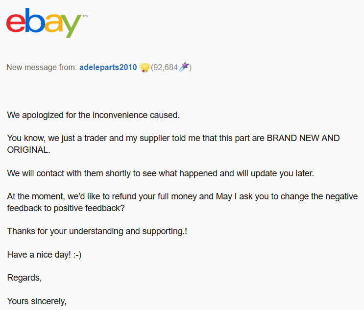

I did and today they partially refunded (I am out the shipping).
I attached their reply. They are still selling them and I doubt I will ever hear back about them "contacting their supplier". And they want me to change the negative feedback, however I don't want others to get cheated.
We apologized for the inconvenience caused.
You know, we just a trader and my supplier told me that this part are BRAND NEW AND ORIGINAL.
We will contact with them shortly to see what happened and will update you later.
At the moment, we'd like to refund your full money and May I ask you to change the negative feedback to positive feedback?
Thanks for your understanding and supporting.!
Have a nice day! :)
Yours sincerely,

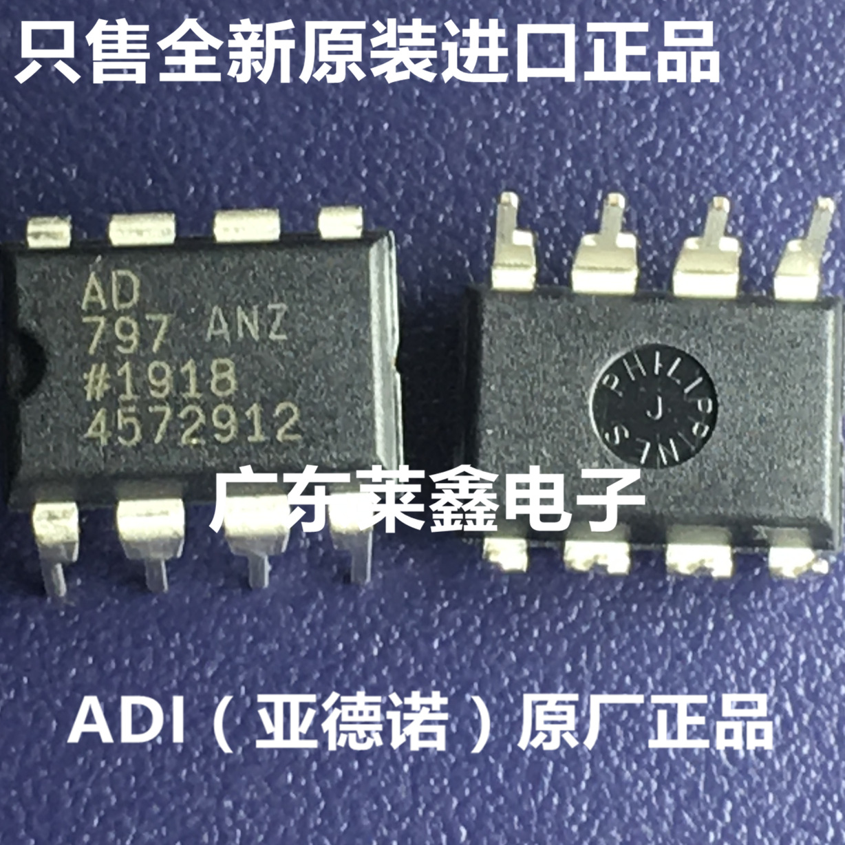

Checking Taobao, the sellers with credible offerings are priced around $9 each for AD797 and look like this :

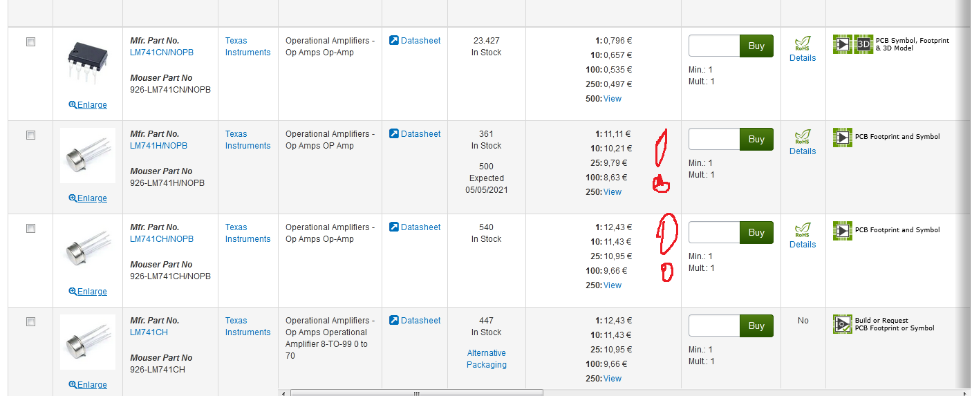

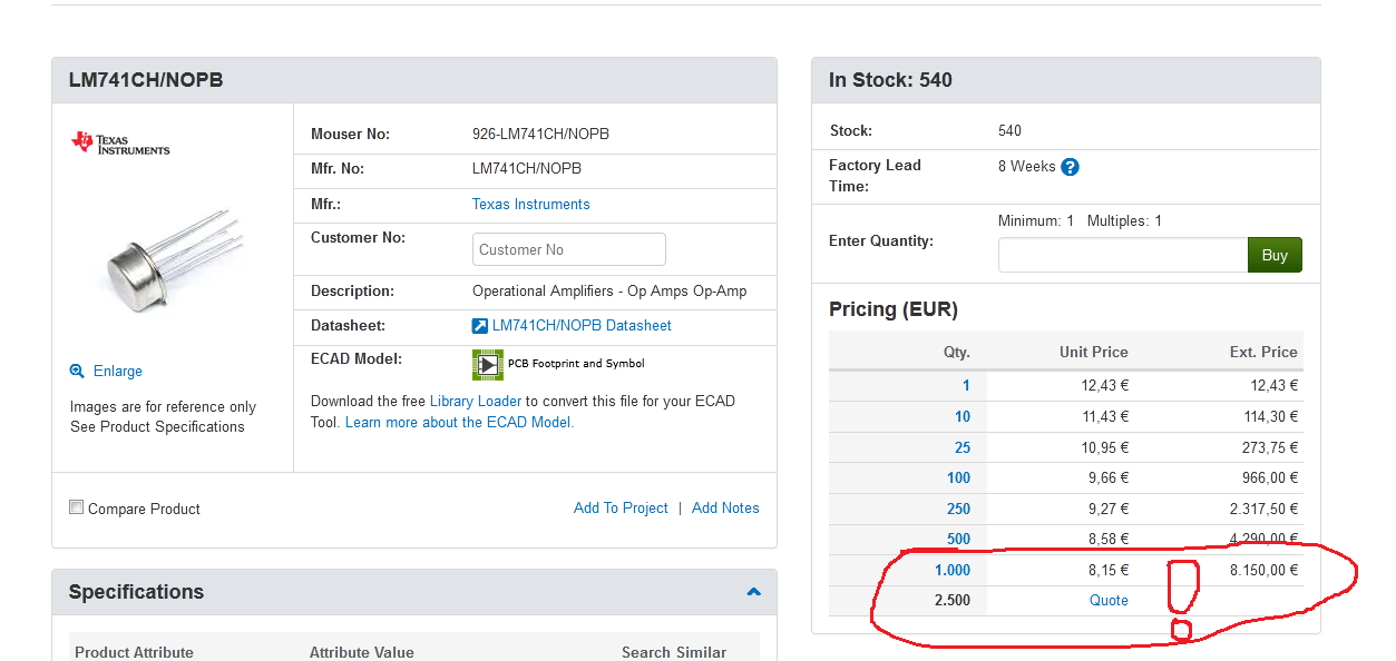

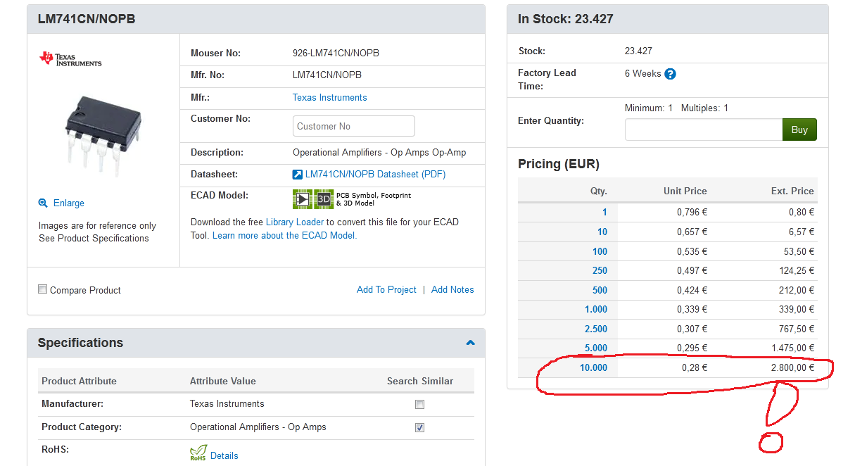

I was tinking that just buying those 0.01 cent chips, wipe out the old writing off the chip , giving it a new finish and a laser printer is better...
until i checked the real prices for lm741 which are insanely high:
What is sometimes not understood (by those outside the industry) is that manufacturers with volume purchase agreements routinely pay a tenth of the prices listed on Digikey and Mouser. That is the reason for the puzzle of assembled products containing actual genuine chips that cost less (including shipping) that you can buy just the main chip for. At Digikey or Mouser prices you could not possibly buy the assembled raw components for anything (TV, amplifier, computer, whatever) for anywhere near the price of the assembled, tested and packaged product you buy in the store.
Also I am sure that the LM741 type being used in the fakes is coming from the least expensive fabs in the least expensive regions of the world.
