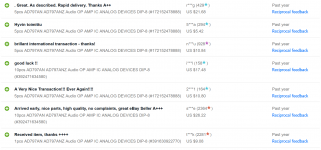

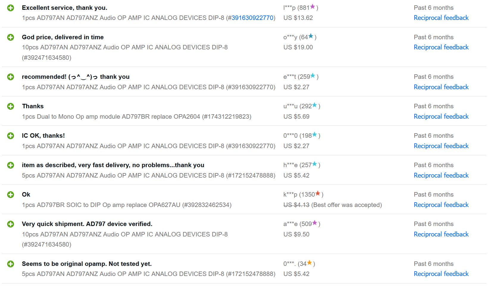

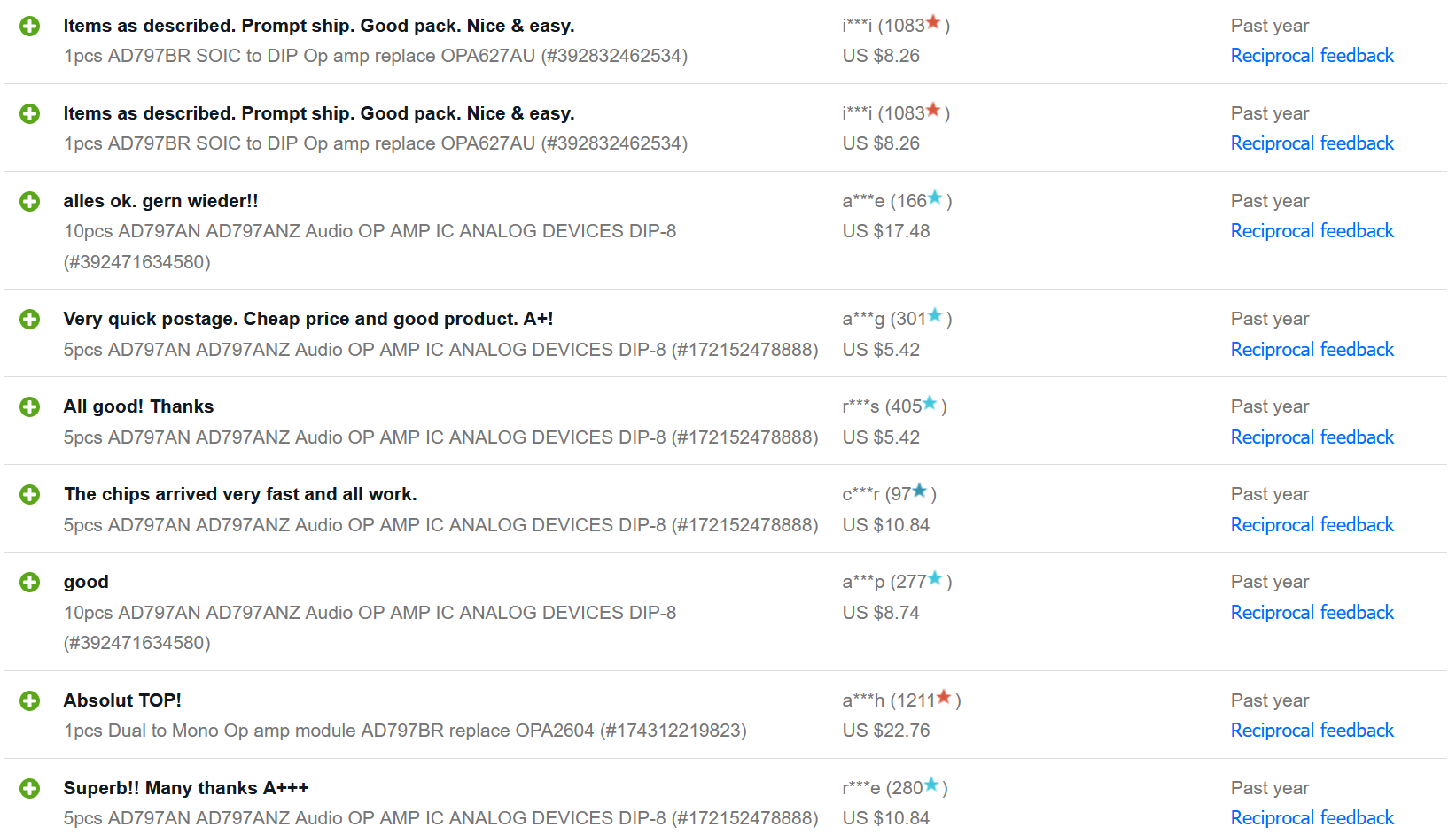

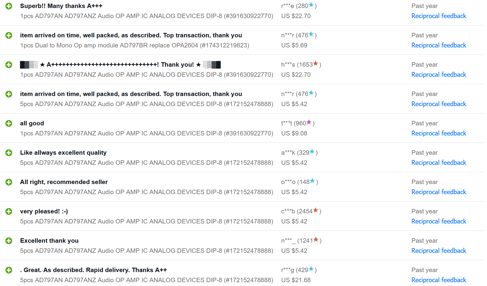

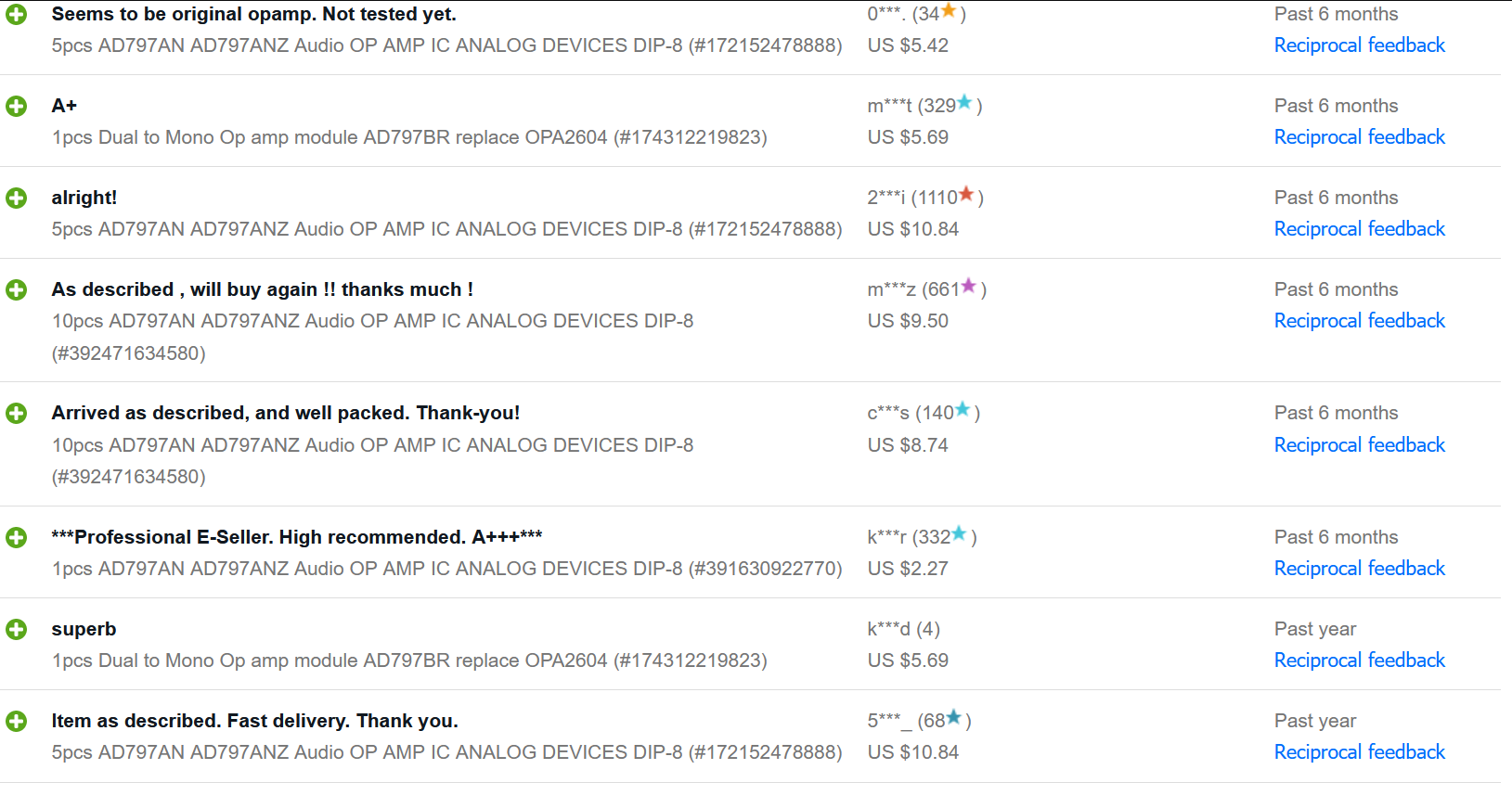

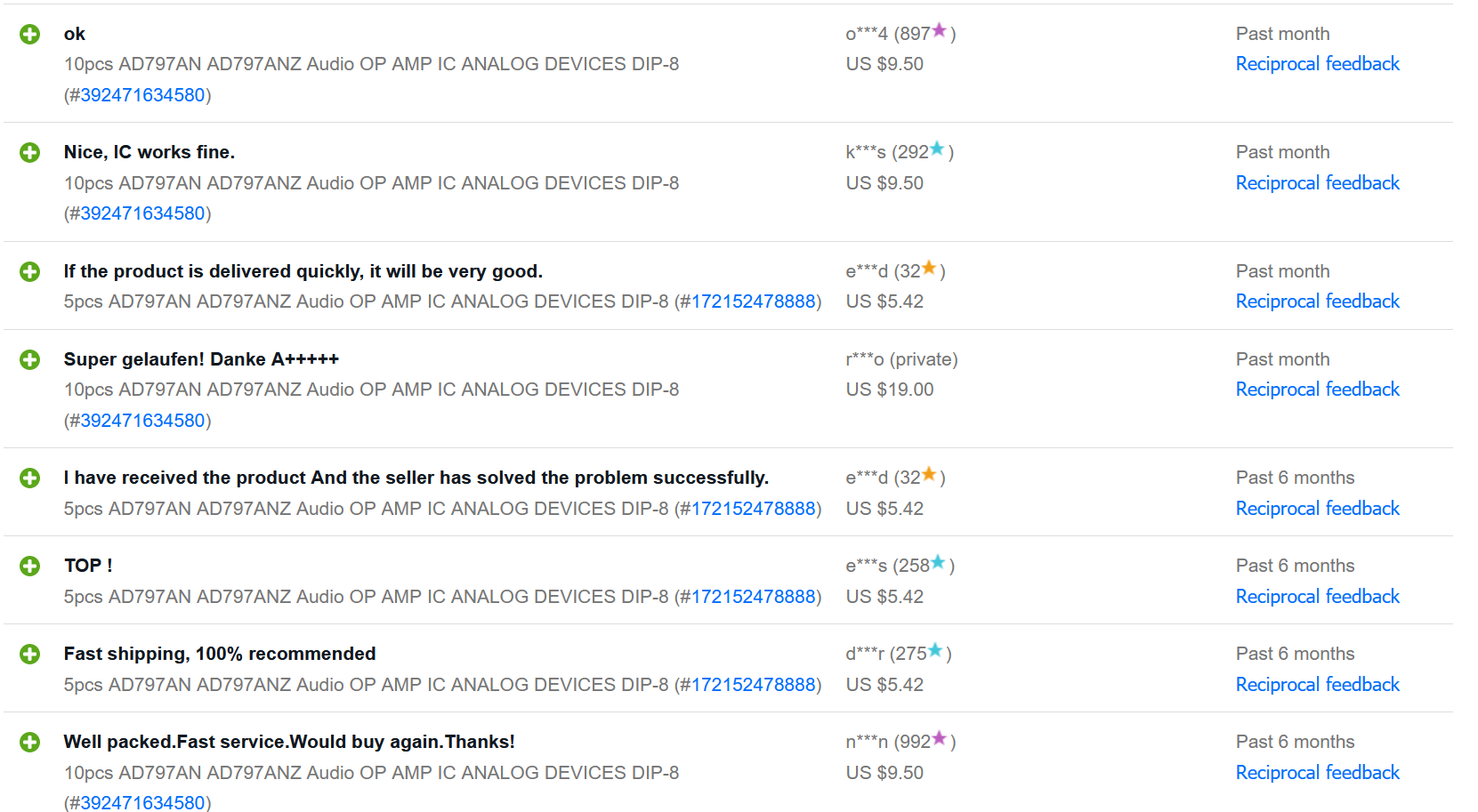

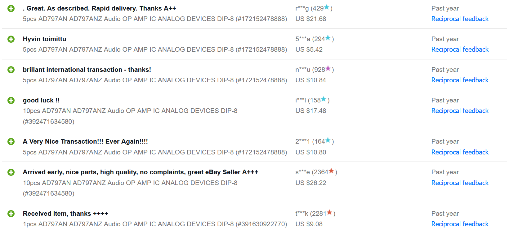

As I mentioned in the first post I have a rule against buying transistors, capacitors and op-amps online based upon prior experience.
This was simply an experiment based upon the enormous amount of positive feedback for the particular item (AD797 search in feedback) and thousands sold.
I wanted to know if it was really possible that thousands of "do it yourself" types had purchased this "AD797" with zero negative feedback on the transaction. Is that because they received real ones? Or because they can not tell the difference? Do people really just blindly leave 5-star feedback with no idea about what they are saying?
Take a look at the feedback (attached). Perhaps this indicates that the online market systems of ratings and feedback are hopelessly meaningless. Perhaps they are fake themselves?
And if you knew this you would not warn anyone else on DIYAUDIO? If you see thousands sold and know very well that they are likely bought by "do it yourself" audio types you would not be bothered to post a message to warn others? When you see the quantities of thousands having been sold? The purpose of the thread was not to complain. More to educate others. Are there any posts on DIYAUDIO about the sound of such and such after being upgraded with AD797, OPA1612, etc? Except those are fake AD797 & OPA1612? Just wondering.
